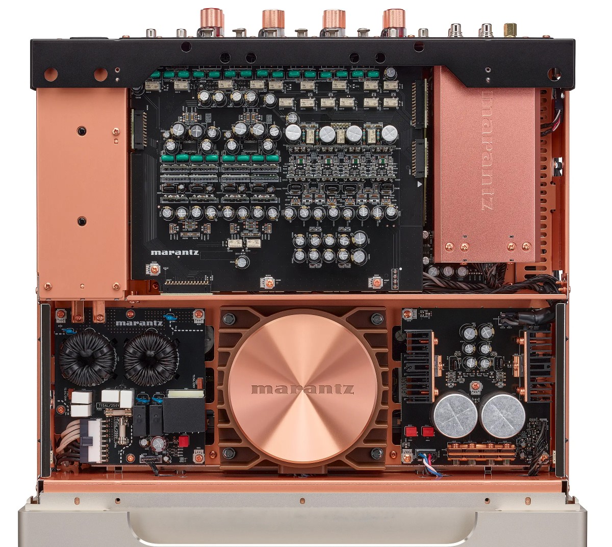

The power amp section is a new design engineered in partnership with the Danish company Purifi. (Co-founded by Class D savant Bruno Putzeys, Purifi was responsible for the circuit that made the NAD M23 one of the most accurate power amps ever to grace Gene’s test bench.) The Model 10 uses two of these newly-designed amps in dual-mono operation. The Model 10 utilizes a uniquely developed Purifi Class D amplifier topology in a BTL (Bridged Tied Load) configuration, customized for Marantz's requirements. Marantz states that the Model 10 is a fully balanced amplifier from input to output, featuring individual SMPS power supplies for each channel, designed by Marantz from the ground up, with all line-level input circuitry powered by a separate linear power supply unit.
As you might expect from a Purifi-based design, the amp boasts astonishingly low distortion — Marantz claims 0.05% THD across the entire audio band at full power, and an order of magnitude better at half-rated power. The 0.05% THD+N rating is Marantz's spec for clipping power. Based on the Purifi data sheet and our past experience measuring their amp designs, we'd expect the distortion figures to be almost immeasurable on our Audio Precision test gear at below clipped levels. Dynamic range should be no problem, thanks to the amplifier’s 30A of peak current. Marantz also says that the amp’s frequency response is immune to load impedance. In front of this new power amp is an all-new preamplifier section utilizing the latest generation of Marantz’s HDAM (Hyper Dynamic Amplifier Module) analog circuitry. HDAM is a proprietary Marantz technology first introduced in the PM-99SE amplifier in 1992, and is designed to deliver the optimum combination of speed of response and transparency of signal, according to the company. The latest incarnation of this all-discrete componentry is said to outperform all predecessors, ensuring that the Model 10 “has all the musicality for which Marantz amplifiers are rightly renowned,” according to Marantz.

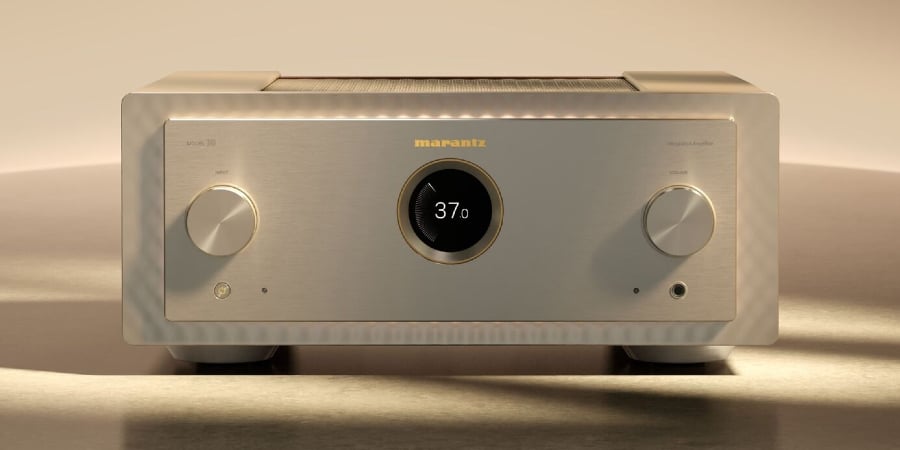

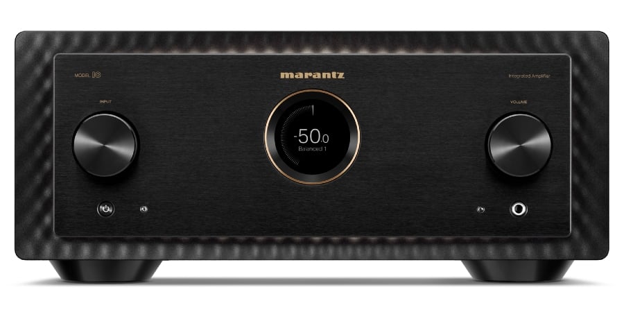

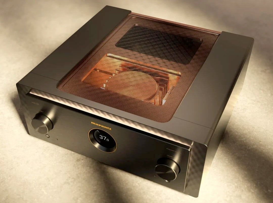

Marantz is known for paying thoughtful attention to the little things when it comes to aesthetics and ergonomics. The Model 10 features the brand’s signature porthole-style display, but it’s been upgraded to a high-res TFT that can switch from displaying volume level, to selected input, to a Level Meter mode. The CNC-machined, spun-finished aluminum control knobs for volume and input selection feature individual bearings for a smooth feel. Beauty may be in the eye of the beholder, but this beholder thinks the Model 10 is a knockout. The amp’s industrial design is marked by the special hairline finish on the front panel’s extruded aluminum control surface, with subtle LED lighting embedded around the assembly. The mesh-covered grille section on the unit’s top panel is “rippled with Marantz’s iconic rhythmic design pattern and illuminated from within,” showing off the amplifier’s massive power transformer and other high-spec components. The solid aluminum side panels are almost 16mm thick, providing an ultra-low-resonance structure and contributing to the 74-pound amp’s overall feel of solidity.

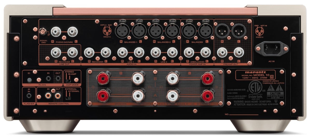

While some manufacturers seem to treat remote controls as afterthoughts, the Model 10’s remote features a teal-colored aluminum top surface that gives it “added heft and (a) premium feel,” according to Marantz. The remote is unique to the Model 10. The all-analog Model 10 features two XLR balanced inputs, three additional unbalanced inputs on RCA, and a high-quality phono stage for both MM and MC cartridges. Preamplifier outputs are also provided, again in both XLR and RCA. There is also a power-amp input that bypasses the Model 10’s internal preamplifier. A high-quality headphone output rounds out the offering. Peering at the backpanel, we don't see provisions for a bass managed subwoofer output so you'll have to use the preouts and internal crossover of your powered subwoofer if you decide to supplement the bass response of your system.
