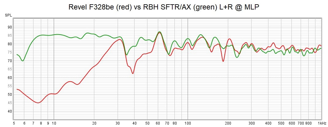

In-Room Bass Response Comparison: Revel F328be (red) vs RBH SFTR/AX (green)
Editorial Note on Bass by Gene DellaSala
My office is a very difficult room to get great bass response in from just a pair of pass full-range speakers. As you can see in the measurements above, my seating area has a large null from 30-45Hz that isn't fixable with a passive speaker like the Revel F328Be as easily as it is with an active speaker like the RBH Sound SFTR/AX. The Revel's limited bass extension sharply rolls off below 25Hz while the dual active 12" subwoofer drivers of the RBH Sound sealed bass modules produced flat room extension down to 7Hz! The end result is epic proportions of deep bass for music and movies.
Shane Rich, Technical Director of RBH Sound, recently flew down to Florida to install a prototype of the SFTR/AX in the Audioholics Smart Home. While the regular SFTR uses analog crossovers, the SFTR/AX uses active DSP crossovers and other features that supercharge its performance. In a recent YouTube video on the Audioholics channel, chief Audioholic Gene DellaSala goes over the details of this new active speaker system with Shane. They show some preliminary in-room measurements and compare the speakers’ performance with that of the Revel F328be speakers to demonstrate the power of an active, DSP-tuned loudspeaker system.

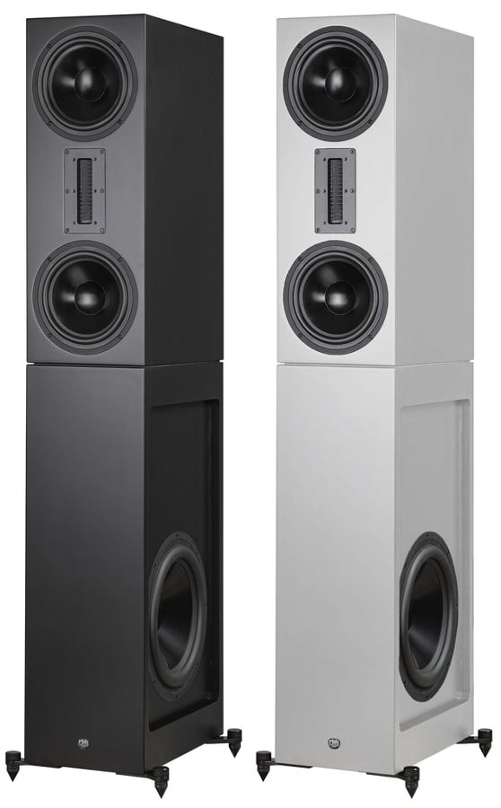

Both the passive and active versions of the SFTR modular towers promise top-tier performance in their price categories. The standard SFTR provides a passive upper module paired with 2400-Watt active subwoofers. The 821-SF/R module on top uses two newly-developed, 8-inch, proprietary aluminum cone woofers, situated above and below an acclaimed Aurum Cantus air motion transformer tweeter. This large AMT tweeter “integrates perfectly with the proprietary aluminum-cone mid-bass woofers,” according to RBH Sound. The slender profile and traditional MTM alignment reportedly contribute to astounding stereo imaging. The 8-inch driver is a new design and is said to be better suited to midrange duties, thanks to the addition of shorting-rings and a new voice coil. The 1212-MS/R subwoofer module that serves as the speaker’s base uses dual proprietary side-firing 12-inch long-throw aluminum cone subwoofers in a sealed enclosure. The two modules are secured to one another with steel plates. Customers have the option of choosing between internally mounted 2400-Watt RBH DSP-controlled amplifiers (with a total system cost of $16,500/pair) or a rack-mountable 2200-Watt RBH DSP-controlled DA series amplifier (which brings the cost of the SFTR down to $14,500/pair). RBH says that either option provides the subwoofer modules with enough output to create an in-room frequency response down to a seismic 12Hz in most listening environments. Buyers of the passive SFTR can choose the UNRIVALED upgrade path ($22,000/pair), which includes internal wiring by Kimber Kable, additional wall damping, and the inclusion of the RBH’s newly-developed G.A.D.S. (granular acoustic damping system) technology, which further increases the performance of the speaker by making the enclosure more resonance-free, inert, and well-damped. Other upgrades include better binding posts, internal damping panels, and a wool upgrade over poly fill.

Although not nearly as enormous as the flagship SVTRS towers, the SFTR towers are still substantial speakers, standing nearly 58 inches tall and weighing in at 137 pounds each for the passive version (the active version adds another 23 pounds). They are available in satin black or satin white finish. If you go with the active version, you need only bring a music source and volume control to the party. A streamer with a built-in volume control would work — anything from a $599 Bluesound Node to a six-figure stack from DCS or MSB. Or you can use an analog preamp and the analog or digital source of your choosing. With the passive version, you will of course need to supply your own amplifiers. But the passive module offers high sensitivity — it’s rated at 92dB (2.83V @ 1M) — so you won’t necessarily need a big bruiser of an amp. With a frequency response of 20Hz-35kHz (±3dB), both versions of the RBH Sound SFTR will deliver true full-range performance. The speakers are available now from the company’s authorized dealer and distributor network including our own channel partner Dreamedia.
