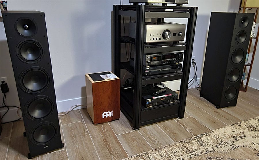

The Paradigm SE 8000F is a large 5-driver, 3-way bass
reflex, floorstanding speaker available in matte black or white gloss. They

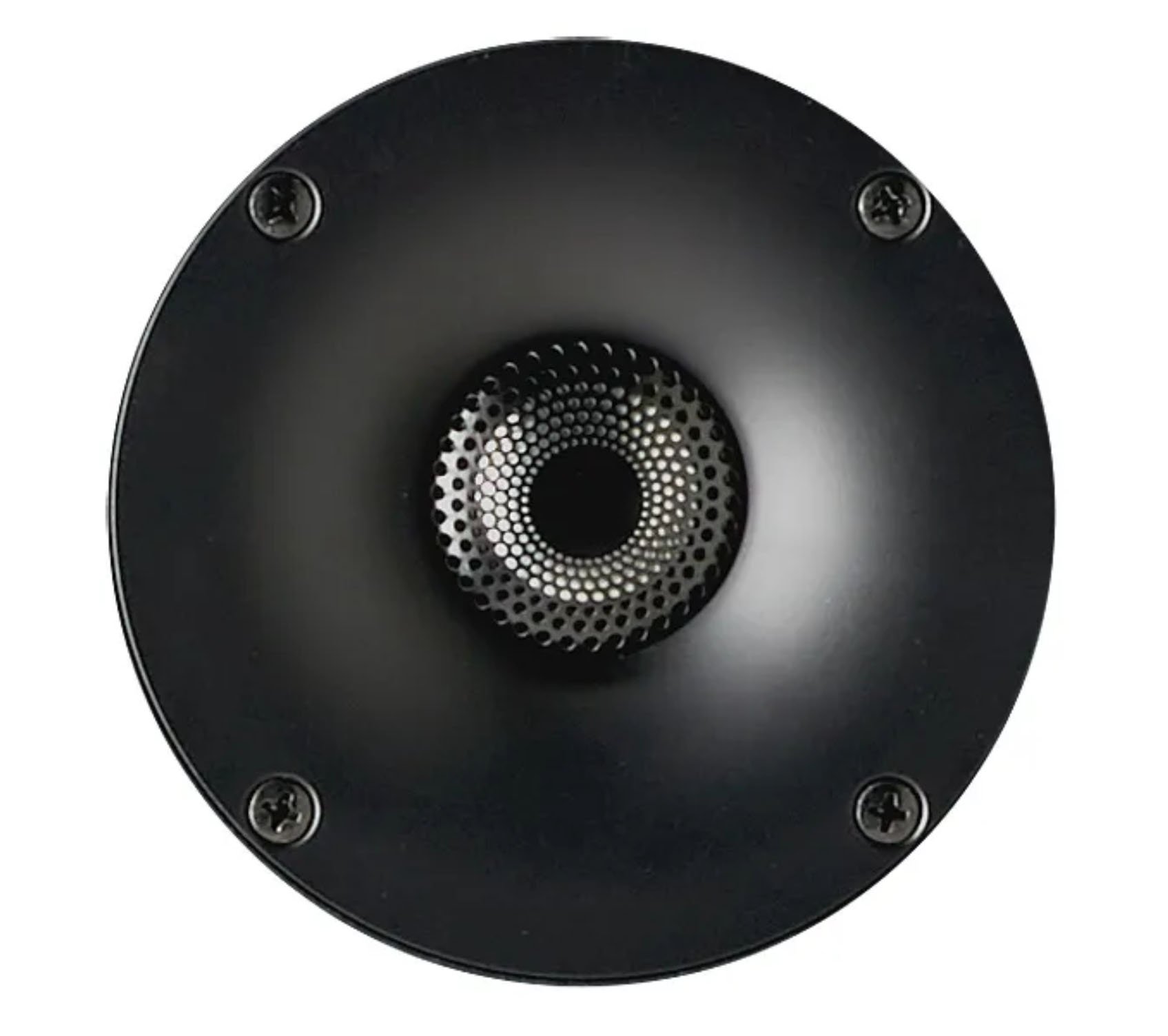

feature a 1" X-PAL™ pure aluminum dome tweeter with PPA (Perforated
Phase-Aligning) lens borrowed from their more expensive Premier, Founder and
Persona series. This exclusive patented design acts as a refined phase plug to
prevent on-axis beaming by blocking out-of-phase frequencies from interfering

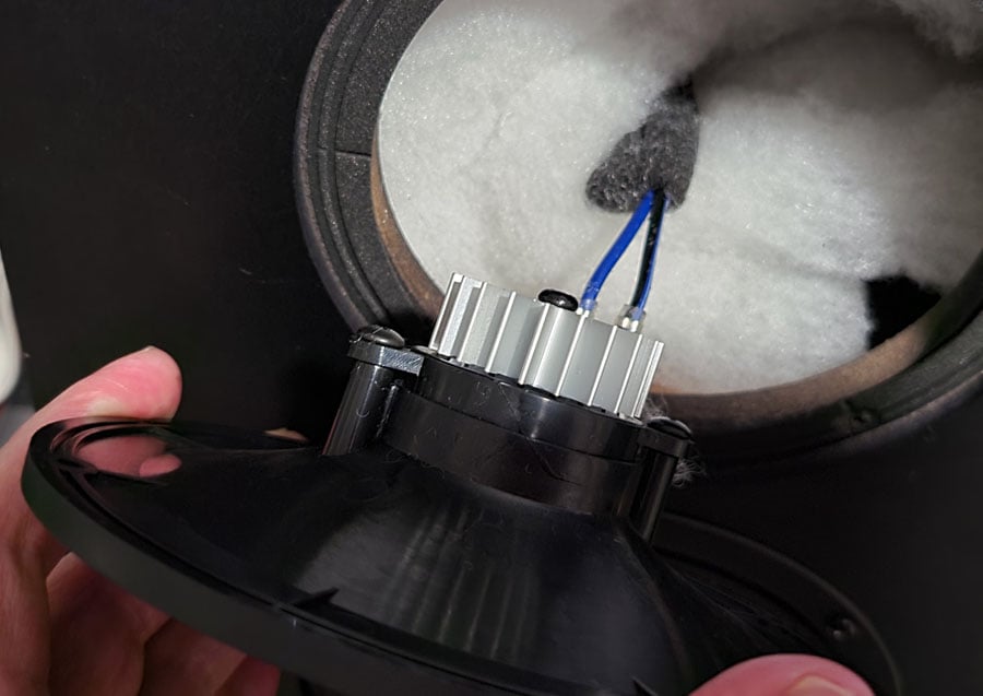

with and canceling the tweeter’s direct radiation. The tweeter has a neodymium
magnet with a surprisingly generous heat sink to keep it minimize thermal
compression typical of these type of designs without adequate heat dissipation
on the tiny but powerful magnet.

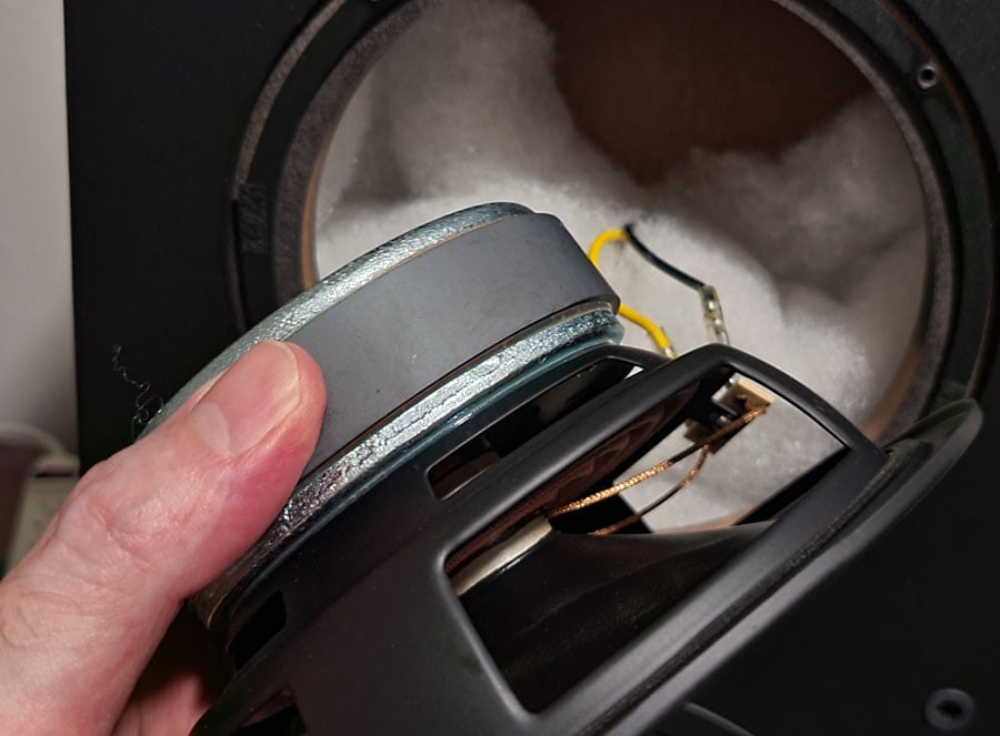

Paradigm SE 8000F Tweeter w heatsink (left) ; Midrange w vented spider (right)

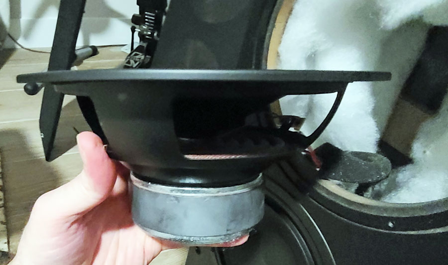

The 6-1/2" mineral-filled polypropylene midrange driver is a vented stamped basket design in its own MDF enclosure amply stuffed with Dacron insulation. Bass is handled by three 8" mineral-filled polypropylene stamped basket bass drivers with substantial motor structures. Their combined surface area is equivalent to a 14” bass driver. The cabinet has dual 3” flared rear ports and is not bi-amp or bi-wireable. The cabinet seems to have sufficient bracing and is heavily insulated. The side and front panels are only ½” thick which is a bit disappointing as I prefer to see thicker front baffles (at least ¾”) to increase rigidity. With that said, the speaker is still substantially heavy weighing in at 1lb short of 70lbs and it stands tall at 46” x 11 ¾” and 17 ¾”. These are not speakers you can easily tuck into a small dorm or guest room (well I managed the later and with some impressive results). The grilles are made of MDF and have mounting pegs, no neodymium magnets for a clean look like many speakers have these days.

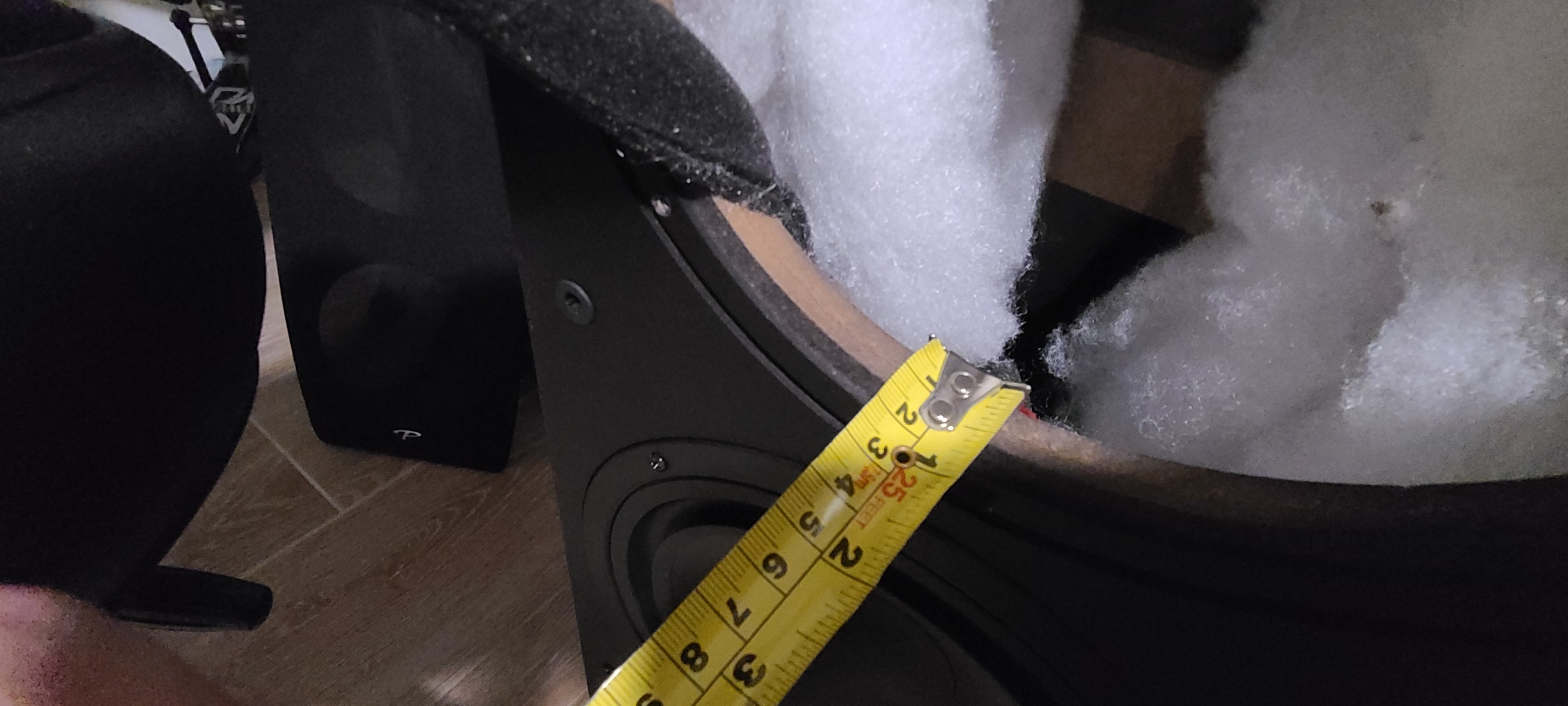

Paradigm SE 8000F Woofer w stamped basket (left) ; Front Baffle 1/2" thick (right)

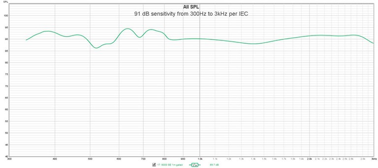

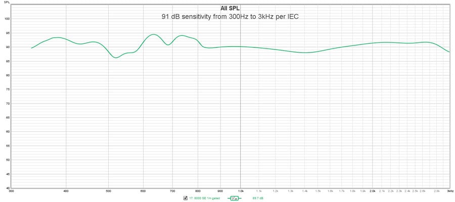

The SE 8000F are rated at frequency response: 45-21,000 Hz (±3dB) with a sensitivity rating of 95 dB (in-room) / 92dB (anechoic) and a continuous power handling of up to 150 watts. I measured the sensitivity at 1-meter in-room per IEC 300Hz to 3kHz at 2.83Vrms and got just shy of 92dB. It was nice not to see Paradigm inflate their sensitivity ratings like some manufacturers.
Paradigm SE 8000F Sensitivity Measurement (2.83Vrms @ 1m from 300Hz to 3kHz, gated)
I was unable to measure this speaker outdoors on a platform like James Larson does in his loudspeaker reviews. However, I did capture an in-room spatial average at 1-meter from 300Hz to 20kHz to get an idea of the voicing of the speaker.

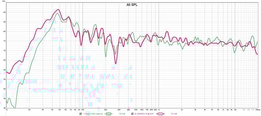

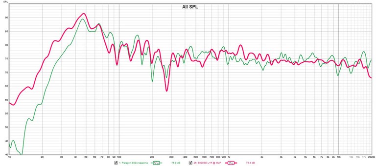

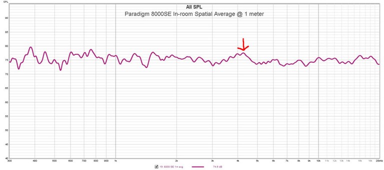

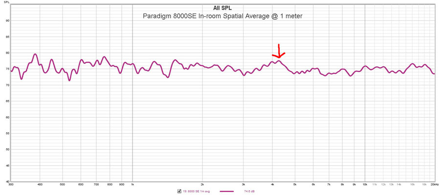

Paradigm SE 8000F In-Room Frequency Response (Spatial Avg @ 1m from 300Hz to 20kHz)
The response looks pretty linear sans the 2-3dB low Q bump I measured at 4kHz below the tweeter axis. Upon closer inspection of a nearfield measurement of each of the drivers, I noted some excessive midrange energy that wasn’t fully filtered by the crossover. This could of course be improved but shouldn’t be a show-stopper for anyone that isn’t in the pursuit of the most measured linear response. This bump disappeared above the tweeter axis, which is how most of my listening was conducted.
Paradigm specs the SE 8000F as having slightly less bass extension than the Premier 800F but my in-room measurements show a much different story.
In-Room Frequency Response of Paradigm SE 8000F (red) ; Premier 800F (green)
I measured the SE 8000F and Premier 800F as a stereo pair at the main listening position to get an idea of tonal characteristics and how the two different speakers couple in my listening room. As you can see in the graph above, the SE 8000F appear to have 10Hz lower bass extension compared to the Premier 800F. I got usable in-room bass extension all the way down to 30Hz on the SE 8000F vs 40Hz on the Premier 800F.

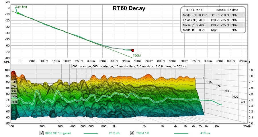

RT60 Decay Time of Audioholics Smarthome Guest Room ( < 500 msec from 100Hz to 20kHz)

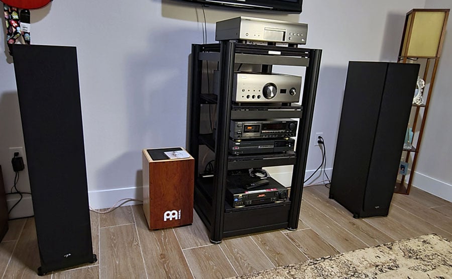

aggressive toe-in and also to keep the grilles on. This is one of the rare
cases where I felt a speaker sounded better with the grilles on. I honestly think I may prefer the cover
