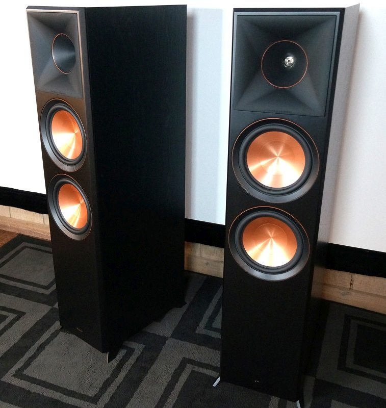

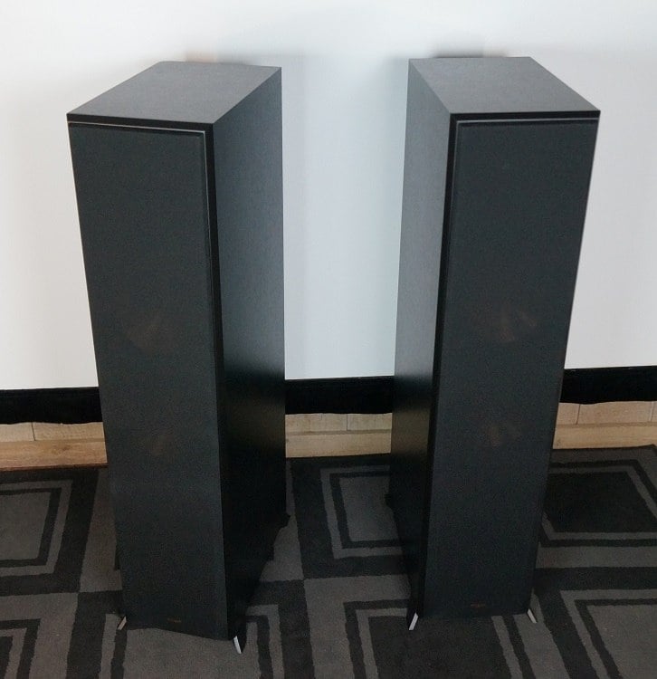

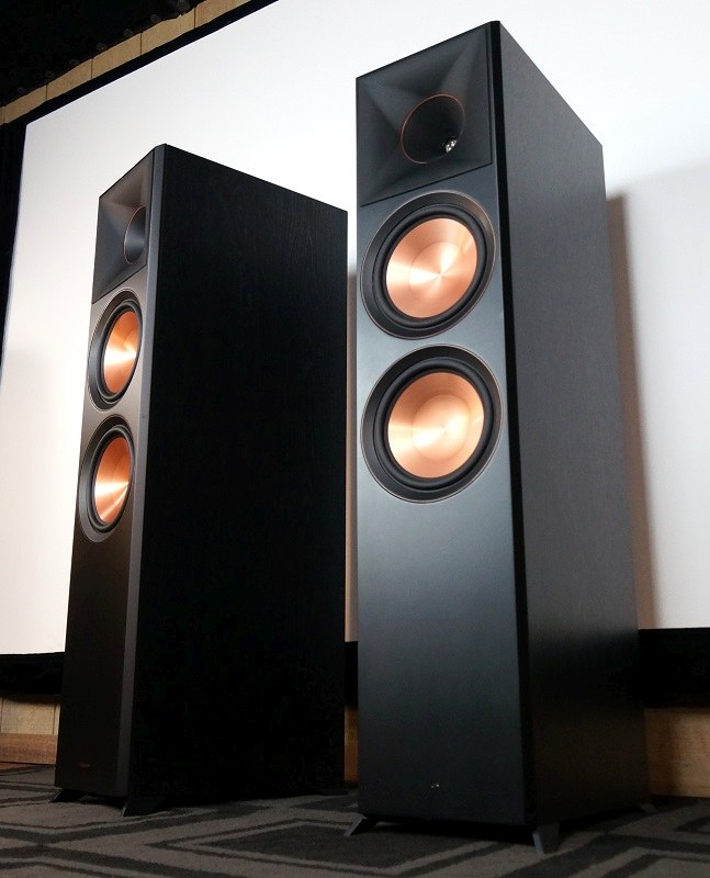

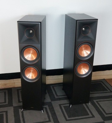

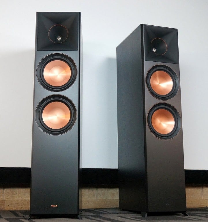

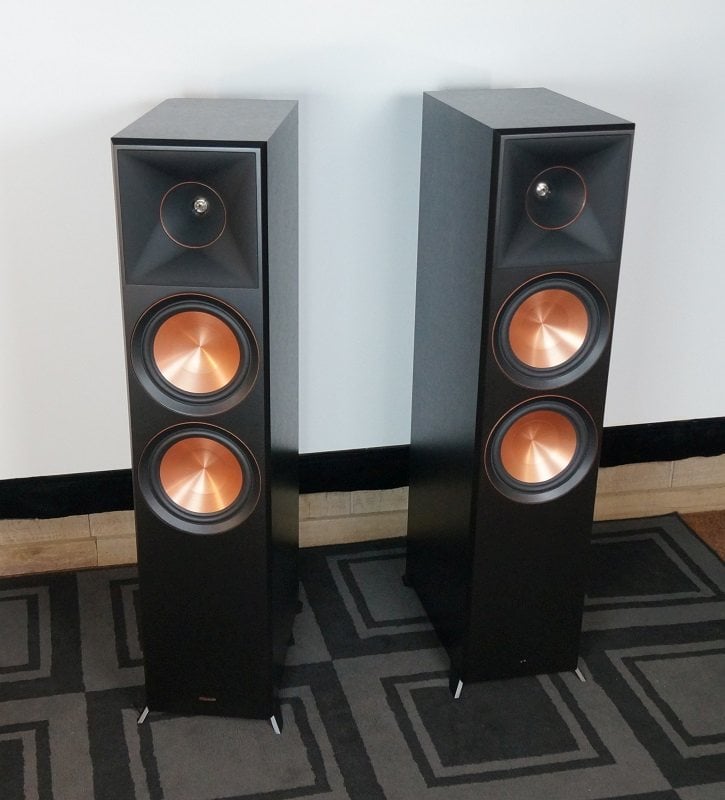

The RP-8000F II is not a small floor-standing speaker, but it isn’t huge either. It can be had in two finishes, ebony or walnut. We received the ebony pair, which has a black woodgrain veneer except for the front baffle which has a satin black finish. The wood grain is really a vinyl imitation, but it is not apparent unless given a very close inspection. The satin black baffle serves as a nice contrast against Klipsch’s trademarked copper metallic cones. The frame of the cones has a copper ring around them, and there is a copper ring within the Tractrix horn; these rings add a nice bit of refinement. There is a slight chamfer around the edges which helps to give the RP-8000F II a slightly softer and sleeker look. There is a copperish Klipsch badge in the lower part of the speaker with or without the grille. The top front of the speaker is almost completely taken up by the waveguide for the tweeter, and the geometry from a squared waveguide to a round one as it moves inward adds an interesting visual element. The grille hides all of this copper, and with the grille on, the RP-8000F II just looks like a tall black box with a slight backward lean. The feet are black aluminum rails that give the speaker its slight backward tilt.
8000 II grille5   8000 II pair4
Style-wise, there hasn’t been much change over the last version except that the waveguide is now a bit larger. Unfortunately, the RP-8000F II is not available in a gloss finish unlike the original which was a pretty slick-looking speaker. A gloss finish might have added two or three hundred dollars per speaker, but it would have been a nice option to have. Overall, the RP-8000F II is not a bad-looking speaker at all, and the copper accents help to give it some personality.

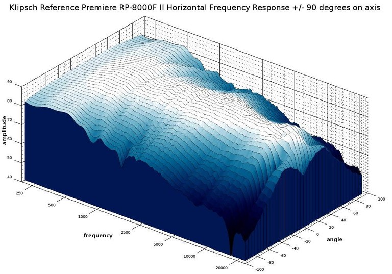

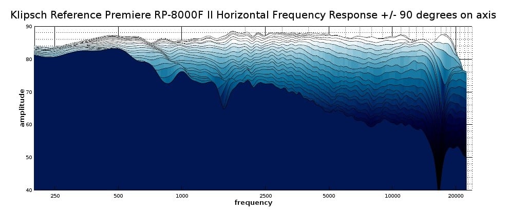

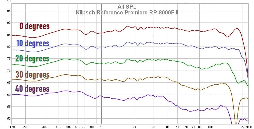

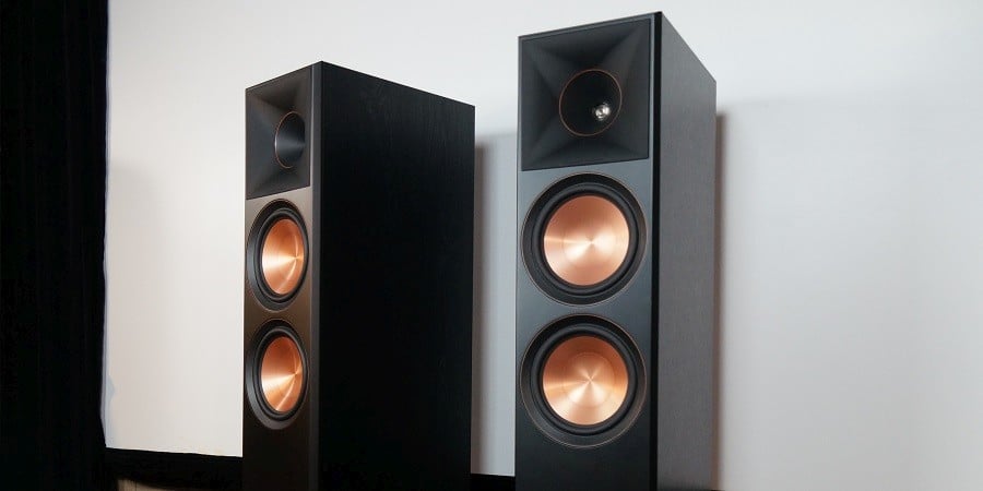

At a glance, the basic overall design of the RP-8000F II looks almost exactly like the original: a vented enclosure of the same size and two 8” Ceramatallic woofers and a horn-loaded tweeter. But while the RP-8000F II has many similarities to the original RP-8000F in design, when we take a closer look, there are some notable differences that are bound to have an effect on the resultant sound performance. However, for a description of the similarities, I will just borrow passages from the review of the original where things have not changed. Such is the case with the horn-loaded tweeter.

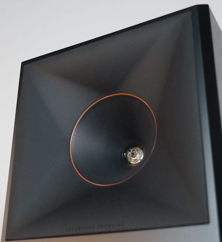

In horn-loaded loudspeakers, the geometry of the horn shape plays a big role in determining its sound character. The RP-8000F II uses what Klipsch calls a “Hybrid Cross-Section Expanded Tractrix” horn. A Tractrix is a geometrical term that signifies “the Catenary Involute described by a point initially on the vertex” to use one (very technical) definition. It is a shape that is used in loudspeaker horns under the assumption that the emerging pressure waves expand out from the transducer diaphragm as a spherical wavefront. As the wavefront exits the horn, it will constantly be at a perpendicular angle to the edges of the horn. This supposedly helps to reduce horn-related anomalies such as odd reflections in the horn itself and unwanted diffraction effects.
8000 II tweeter
The RP-8000F II horn is divided into two sections by the copper ring embedded into the horn. The inner section is a conical plastic piece that serves as the throat of the horn, and the outer section, the mouth of the horn, is a softer silicone piece that takes on a more orthogonal shape. The softer silicone material of the mouth is used to avoid bell resonances in the horn. The throat of the horn is a round conical shape in order to reduce early diffractions as the soundwave leaves the tweeter diaphragm. The squarish mouth shape governs its dispersion pattern. A 1” titanium dome tweeter is used to load the horn, and it uses what Klipsch calls the ‘Linear Travel Suspension’ system which is a carefully designed suspension that allows for larger excursions of the moving assembly before the suspension thwarts linear motion thereby incurring distortion. Titanium seems like a natural choice for the diaphragm material since the horn-loading and lower crossover point put excursion demands on the tweeter that might be more than softer dome types such as fabric could withstand without physically deforming. The rear chamber of the tweeter is vented to allow backwave energy to better dissipate instead of being reflected back into the diaphragm, which would also increase distortion. The tweeter motor uses a ferrite magnet instead of neodymium, and this can help reduce the effects of thermal compression since the larger surface area is able to radiate more heat than the smaller surface area of a neodymium motor.
One difference between the RP-8000F II horn and the original is that Klipsch has widened the horn so that the mouth almost reaches the edges of the front baffle. The larger horn should help to lower the frequency where the horn can control the directivity of the sound. It should also reduce any diffraction effects coming from the front baffle of the cabinet.
8000 II cone

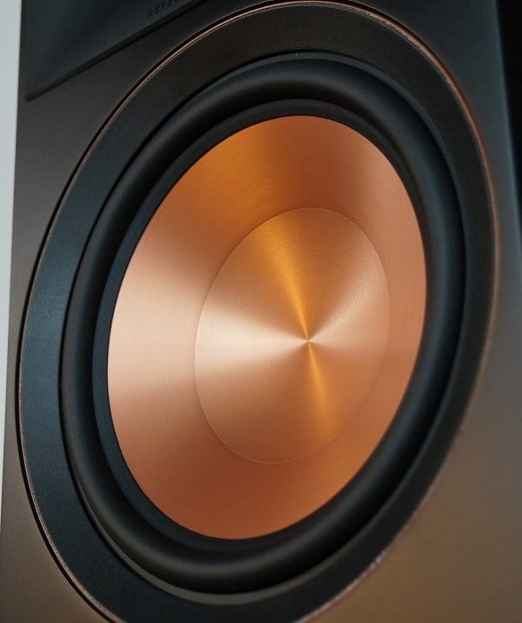

Two large 8” woofers take the bass duties as well as much of the midrange. Klipsch has named the woofer’s cone composition ‘Cerametallic.’ This seems to be an aluminum layer that has been hard anodized to form a ceramic coating which is stiffer than the aluminum substrate and also dyed a copper color. The ceramic coating makes the cone stiffer than pure aluminum thereby pushing breakup modes to higher frequencies that are easier to filter out by a crossover circuit. The aluminum layer provides a light but strong platform for the ceramic layer and also provides additional damping due to the differing densities of the materials. I can’t be sure of how well it works versus a plain aluminum cone, but I am sure Klipsch would not go through the trouble of anodizing all of their cones if the effects were insignificant.
One improvement Klipsch has done to the woofers over the previous generation Reference Premiere speakers is the addition of shorting rings. As their name implies, shorting rings short out the induced current that is caused by the voice coil’s motion in the magnetic field. In loudspeaker drivers, we just want the motion of the voice coil without the side effect of the induced current. This induced current reduces the bandwidth of the driver by making it less sensitive in upper frequencies, and it also increases even-order harmonic distortion. So the addition of the shorting rings should increase the upper-frequency sensitivity and reduce distortion.

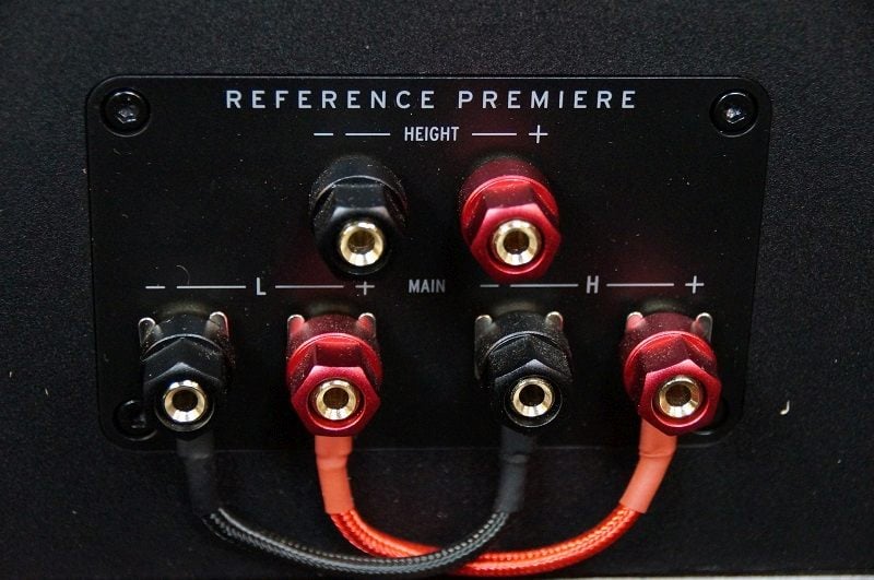

8000 II binding posts

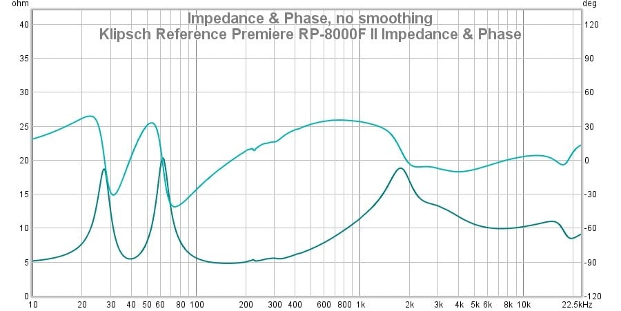

Klipsch specifies a 1,630Hz crossover frequency between the tweeter and woofers which is a bit lower than the previous generation, and this may be due to the larger horn allowing the tweeter to play a bit lower. That crossover frequency is right around where many 8” cones would normally start to narrow dispersion, so it looks like a smart handoff point to the tweeter. There is a fourth-order electrical high-pass filter on the tweeter and a second-order low-pass filter on the woofers. The RP-8000F II has dual binding posts that can be bi-amped or bi-wired. I don’t think that is justified in this speaker, and it probably shouldn’t be used in a typical setup. With a listed power-handling spec of 150 watts continuous, these speakers wouldn’t really handle much more wattage than a mid-level AVR can put out, providing that the power isn’t spread out over nine other speakers in a surround sound system. Klipsch has also put in a pass-through binding post for an Atmos module to be easily added to the top of the speaker without a wire trail. While that probably didn’t add too much more cost to the speaker, I don’t think it was a worthwhile inclusion since most Atmos module speakers are very poorly designed and are not worth adding to any system, but that is a rant for another article.

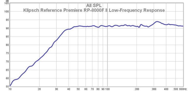

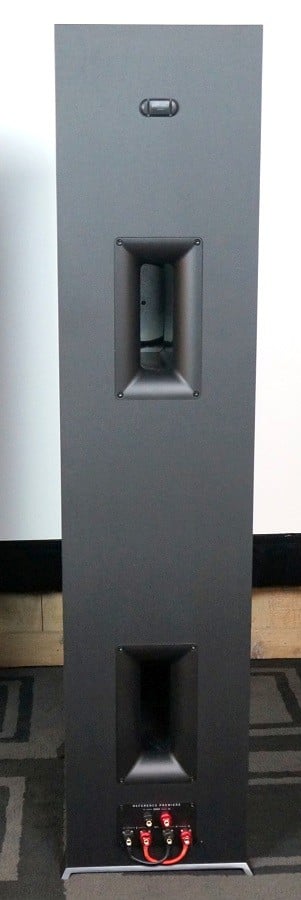

8000 II rearThe cabinet still uses ¾” thick MDF paneling and bracing like the previous iteration, but it has had a lot of internal redesign over the previous generation. One big change is that each of the woofers is given its own compartment that is sealed off from the rest of the speaker. Each of these compartments has its own port. Since that subdivides the cabinet into two compartments, the modal frequencies of those chambers are raised and so no longer have as much bandwidth. Panel resonance also becomes more easily addressable by basic bracing and internal damping, and there is a healthy amount of Dacron-type stuffing on the interior. The internal bracing network is fairly complex, and since there are now solid braces throughout the enclosure, this should be a pretty inert cabinet.
The ports are still a Tractrix shape seen in the last generation of Reference Premiere speakers. This is pretty silly since the reason that the tweeter waveguide uses a Tractrix shape has nothing to do with how a loudspeaker port works. I think Klipsch just likes putting their branded design cues all over their products, but there is no reason why a Tractrix port would work better than a standard flared tube that I could know of. It is essentially just a flared slot port with a silly marketing name. Nonetheless, it probably works just fine for its intended purpose. The addition of the second port may increase the level of port-generated output before turbulence sets in.
The feet are extrusions on an aluminum rail. They are pretty solid and give the speakers a nicely stable placement on the floor. Users should be careful about moving the speakers on hardwood flooring, because these feet could scratch that type of flooring if the speaker is slid on a floor instead of being lifted up and moved. Klipsch might want to consider adding some kind of soft-padding accessory for the bottom of the feet for those with hardwood flooring. The grille uses magnetic adhesion and is simply some acoustically transparent fabric draped over a thin plastic frame. Unlike more substantial grilles, it doesn’t cause much diffraction from the frame, although it wouldn’t offer much protection from heavy objects coming at the front of the speaker with any significant force.
The big changes over the original RP-8000F look to be the enclosure re-arrangement, the addition of the second port, improved drivers, and the larger waveguide. While the speaker looks very similar to the previous version, these changes look to be more of a redesign than just a quick refresh. But, much like the original, the RP-8000F II still looks to be a formidable speaker with some serious dynamic range. Let’s see how it does in practice…

In my 24’ by 13’ (approximately) listening room, I set up the speakers with a few feet of stand-off distances between the back wall and sidewall and equal distance between speakers and listening position. After some experimentation, I angled the speakers with a time-intensity toe-in where the speakers’ aim crosses in front of my listening position. The listening distance from the speakers was about 9 feet. No equalization was used and no subwoofers were used.

The RP-8000F II could image Avi’s voice with pinpoint accuracy, especially after I positioned the speakers for a time-intensity toe-in where their aim crosses in front of my listening position. This is where I had the best results for imaging with the original RP-8000F speakers on account of their narrow dispersion. This type of placement mainly benefits listeners who do not have an equidistant listening position from both speakers, but it can still yield a more precise image for those who are in the ‘sweet spot’ with equal distances between the speakers. (For those who want to know more about time-intensity trading, Audioholics discusses it in this Livestream presentation: Finding the Loudspeaker Sweet Spot). I tried the RP-8000F IIs with no toe-in as well as a toe-in that angled them to face my listening position directly. With no angling, the speakers could still image well but it was broader imaging and less precise. Angling the speakers to face the listener directly tightened up the imaging, but angling the speakers inward even further really sharpened the imaging. As I angled the speakers inward, the soundstage did shrink a bit since there were fewer acoustic reflections from the speaker to its closest sidewall. I decided that the trade-off of a broader soundstage for more precise imaging was worth it for these particular speakers.

With two 8” woofers, I didn’t doubt that the RP-8000F IIs could do bass but listening to “Fight! Fight! Fight!” at a loud level proved they could do it without shirking the dynamic range. While they didn’t dig quite as deep as a subwoofer, they did have the mid-bass punch one would have expected from a sub. The treble and upper midrange had a snap that could make me wince at a loud enough level. A track that serves as a lesson in wide dynamics is “ZX Rhythm” with its bouts of percussion and bass separated by a gentle reverb. The following track, an absolute bruiser on bass titled “Zero Face,” made the woofers visibly move for its duration, but I never heard anything resembling distortion or compression from the speakers. The RP-8000F II could easily get louder than I could tolerate, so I wasn’t blasting them at maximum levels, but I was playing them at a level that most people seldom would, and they didn’t break a sweat. If you are looking for speakers that could sound good as an intimate two-channel system as well as handle a house party, these are a great option. The RP-8000F II is a high-fidelity headbanger’s choice.
