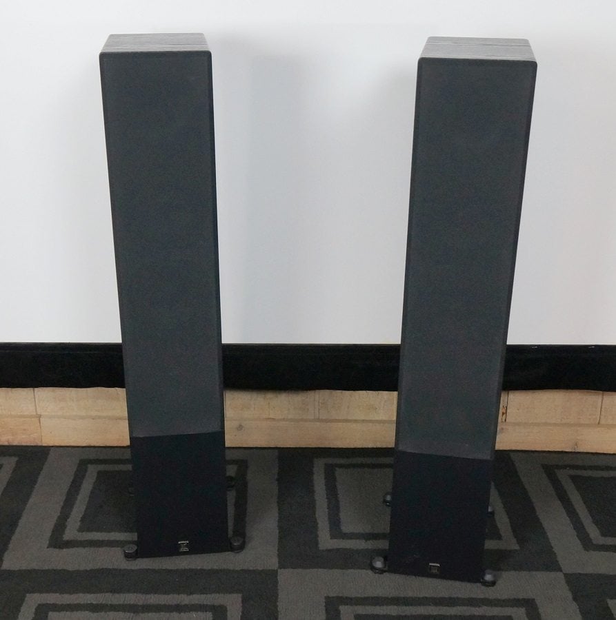

Packing and Appearance
The speakers arrived to me individually boxed and not packed as a pair. Inside the boxes, the speakers were packed in a series of polyethylene foam blocks that held not just on the top and bottom of the boxes but the middle as well. The speakers themselves were wrapped in a cotton drawstring sack to protect them against moisture and scuffs, and the grille was covered in a plastic bag. This is good packing for speakers at this pricing, and it should enable them to survive the rigors of typical parcel shipping.

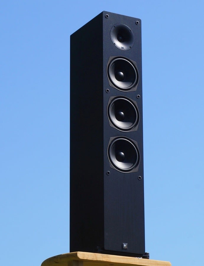

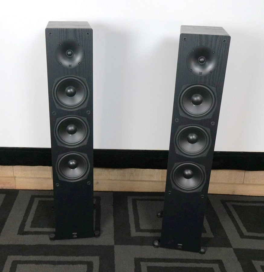

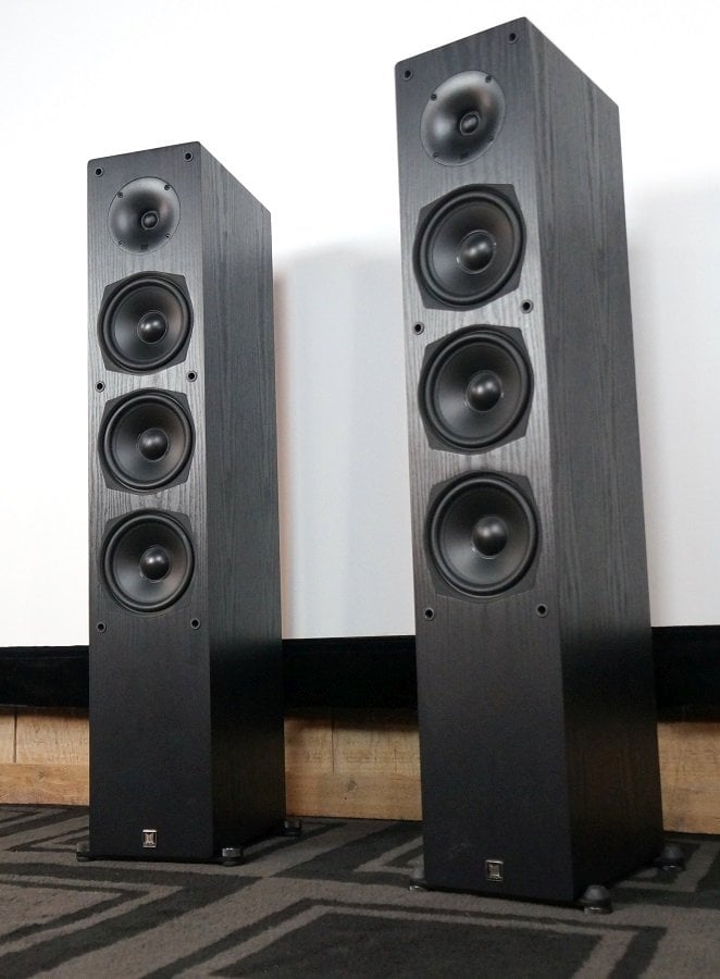

Once unboxed, the Audition T5 Towers present themselves as fairly innocuous and standard-looking towers. They don’t look bad but they don’t look ravishingly beautiful either, not that anyone should expect gorgeous looks at their pricing. At 35” high with a 6.5” width, they are somewhat small tower speakers, and that will help a lot in making them a minor presence in-room. The finish is a fake black oak vinyl that can be seen in many budget loudspeakers and subs. It isn’t bad and is fairly durable and doesn’t show fingerprints easily. The lengthwise edges have a slight rounding, but even that slight rounding goes a long way in making them seem less boxy. The T5 speakers use black metal outriggers for footing, and this does help to make them look more substantial than if they had simple cones for feet like we might expect of low-cost floor-standers.
The grilles hide the drivers completely and reduce the Audition speakers to minimalism, so those who would rather have the speakers go unnoticed have a good option in that regard. The grilles themselves have a slight beveling around the edges so they are not totally flat in appearance. With grilles removed, we see three matte black 5” woofers and a tweeter mounted in a shallow waveguide. They look like a typical driver layout and are not especially noteworthy. The Audition T5 speakers look like pretty standard speakers and are almost generic in appearance. It’s as if someone told an AI image generator to produce an image with the prompt “typical tower speaker.” They look fine and probably a bit better than one would expect given their price.

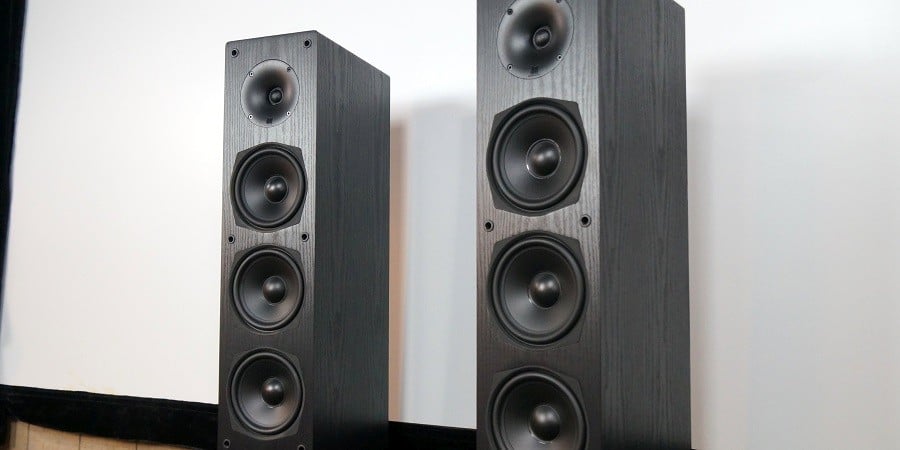

As budget loudspeakers, the Audition T5s are not especially complex, but they do have some noteworthy design features that are worth discussing. As we said in the appearance section, this is not a huge speaker and only has a 35” height, putting the tweeter at a 31.5” height. This is likely at or lower than ear-level for most people’s listening position. However, the design of these tweeters looks like they could be good for a wide vertical angle of dispersion. At 23.4 lbs. (or 10.6kg for the saner parts of the world), it is not a heavyweight speaker, and that makes it very easy to deal with physically.

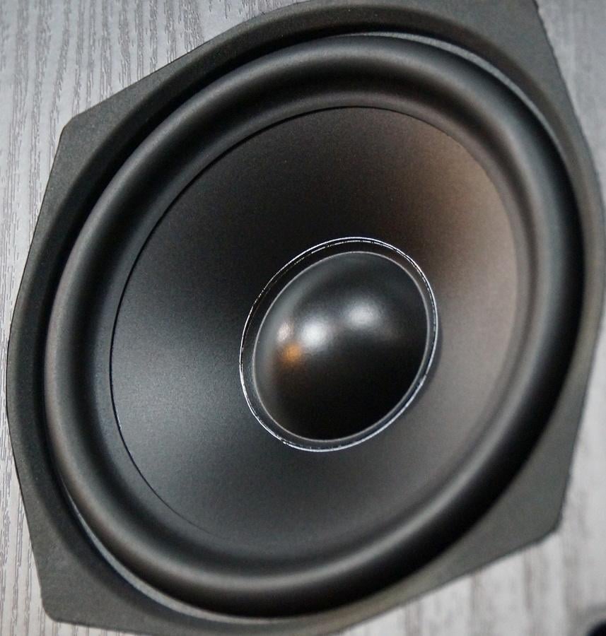

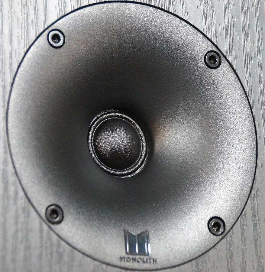

Let’s start our discussion of the particulars at the top of the frequency band with the tweeter. The tweeter is a 20mm (approx. ⅘” diameter) silk dome mounted in a shallow spherical waveguide. It is driven by a motor using a small neodymium magnet, but most of the assembly is shrouded in plastic, so it's hard to discern any more details about its construction. Most of what will determine its performance wouldn’t be visible to the naked eye anyway. However, with a somewhat small diameter, this tweeter should be capable of high treble frequencies before any break-up or bending modes occur, and the soft silk diaphragm should help to damp any break-up harshness anyway.
The tweeter is accompanied by three 5.5” woofers in a 2.5-way configuration, so the upper woofer plays all the way up to the crossover frequency of the tweeter in addition to bass frequencies while the lower two woofers are filtered to play bass frequencies only. The advantage of this 2.5-way design is that low-frequency headroom is increased with the additional woofer. Another advantage of a 2.5-way speaker is the gain in efficiency in low frequencies that can help compensate for baffle step loss. Baffle step loss is the loss of forward-traveling acoustic energy where the lower frequencies radiate out omnidirectionally instead of in front of the speaker. That means that if lower frequencies are emitted out at the same overall energy level as the rest of the range, the speaker might sound thin because much of that energy is not traveling toward the listener but rather in every other direction. By allowing the midrange drivers to tackle low-frequencies as well as mids, it can help to compensate for that loss and give the speaker a fuller sound without resorting to tapering down upper-frequency sensitivity in the crossover circuit.
Three 5.5” woofers have about the same surface area as an 8” cone, so the T5 should be capable of a fair amount of bass punch. Their cones are made from polypropylene which is a very inexpensive but highly effective material on account of its light weight, stiffness, and intrinsic damping properties. The lower two woofers are low-passed at 220Hz using a 1st-order filter, and the upper woofer is low-passed at 2.4kHz using a 2nd-order filter. The tweeter is high-passed using a 3rd-order filter, but I have to guess that includes the acoustic roll-off since a full 3rd-order electric filter would be a tall order for a speaker at such low pricing. These crossover frequencies seem sensible given the Audition T5’s design, but we will see how well they truly integrate later on in our measurements section.

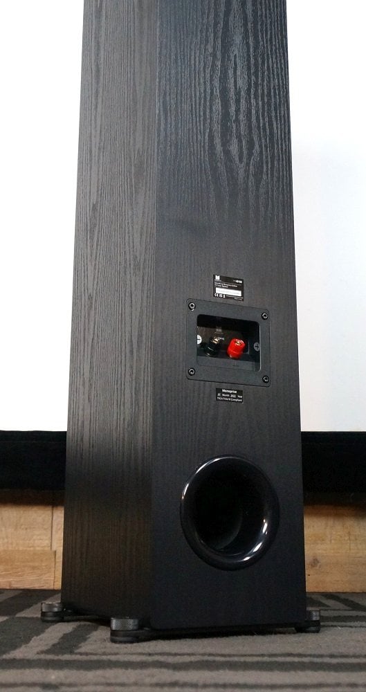

about scratching it. Wire connectivity is done through some simple 5-way
binding posts within a terminal cup; it ain’t fancy but it works fine. The
Audition T5 is a ported speaker and has a dual-flared rear-mounted port that
has a 5 ⅞” depth with a 2 ⅞” diameter. That is a fairly large port for a small
tower speaker, and with those port dimensions, I expect that it would produce a
good amount of output although not with a super-low tuning frequency.

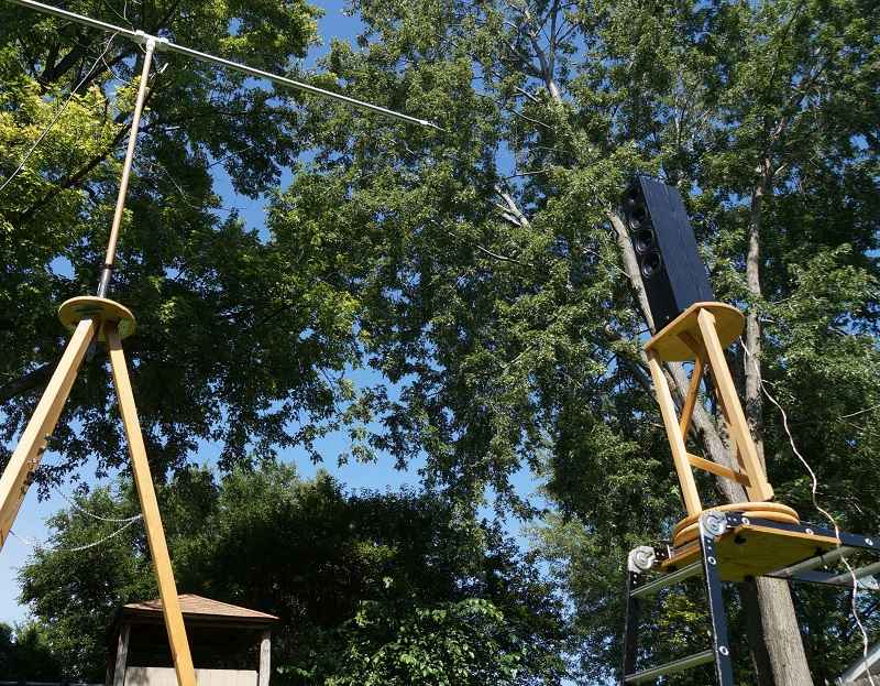

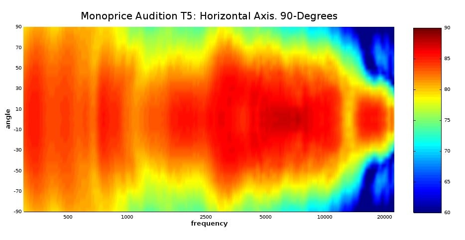

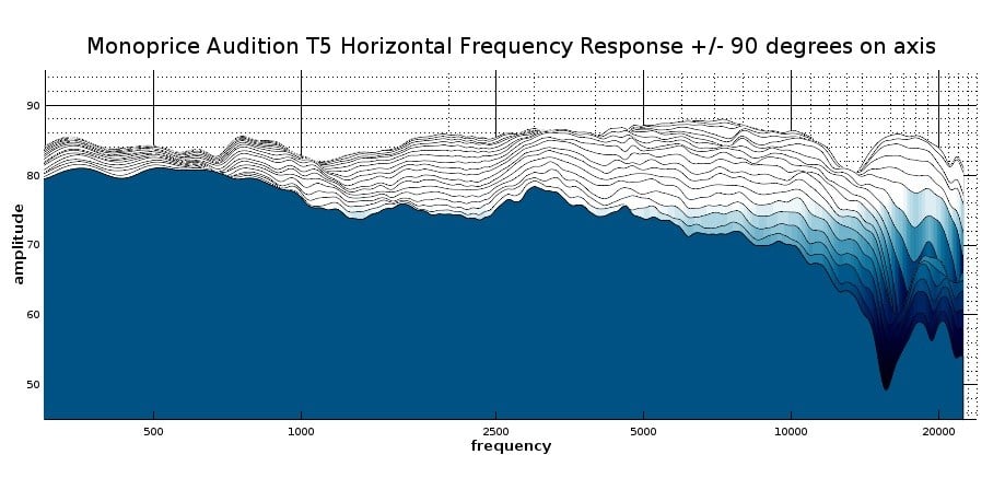

The Monoprice Audition T5 speakers were measured in free-air at a height of 7.5 feet at a 2-meter distance from the microphone, with the microphone raised to be level with and aimed at the tweeter center. The measurements were gated at 8 milliseconds. In this time window, some resolution is lost below 400 Hz and accuracy is completely lost below 200 Hz. Measurements have been smoothed at a 1/24 octave resolution.

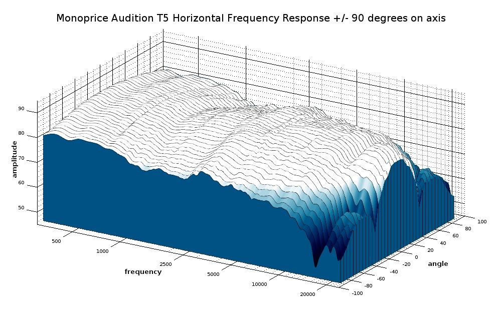

The above graphs depict the Audition T5’s direct-axis and horizontal dispersion out to a 90-degree angle in five-degree increments. Information on how to interpret these graphs can be read in our article, Understanding Loudspeaker Measurements Part II. One immediately noticeable aspect of this graph that correlates to my listening experience was the elevated treble. Nearly the entire treble range is two to three dB hot with respect to lower ranges. This makes for a bright loudspeaker, of course. Outside of the hot tweeter, there isn’t much to complain about. The midrange is a tad rocky, but one cannot expect perfection at this pricing, and I didn’t notice any problems with the midrange in my own listening. We can see an on-axis dip between 13kHz to 14kHz, but that is too high in frequency to be a tonal concern, and if anything, it might help to take a bit of the edge off the treble anyway. It doesn’t carry over to off-axis frequencies which leads me to believe it is due to a waveguide reflection cancellation. I noted in my listening that although this speaker was bright, I didn’t think it was especially sibilant, and the reason may be that the entire treble range is elevated instead of just the 4kHz to 8kHz range. We do see the most excess energy in that range, especially above 6kHz, and this may be what I heard as an over-emphasis on ‘S’ sounds. Overall, what we have here is a bright speaker but not a scorchingly hot one. It doesn’t sound awful, but padding the tweeter an additional two to three dB would have made it better, to my ears at least.
The above polar map shows the same information in the preceding graphs but depicts it in a way that can offer new insight regarding these speakers’ behavior. Instead of using individual raised lines to illustrate amplitude, polar maps use color to portray amplitude, and this allows the use of a purely angle/frequency axis perspective. The advantage of these graphs is they can let us see broader trends of the speaker’s dispersion behavior more easily. More information about interpreting this graph can be read in our article: Understanding Loudspeaker Measurements Part II.
The first thing to note is the wide angle of dispersion of the tweeter relative to the woofer. We can see where the tweeter kicks in by its broader dispersion above 2.5kHz. If the tweeter had been toned down a bit, we might have had better directivity matching, at least at the crossover point. Outside of the directivity mismatch between the tweeter and midwoofer, we do some waist banding just above 1kHz, although it is fairly mild, and I don’t think it would impart much coloration to the sound unless the listener was at a 50-degree angle with respect to the speaker for some reason. The overall breadth of acoustic energy coming from the speaker looks to occur within a 50-degree angle. Within that angle, the response looks to be roughly consistent, so these speakers have a fairly wide dispersion on the whole, meaning they will retain similar tonality over a wide listening area. The tweeter does start to beam a bit above 15kHz, but that is too high in frequency to matter for most listeners, and it still holds a +/-20-degree spread which is more than what many dome tweeters can manage at such high frequencies.

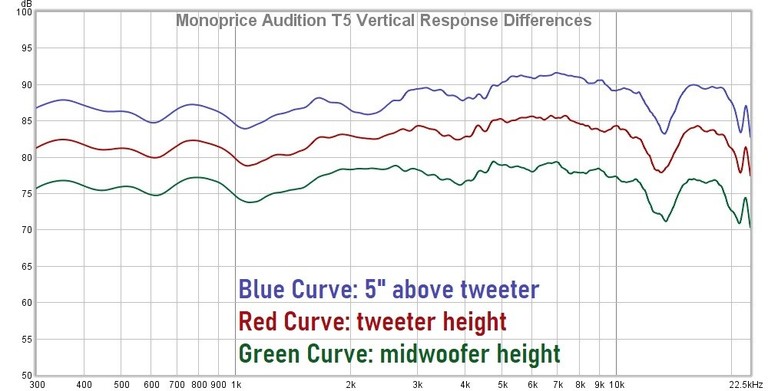

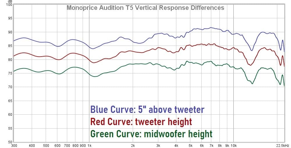

The above graph is a sampling of some of the vertical angle responses at and around the on-axis angle. The tweeter center of the Audition T5 has a 31.5” height. That is relatively low compared to the tweeter height of most tower speakers, but the T5s are somewhat short in height. Unfortunately, this puts the tweeter below the ears of many listening positions, and that angle is where the treble is most pronounced. At tweeter height and below it does bring the treble level down with respect to lower frequencies, but this is at a rather low altitude. Users could ameliorate this by tipping the speaker up by a few degrees from placing something underneath the front feet, although that is not a solution I would resort to if it caused any stability issues. I tried listening at midwoofer height by placing the towers on 10” blocks that elevated the midwoofer to my ear height. Listening at tweeter or midwoofer height doesn’t tame the tweeter by much, but it seems to give the speakers a slightly fuller sound, perhaps by filling in the upper midrange/lower treble more relative to the levels above 4kHz. For those seeking to tame the treble, a much better solution would be to just equalize it.

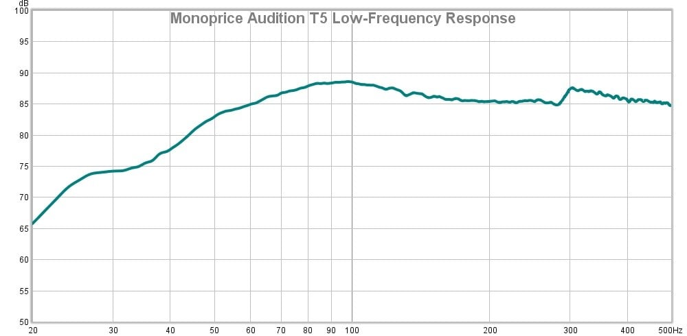

The above graph shows the Audition T5’s low-frequency response captured using groundplane measurements (where the speaker and microphone are on the ground at a 2-meter distance in a wide-open area). Earlier in my listening sessions, I complained of the somewhat thick bass, and I would attribute it to the hump centered around 90Hz to 100Hz. It isn’t severe, but it is certainly audible. Again, this would be easy to EQ, so this characteristic would not be difficult to change- if the user wished to. As I said before, a lot of people enjoy elevated bass, and if they used a room correction program like Audyssey, the EQ curve that would be applied might not even be preferable to many people, at least in low frequencies. Low-frequency extension is good for a smaller tower speaker. In my own room, which does not get much low-frequency room gain, I had a strong response down to 40Hz- not bad considering the size of these speakers.

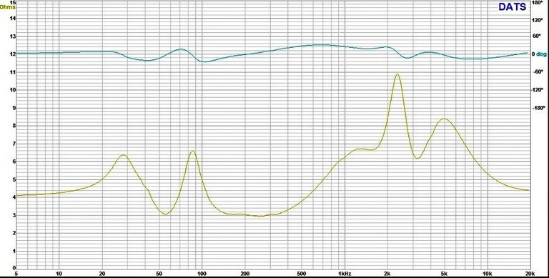

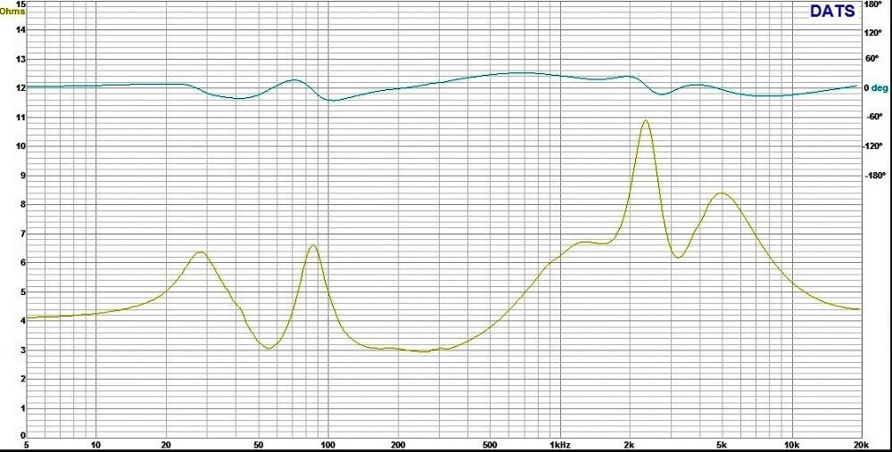

The above graph shows the electrical behavior of the Audition T5. Monoprice specifies it to be nominal 4 ohms, and that is about right. The impedance does dip down to 3 ohms for some critical regions: not ideal for a budget speaker, but the reality is that most AVRs will handle this speaker fine. At least the phase angle doesn’t seem very steep in these bands. At high volumes for long periods, cheaper amps might get hot but not likely to the point of auto-shutdown for most users. If you are running the system hard for a prolonged period with a cheap AVR, it’s possible that it could trip thermal limits of the AVR. I measured sensitivity at 88.1dB (2.83Vrms @ 1m) which is about 1dB higher than Monoprice’s spec. That is around what one would expect for a speaker like this, and it should be OK in achieving loud volumes without needing a ton of power.
