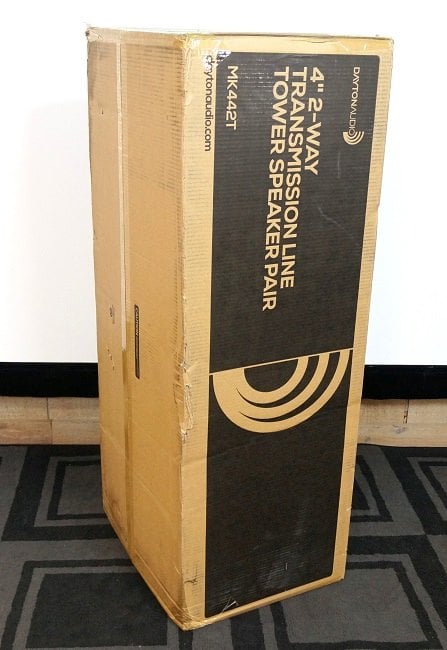

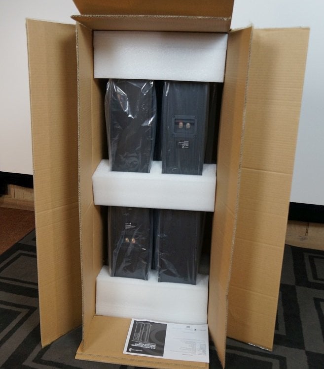

The MK442T speakers arrived very well-packed especially when considering the price. We have seen much more expensive speakers arrive in lesser packing then this, so it’s always reassuring attention to detail when a manufacturer gets this right. The speakers come double-boxed with sturdy polyethylene foam blocks holding the speakers at the top, bottom, and middle. Plastic wrapping protects the speakers from moisture. These speakers are well-packed enough to take the inevitably brutal shipping treatment that pretty much all the major parcel delivery businesses are known for.

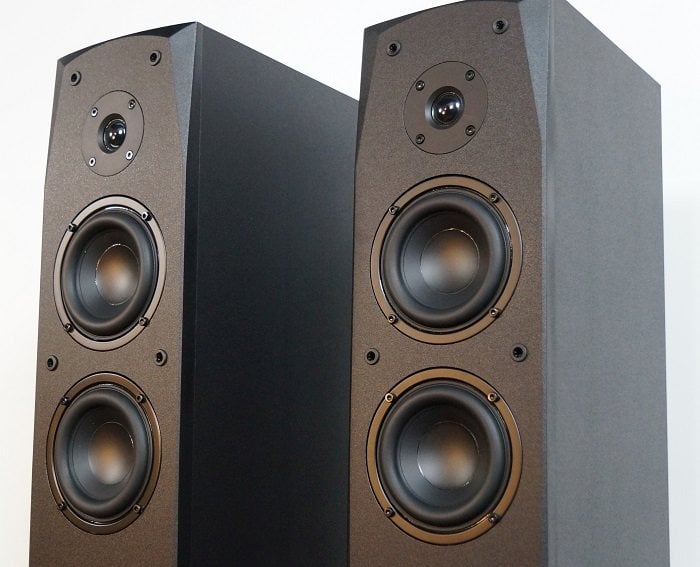

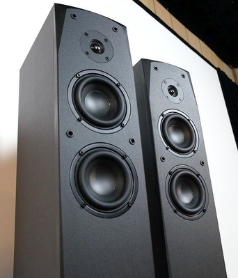

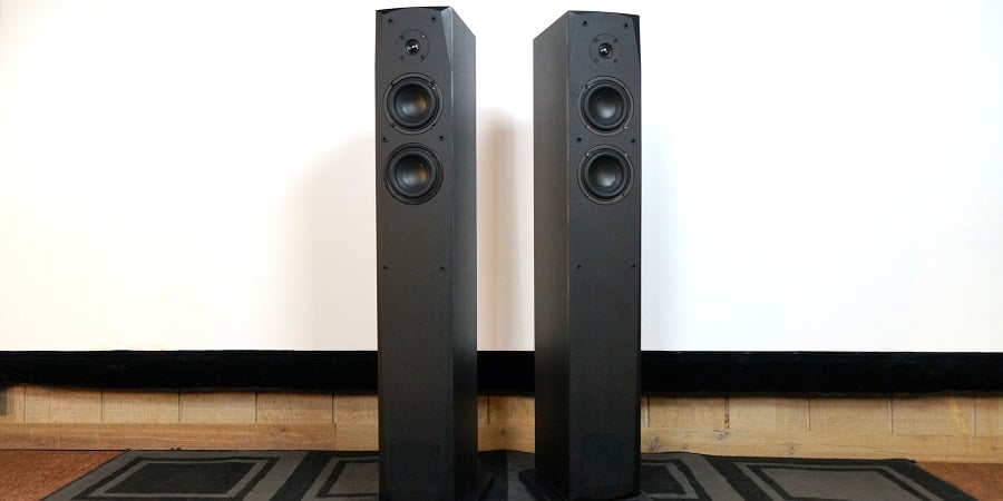

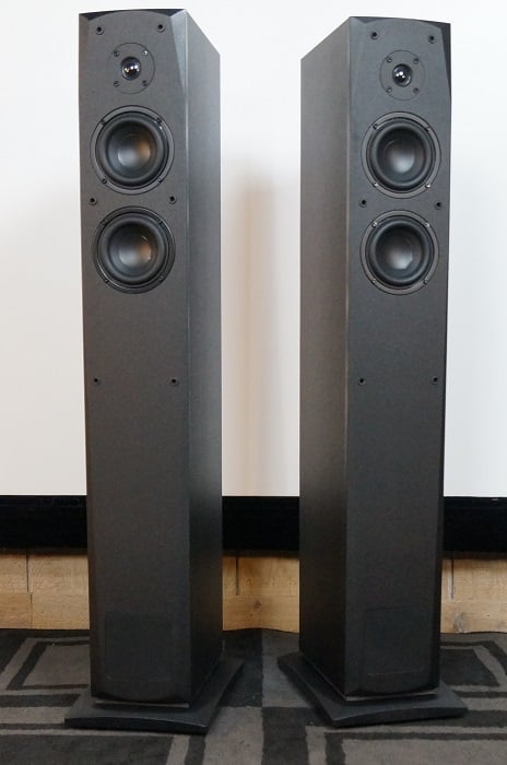

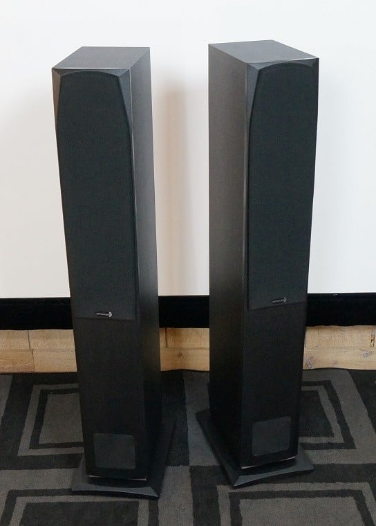

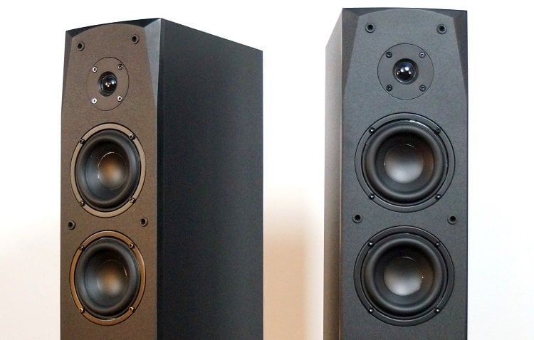

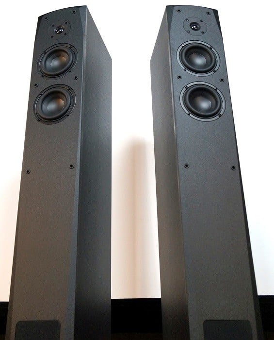

Once unpacked, two nice looking, and, dare I say, attractive speakers emerge. The aesthetic norm for floor-standing speakers in this price range tends to be merely utilitarian, but the MK442Ts are actually handsome speakers and should fit in the decors of most homes. One aspect that helps in this regard is that they are relatively narrow tower loudspeakers and so do not draw as much attention to themselves as would a more regular-sized tower speaker. They have a textured black vinyl wrap like so many other speakers use these days, but it isn’t bad and it’s a good deal sleeker than basic matte black. Personally, I prefer this finish over the faux-wood vinyl wraps that are sometimes seen in low-budget speakers. The tweeter and woofers are relatively nice looking as tweeters and woofers go, and the beveled edges at the top and bottom of the cabinet go a long way toward bringing style to these budget speakers. The speaker rests on a plinth to give it stability, and the plinth itself has some beveling which adds a touch of class to the MK442Ts. At a glance alone, I wouldn’t guess that these speakers were as inexpensive as they are. Dayton Audio has done a great job in the industrial design department here.

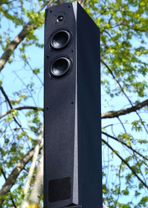

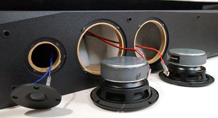

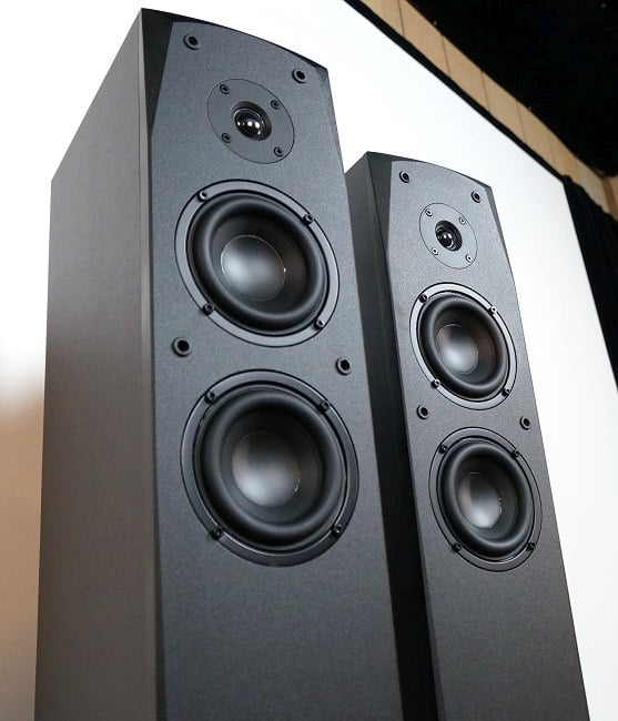

The Dayton Audio MK442T is a two-way floor-standing speaker using two 4” bass drivers and a ¾” dome tweeter. As mentioned, the cabinet uses a transmission line to supplement the low frequencies instead of the typical port that you would expect to see in a speaker in this price class. The drivers used in the MK442T are the same as that used in the MK402 and MK442. Although the woofers are relatively small in diameter, they are serious performers. I will not go over all the details of their design since that was covered extensively in our review of the MK402/MK442. Suffice it to say they are of a higher-quality construction than one would expect to see in such a low-priced speaker. The same is true of the tweeter.

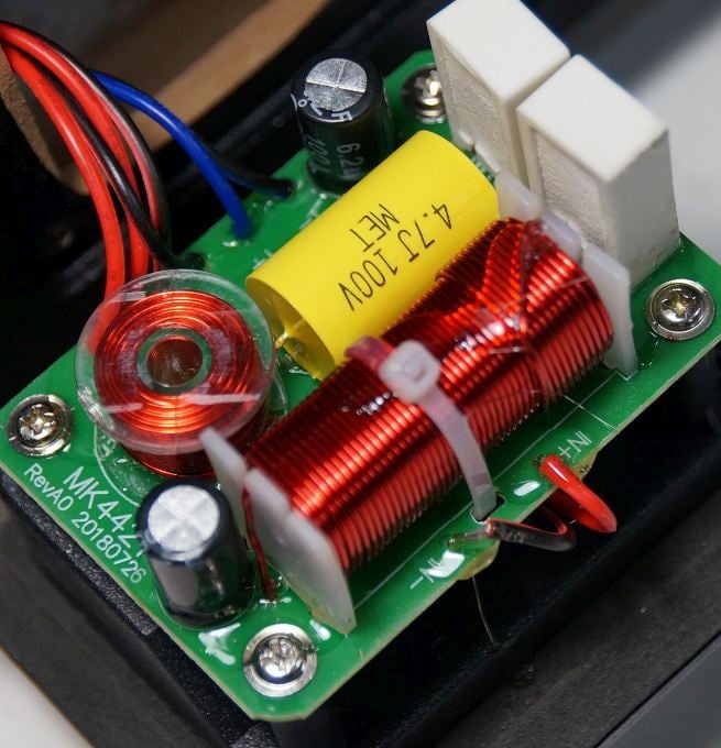

The crossover is a 7-element piece using three capacitors, two resistors, an one air-core and one iron-core inductor. The spec’d frequency is 3kHz with a 2nd-order low-pass and 3rd-order high-pass acoustical slopes. As with other aspects of the MK442T’s design, that is a much more substantial crossover than one expects to find at this price point. The crossover is mounted on the back of the cup for the speaker terminals, which uses a 5-way binding post- another feature not commonly seen in speakers of this price class.

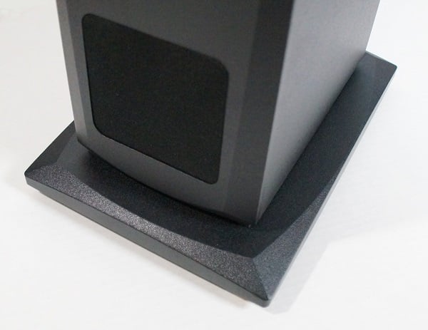

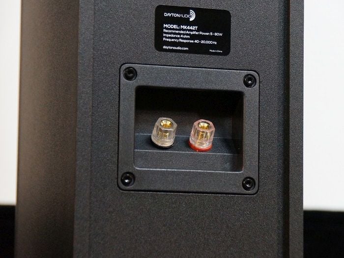

442T rear    442T base

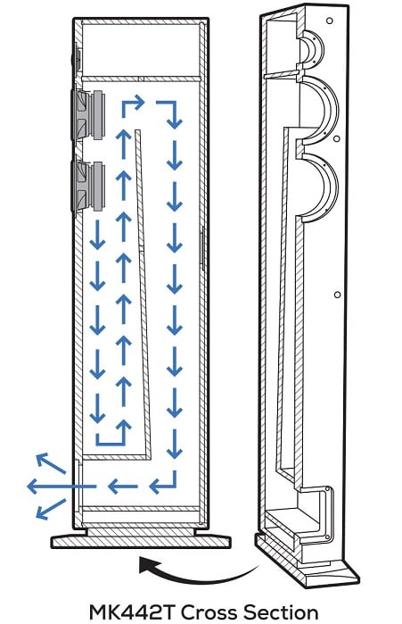

As a whole, the cabinet forms a quarter-wave transmission line. This design uses the backwave pressure from the woofers to vibrate the mass of air inside the cabinet at frequencies determined by the length and shape of the air pathway inside the cabinet. That is different from a conventional ported design where only the air in the port is loaded so that its resonance is what generates sound. A similarity between ported designs and transmission line designs is that the standing wave acts on the back of the driver cone thereby attenuating its motion. This helps to dramatically reduce distortion around the transmission line’s resonant frequency. Unlike a ported loudspeaker, a transmission line does not have a full cycle of phase delay from its open end. A quarter wave transmission line has a much shorter 90-degree delay from the open end, and since most of the output of the speaker is coming from the opening of the transmission line at low frequencies, this does not turn into a big conflict with the woofer’s output. Proponents of transmission lines claim they have the transient response of a sealed speaker along with the low-end efficiency and output of a ported speaker.
442T cross section   442T close2
What do these design decisions all add up to? Like the MK402/MK442, I wouldn’t expect the MK442T to be an output monster. Two 4” woofers have about the same surface area of a 5.6” cone. But no one shopping for floor-standing speakers in this price range should be expecting dynamic range over-achievers anyway. They should still be able to get more than loud enough for regular users though, and though the cone diameter of the woofers is on the small side, they do have an unusually high excursion. As with the MK402/MK442s, I would expect wide dispersion, so that sound is projected out at a very wide angle. Unlike the MK402/MK442, I would expect these to handle low-frequencies better. The MK402s, in particular, had a very small port in order to achieve a low port tuning, but this meant that they could be driven into port turbulence (“chuffing”) without too hard of a push. So what we should be looking for is MK442-like performance but with a lot more capable low-frequency performance. That would be a recipe for a terrific loudspeaker! Let’s now give these a listen to see how close they come to the promise of their design…

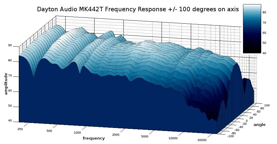

The Dayton Audio MK442T speakers were measured in free-air at a height of 7.5 feet at a 2-meter distance from the microphone, with the microphone raised to a 10’5” elevation that was level with and aimed at the tweeter center. The measurements were gated at 11-milliseconds. In this time window, some resolution is lost below 200 Hz and accuracy is completely lost below 100 Hz. Measurements have been smoothed at a 1/12 octave resolution.

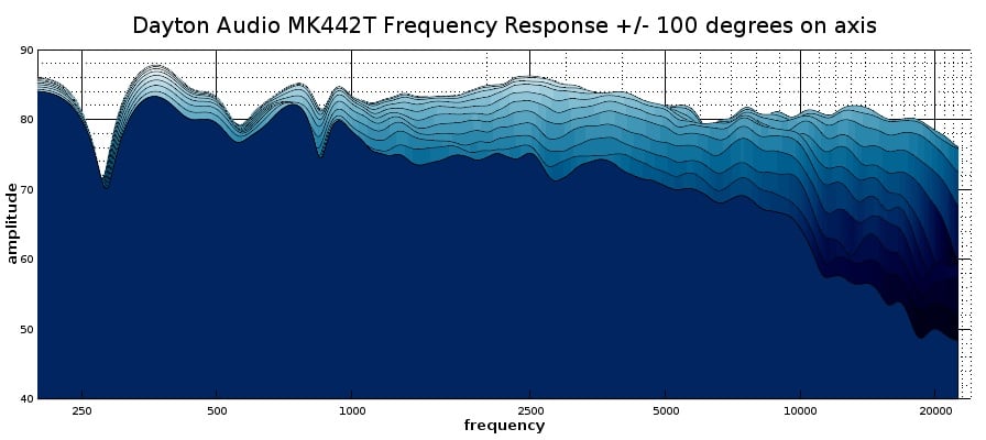

mk442t waterfall response 3D
mk442t waterfall response 2D
The MK442T’s is an easy-going speaker that has a full sound and is not fatiguing to listen to for long stretches.
The above graphs depict the MK442T’s direct-axis and horizontal dispersion out to a 100-degree angle in ten-degree increments. The most stand-out aspect in these curves is that we can see a spectral tilt toward lower frequencies. This should give the MK442T a relatively ‘warm’ sound that might also be described as ‘laid-back.’ I didn’t get a particular sense of warmth in my own listening to these speakers, but it may be something that is more readily apparent in an A/B comparison with a neutral speaker or perhaps something with hot treble. What is interesting is the direction that Dayton Audio has taken with the voicing of the MK442T speakers; in our review of their bookshelf and MTM counterparts, they had rather elevated treble, the MK402s especially. The voicing on the MK442Ts is almost an opposite. That is OK with me as I prefer a warm sound over a hot sound. The MK442Ts should be very easy to listen to, and those who get hearing fatigue from too much treble ought to give the MK442Ts consideration. What’s nice about this is that budget speakers tend to have hot treble, so here is a very affordable speaker that’s much more easy-going. What is also convenient about the character of the treble response is that, like the MK402, the elbow of the change occurs at a frequency where a typical treble tone control becomes active, so those who want a more neutral and less warm sound can simply raise the treble tone control up by 2 or 3 dB.
The on-axis response has a low-Q peak around 2.5 kHz but that settles down outside of a 30-degree angle. In fact, at 50 and 60-degrees, the MK442Ts have a nicely flat midrange response, although that does come at the expense of output at 10 kHz and above. One thing to note is the ragged response at bass frequencies. There is a high-Q null at 300 Hz followed by a peak just under 400 Hz. These are succeeded by some other minor dips and peaks above that point. These look to be pipe resonances from the transmission line. They are harmonic resonances of the transmission line’s resonant frequency that occur when transmission lines are underdamped. These resonances can be heard in outdoor test sweep tones, but they aren’t as audible in complex content. The dip would be difficult to notice, but the peak would probably be noticeable were this speaker compared directly to one with a flat response in that range. The thing is I didn’t notice anything out-of-whack when I was actually listening to the MK442T’s in-room. The most severe portion of this ragged response occurs below the transition frequencies of most rooms where the room acoustics will mangle the response anyway. The bottom line is that while it would be better if these speakers had a flat bass response, these flaws aren’t enormously audible. Automated room correction programs like Audyssey may be able to trim the peaks in the bass response, but even then, I wouldn’t necessarily say it’s worth the penalties that such programs bring in upper frequencies. Some forms of room correction equalization can be limited to bass frequencies only, and in those cases, it may be advisable to run that kind of program on these speakers, but systems with that ability are probably not usually going to be paired with speakers in this price range.

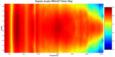

mk442t polar map

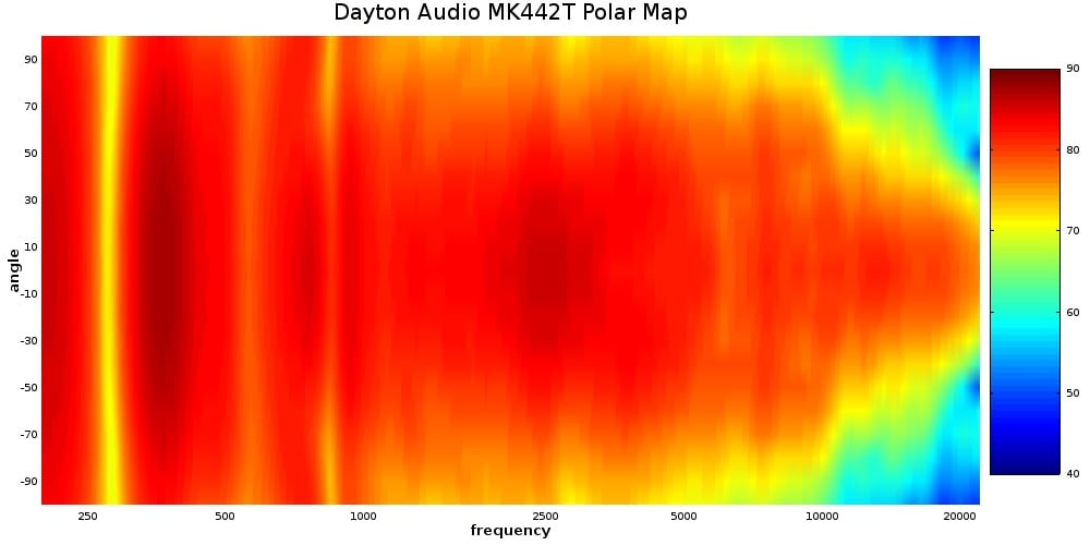

The above polar map shows the same information in the preceding graphs but depicts it in a way that can offer new insight regarding these speakers’ behavior. Instead of using individual raised lines to illustrate amplitude, polar maps use color to portray amplitude, and this allows the use of a purely angle/frequency axis perspective. The advantage of these graphs is they can let us see broader trends of the speaker’s dispersion behavior more easily. The foremost feature of the horizontal dispersion of the MK442Ts is its very wide coverage. This speaker projects sound out at a very wide angle, as was promised by its design. Dispersion does tighten up above 10 kHz, so those who want that very high treble ought to listen as closely to the on-axis angle as possible, but most listeners will still get a relatively full sound even past a 70-degree angle. Some good news is that there is a relatively good correlation between the on-axis response and off-axis response, so EQ changes made should have a proportionate effect at all angles. The MK442T is a great choice for those who want wide coverage, and this can be advantageous for a wide seating area relative to speakers’ positioning.

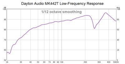

442T bass response

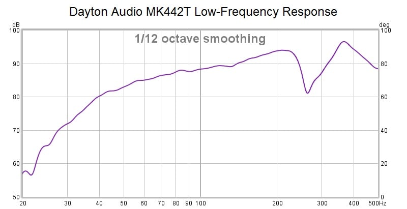

The above graph shows the Dayton Audio MK442T’s low-frequency response that I captured using groundplane measurements (where the speaker and microphone are on the ground at a 2-meter distance in a wide open area). In this graph we get a closer look at the null centered just below 300 Hz. As was mentioned before, it is a bit too narrow to be intrusive in listening to real-world content, but it is a blemish, nonetheless. Below that dip, the response is smooth, with a gentle taper from 200 Hz down to 40 Hz below which the response falls off at a much more rapid rate. Dayton Audio’s claimed 40 Hz extension spec for the MK442T does pan out here. 40 Hz is deep enough to cover most music recordings, so those buying these speakers for music are covered unless they want high SPLs in bass.

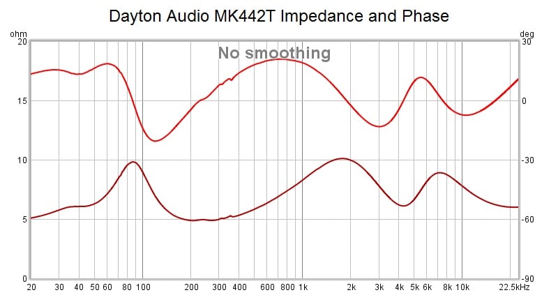

442T impedance
The above graph shows the electrical behavior of the Dayton Audio MK442T speakers. Dayton Audio’s impedance spec of 4 ohms turns out to be rather conservative. Impedance doesn’t really dip below 5 ohms. However, too much of the impedance curve is too low for the MK442T to be said to be an 8-ohm speaker. If Dayton Audio had said this is a 6-ohm speaker, I would not have argued with that spec. Either way, it’s not a tough load for amplifiers, despite its official specification. Any AVR or amplifier should be able to run these speakers pretty easily. We do see a few ripples from 200 Hz to 400 Hz which are more evidence of the pipe resonances of the transmission line. Dayton Audio specified the MK442Ts as having an 87 dB 1 watt/1 meter sensitivity. I measured 84 dB for 2.83v at 1 meter. The difference may be attributable to Dayton Audio’s measurement of watts and my measuring in voltage. These aren’t enormously sensitive speakers, but that is a given due to their design. As was mentioned before, these aren’t party speakers or hand-banging speakers, however, they should have enough dynamic range for most people.
