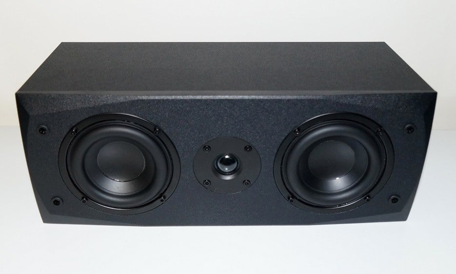

MK442 Center Speaker:
Design: 2-way vented MTM center speaker speaker/LCR
Woofer: (2) 4" high excursion driver with a treated paper cone
Tweeter: 3/4" soft dome
Finish: Black vinyl
Power handling: 80W RMS/160W max
Impedance: 4 ohms
Frequency response: 60 Hz to 20,000 Hz
Sensitivity: 86 dB 1W/1m
Crossover: 2.5 kHz, 2nd order low pass, 3rd order high pass (acoustical slopes)
Terminals: 5-way gold plated binding posts
Port tuning: 57 Hz
Weight: 8.7 lbs.
Dimensions: 5.75" H x 15" W x 6,6" D*
*Depth includes removable grill

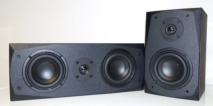

Dayton Audio recently announced two budget speakers in their product line up, the MK402 and the MK442. The MK402 is a 2-way ported design with a 4" midbass driver and .75" soft dome tweeter and sells for a meager $69/pair. The MK442 steps it up with an additional 4" driver in an MTM driver topology along with a more sophisticated crossover network and again sells for only $100/pair. In this review, we take a look at both speakers to better understand what type of performance to expect for what amounts to a cost less than most audiophiles spend on speaker cable.
The MK402 is a small speaker designed for systems where space is at a premium and a subwoofer might not be in use thanks to its 60 Hz extension, which is unusually low for such a small speaker. Scenarios for such a product would be a desktop stereo system, a small system for a shelftop in an office or bedroom, or a bedside system. It is intended for setups in close proximity to the listener, and it looks like it would be a good fit for a system with simple electronics, i.e., a small amplifier and no bass management. Dayton Audio is positing the MK402 as an affordable yet still high-fidelity speaker by stressing its heavy-duty woofer, chamfered edge baffle, a crossover that is more than just the barebones high-pass filter (“more than just a Capacitor” says Dayton Audio's literature), and ¾” soft dome tweeter. The MK442 is its corresponding center channel speaker. So how well do the MK402 and MK442 accomplish their mission of being small speakers with meaningful bass extension and high sound quality for their low cost? With the pair of MK402s and a MK442 that Dayton Audio has sent us for review, let’s now try to answer that question.

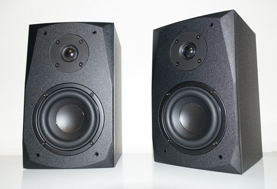

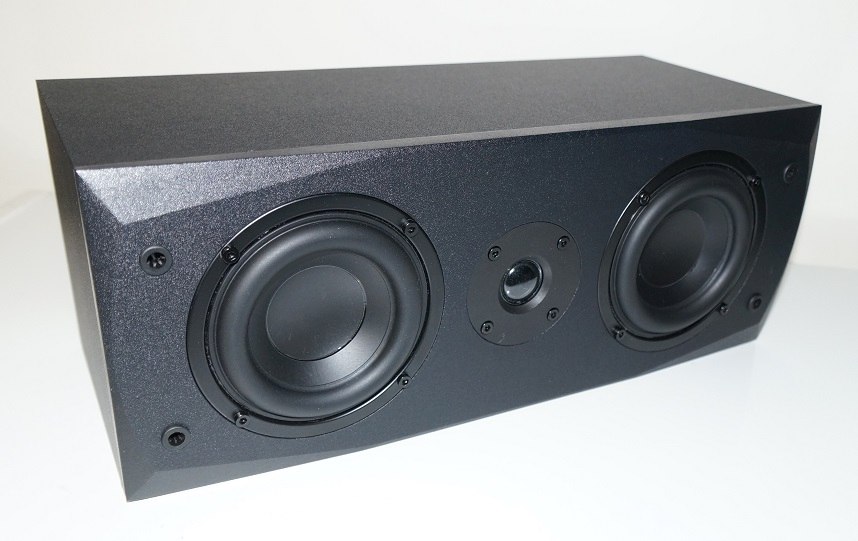

Unpacking and Appearance

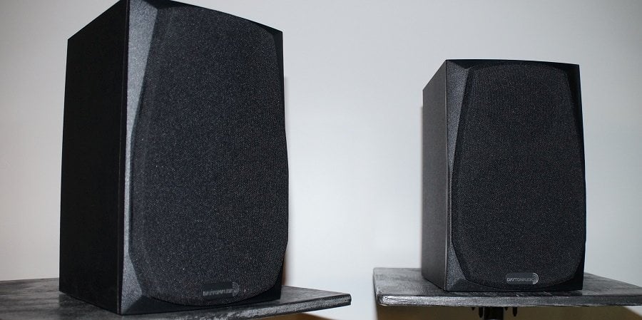

The MK402s and MK442 came packed in a cardboard box with two thick foam pieces sandwiching the speakers which protects them from shock and gives them space from the sides of the box. They were wrapped in plastic for protection against moisture and scuffs. The packing was reasonably good considering the cost.

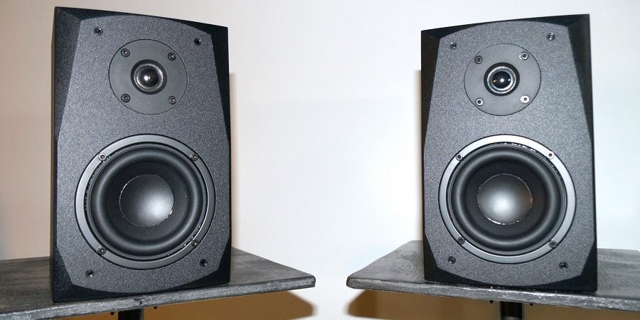

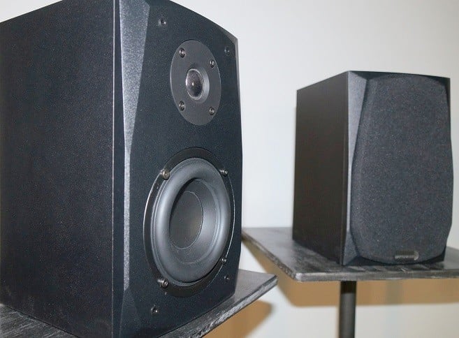

These are not bad looking speakers. They use a textured black vinyl finish that, combined with their chamfered front baffle edges, do project some sense of style. The grilles do hide the drivers, but that makes the speakers look a bit more plain. The glossy black tweeter and beefy surround on the woofer along with its concave dustcap give the MK402 and MK442 speakers a somewhat brawny look for small speakers. With the grilles off, they are just begging to blast some tunes; the grilles give them a more sedate appearance.

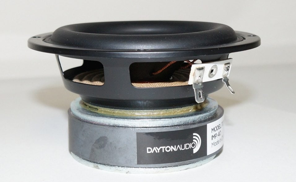

The MK402 and MK442 speakers are a nearly textbook case of getting a full sound out of a small size. The key component in this goal is the woofer and its bass extension ability; it will need some specific qualities towards achieving this end. But before we get into the woofer, let’s talk about the MK402’s diminutive size. At 9.5” high, and about 6” wide and 7” deep, it is on the small size for bookshelf speakers. It isn’t enormously heavy either, at 5 lbs. It’s a bookshelf speaker that could fit on many people’s desktop setup. That small size does have a penalty; it doesn’t get as loud for the same amount of electrical current as a larger speaker would, all other things being equal. The MK442 should be a bit more capable since it has two woofers.
Dayton Audio claims the MK402 and MK442 has usable bass down to 60 Hz, which is quite a feat from a 4” bass driver. However, the bass driver used in these speakers is rather heavy-duty, considering the cost of the speakers. It is the Dayton Audio TCP115-4. It has a relatively low resonant frequency for such a small cone with a stated Fs of 53.8 Hz. Its beefy motor uses a ¾” tall, 3” diameter magnet with a vented pole piece. The voice coil is a 1”, four-layer CCAW (copper-clad aluminum wire) wound around an aluminum former for better thermal dissipation. Its suspension system uses a 3” diameter spider along with a ½” wide surround; a very brawny surround for a 4” woofer! The cone is made from treated paper with an inverted dustcap. It looks to me like the bass driver forms the heart of this particular speaker; it has the sort of build quality that I would expect to find in a speaker at twice this price.

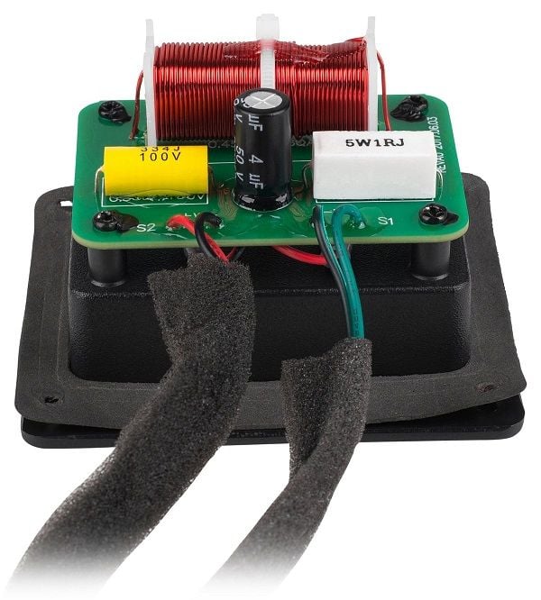

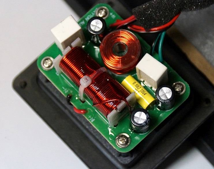

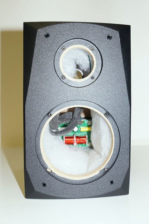

MK402 crossover (left), MK442 crossover (right)

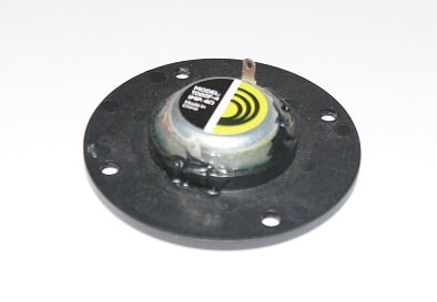

The MK402 and MK442 both use a ¾” silk-dome tweeter with ferro
fluid cooling (the Dayton Audio TD20F-4). Such a small diameter tweeter should have wide dispersion even at very high frequencies. The MK402 speakers use a four-element crossover network with a 2.5 kHz crossover frequency: an inductor and capacitor are used for a 12dB/octave low-pass filter on the woofer, and a capacitor is used for a 6dB/octave high-pass filter on the tweeter. There is also a resistor intended to pad the tweeter since the tweeter has a higher sensitivity than the woofer. The MK442 uses a more sophisticated 8-element crossover that has four capacitors, two inductors, and two resistors for an 18dB/ octave slope high-pass filter on the tweeter and a 12dB/octave low-pass filter on the woofers.
The cabinet is made from ½” thick MDF paneling all around with no internal bracing. Internal bracing in such a small cabinet is probably overkill, so the omission of bracing here isn’t a worrisome matter, especially at this price point. Both the MK402 and MK442 are rear-ported with the MK402 using a 1" diameter port and the MK442 using a 1.5" diameter port. The ports have only slight flaring. As was mentioned previously, there are some chamfered edges on the front baffle, but this appears to be done more for the sake of style than to reduce baffle diffraction because it still leaves quite a bit of surface surrounding the tweeter which is where diffraction would be at its most severe. The interior is stuffed with a good amount of polyfill to damp backwaves and also for isothermal conversion (isothermal conversion turns acoustic energy into heat to make the enclosure seem a bit larger than it actually is).

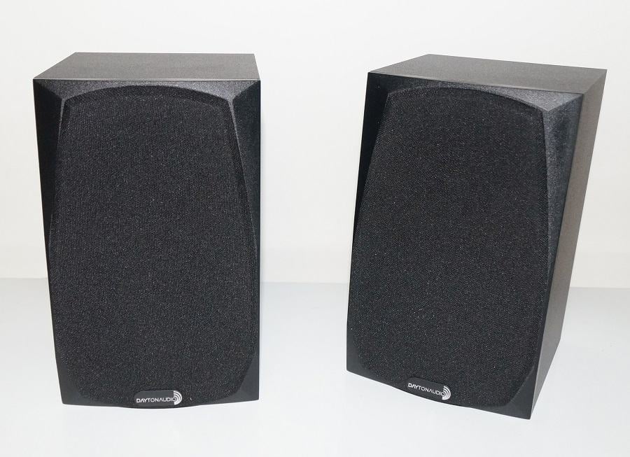

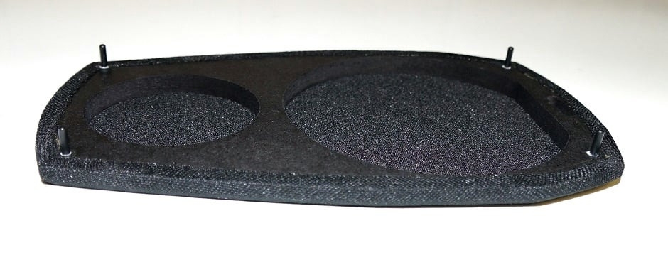

The grilles use a ½” thick sheet of MDF with cut-outs for the drivers and covers everything in an acoustically transparent fabric. It is attached to the front of the speaker with plastic pegs. A grille like this, which essentially protrudes from the front baffle in front of the tweeter, is bound to cause extra diffraction which isn’t going to do the sound any favors. It is there to protect the drivers and make the speaker look more innocuous. Four small, soft rubber discs serve as feet. The softness of the rubber here is a good idea for damping since this small speaker has a relatively long-throw bass driver that can play to such low frequencies where rigid feet would likely cause audible vibration on a hard surface.

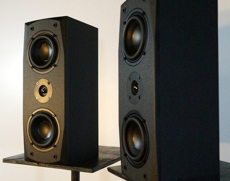

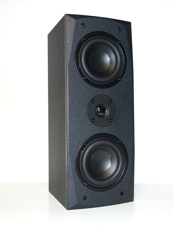

Additional Listening With the MK442s as an Upright Pair

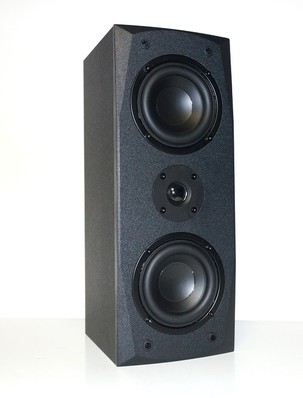

After measuring the acoustic behavior of the MK442 in free-air testing, I was quit
e impressed with its behavior on its vertical axis. From the response I measured on its vertical axis, I reasoned that the MK442s would make for an exceptionally good speaker when used on its side. I asked Dayton Audio to send me another MK442, so I could listen to them as a stereo pair in that orientation. As the measurements suggested, these sound very good when used standing on its side for a vertical alignment of the woofers. They had excellent center imaging and a good spectral balance. While just a tad bright, they were easier on the ears than the MK402s, and I did not feel the need to equalize them or use a hard toe-in to alleviate the treble response. They sounded good right out of the box. From listening and comparing a pair of MK442s to a pair of MK402s for stereo music listening, I think that the extra cost for a pair of MK442s is well worth it. The MK442s sound good without even considering cost and without adding any caveats or conditions. When considering that they only go for $100 a pair...well, I am listening to a pair as I type this, and they are astonishingly good for the price.

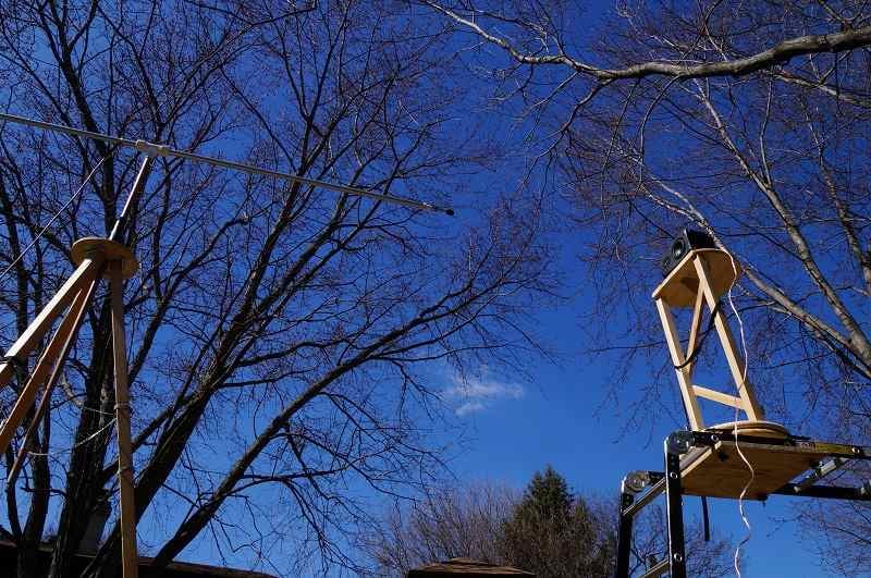

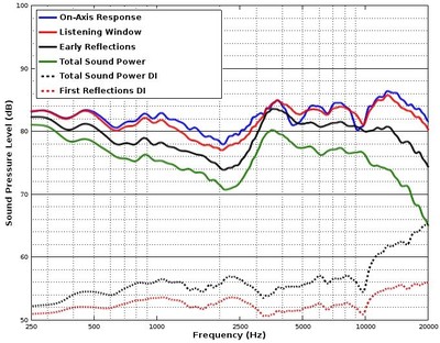

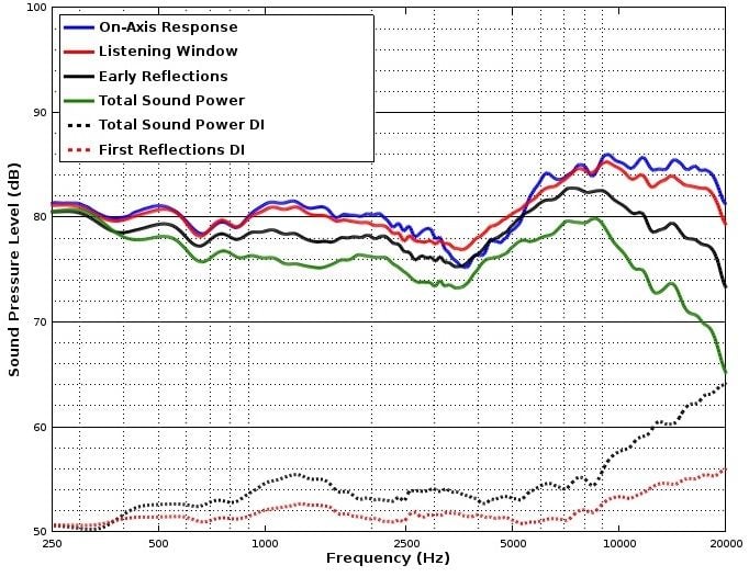

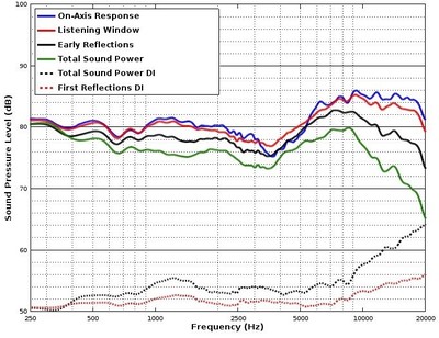

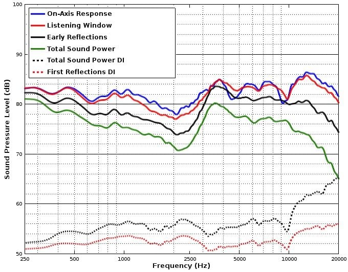

The Dayton Audio MK402 and MK442 speakers were measured in free-air at a height of 7.5 feet at a 1-meter distance from the microphone, and the measurements were gated at an 8.5 millisecond delay. In this time window, some resolution is lost below 250 Hz and accuracy is completely lost below 110 Hz. Measurements have been smoothed at a 1/12 octave resolution.
Dayton Audio MK402 (left) and MK442 (right) response curves
One thing that is immediately discernible from our response curves above is the treble region above 5 kHz seems rather elevated with respect to the rest of the frequency band, at least for the MK402, and this explains the hot treble in our listening sessions. The tweeter seems to be a lot more sensitive than the woofer, despite padding from the resistor on the crossover. This is not surprising, since a 4” long-throw bass driver is inevitably going to be insensitive, and the light diaphragm of a ¾” dome tweeter could easily be very sensitive at high frequencies. It can be seen from the “Directivity Index” curve that the MK402 exhibits very little directionality until 9 kHz, meaning it is a very wide dispersion speaker until high treble frequencies. This speaker will have a less bright sound at off-axis angles, although it will still have some brightness since even the first reflections curve has quite a bit of heightened treble. The bass region and midrange region have a relatively neutral response for a speaker at this price point, although there is a slight depression just above the crossover region in the direct axis response, which is likely the result of the lower end of the tweeter’s response not quite matching up perfectly with the upper end of the woofer’s response. We can see from the ‘Listening Window’ curve that this dip is ameliorated at off-axis angles.
The MK442 is more even-keeled in its treble output. There is a dip around the 2 kHz area which is more pronounced in the curves that use more off-axis measurements, and this dip is primarily due to interference of the woofers canceling out each other’s output. This cancellation pattern is called lobing, and Audioholics has published multiple articles about this effect in center speakers such as Pros and Cons of Various Center Channel Designs, Vertical vs Horizontal Center Speaker Designs, and Center Channel Speaker Design Additional Considerations. The additional woofer does bring up the bass and midrange response relative to the tweeter’s output, so the treble is not as hot as with the MK402. The thoroughly different crossover likely has a role to play in this respect as well. The MK442 is more directional than the MK402, and certainly a large part of that will be due to the lobing effects.
For more information about the meaning of the curves in these graphs, please refer to our article Objective Loudspeaker Measurements to Predict Subjective Preferences.

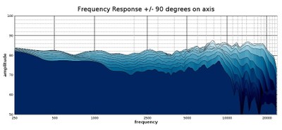

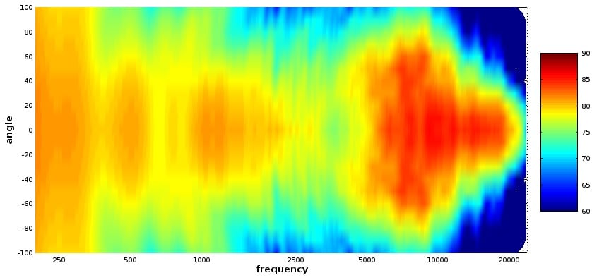

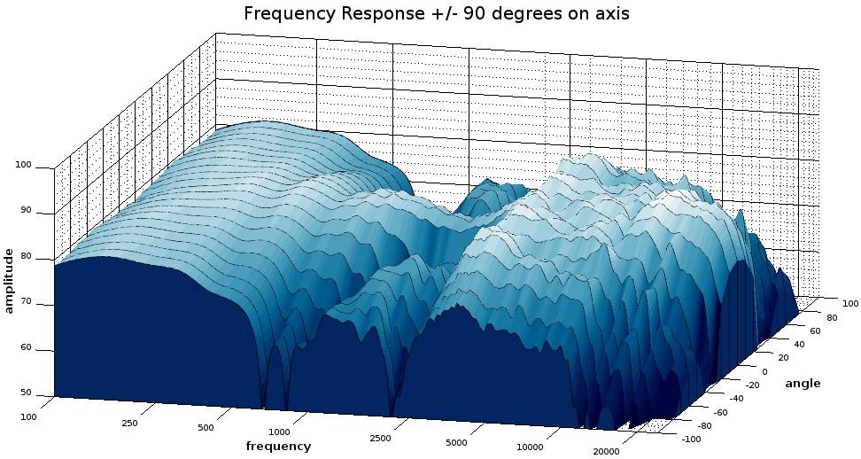

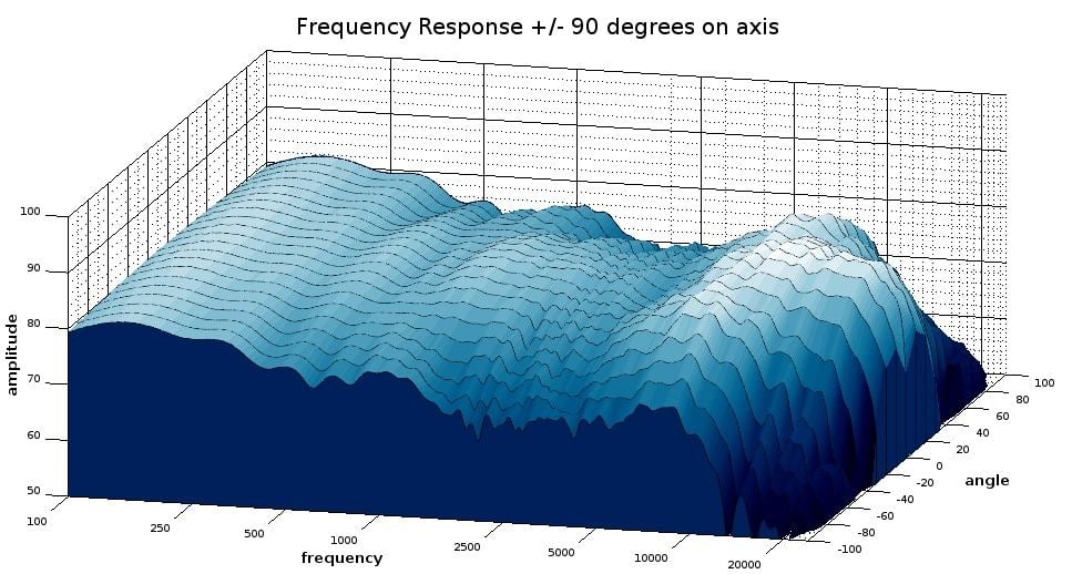

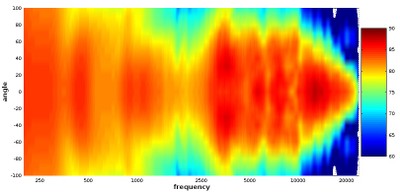

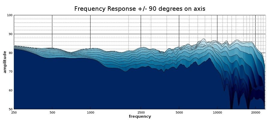

Dayton Audio MK402 (left) and MK442 (right) Horizontal Responses +/- 100 degrees: 3D view
Dayton Audio MK402 (left) and MK442 (right) Horizontal Responses +/- 100 degrees: 2D view

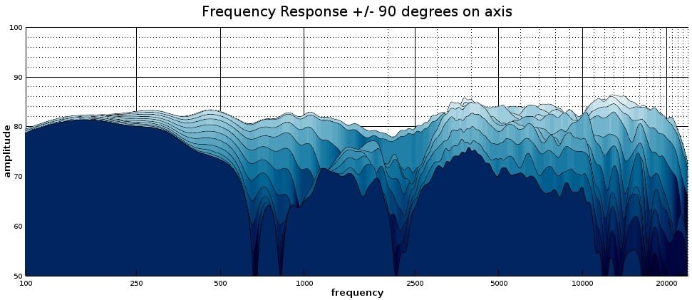

The above graphs depict the MK402 and MK442’s lateral responses out to 100 degrees in ten-degree increments. In the MK402’s graphs, we get a better look at the tweeter’s heightened treble. If you want to tame the treble on these speakers without equalization, you need to listen to them at a pretty hard angle, and that still will not alleviate a hump at 7 to 8 kHz by a whole lot. It should be said that this all occurs at the tweeter-height. Above this height, things do change for the better, but we will discuss that when we get to the vertical behavior of the MK402.

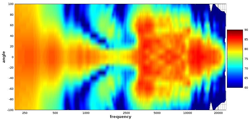

Regarding the MK442, the effects of the lobing become very stark in these graphs. If you are off the horizontal axis by more than 10 degrees, a big null starts to form centered at 2 kHz from the woofers fighting against each other as their output falls out of phase with each other. Pretty much every horizontal center speaker with this woofer-tweeter-woofer design is going to have this issue, so don’t think this problem is particular to this speaker. Best listening is done within a 20-degree angle of its direct axis, but outside of that angle problems start to occur.

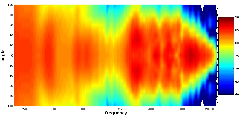

Dayton Audio MK402 (left) and MK442 (right) Horizontal Responses +/- 100 degrees: Polar Map
The above graphs show the same information that the preceding graphs do but depict it in a way that offers new insight regarding these speakers’ behavior. Instead of using individual raised lines to illustrate amplitude, these polar maps use color to portray amplitude and this allows the use of a purely angle/frequency axis perspective. The advantage of these graphs is they can let us see broader trends of the speaker’s behavior more easily. For example, we can see, when looking at the MK402’s polar map, that big blotch of red that resides in the high frequencies; that tells how much of that elevated high-frequency energy inhabits the speaker’s coverage, and it is a lot. We can see hot treble reach out to 70 degrees off axis from 7 to 10 kHz! So, we can see that a strong toe-in is not going to save the sound from high levels of treble, and it will mostly just reduce treble from roughly 13 kHz and above. Below the burst of treble, the energy is spread out relatively evenly, although we do see some waist-banding around 4 kHz. To really tame the MK402s, equalization is going to be needed.
The polar map of the MK442 also tells us a different side of the story of its horizontal dispersion. While there is a similar burst of high-frequency energy, it covers a larger range of treble and is also matched by similar amounts of energy in low frequencies, at least near direct-axis angles and so shouldn’t sound as bright, at least if the listener is sitting directly in front of the speaker. We also get a better look at how the output of the two woofers are colliding out of phase and thereby greatly reducing energy at off-axis angles. We can clearly see when the tweeter kicks in as the off-axis energy splays outward at about 3 kHz.

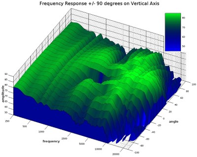

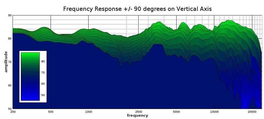

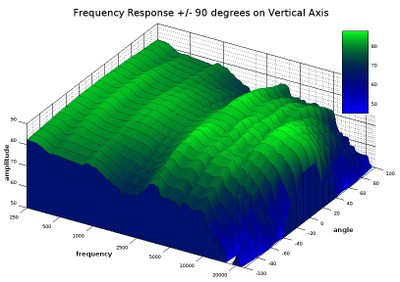

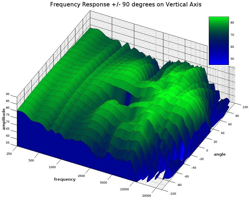

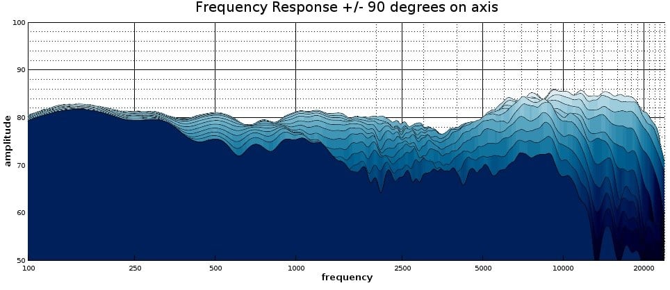

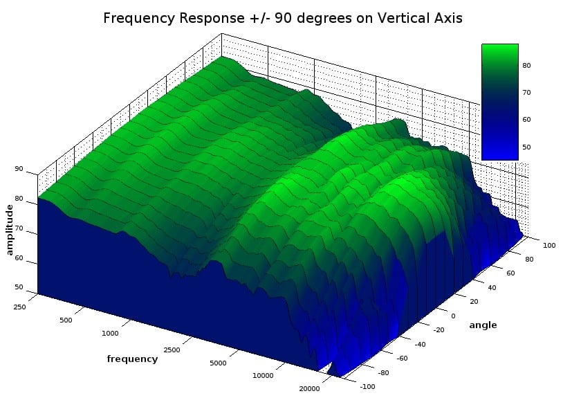

Dayton Audio MK402 (left) and MK442 (right) Vertical Responses +/- 100 degrees: 3D view
The above graphs depict the MK402 and MK442’s frequency response behavior on their vertical axis, where zero degrees is directly in front of the tweeter, negative degree values are below the tweeter, and positive degree values are above the tweeter. The valleys that occur above and below the zero-degree axis on the MK402 are very common in conventional loudspeaker design. They are the result of the tweeter and woofer paying the same frequencies but out of phase, so they are not synchronous. They are usually only fully synchronous directly ahead of the speaker. The only speaker types that would be immune to these artifacts would be speakers that use either full range drivers or coaxial driver configurations. Uniformity (as in nice smooth response lines) in the horizontal dispersion is much more important than uniformity the vertical dispersion, so don’t let the rockiness of this vertical response graph be a troubling matter for you. The lesson here is try to listen to the MK402s with the tweeter level with your ears.
Let’s talk about the vertical dispersion of the MK442 and how much smoother that response is than its rugged horizontal response:
Dayton Audio MK442 Vertical Response +/- 100 degrees: 2D view
The above graph looks at the vertical dispersion of the MK442 from a profile view to get a better sense of its amplitude response. The vertical response of the MK442 is much better than its horizontal response- but since the horizontal response is so much more important and consequential than the vertical response, what are we going to do? The solution, if possible, is to use it on its side, like so:
If possible, use the MK442 like this!
When you stand the MK442 on its side, it has fairly good behavior on the horizontal axis for that orientation; in fact, it has an overall much more neutral response on its side than the MK402 does standing upright. To get a better sense of this, take a look at its horizontal response in a polar map when it is standing upright:
Dayton Audio MK442 Horizontal Response when used on its side +/- 100 degrees: Polar Map
Aside from some waist-banding around 2 kHz, it has a nicely even dispersion of energy out to a 70 degree angle. It would still be a bit bright without equalization, but not nearly as much so as the MK402. The MK442 vertically oriented has a far more even coverage of sound over a wide area than the MK402 or itself when it is positioned horizontally. Within 30 degrees of its direct axis, we can see fairly strong coverage of acoustic energy, so those who use the MK442s in an upright orientation like this should have a full sound within a 60-degree angle in front of the speaker. That means there isn’t a small “sweet spot” with these speakers used in this orientation, and they should provide reasonably good sound over a large area. A pair of these used in a vertical orientation would make for a very nice two-channel system on a tight budget!

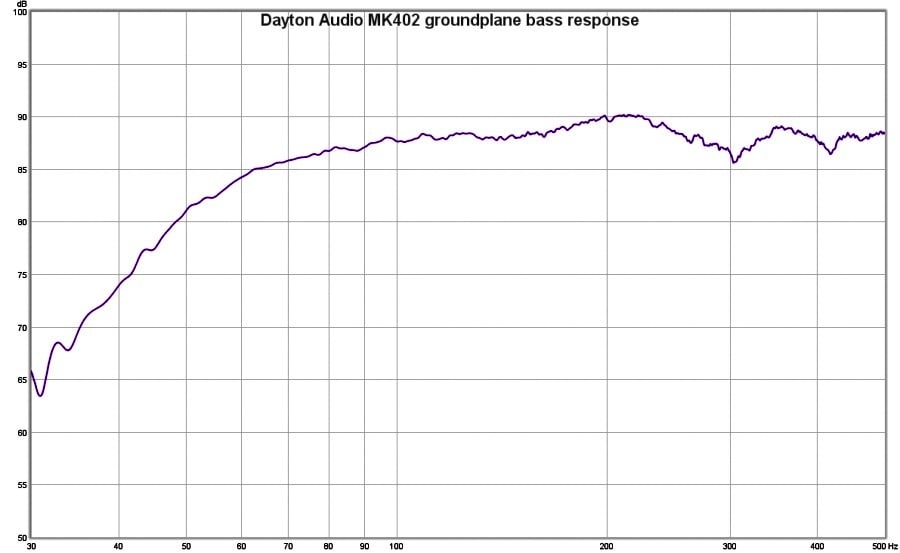

Dayton Audio MK402 groundplane bass response
The above graph shows the MK402’s low-frequency response that I captured using groundplane measurements (where the speaker and microphone are on the ground in a wide open area). The MK402 has a very good bass response when its size and price are considered. These legitimately dig down to 60 Hz and should even be able to provide decent 50 Hz output if used in a placement that gives it some boundary gain such as nearby a wall or on a desktop. The bass is relatively smooth too and doesn’t have a boosted response around port tuning like many budget speakers. This speaker will play bass notes evenly and clearly, and that has to be considered a minor miracle at this size and pricing. However, at higher drive levels, the 1” port of the MK402 do get overloaded and will go into audible turbulence (“chuffing”) on content that has very low frequencies. The same is likely true of the MK442 since it has a similarly-scaled port diameter for its two woofers instead of just one, although I did not hear any audible chuffing from the MK442 during my time with it. A subwoofer would be useful here to take a heavy load off the port and greatly reduce the potential for port chuffing.

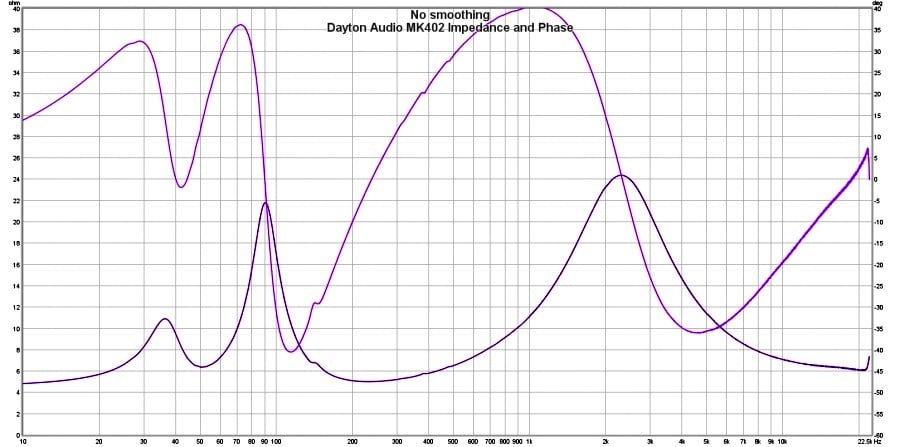

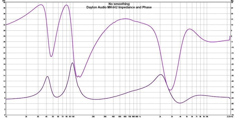

Dayton Audio MK402 (left) and MK442 (right) Impedance and Phase Response
The above graphs show the electrical behavior of the MK402 and MK442 speakers. They are both spec’d by Dayton Audio to be 4-ohm speakers, and this is a fair rating, even though the impedance of both speakers never actually touches 4 ohms. They do spend much of the critical bandwidth regions around 5 ohms though. The MK402 is not a particularly heavy electrical load for amplifiers; although it does dip to 5 ohms in certain areas, it doesn’t do so at steep phase angles, so it shouldn’t be too hard on even inexpensive amplifiers or AV receivers. The MK442 is largely the same with one exception: it just about hits 4 ohms at a rather steep phase angle at 4 kHz. This might be a problem on cheap amplifiers if you are playing material with strong content in the 4 kHz region at loud volumes for extended periods of time. I think it isn’t likely to turn into a problem, except in cases where someone cranks a movie that is mixed very loudly for its entire duration (a movie like “Transformers” that runs on full blast all the time).
I measured the MK402s sensitivity at 79.75 dB for 2.83v at 1m. That is very low, and wattage does not go as far on these speakers as they do on larger speakers. It doesn’t matter as much when these are placed in the near-field, but, as mentioned before, these are not party speakers. Going back to our discussion in the design overview of these speakers, this is a matter of “Hofmann’s Iron Law” where there will always be a balance of low-frequency extension, sensitivity, and size. I don’t regard this as a bad trade though since the MK402s can still get loud enough for my tastes, and common sense should be used in selecting speakers for really loud applications, for which the MK402s need only a glance to know they are not a good fit. This low sensitivity measurement is not surprising, and I can’t really hold it against them since that bass and size isn’t possible without this compromise. I did not measure the MK442’s sensitivity but it isn’t going to be a whole lot more than the MK402’s.
