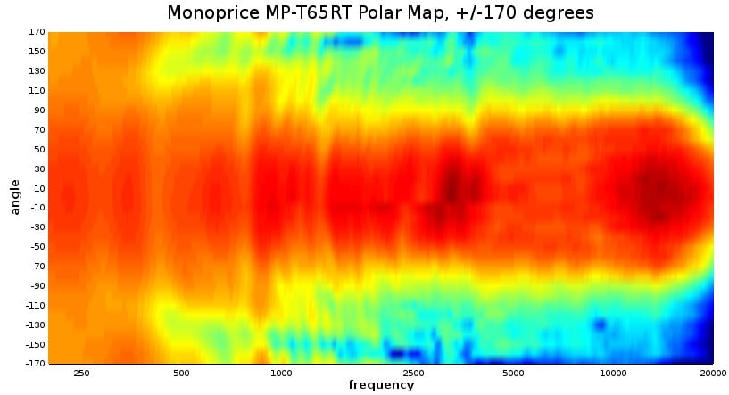

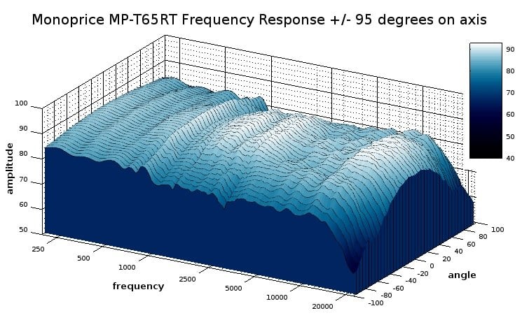

- Exceptionally good off-axis response

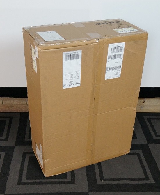

Unpacking and Appearance

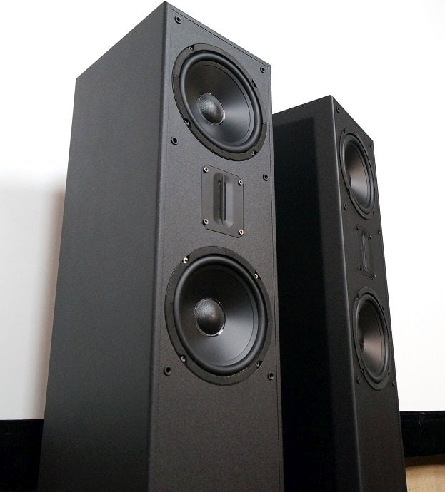

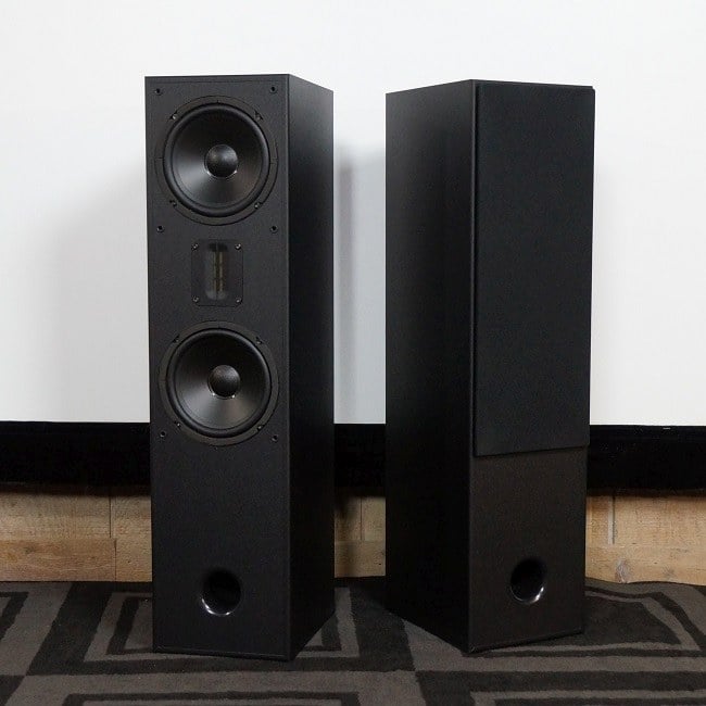

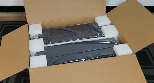

The MP-T65RT
arrived in a prudently packed
box. The packing was thrifty yet smart, so those
who order these speakers should manage to receive them undamaged. One factor in
that is these speakers are very light, so they don’t have as much mass to put
stress on themselves or the packing should they encounter a sudden shock. They
were nested in a bunch of foam blocks, and they wrapped in plastic to protect
them against moisture. Once out of the packing, I was presented with a pair of
petite and somewhat plain looking tower speakers. The finish is a simple
textured vinyl that is seen on many speakers these days, including much more
expensive speakers. With grilles on, they really are just tall, featureless
black boxes. With grilles off, they are more utilitarian looking, but they also
have more personality. The woofers take up so much of the front-baffle real
estate that it gives the speakers an almost aggressive feel as if they are begging
to be given music to play right this instant. These speakers aren’t going to
dazzle anyone with their appearance, but they are too simple to offend as well.
Unless they are placed in the middle of the room, they will likely disappear
into the scenery. If you like your speakers to look unpretentious, these
accomplish that.

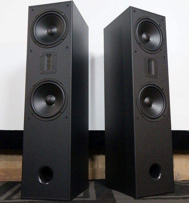

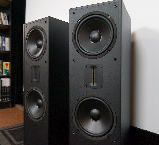

The
MP-T65RT speakers are pretty simple floor-standing speakers, and at this price
point, you can’t expect much complexity. However,
simple doesn’t mean bad.
There may not be that many pieces to this puzzle, but so long as all the pieces
fit together just right, the assembled picture will still be correct. The

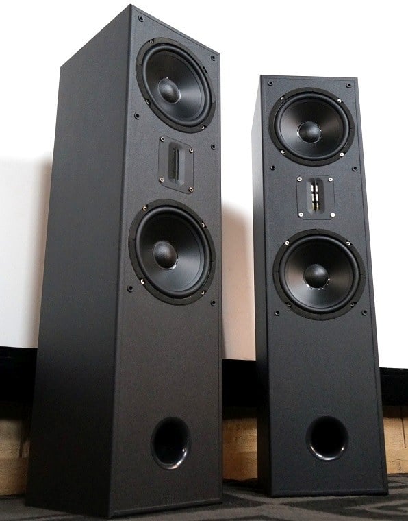

MP-T65RT is a two-way, ported, floor-standing speaker using two 6.5” woofers
sandwiching a planar tweeter in an MTM configuration. It’s unusual to see
budget floor-standing speakers use an MTM design where the woofers sandwich the
tweeter, but it’s a good idea for a couple of reasons.

Placing
the tweeter between the woofers makes the tweeter the acoustic center of the
speaker in a more meaningful way, and it’s strange that more two-way tower
speakers don’t use this design strategy to their advantage. It does not
increase the complexity of the design much. The only drawback is that it can
make the speaker taller in order to get that tweeter at an ear-level height.
Here, the MP-T65RT does have a deficiency: the tweeter on this speaker is
fairly low compared to most speakers. The optimal height to listen to most
speakers is with the tweeter at ear level, and this is especially true of MTMs,
but the height of the tweeter on the MP-T65RT is only 20” off the floor. That
means that their tweeters will be lower than ear levels of most people sitting
in normal-height furniture. This can be fixed by
placing them on a shallow
stand or by angling them back slightly so that the tweeter’s ‘aim’ intersects
the listener’s ear position. Monoprice likely did this to save on costs, after
all, a larger speaker would have been significantly more expensive to ship. In
my opinion, it’s not so bad to make a speaker that’s a bit too low; you can
always prop the speaker up on something to adjust the height, but if a tweeter
is too high, it’s a lot less convenient to prop of the listening position,
since there is no way to make the speaker shorter.

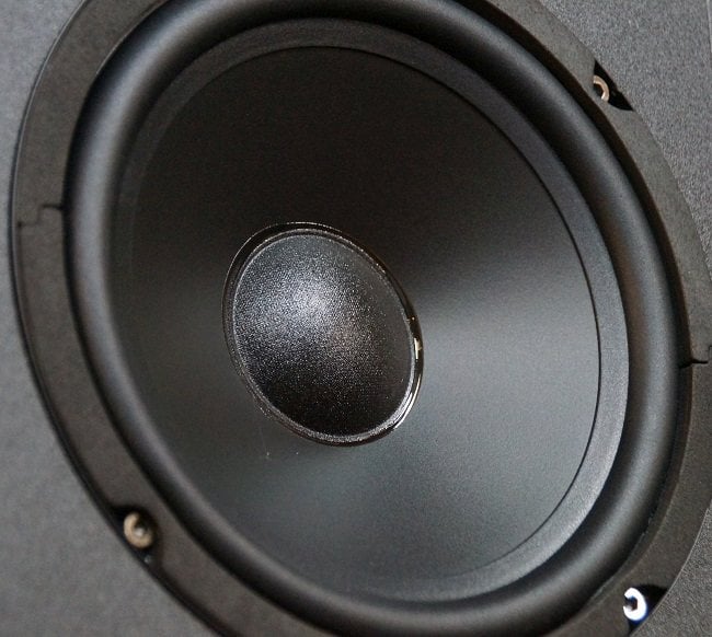

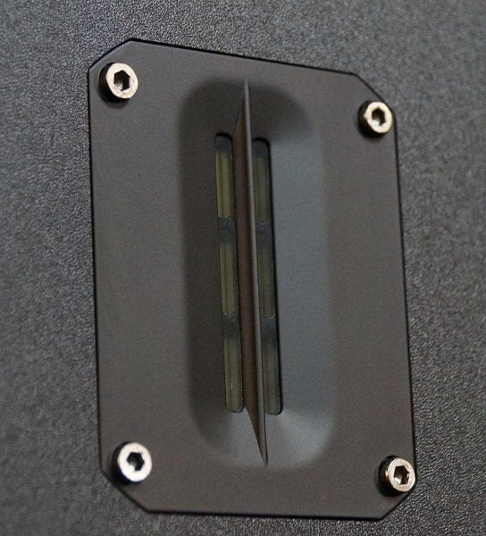

The MP-T65RT uses a ribbon tweeter, kind of. It’s the same tweeter used in the MP-65RT. In our original review of the MP-65RT bookshelf speaker, we misidentified the tweeter as a classic ribbon tweeter, but it turned out to be a planar tweeter. Monoprice calls this a ‘ribbon’ tweeter, and there is a slight similarity, but it wouldn’t quite be considered a true ribbon tweeter. True ribbon tweeters use a very thin piece of conductive film such as aluminum as the diaphragm, but a planar uses a conductive film etched into a light but durable plastic such as polyester as the diaphragm. Among the differences this makes is that the planar tweeter can have an intrinsically more controlled impedance load, so it does not need its own transformer like a true ribbon tweeter, and the manufacturing is much simpler, making it a far less expensive tweeter. Planar tweeters are also a lot more durable than true ribbon tweeters. Many ribbons have a difficult time dealing with midrange frequencies, but planar tweeters tend not to be as fragile if given a lower frequency range to cover.
Monoprice MP-T65RT 6.5" Woofer
The MP-T65RT also uses the same polypropylene woofer used in the MP-65RT, and this is good news because these woofers don’t have severe breakup effects. This speaker is too inexpensive to have a real crossover circuit, so the woofers are running mostly full-range and are not being low-pass filtered. In order to pull this off without sounding horrendous, the woofers cannot have high-frequency excitations that jump sharply up in amplitude. Many drivers, when pushed beyond their upper-frequency comfort zone will run into break-up modes, where the cone or diaphragm starts to bend because it’s being asked to move too fast and therefore can’t hold its shape. At this point, it loses pistonic behavior, and its frequency response becomes very erratic and uneven. Most speaker designers try to filter out playback of frequencies where breakup occurs, but that means the use of a real crossover circuit with inductors. Instead, the MP-T65RT uses a woofer that was engineered to have less objectionable breakup behavior, so when these woofers do run into breakup modes, the effects on the response aren’t as loud or offensive-sounding, so it shouldn’t be as audibly intrusive on the overall response of the speaker.

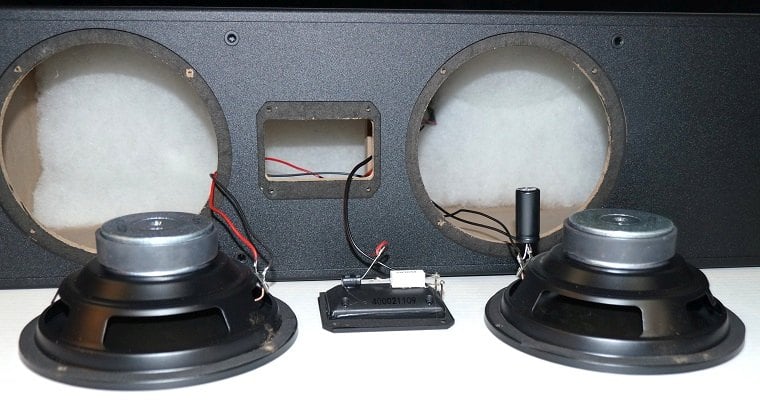

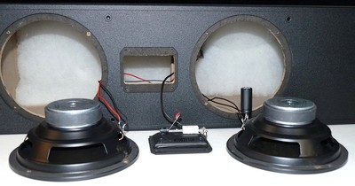

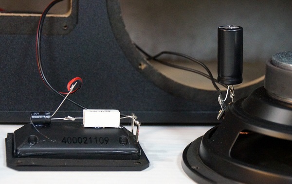

The
‘crossover,’ as it were, is just a good-sized capacitor on the woofers,
presumably to prevent them from playing below the port tuning frequency, and a
small capacitor and resistor on the tweeter to protect it from lower frequency
playback.
The cabinet is very much that of a budget speaker, with ½” thick MDF
side panels and only small blocks around the internal edges for bracing. Thin,
flat, large panels with little bracing such as these may have some resonance
issues, and that is one of the sacrifices that must be made to achieve this low
price point. However, the offensiveness of panel resonance has never really
been established with exactitude, so the severity of this problem may not be
all that bad. I measured the speakers to weigh 15 lbs. each which is less than
Monoprice’s spec of 17.5 lbs. each, but they may have meant shipped weight.
There is a layer of stuffing used in the cabinet to help damp backwave acoustic
energy from the cones that may alleviate some panel resonance. The speaker wire
inputs are just a set of spring clips, which is just fine. Spring clips are not
as fancy as five-way binding posts, but they are a perfectly fine way of
connecting speaker wire. They are a cost-cutting measure that wouldn’t bother
me even on much higher-priced speakers, to be honest. The ‘feet’ are just some
small felt pads that can prevent hard floor surfaces from getting scuffed.

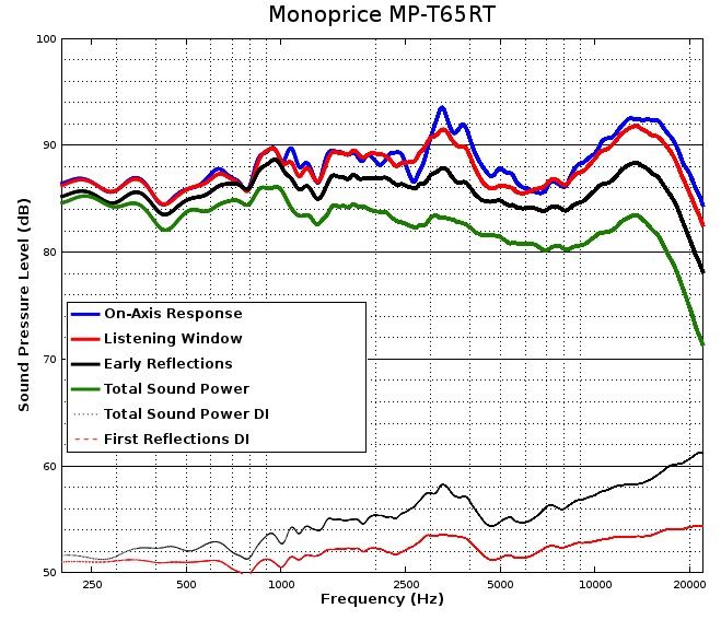

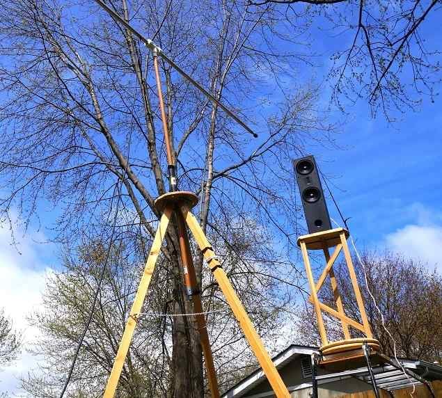

Monoprice MP-T65RT Measurements and Analysis
The Monoprice MP-T65RTs were measured in free-air at a height of 9 feet at a 1-meter distance from the microphone, and the measurements were gated at an 11-millisecond delay. In this time window, some resolution is lost below 200 Hz and accuracy is completely lost below 100 Hz. Measurements have been smoothed at a 1/24 octave resolution.
The above graph shows the direct-axis frequency response and other curves that describe the speaker’s amplitude response in a number of ways. For more information about the meaning of these curves, please refer to our article Objective Loudspeaker Measurements to Predict Subjective Preferences. The most immediate feature that leaps out here is that the on-axis response is not the flattest that we have ever seen. This is not surprising for loudspeakers in this price range. There is some peakishness in the 3 kHz to 4 kHz that is likely the result of cone breakup since there is no low-pass filter implemented to tame the woofer’s higher-end response. This peak is relatively contained though and only occupies a quarter of an octave, so while it may be audible, it shouldn’t be that intrusive. It may add a slight sibilance to certain parts of speech. The MP-T65RT’s response does ramp up a bit above 10 kHz, but this is even less of an issue since there is not much recorded content in that range. That extra energy centers around 15 kHz and wouldn’t do much more than give these speakers a bit more ‘air’ in recordings that actually have some content in that range. The ‘Listening Window’ tells largely the same story as the on-axis curve, that this response basically continues out to a 30-degree angle in the horizontal axis.
For those familiar with this family of curves, there are a couple of interesting details that emerge which we will explore in greater detail below. One is the relatively stable ‘early reflections’ curve. This curve is pretty well contained within a 4 dB window. The other detail is the low levels of the directivity indexes; that indicates that these are going to be rather wide dispersion speakers in some manner. The combination of the relative stability of the ‘early reflections’ curve along with the low level of the directivity indexes hint at a very cool feature of the MP-T65RT, so let’s take a closer look at what is going on here…

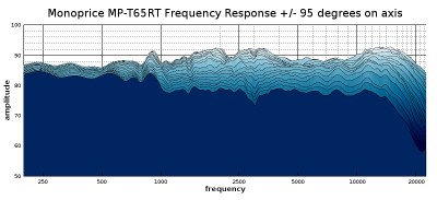

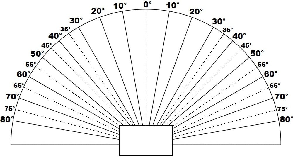

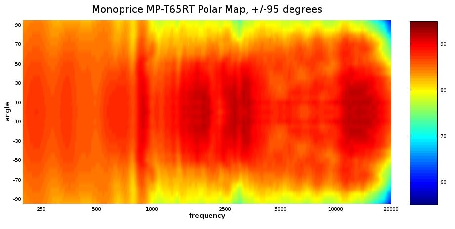

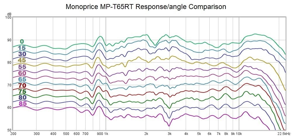

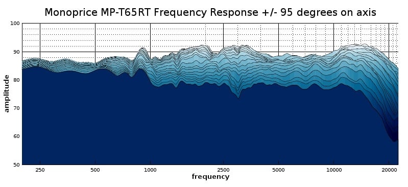

The above graphs depict the MP-T65RT’s lateral responses out to 95-degrees in five-degree increments. Here we get a more detailed look at the horizontal dispersion of the MP-T65RT. An astute observer of these graphs will notice something remarkable that occurs as we get away from the on-axis angle: the responses actually become very flat. Let’s individually separate some of these curves so it’s easier to see this effect:
The above graph is a number of some of the individual responses of angles of the MP-T65RT. The number above each curve on the far left denotes the angle degree of the response. The on-axis response is fairly uneven, and it remains that way out to 30-degrees. We can see it is leveling out a bit at 45-degrees, and at 55-degrees the response reaches a very good level of neutrality. This is nearly an absurd situation; many speakers will have a flattish on-axis response that becomes irregular as we move away from the on-axis angle, but with the MP-T65RT speaker, the reverse occurs! The take-away from this is that the MP-T65RT is capable of producing a very neutral tonal balance, but it happens at an angle way off the front axis of the speaker. To give you an idea of the kind of angle this happens at, we provide the diagram to the right. The MP-T65RT is a very wide-dispersion speaker that has a great off-axis response but a not-so-linear response around the front axis. Now let’s look at the width and shape of this dispersion pattern:
The above graph shows the same information that the preceding graphs do but depict it
in a way that can offer new insight regarding these speakers’ behavior. Instead of using individual raised lines to illustrate amplitude, these polar maps use color to portray amplitude and this allows the use of a purely angle/frequency axis perspective. The advantage of these graphs is that they can let us see broader trends of the speaker’s behavior more easily. Compared to many of the speakers reviewed here in the past, this is a very wide dispersion speaker. The acoustic energy produced by the MP-T65RT does not really subside until it reaches a very far angle off the front axis. In fact, the dispersion is so broad that this +/- 95-degree graph doesn’t fully capture the full nature of this speaker’s off-axis breadth. To get a greater perspective, let’s widen the angle of our polar map out to +/- 170-degrees:
Regular readers of our reviews will remember one other occasion where we thought such an extreme angle was necessary to really show a speaker’s behavior, and that was from the celebrated Philharmonic BMR Philharmonitor. What is astounding is the similarity in the horizontal directivity. This speaker, much like the BMR Philharmonitor, has a pretty strong response out to an 80-degree angle off the front axis. The directivity matching of the woofers to the tweeter here is excellent. Most speakers don’t have directivity this consistent and uniform regardless of pricing, but these speakers, which will likely be the lowest cost floor-standing speakers that this publication will ever review, performs superbly in this respect. It is bizarre to see such an excellent performance attribute in a speaker that is so cheap.

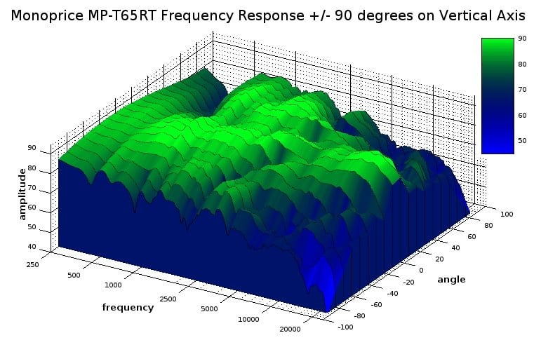

The above graph shows the MP-T65RT’s response behavior along its vertical axis where zero degrees is directly in front of the tweeter, negative degree values are below the tweeter, and positive degree values are above the tweeter. What can be seen here is that the response gets rough very quickly outside of a narrow angle on the vertical axis, so these speakers are best listened to with the tweeter at ear level. At too high or too low of an angle, all kinds of issues crop up as would be expected in a design of this nature. One significant problem here is that we can see a lot of high-frequency energy loss not too far of an angle above the tweeter, yet the tweeter on this floor-standing speaker is relatively low in height, so those users who do not address this issue will be left with a rather poor sound. This speaker should be listened to in a +/- 10-degree vertical angle of the tweeter. Ideally, the tweeter should be level with the listener’s ears. That is the case with almost all speakers, and that is especially the case with MTM speakers, and that is super-extra double especially the case with MTM speakers using a ribbon-type tweeter that has a very narrow vertical dispersion such as the design here. Possible solutions include setting the speakers on something that lifts their tweeter to an ear level height, angling the speakers back so that the tweeters’ path is level with listening position ears, or lowering the listening position so that listener’s ears are level with the tweeter. The natural height of this speaker is great for people who use beanbag chairs or other seating that places them lower to the floor than normal seating.

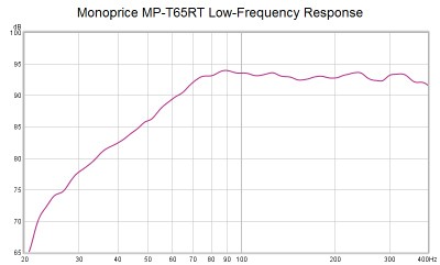

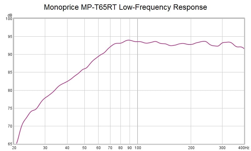

The above graphs show the MP-T65RT’s low-frequency responses that I captured using groundplane measurements (where the speaker and microphone are placed on the ground in a wide open area). The low-end of the MP-T65RT does start to roll-off at around 80 Hz, but it is a shallow slope that will still provide plenty of usable bass below the curve’s elbow frequency in any normal room due to room gain. The slope is too shallow to occur below port tuning. Many tower speakers use this kind of a low-end slope because having a flat response down to a low port tuning frequency can often lead to a bloated bass sound, since room gain can add a considerable amount of boost to the low-end response. The MP-T65RT doesn’t show any signs of having artificially elevated bass that can sometimes occur in cheap speakers as a way of creating a sense of deeper bass than is actually present. The low-frequency response is relatively flat from 80 Hz to past 400 Hz.

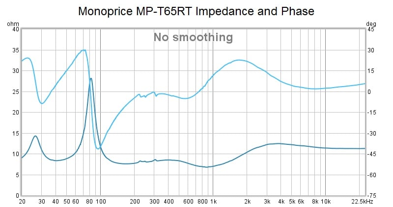

The above graphs show the electrical behavior of the MP-T65RT. What we see is a very easy electrical load for any amplifier. Monoprice rates the MP-T65RT as a 6 ohm speaker, but I would say that is a super-conservative spec. This is very much an 8-ohm speaker and doesn’t even quite have a 6-ohm minima. We can see from the low-end saddle that the port-tuning is around 40 Hz or perhaps just a bit below. We can see from the low-frequency mismatched impedance peaks that the port isn’t loading the woofer optimally, but that isn’t surprising given the design of the speaker. We do see that the planar tweeter has a beautifully steady impedance and phase response. There is evidence of cabinet resonance in the jaggedness of the impedance and phase curves around 200 to 300 Hz. Again, not surprising given the minimal construction of the cabinet. A few pieces of internal bracing or a thicker side-panel would greatly smooth out the curves there, but, of course, that would significantly add to the cost and weight of the speaker.
I measured the sensitivity at 88.2 dB for 2.83v at 1 meter. That is very close to Monoprice’s specification of 86 dB for 1 watt at 1 meter, and, if anything, it is a bit better. That is a fairly average sensitivity for a speaker of this type, which is good news, as a low sensitivity would cripple the dynamic range of this speaker given its somewhat low power-handling ability.

with a speaker that uses a planar tweeter in an MTM orientation, no less. Their
methods of cost-cutting are pretty obvious: the cabinetry is thin, the drivers
are not exactly heavy-duty, and there isn’t really a crossover circuit used,
just a couple high-pass filters. The penalty for this is that these don’t have
the smoothest response on-axis, they don’t quite have the dynamic range that
most tower speakers have, and I do hear some slight midrange congestion. And
then there is the matter of the tweeter, which is mounted so low that it
requires that the speaker be given some unique positioning adjustments to get
its aim level with the listener’s ear. But all speaker design is a matter of

The strengths of the MP-T65RT start with the far off-axis
response, which is phenomenal for a low-cost speaker. If used to the listener’s
advantage, that off-axis response can bestow a nicely-balanced sound. Another
positive attribute is that the bass response is also unexpectedly even-keeled
for a speaker of this cost. The electrical load of the speaker makes it totally
benign for any audio amplifier out there. Its weight makes it a very easy
