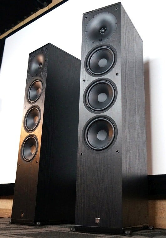

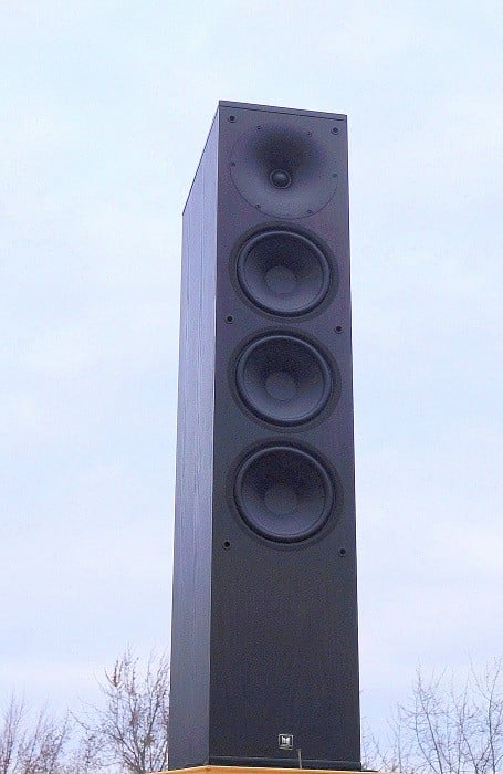

Packing and Appearance

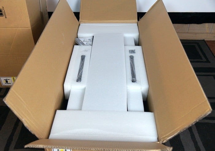

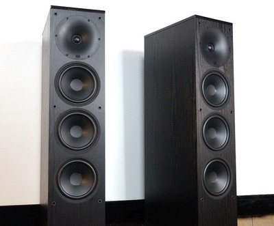

The Encore T6s landed at my home in a thick cardboard box and were generously packed in polyethylene foam from nearly top to bottom. Inside the foam, the speakers were covered in a soft cotton drawstring sack to prevent scuffing and to protect against moisture. That all can’t have been cheap, and it’s nice to see such a level of care and protection for this budget speaker that I sometimes don’t even see on much higher-priced items. Monoprice looks to be very aware of how brutal shipping can be and has packed their speakers accordingly.

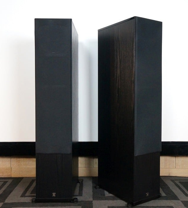

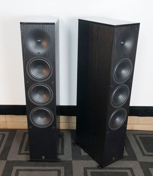

Once unpacked, I was presented with fairly normal-looking tower speakers with some embellishments that wouldn’t be expected for this price range. The veneer was a standard faux black-oak vinyl that is often seen in this class, but the top and bottom of the speaker were capped with some gloss-back end caps. The drivers were all fairly normal-looking and not all that visually remarkable, and they can be hidden with a grille that has a beveled edge. There isn’t a lot to say about the Encore speakers’ appearance; they don’t look bad at all, but they aren’t exciting either. They are innocuous enough that they should be able to blend in just about any normal decor. I would say that they look a tad better than what would be expected for $400 each.

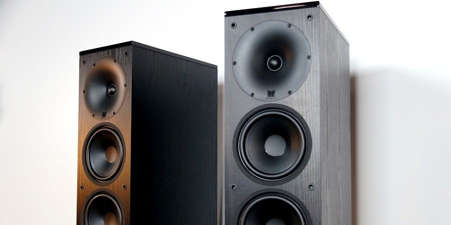

The Encore T6 speakers don’t break the mold of traditional loudspeaker design. Instead, they stick with some fairly tried and true principles. The most noteworthy aspects about them, in my opinion, are the waveguide and the crossover design. Regarding the crossover, the Encore T6 speakers are a 2.5-way design which means that at least one of the midwoofers is not just dedicated to midrange duties but also covers the bass driver band as well. The advantage of this 2.5-way design is low-frequency headroom is increased with the additional woofer. Another advantage of a 2.5-way speaker is the gain in efficiency in low frequencies that can help compensate for baffle step loss. Baffle step loss is the loss of forward-traveling acoustic energy where the lower frequencies radiate out omnidirectionally instead of in front of the speaker. That means that if lower frequencies are emitted out at the same overall energy level as the rest of the range, the speaker might sound thin because much of that energy is not traveling toward the listener but rather in every other direction. By allowing the midrange drivers to tackle low-frequencies as well as mids, it can help to compensate for that loss and give the speaker a fuller sound without resorting to tapering down upper-frequency sensitivity in the crossover circuit.

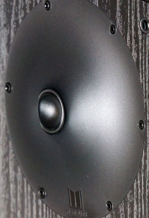

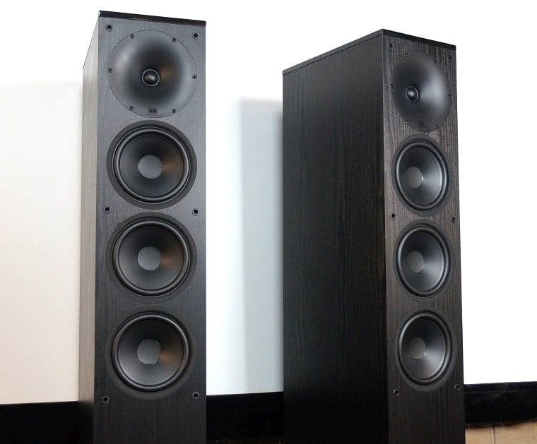

The other interesting aspect of the Encore’s design is the waveguide. The geometry of the waveguide is very important in any speaker that uses them. Poor geometry can cause all kinds of problems that defeat the purpose of using a waveguide in the first place, but good geometry can bring major benefits to the loudspeaker. Some of the problems that can occur are diffraction from the waveguide surface as well as poor directivity control. Diffraction occurs when sound pressure waves reflect off the surfaces of the waveguide and intersect with the direct sound being emitted from the tweeter, which can cause a comb-filtering effect that can be perceived as distortion. Poor directivity control is when sound emitted at off-axis angles has a badly uneven acoustic output. The purpose of a waveguide is to evenly control the dispersion the driver’s output across a wide frequency range as well as raise the acoustic impedance against the driver. For the purposes of waveguides, acoustic impedance can be thought of as the amount of pressure against the driver as it moves in the air. Higher acoustical impedances enable the driver to perform with much greater efficiency.
The Encore speakers look to be using a spherical waveguide. In theory, such a shape should do well at not only loading the tweeter but also having a smooth expansion of the acoustic wavefront that itself expands out as a sphere. The waveguide is loading a 1” silk dome tweeter. Somehow this tweeter can manage a crossover frequency of 1.35kHz which is extremely low, especially for a dome tweeter. While the horn-loading of a tweeter can help it manage lower crossover frequencies by raising its acoustic impedance, 1.35kHz is still unusually low for such a design. One advantage of such a low crossover frequency is that it can provide better directivity matching with the woofer. Normally, 1” dome tweeters cannot have a perfect directivity match with a 6.5” woofer since the tweeters can’t play to low enough frequencies to match a point where the woofer hasn’t significantly narrowed its dispersion. In such cases, when the tweeter takes over, there is a “bloom” of dispersion where the tweeter radiates sound at a much wider angle than the top of the woofer’s frequency band. That is not optimum. Ideally, you’d like to keep the sound consistent at all angles, but the Encore T6’s waveguide should be able to blend in the tweeter much better with the woofer.

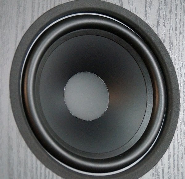

Underneath the tweeter, the Encore T6 uses three identical 6.5” bass/midrange drivers. As was mentioned in our discussion of 2.5-way speaker design, the uppermost driver plays all the way up to the tweeter’s band, while the two lower drivers only play up to 180Hz. This is a good low-pass point for a 2.5-way design for these drivers since that is around where they would become fully omnidirectional. Dual 5-way binding posts allow for bi-amping ability, but that seems like an extraneous feature for a $400 loudspeaker. Few people shopping in this price range would be looking for that feature or would have the extra amps laying around to make it work properly. Monoprice would have been better off just saving the few pennies it took to implement this feature and just have used a single binding post set.

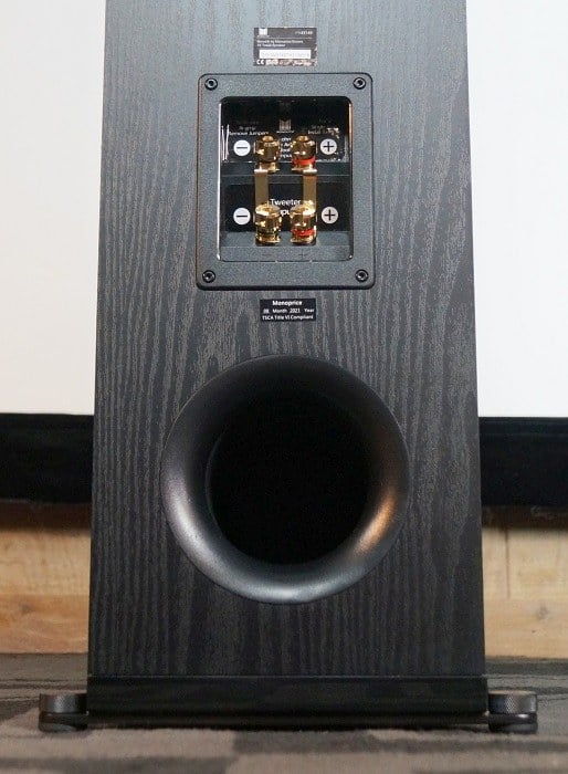

The enclosure is a lot more substantial than what would be expected from a $400 speaker. It is an MDF construction using ¾” thick paneling on all sides and has two windowpane braces that divide the cabinet into three sections. On the lower rear panel, there is an 11” long port with a 3 ½” diameter. That is a seriously large port and, given its proportions, ought to be capable of some real output at deep frequencies. The feet are mounted on an outrigger system that must be assembled when the speakers are unpacked. Users have the option of going with some spiked feet with some floor discs or just rubber feet. The style of feet should depend on the surface that the speakers will rest on, where spiked feet would be better on carpet but rubber will be better for hard surfaces.
Given the size and driver array of the Encore T6 speakers, I would expect it to be capable of some pretty serious dynamic range as well as good dispersion control at off-axis angles. Physically speaking, it’s an impressive amount of speaker for $400 each, but how does it fare in practice? Let’s give them a listen to find out…

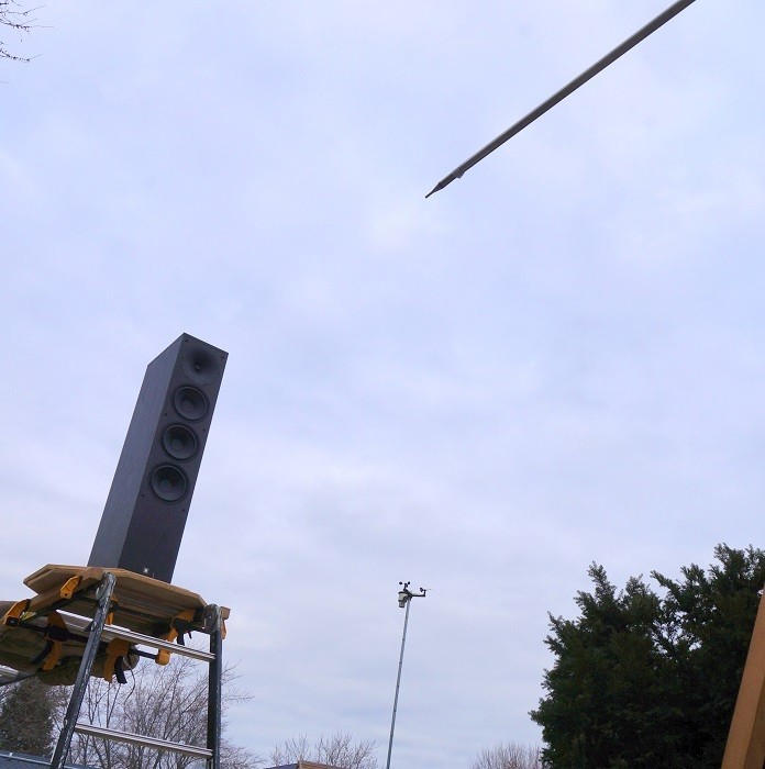

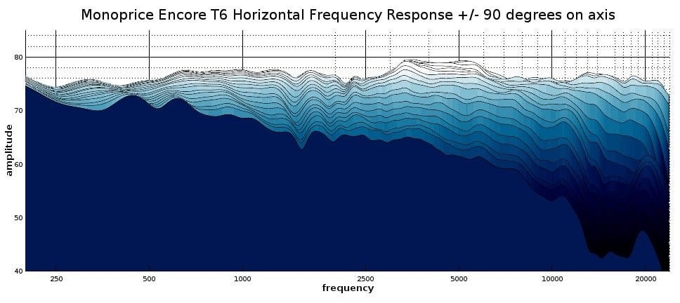

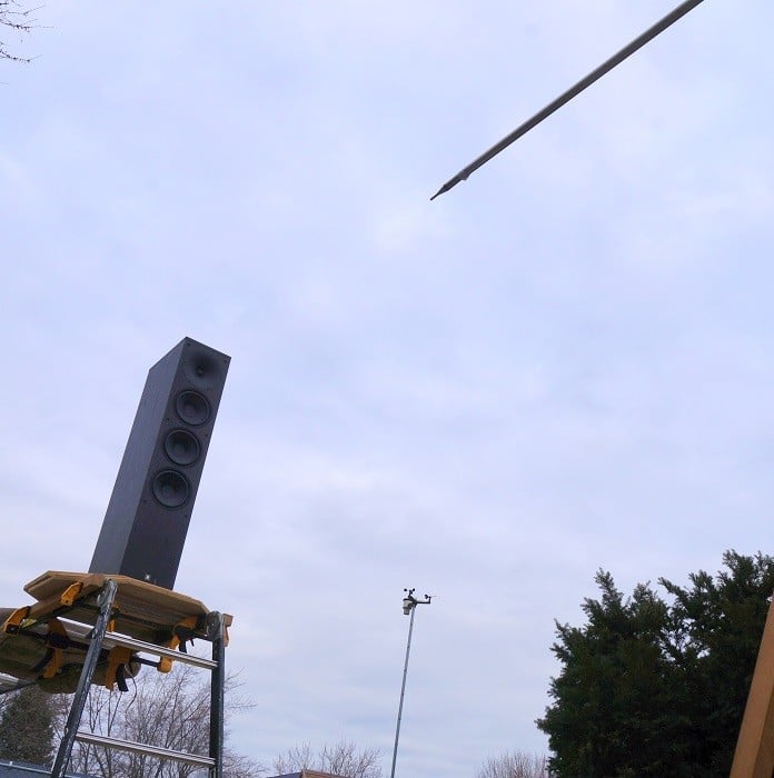

The Monoprice Monolith Encore T6 Towers were measured in free-air at a height of 4 feet at a 2-meter distance from the microphone, with the microphone raised to a 7.5’ elevation that was level with and aimed at the tweeter center. The measurements were gated at 8-milliseconds. In this time window, some resolution is lost below 400 Hz and accuracy is completely lost below 200 Hz. Measurements have been smoothed at a 1/12 octave resolution.

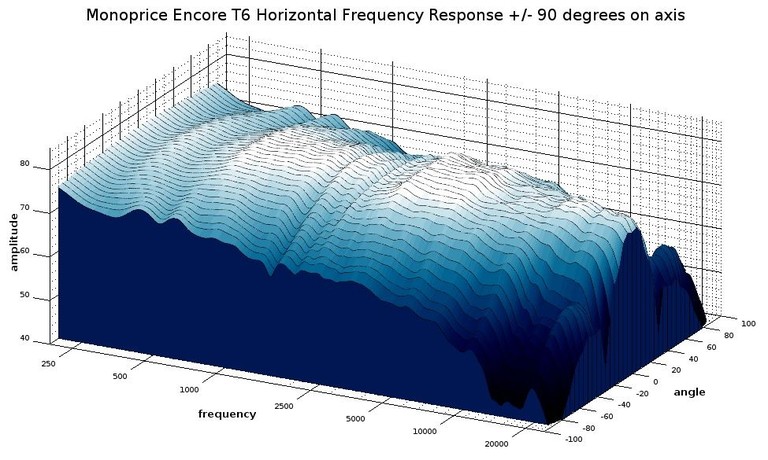

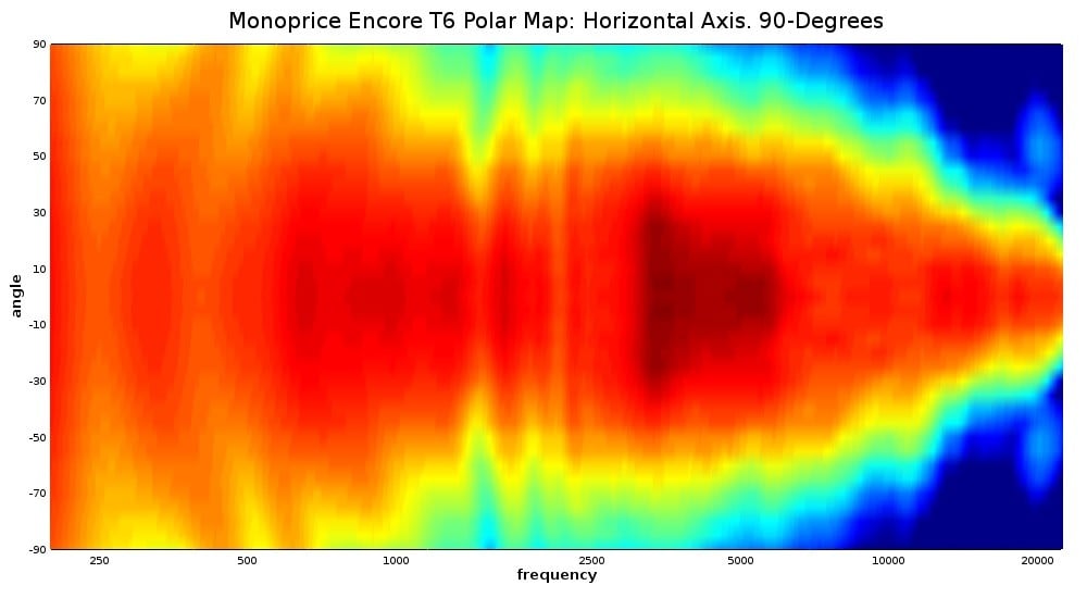

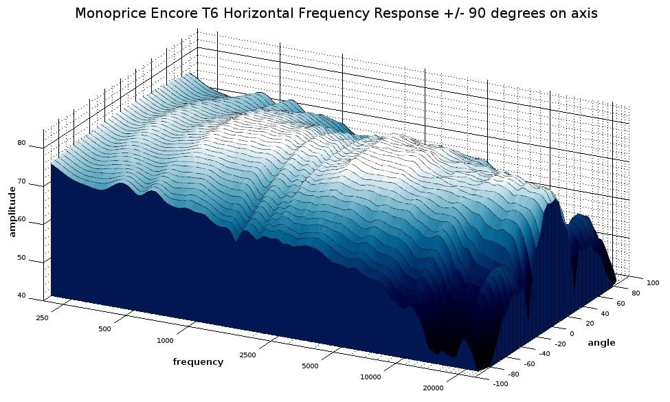

The above graphs depict the Encore T6 tower’s direct-axis and horizontal dispersion out to a 90-degree angle in five-degree increments. Information on how to interpret these graphs can be read in our article Understanding Loudspeaker Review Measurements Part II. The performance shown here is not perfect but overall very good. There is a wide but shallow 3dB rise between 3kHz and 6kHz that occurs at and around the on-axis angle. It may well be audible when compared to a speaker that doesn’t have that elevated range. It should make this speaker a bit more sibilant and forward when compared to something without that hump. I didn’t notice the Encores being especially sibilant in my listening. Aside from the 3-6kHz rise, the response is fairly neutral, much more so than would be expected of a tower loudspeaker in this price range. The elevated range doesn’t really carry out too far off-axis angles, so equalizing it out might leave a slight depression in that range for an in-room sound character, although I would guess it would be mild at worst.
The above polar map shows the same information in the preceding graphs but depicts it in a way that can offer new insight regarding these speakers’ behavior. Instead of using individual raised lines to illustrate amplitude, polar maps use color to portray amplitude, and this allows the use of a purely angle/frequency axis perspective. The advantage of these graphs is they can let us see broader trends of the speaker’s dispersion behavior more easily. More information about interpreting this graph can be read in our article Understanding Loudspeaker Review Measurements Part II.
The first thing to note is that we can see that the waveguide is doing a beautiful job of controlling overall directivity so that there are no large off-axis fluctuations that would drastically change the sound character for any given angle. This quality makes the Encore T6s amenable to ordinary room acoustics, and the user will not need to rely on acoustic treatments to get a good sound from these speakers. This type of dispersion also means that this speaker is suitable to conventional equalization. Some readers might think that statement contradicts statements made above about how unmatching off-axis responses makes this speaker more difficult to EQ, but that is for a finer level of equalization in getting a perfected response for an extremely neutral sound. What the polar map shows us is that we can easily shape the response for broader tonal changes without worrying about whether acoustic reflections will screw up our intended results. Another takeaway from the above graph that we can see is that we could be listening out to a 40-degree angle without missing much at least under 10kHz, meaning this speaker is pretty generous in covering a wide angle with the full spectrum of sound. Above 10kHz, the tweeter does start to beam a bit, but it is not severe, and listeners will be met with high treble in any normal listening position with respect to the speaker.

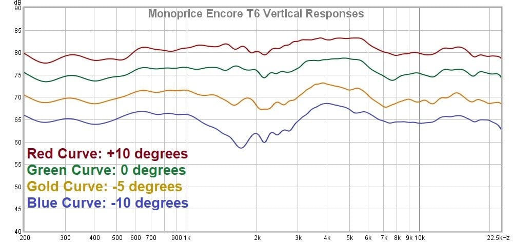

The above graph is a sampling of some of the vertical angle responses at and around the on-axis angle. The response holds pretty nicely at and above the on-axis angle, but not so much when listening below the tweeter axis. The height of the tweeter is set at 36” which should be about where most listeners’ ears would also be situated, but those with low-slung seating might end up at lower altitudes in which case they would not be hearing the T6s at their best. These curves tell us that the best sound occurs at a +/-5 degree vertical angle with respect to the tweeter.

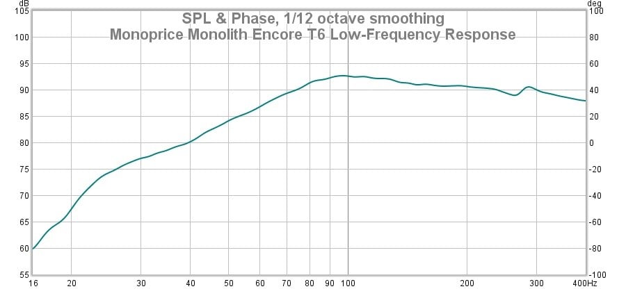

The above graph shows the T6’s low-frequency response captured using groundplane measurements (where the speaker and microphone are on the ground at a 2-meter distance in a wide-open area). Going down in frequency, there seems to be a slight bump in lower mid-bass centered between 90 and 100Hz which is followed by a gentle slope leading to the port tuning frequency that occurs around 30Hz. This is a typical underdamped response that we see from many tower speakers which is done to avoid the bass boost that comes from in-room boundary gain that can make speakers sound boomy. Pressure vessel gain should shore up such a shallow response so that the user will get a solid response down to port tuning. The T6’s are tower speakers with unusually low bass extension for their price point. Few people would really need a subwoofer with these, especially in a small room where pressure vessel gain can be massive. The irony here is that these are budget speakers that could only benefit from the addition of the relatively expensive subwoofers that can competently dig below 20Hz.

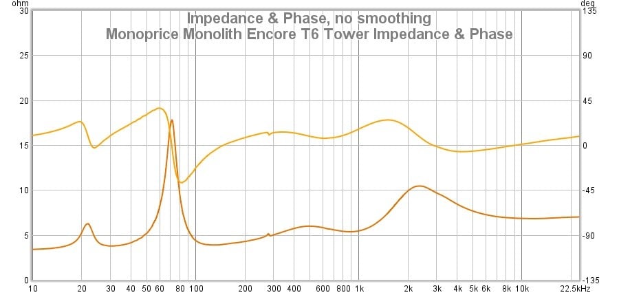

The above graphs show the electrical behavior of the T6 speakers. Monoprice specs these as 4-ohm speakers, and that would appear to be the case, although this is not a very demanding load as far as 4-ohm speakers go. Much of the mid-bass band dips below 5-ohms but not at a very severe phase angle. Most midrange AVRs could handle these speakers without problem. Rocking them hard for a long period with an entry-level AVR might be asking for thermal protection shutdown, however. Some attributes that we can discern from the dip in the saddle of the bass response is that the port tuning frequency seems to be 30Hz as we saw from the low-frequency response graph above. We can also see that the bass drivers have a significantly higher resonant frequency than the enclosure from observing that the bass saddle peaks so much higher at the upper half of the shape.
I measured the Encore T6’s sensitivity to be 89.75dB at 1 meter for 2.83v. This is a bit above Monoprice’s spec of 87.8dB. Either way, sensitivity in the high 80’s is typical for a tower speaker of its size. Megawatt amplifiers are not needed for this speaker to get loud. A typical AVR would be enough to make it rock pretty hard.
