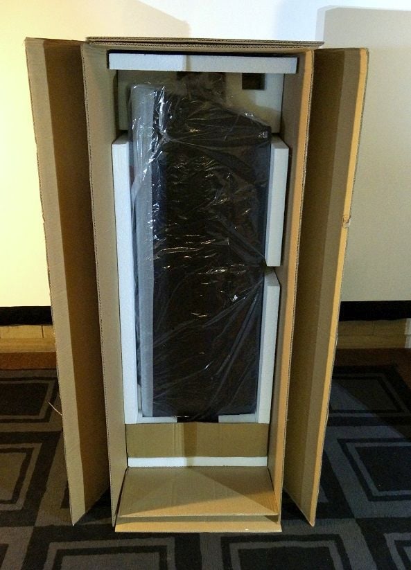

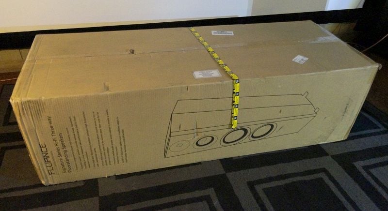

The Signature Towers arrived at my doorstep well packed. They were double-boxed and the speakers were placed in a thick plastic covering and surrounded by large foam blocks. The packaging had taken a beating, and it was obvious that the carrier had not babied these shipments, but the speakers were in mint condition thanks to the smart packing. The manual that Fluance provided is pretty generic and seems to be the manual for all Fluance speakers, but it does give intelligent advice for placement and setup. One part of the setup is the assembly of the outriggers, and Fluance includes instructions for that, so it is a simple and easy process.

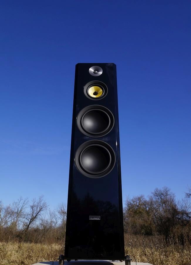

Signature tower image courtesy of Aaron Wallace

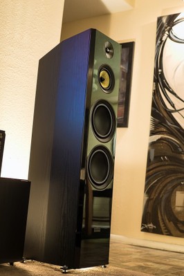

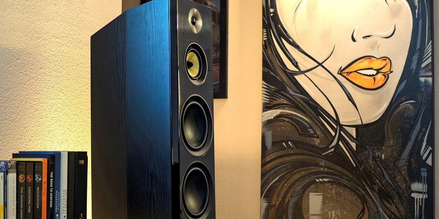

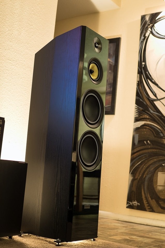

The Fluance Signature Towers are not small speakers, at four feet high, eleven inches wide (fourteen inches wide with outriggers), and fifteen inches deep. They will not disappear in whatever room you place them in. This is not to say they look bad; on the contrary, the tapered cabinet, glossy front baffle, and slick driver array make this speaker look much more expensive than it is. It is a large speaker, but a tastefully finished one. With grille on, the speaker is a black monolith, but a handful of nice touches do distinguish it. The embossed cursive signature at the top and metal Fluance emblem down below are aesthetic touches one would expect to find on pricier speakers, as are the polished wire posts on the back. Even the floor spikes on the outriggers look attractive. My favorite visual element here is the sleek bass drivers. I can’t think of a nicer looking tower speaker at this price. It may be that, given the speaker’s sheer size, Fluance had to go the extra distance in terms of aesthetics to make this a more acceptable speaker for more people.

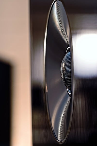

Signature tower driver images courtesy of Aaron Wallace

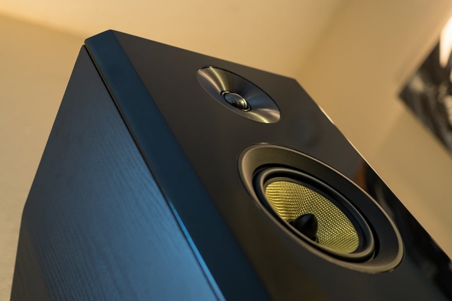

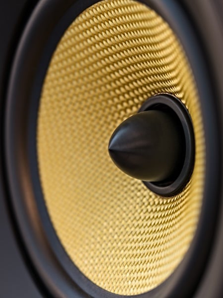

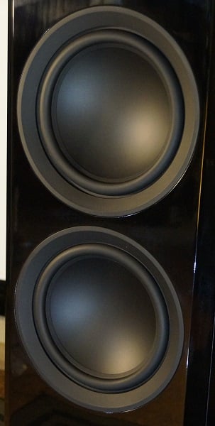

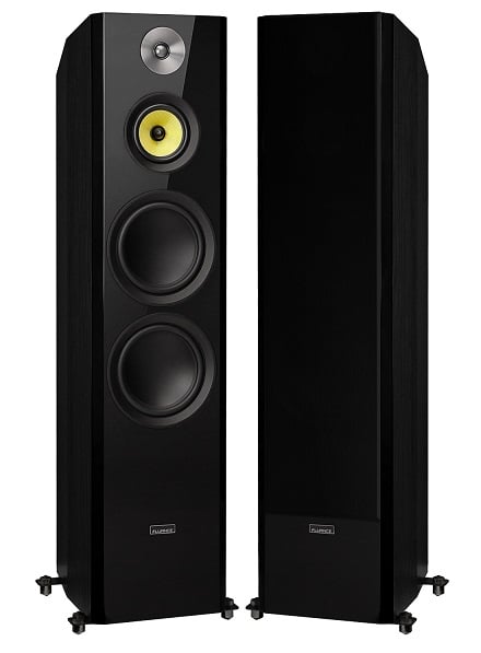

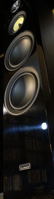

The “Three-Way” in the Signature Tower’s name is split between two 8” woofers, a 5” mid-woofer, and a 1” dome tweeter, with crossover frequencies at 530 Hz and 2,600 Hz. The 8” bass drivers use polypropylene cones and are claimed to have ‘long throw’ by the marketing literature, but I am not sure what their definition of ‘long throw’ is. Nonetheless, two 8” woofers would seem to offer more displacement than other similarly priced tower speakers. The 5” glass fiber woven mid woofer uses what Fluance’s literature calls a “pointed dome” but, since it is fixed to the pole piece, it is really a phase plug; as long as it serves to improve the driver’s performance, I don’t care what they call it. The 1” silk dome tweeter is embedded in a shallow metal waveguide and uses a neodymium magnet and ferrofluid cooling which are fairly standard features of dome tweeters these days. Notably, one of the complaints of the first Signature Towers was that the bass-to-mid crossover was too high, at 1,200 Hz, which allowed the mid-woofer to only play a relatively small range of frequencies, but we see this has been rectified with a more sensible 530 Hz.
The cabinet build quality is not bad considering the price. The enclosure is MDF, of course, and Fluance calls it “audio grade MDF” (first time I have heard of that grade of MDF). The side and rear panels are 0.7” thick, and the front baffle is a more impressive 1.4” thick. Window bracing is used in the cabinet, and one nice touch is that the drivers have separate internal enclosures. The mid-woofer and tweeter occupy their own sealed compartments in an effort to keep other driver’s back waves from interfering with their smooth operation. The speaker is bi-ampable for those who want to amplify the bass section separately from the midrange and tweeter section. This may help to reduce distortion slightly. The cabinet is chock full of polyfill for damping internal waves. Two 3” ports are flared on both ends and have netting covering the internal end that keeps stuffing from blowing out and objects (or critters!) from entering the cabinet. This looks like a good idea for those with children who like to hide things; most of the stuff they can cram in the ports won’t fall into the cabinet. The Signature Towers come with a very sturdy set of outriggers. The outriggers use floor spikes, but the spikes do not have a sharp tip, so they should be safe to use on hard floors without being a scratching hazard. The cabinetry is not as heavy-duty as one sees in higher-priced speakers, but it is good for its price, and there is some details in its construction that go beyond what you expect to see for the cost.

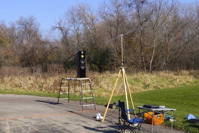

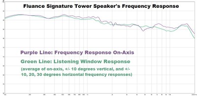

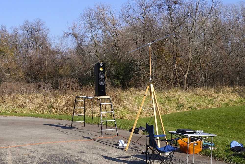

The Fluance Signature Tower speakers were measured in free air elevated to a height of approximately 4 feet and gated at 9 ms. At this windowed gate, accuracy is lost below 111 Hz and so lower bass frequencies below that point should be ignored. The microphone was placed 2 meters away from the speaker at a height level just below the tweeter. The below graphs use 1/24 octave smoothing.
Fluance Signature Tower Frequency Response (2 meters outdoors)
The frequency response of the Fluance Signature Towers can’t really be called neutral, however there isn’t anything very worrisome here either. This speaker has deliberately been voiced for a ‘warm’ sound, i.e, the treble is a bit lower than the bass. This is not unusual and can give recordings a slightly recessed response, but it can also take some of the edge off of a harsh recording and can be a less fatiguing speaker to for long listening sessions. A speaker with hotter treble might be able to provide a more detailed sound, however, between a speaker with elevated treble and a speaker with lowered treble, I will take lowered treble since too much treble can make for a hollow or tinny sound, although I would prefer a flat response. The first Signature towers were criticized for their heightened treble, but the frequency response from these re-launched Signature Towers certainly do not suffer from this anymore. A response like this would be good for those who want to throw on a rock album or a dance mix and listen to it all the way through, since it will be a less harsh experience than other speakers. For those who are looking for very high accuracy or who want catch every detail in a recording, there are better choices. The good news is there isn’t any abrupt peaks or resonances, which are the more egregious flaws. The ‘Listening Window’ curve indicates very little deviation of the near off-axis to the direct axis, so this speaker should sound good over a broader area than a narrow ‘sweet spot’ of seating.

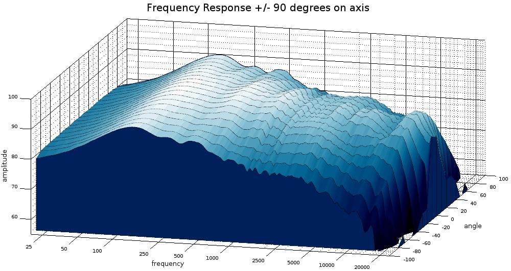

Fluance Signature Tower speakers horizontal frequency response +/-90 degrees from axis: 3D view
Fluance Signature Tower speakers horizontal frequency response +/-90 degrees: 2D view

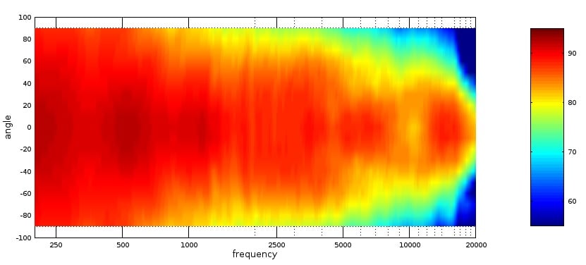

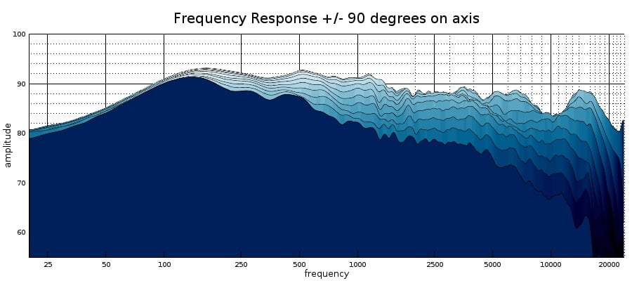

For the horizontal off-axis response of the Fluance Signature Towers, the outer angles follow the on-axis fairly well, which is a desired quality off axis. The sound of the Signature Towers off-axis does not differ much from the on-axis sound, except of course, for the roll-off of the high frequencies. The dispersion pattern evidenced by this graph indicates that the Signature Towers would cover a relatively wide area with a decent response, meaning that this is not a speaker that only sounds good in one listening position. This is good dispersion for who need good coverage over a broad area. One thing to note about this graph is that there is a 5 dB dip around 10 kHz. These measurements were taken on-axis with the tweeter, and that dip occurs at that height. This isn’t a serious concern because the tweeter is mounted so high on this speaker, that a seated listener’s ears is likely to be around the mid-woofer height. When the Signature Tower speaker is measured at the mid-woofer height, the 10 kHz dip disappears.
Fluance Signature Tower Polar Map
The above Polar Map shows the same data as the horizontal responses above, but from a top-down view using color to indicate amplitude. What can be seen in this graph of the Signature Tower horizontal measurements that is not as easy to see in the others is a narrowing of the dispersion around 6 kHz, which is a consequence of the ‘warm’ voicing, meaning that the high frequencies above that point are not quite as widely emitted as lower frequencies. This will also contribute to the warm sound of the Signature Towers, since there won’t be quite as much high frequency reflection off of surfaces in-room.

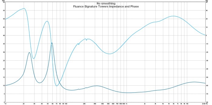

Fluance Signature Towers Electrical Impedance and Phase
For the Impedance spec on the Signature Tower’s product page, they simply state “8 ohm compatible”, which I assume to mean they are compatible with amplifiers rated only down to an 8-ohm load. From examining the impedance graph, I would not dispute that. Even an entry level AVR should be able to drive the Signature Towers with no problem. The impedance minima is 5.7 ohms, but these speakers do not require special amplification or a heavy-duty amplifier.
Fluance states an 89 dB sensitivity spec, but they do not say whether that was taken at 2.83v or 1 watt (this important distinction is discussed in our loudspeaker sensitivity article). Our measurements show an 87.8 dB sensitivity for 2.83v, which would be very close to what Fluance has, especially if they mean 1 watt. This means that it does not take a beefy amplifier to get this speaker loud. A 60 watt amplifier would be enough to pierce one’s ears with the Signature Towers.

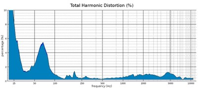

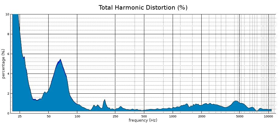

Total Harmonic Distortion for Signature Towers at 95 dB drive level
The Total Harmonic Distortion graph above shows fairly good performance. Pictured are both the 90 and 95 dB level distortion profiles, and they are nearly identical. These tests were not done in an anechoic chamber, so background noise may have a slight contribution here. Even at these loud drive levels, distortion is mostly kept under 1%, except for the bump centered around 70 Hz, which is where the woofers are driven the hardest. The dip in distortion below that peak is the ports taking over from the woofers, and alleviating them of the need for high excursions, so distortion drops markedly. Even that peak is not bad; 5% harmonic distortion at such a low frequency is very unlikely to be audible, especially since it is composed mainly of 2nd and 3rd harmonics much, which is far more audibly-benign than higher order harmonics. Distortion might have been reduced a slight bit more if we’d tested it in a bi-amped configuration, but this is already a good showing, so I would say that bi-amping is not needed. Overall, this is a good picture of performance with no real problems evident. The Signature Towers offer very clean performance across their frequency spectrum.
