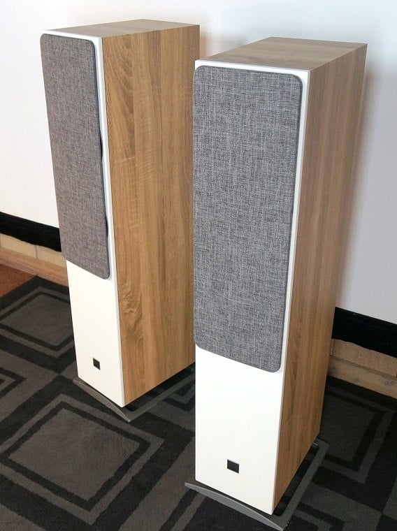

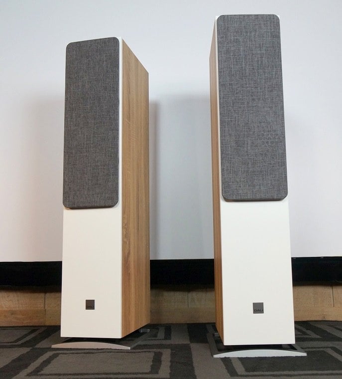

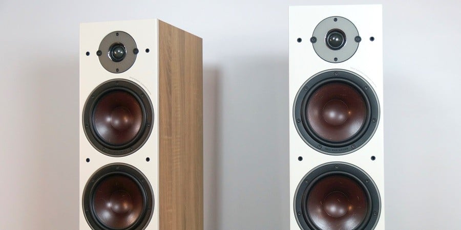

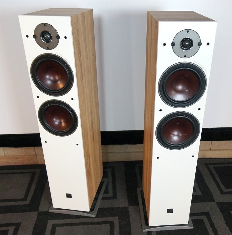

The OBERON 7C comes in four finishes: matte white, dark walnut, light oak, and black ash. I received the light oak finish, although the veneer does not extend to the front baffle, which is matte white. In the light oak, the OBERON 7C looks upbeat compared to so many speakers that are merely black boxes or, if they have a wood veneer option, it is an overly conservative one. I would say this makes the OBERON 7C a good choice for white-painted interiors as is found in so many homes. The veneers are laminates, but they are pretty convincing imitations, and it wouldn’t be noticed unless you gave the speaker a very close inspection. The grilles have a grey weave fabric that gives the grilled appearance more character than the usual black fabric grilles. While I think these speakers look a bit better without the grilles, the grilles don’t look bad on these models. The enclosure has some slight rounding on the vertical edges of the front baffle, but otherwise, the shape is just a rectangular box. The most notable feature of the exposed drivers is the plum coloration of the woofer cones. This is a visual signature of DALI speakers, which all have this cone correlation, much like Klipsch is known for their copper cones. The tweeter is a dome mounted in a sizable plate that has a dotted pattern printed on it. The enclosures stand on some curved metal plinths which complement the speakers nicely. Overall, the OBERON 7C speakers look tasteful without being boring, and they could fit in easily with a wide variety of interior decors thanks to the variety of veneers and refined industrial design.

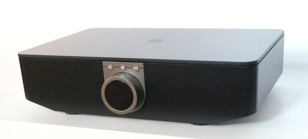

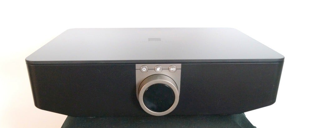

There isn’t too much to say about the looks of the Sound Hub, except that it doesn’t look bad either, thanks to its minimalist design. Obviously, it won’t have as much aesthetic impact as the speakers. It’s a glossy plastic module that is mainly distinguished by a large volume knob in the unit’s center. The LED display is centered within the volume knob, which is a neat touch.

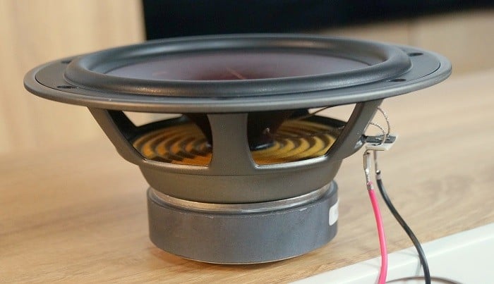

driver close up

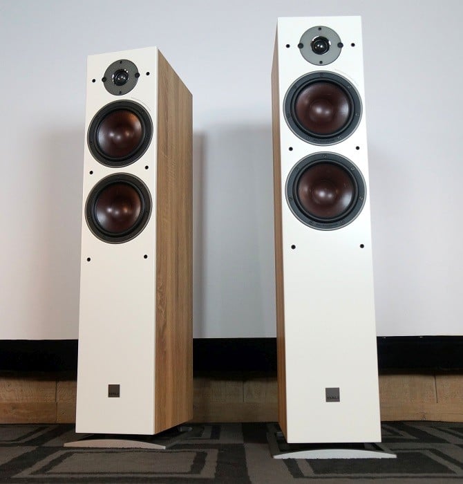

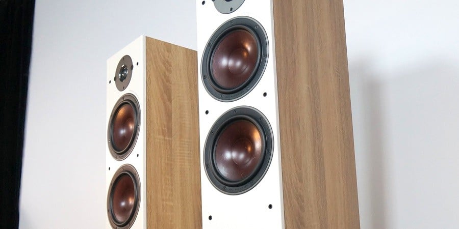

Let’s start our analysis of the system design by talking about the OBERON 7C loudspeakers. They are two-way, self-powered, floor-standing loudspeakers set that can only take wireless signal input produced by the DALI Sound Hub or the less expensive and smaller Sound Hub Compact. The OBERON 7C uses two 7” bass drivers and a 1” dome tweeter. Curiously, the bass drivers are powered by a 50-watt class-D amplifier and the tweeter is powered by another 50-watt class-D amp. This is unusual because one would think that the bass drivers would require a lot more power than the tweeter to produce the same SPL, so only providing 50-watts is robbing them of some headroom that the system could otherwise deliver. DALI may have opted for using a 50-watt amp for the woofers for ease of manufacturing and cost. Nonetheless, the amplification should give the system enough headroom to satisfy most buyers.

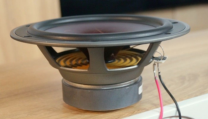

bass driver

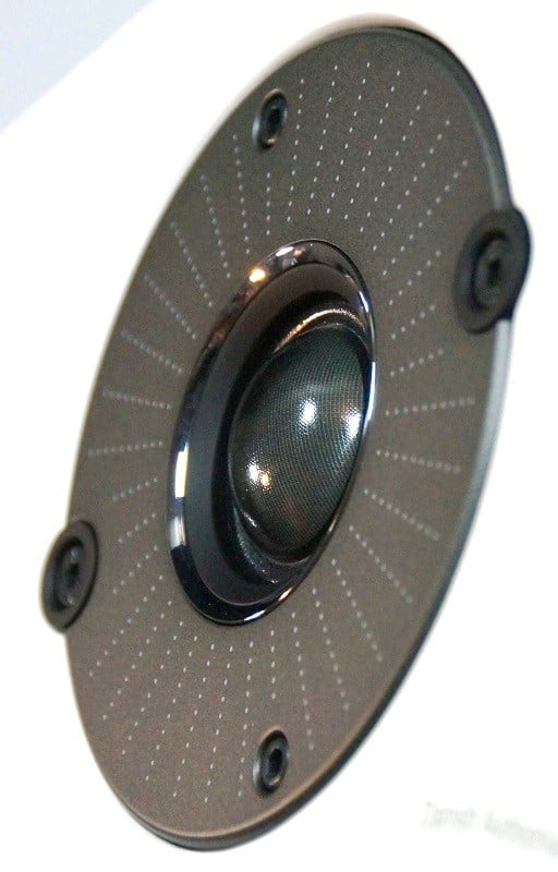

The OBERON 7C tweeter is a 1.1” fabric dome that uses an iron ferrite motor and ferrofluid in the voice-coil gap for greater thermal handling. The bass drivers’ cones use a composite of fine paper pulp and reinforcing wood fibers. One interesting aspect of the bass drivers occurs in the motor section with the use of SMC or Soft Magnetic Compound. SMC is used in the motor section around the gap where the voice coil rests. What SMC does is transmit the magnetic field without being electrically conductive. The advantage in that is a major reduction in eddy currents and hysteresis and thus reduction in odd-order harmonic distortion and an increase in upper-frequency sensitivity. For those who want the gory details about SMC use in drivers, DALI has this page that describes it, but the reader can also refer to the patent for a more precise description. The motor uses a reasonably sized 3 ¼” diameter magnet with a ¾” thickness and is vented through the pole piece.

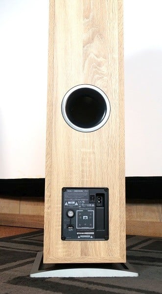

tweeter2  rear
The grilles attach to the speakers using pegs. Unfortunately, the grille frame design has large solid pieces that surround a honeycomb pattern over the drivers. While it does a lot to actually protect the drivers, it is a suboptimal design for how the sound diffracts off of the front baffle and grille frame. While leaving the grilles off of the speaker for the best sound is almost always the best way to go for any speaker, it is even more true for this speaker.

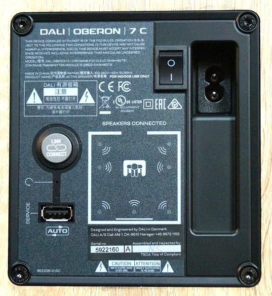

The OBERON speakers were easy to pair up with the Sound Hub. All I had to do was press the ‘LINK’ button on the Sound Hub, then press the ‘LINK’ button on the speaker, and when they established a connection, I selected what channel it should receive on the Sound Hub. The Sound Hub’s instruction manual was a bit vague and ambiguous, but the instruction manual on the Sound Hub online product page is much more articulate, so I would advise users to refer to the website’s manual. The Sound Hub can take input from almost any source that exists except for balanced analog inputs. It can accommodate unbalanced RCA, optical TosLink, S/PDIF COAX, 3.5mm mini-jack, and wireless Bluetooth. There is an expansion slot that adds optional connectivity. One module is a BuOS module that can enable ethernet and WiFi connectivity as well as USB inputs that allow sound files to be played from a USB drive. There is another similar module that does all of the same things but also adds Apple’s AirPlay2 streaming. There is also an HDMI module available for HDMI connectivity including HDMI ARC and eARC signals.

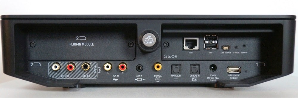

The Sound Hub has an unbalanced RCA left and right outputs as well as a subwoofer output, so it can be used as a 2.1 preamp if desired. It does mute the wireless output if it detects a connection on the RCA outputs. If HDMI connectivity is used, the Sound Hub can emit eight channels of signals; so it can handle a 7.1 system. If the user is inputting a higher channel signal than the number of speakers that are actually connected to the Sound Hub, it will downmix the output appropriately.
The Sound Hub can adjust the speakers individually for level and distance. The crossover frequency used for the sub output is 100Hz, and that seems to be the extent of the bass management. I would like to have seen more options for bass management. The subwoofer output can be sent both wirelessly and through the RCA sub out. DALI offers a wireless subwoofer signal adapter called the WSR that receives the wireless signal and converts it to an ordinary RCA output, so it can be used with any subwoofer. The Sound Hub can only transmit to one WSR, so the sound hub cannot output to multiple subwoofers itself. If the user wants to employ multiple subwoofers, they will need to use a signal splitter on the output of the WSR.
rear panelThose who want to take advantage of the surround sound capability of the Dali Sound Hub must purchase and install the optional HDMI Module (as well as the extra speakers for those channels). Once installed, the Sound Hub can handle ARC and eARC signals and decode Dolby and DTS sound formats for surround sound up to 7.1 channels. There is no support for the extra channels of Dolby Atmos or DTS:X, but the Sound Hub does support DTS HD Master Audio and Dolby TrueHD. Dolby signals will be post-processed by the Dolby ProLogic I or ProLogic IIx codec, depending on user selection, while DTS and PCM will be post-processed by the DTS Neo:6.Cinema Codec. The module can also be configured to upmix the sound up to a 7.1 system or simply route the signals to the intended channels with no upmixing.
Controls for the Sound Hub are pretty simple. There is a large volume dial, and three buttons above it: a stand-by button, a source selector, and a mute button. The Sound Hub comes with a remote with the same set of controls. The center of the volume dial has an LED display that shows the volume level as well as the selected source. The brightness of the LED display in the volume control can be adjusted. Setting up the Sound Hub with the OBERON speakers was not difficult, but I did have to refer to the user manual since the quick start guide’s illustrated steps were a bit too ambiguous for me to follow.

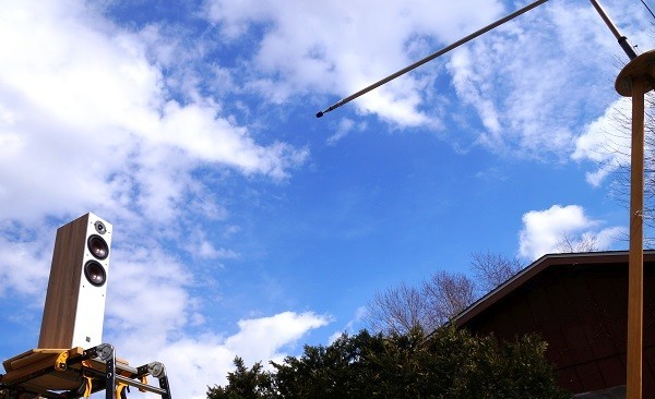

 oberon 7c outdoor measuring

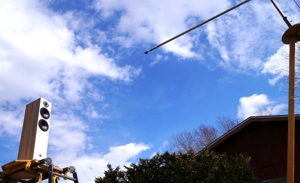

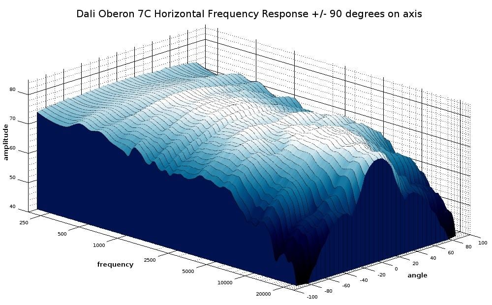

The DALI OBERON 7C towers were measured in free-air at a height of 4 feet at a 2-meter distance from the microphone, with the microphone raised to a 7.5’ elevation that was level with and aimed at the tweeter center. The measurements were gated at 8-milliseconds. In this time window, some resolution is lost below 400 Hz and accuracy is completely lost below 200 Hz. Measurements have been smoothed at a 1/12 octave resolution.
7c 3D waterfall response
7c 2D waterfall response

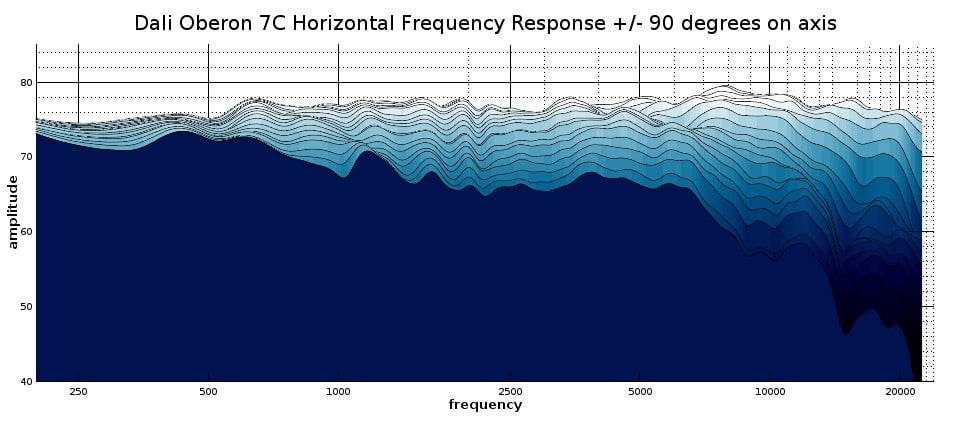

we have a nice neutral response,and the OBERON 7Cs will deliver a sound that is faithful to the source material.
The above graphs depict the OBERON 7C tower’s direct-axis and horizontal dispersion out to a 90-degree angle in five-degree increments. Information on how to interpret these graphs can be read in our article: Understanding Loudspeaker Review Measurements Part II. The measured response here is very good. The on-axis response keeps to a fairly tight window, deviating slightly with a small peak at around 8kHz which would scarcely be notable. The off-axis response keeps to a respectable correlation to the on-axis response except in upper treble where the tweeter starts to beam above 7kHz. The beaming pattern is very common to dome tweeters with no waveguide. Overall, we have a nice neutral response,and the OBERON 7Cs will deliver a sound that is faithful to the source material.

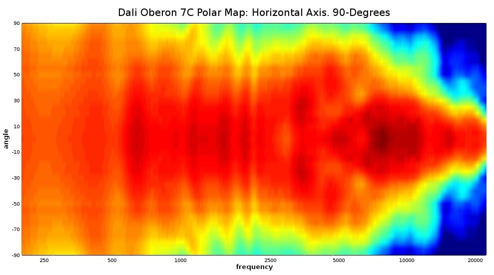

7C polar map
The above polar map shows the same information in the preceding graphs but depicts it in a way that can offer new insight regarding these speakers’ behavior. Instead of using individual raised lines to illustrate amplitude, polar maps use color to portray amplitude, and this allows the use of a purely angle/frequency axis perspective. The advantage of these graphs is they can let us see broader trends of the speaker’s dispersion behavior more easily. More information about interpreting this graph can be read in our article: Understanding Loudspeaker Review Measurements Part II.
The OBERON 7C speakers hold a fairly consistent dispersion pattern up to 7kHz where the treble dispersion starts to narrow. There is some mild waist-banding centered around 2kHz, but it isn’t severe enough to have a big impact on the sound. The treble beaming doesn’t become very narrow until well above 10kHz where it doesn’t matter very much. If you want to get hit with the full range of treble, it's best to be listening at or close to the on-axis angle. It should be remembered that there isn’t much content above 12-15kHz, and many people, especially older men, no longer hear frequencies that high anyway. Curiously, DALI recommends positioning the speakers to face straight ahead so that they are angled in a parallel direction. That would put the listener in a 20 to 30-degree angle from the on-axis direction where upper treble does see a roll-off. However, the most accurate response occurs around the on-axis angle, and I would recommend listening within a 20-degree angle of that direction. My advice is to have the speakers face the listener directly.

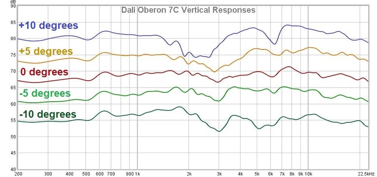

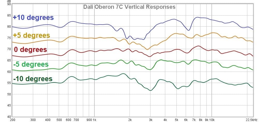

7C vertical responses
The above graph is a sampling of some of the vertical angle responses at and around the on-axis angle. The OBERON 7C holds the flattest response at the tweeter height, but the response isn’t too badly affected out to a 5-degree angle above or below that point. However, the response does take some pretty substantial deformations outside of that range. This is not unusual for a loudspeaker with this type of driver layout. The takeaway here is that the OBERON 7C is best listened to with the ears pretty close to level with the tweeters, much like many other loudspeakers.

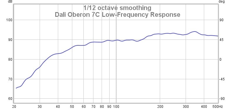

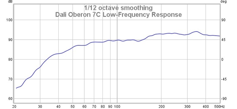

7c low frequency response
The above graph shows the OBERON 7C’s low-frequency response captured using groundplane measurements (where the speaker and microphone are on the ground at a 2-meter distance in a wide-open area). This response is fairly well-controlled and exhibits a bit more upper bass output than lower bass. The room will inevitably boost lower bass, so this is often done in tower speakers in order to compensate for the room gain-induced bass boost. The port tuning frequency looks to be around 35Hz, and typical pressure vessel gain from domestic spaces should yield usable bass down to 30Hz, a very respectable low-frequency extension for a modestly-sized tower speaker.
7c outdoors6Before bringing this review to a close, I will briefly go over the strengths and weaknesses of the product under review, and, as always, I will start with the weaknesses. Taking a broad view of the OBERON 7C and Sound Hub system, I don’t have much to complain about. However, there are a few minor things I things that I think could be improved. Firstly, one nice touch would have been to have the OBERON 7C speakers accommodate analog inputs. That would have made them so much more usable across a wider array of systems. As it is, DALI’s Sound Hub or Sound Hub Compact is required to operate the OBERON 7C speakers, and the speakers only accept a Bluetooth connection from those transmitters as an input signal. If DALI had given the OBERON 7Cs some RCA or XLR inputs, anyone with a DAC could have used these speakers. An added bonus to accepting analog inputs is that if in the future, the Sound Hub breaks or loses functionality, the OBERON speakers would still be useful. But with the way DALI has chosen to design these speakers, if the Sound Hub to the user’s system goes bad and they aren’t able to get another, the entire speaker system is bricked. Analog inputs are a feature on DALI’s step-up series, the RUBICON C series, and it’s a shame that feature didn’t make it to the OBERON series.
