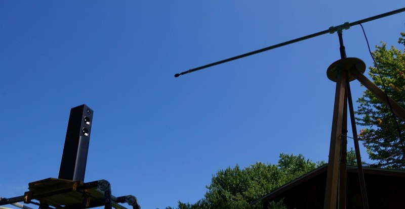

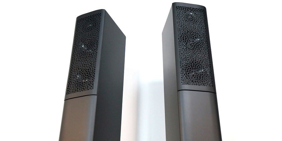

The speaker system that we are reviewing today, the Starke Sound VLOT, attempts to bridge the gap between lifestyle audio systems and performance-centered audio systems. It is a traditional loudspeaker design at a glance but has the convenience and simplicity of regular Bluetooth speakers and soundbars. It is a speaker system that has a built-in amplifier, pre-amp, and Bluetooth receiver. It is not a large speaker which makes it palatable for many buyers, but it bears signs of serious loudspeaker design. So the question that it poses is can we have the best of both worlds: simplicity and convenience as well as a true high-fidelity sound? Let’s dig in to find out…
Packing and Appearance
The VLOT speakers arrived double-boxed and packed with polyethylene foam pieces that protected all of the edges. The speakers were covered in cotton sacks to protect them from moisture and scuffing. The packing was above average for loudspeakers of this size and should be well-protected against the rigors of typical shipping practices.

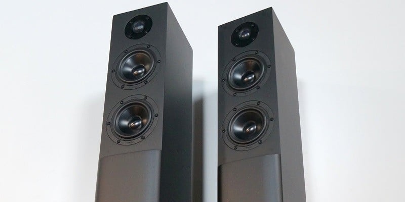

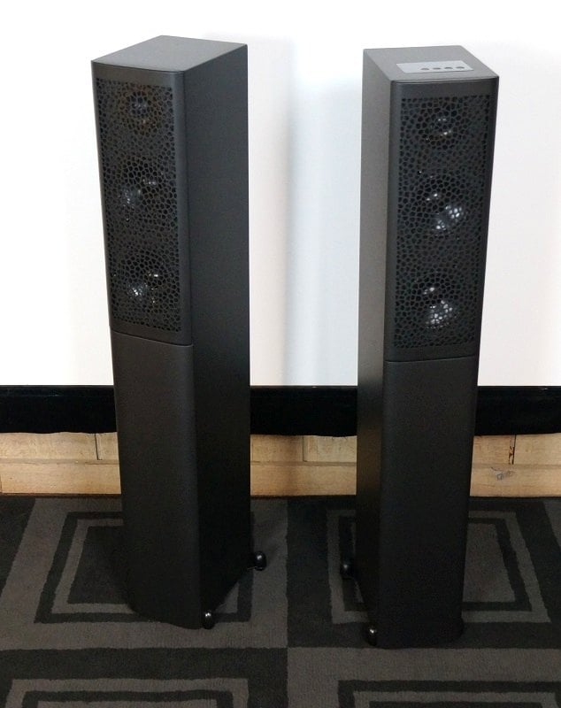

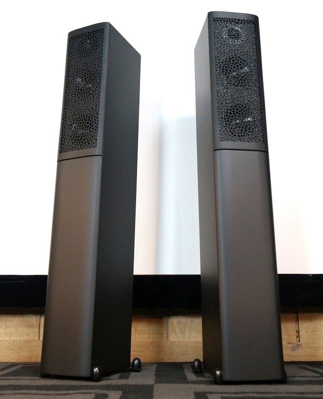

VLOT upgraded finish.jpgOnce unpacked, I was presented with two fairly normal-looking satin black speakers. Without grilles, they are rather undistinguished in appearance: not bad but not particularly distinctive. They are on the smaller side of floor-standing speakers with a rounded lower front-baffle and two smaller woofers below a dome tweeter. The grilles are the visual elements that separates them from other loudspeakers; they have an irregular mosaic pattern that I have not seen on any other speaker. It’s not especially conspicuous in the black finish since it is black-on-black, but it looks to be more prominent as a visual feature in the other finishes. I can appreciate it as something that gives the VLOT speakers some style, and I think that most people would be fine with it in the black finish since it is a bit more subdued there, but it would be a bolder element in the other finishes. The unique grille pattern is probably better for them on the whole since it aesthetically sets them apart from so many other speakers. The VLOTs can also be had in satin white as well as a special edition finish that uses a Macassar wood veneer that has a $300 surcharge. What will make the speaker more acceptable for other household members is not the styling but the size; these are narrow speakers that do not have a large footprint.
Design Analysis

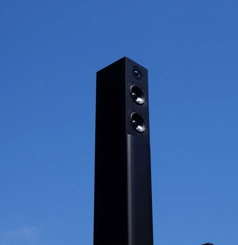

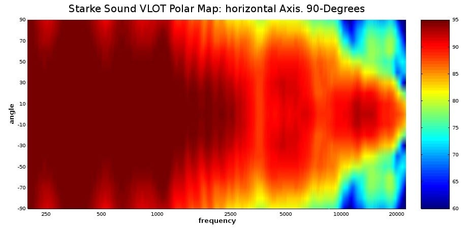

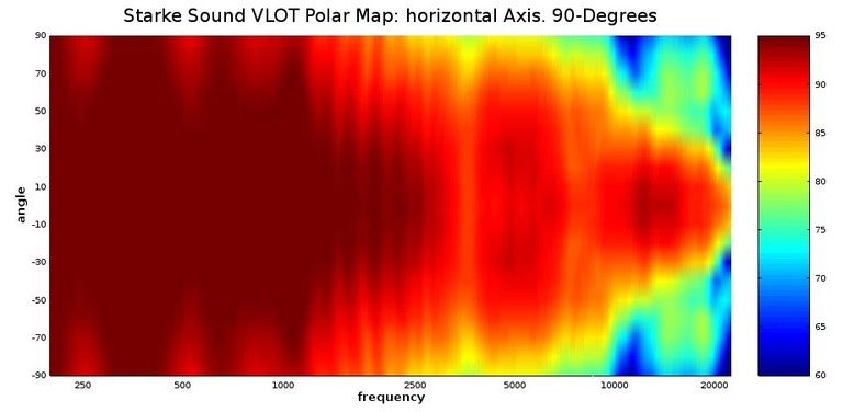

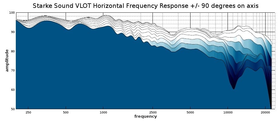

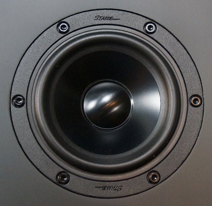

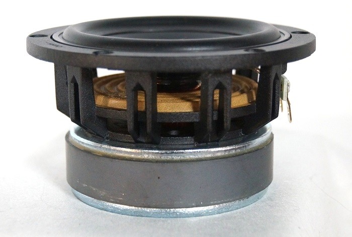

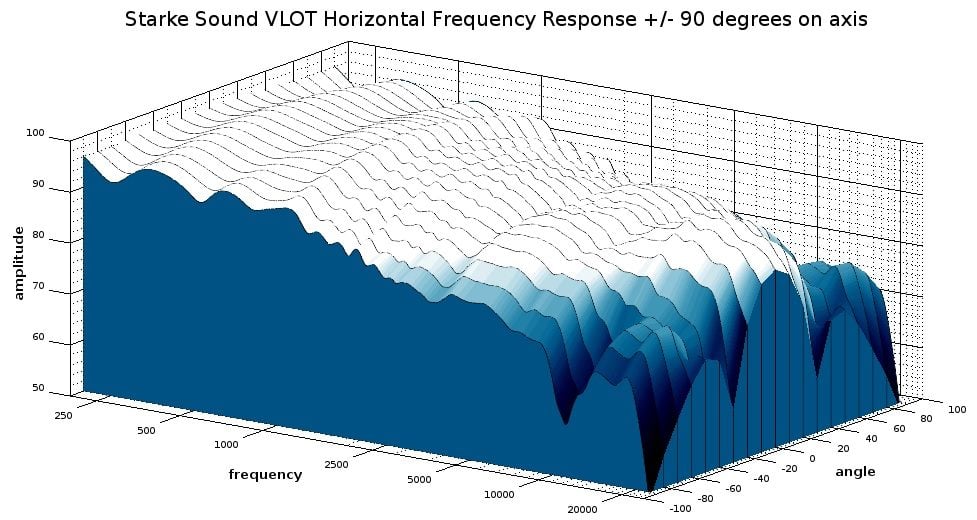

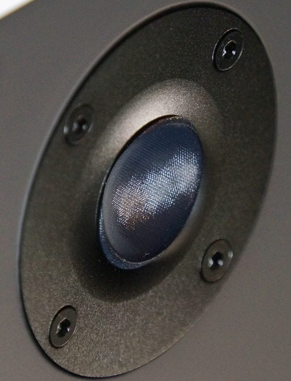

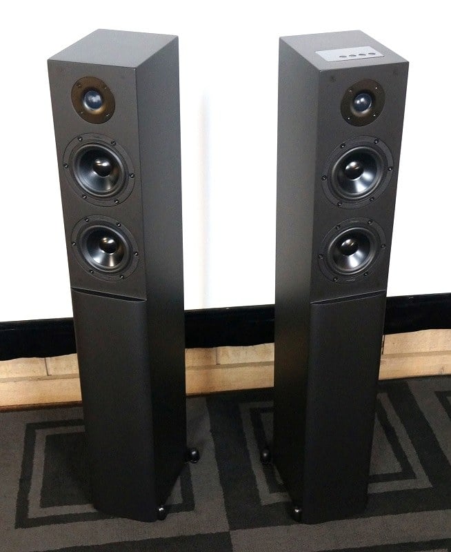

The Starke Sound VLOT speakers are a swiss army knife solution to audio systems. For small tower speakers, they can do an awful lot. To get into the design of them, let’s start with the actual speaker part of these speakers, in other words, the transducers. They use two 4” mid-range drivers along with a 1” fabric dome tweeter. The woofers have a fairly beefy motor considering the 4” cone size. They cross over at 3,900Hz using a passive crossover circuit, so the onboard electronics are not used in the crossover. That seems like a missed opportunity, but Starke Sounds say it was done to keep a lower noise floor and to ensure a higher quality system by not having the acoustic components rely on the electronics for a good sound. I can attest to the low noise; there is a soft hiss if you put your ear right up to the tweeter, but the speakers are silent at any reasonable listening distance.

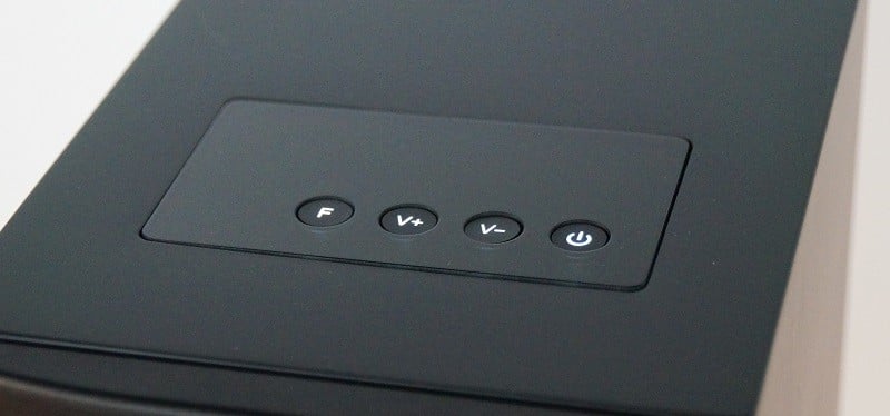

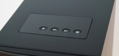

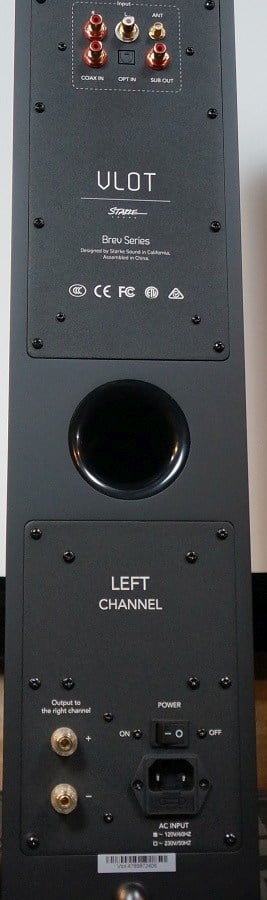

VLOT back plate.jpgThe front baffle of the MDF enclosure uses a ⅞” thick mount for the drivers and has multiple braces throughout the cabinet as well as some acoustic stuffing. The side panels are ½” thick and don’t need to be very massive since it is a small speaker that uses internal bracing. It is a rear-ported enclosure with a 2” diameter flared port with a 4 ¼” length. The feet are some plastic rounded cones mounted on some outriggers. The outriggers don’t let the speakers tumble over easily from brushing up against them, however, a rambunctious child, zooming dog, or inebriated adult would topple over one if bumped into with some force. It would be a good idea to keep the VLOTs away from heavily traveled paths in your home.
Each channel is driven by a 150 watt RMS Class-D amplifier, a lot of power considering the transducers used. Only one speaker unit has the amplifiers built-in, and it connects to and powers the other speaker by way of an included 8’ speaker cable that is flat so as not to cause a bulge under any rug that it might be run under. Of course, as a full sound system, the VLOT also has a DAC and uses a 32-bit ESS Sabre DAC chip. Connectivity is very good, and the VLOT supports a wireless Bluetooth connection, RCA left and right inputs, and digital coaxial as well as optical inputs. Streaming is easy from any device that supports Bluetooth connectivity, and the VLOT supports a range of Bluetooth codec including aptX HD and Sony’s ultra-high-resolution LDAC. I had no trouble establishing the Bluetooth connection even with my ancient LG smartphone. Digital optical and coaxial connectivity makes it easy to hook up to most available televisions as well. The input channel can be selected by a top-mounted control panel on one of the speakers. The control panel also has a volume control.

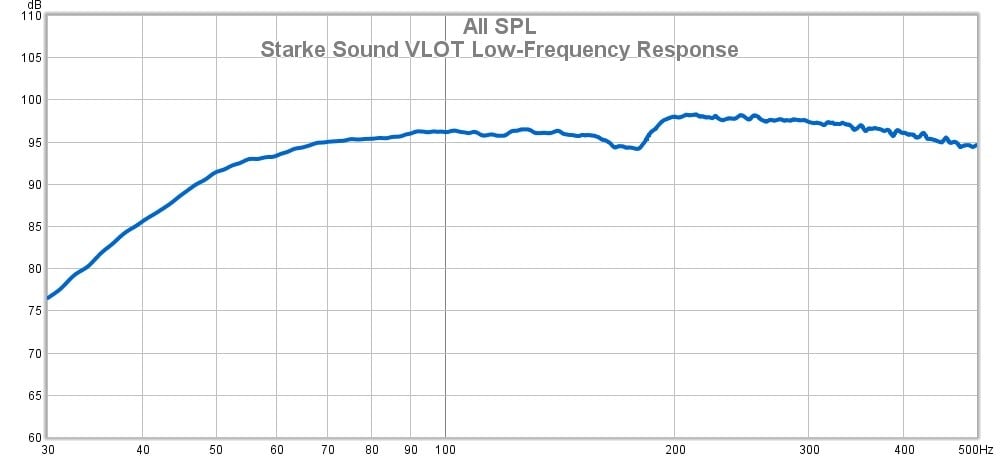

The VLOT has a subwoofer output that essentially sends out a full-range summed signal with no low-pass filtering, so the user will need to rely on the sub’s low-pass filter. There isn’t any method of high-pass filtering the VLOT for use with subs, so while there is a subwoofer output, there isn’t any kind of bass management that comes with it.
