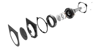

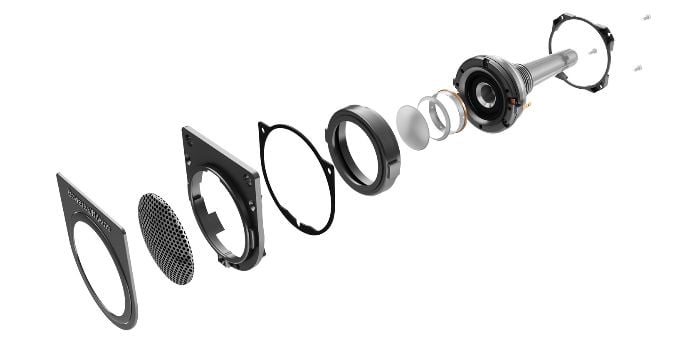

Suffice it to say, B&W’s new 600 series offers a mouthful of technology to discuss, the first being their Decoupled Double Dome Tweeter from the CM10. The “Double Dome” utilizes two layers of aluminum for the diaphragm: a standard aluminum dome and a second layer with the center cut out and glued to the rear of the first. B&W claims this significantly increases the rigidity of the diaphragm, and notes that the first breakup frequency of the new tweeter is well beyond human audibility at 38kHz. Also as one might imply from the name, the tweeter assembly is decoupled from the cabinet via a gel ring to keep unwanted resonances from interfering with the tweeter.
B&W Double Dome Tweeter
Exploded view of B&W’s Decoupled Double Dome tweeter. The added metal screen covering is a nice touch to keep little fingers out.

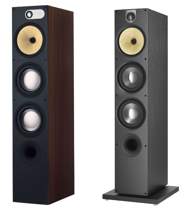

Along with their technical improvements, B&W has six new models to talk about. At the top of the heap is the new and improved 683, a 3-way floorstanding speaker featuring the new 1” dome tweeter, B&W’s familiar 6” FST midrange driver, and dual 6.5” aluminum woofers. Priced at $1,650 a pair, the 683’s offer a frequency response of 52Hz-22kHz (+/-3dB), along with an average sensitivity rating of 89dB with 2.83V at 1 meter, and an 8 ohm nominal impedance (3 ohms minimum). It should be noted due to the minimum impedance that you will want to pair the 683 with an amplifier stable into a 4 ohm load.
B&W 683 Old & New
Old (left) vs new (right), the B&W 683. The refreshed 600 series features a slimmer profile to improve SAF (Spouse Acceptance Factor).

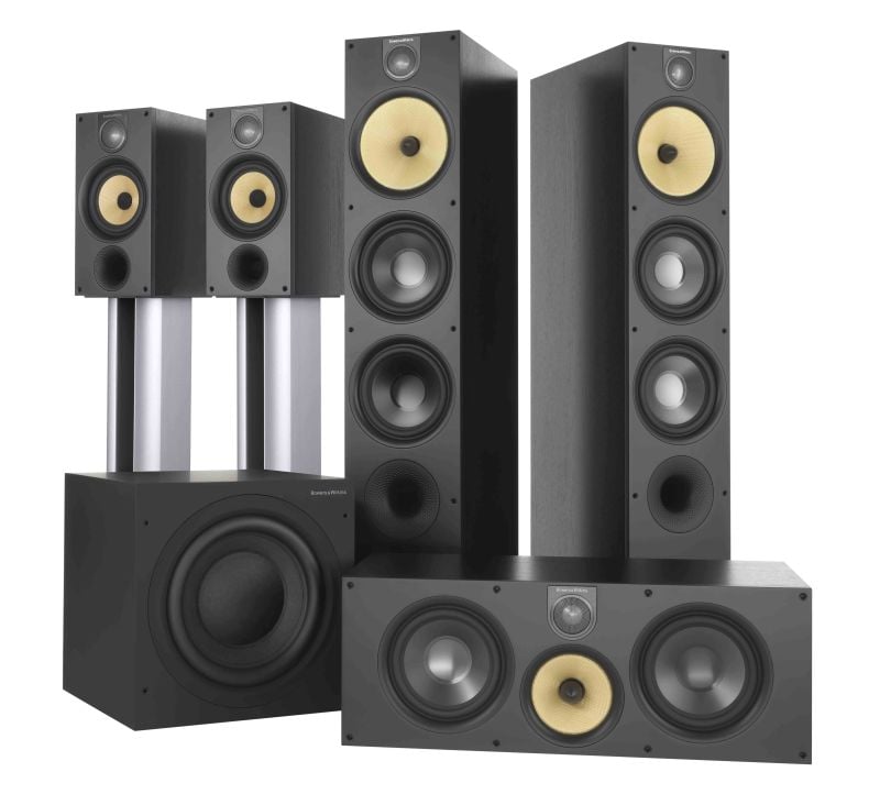

Finally, we get to B&W’s surround sound offerings, namely two center channels, the HTM61 and HTM62. Priced at $750 apiece, the HTM61 is a full-fledged 3-way design boasting a 1” tweeter, 4” FST midrange, and dual 6.5” aluminum woofers. With a frequency response of 50Hz-22kHz, sensitivity of 88dB, and a minimum impedance of 5.2ohms, it looks like it shouldn’t have any trouble keeping up with the 683 tower. On the other hand, the HTM62 is a simple two way design sporting a pair of 5” mid/woofers and costs $450 per speaker. Frequency response is rated from 70Hz-22kHz (+/-3dB), with a sensitivity of 87dB and a nominal impedance of 8 ohms (5.2 ohm minimum). Worth noting, horizontal dispersion of both models appears to leave something to be desired. While on the vertical plane, both speakers achieve a response within 2dB of the on axis response over a wide 60 degree arc, on the horizontal plane, that window is achieved only through relatively narrow 20 degree arc.
