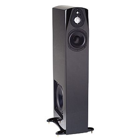

NHT Classic Four Floorstanding Tower Speaker
The lead performer in NHT’s lineup, the Classic Four is a relatively large albeit slim four-way loudspeaker sporting all aluminum drivers including a 0.75” dome tweeter, 2” dome midrange, 6.5” mid/woofer (in an acoustic suspension sub-enclosure), and a 10” side-firing woofer (in a bass reflex sub-enclosure with a tuning-point of 26Hz). The cabinet to which the drivers are mated should be quite solid thanks to multiple braces, an extra thick 30mm front baffle (1.2 inches), 18mm (0.7 inches) sides and rear, and further reinforcement of the woofer compartment courtesy of a 1.5mm aluminum plate. In addition, the cabinet is also quite aesthetically appealing, featuring a high gloss piano black finish as well as a few graceful curves around the tweeter and midrange which also happen to minimize diffraction effects.
In terms of performance, we have high expectations for the Classic Four. The 0.75” tweeter and 2” midrange drivers should contribute to a fairly wide dispersion pattern without any holes that can result from pushing a relatively large mid/woofer to the point of beaming. As noted above, the inclusion of low diffraction cabinetry is a nice plus, and the heavy enclosure (weighing in at 64.3 pounds) should keep resonances to a minimum. So what do the numbers say? In terms of frequency response, the Classic Four is rated from 27Hz-20kHz (+/- 3dB per NHT’s engineering staff), which means that it should be largely capable of full range music reproduction. It’s also worth noting that the Classic Four is a 6 ohm nominal speaker with a minimum impedance of ~4 ohms, and combined with a somewhat low sensitivity rating of 86dB with 2.83V at 1 meter, will likely require a relatively powerful amplifier capable of driving low impedance loads in order to deliver high SPL's.

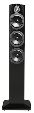

NHT Absolute Tower
While the Classic Four is the big daddy of NHT’s lineup, for those who have a bit less to spend and can get away with a little less low end capability (read: you have a subwoofer), the Absolute Tower is may be the speaker for you. A true three-way design, the Absolute tower utilizes a 1” aluminum dome tweeter with a trio of polypropylene 5.25” woofers in an acoustic suspension alignment; one of the woofers operates from 2.2kHz-450Hz, while the other two handle the frequencies from 450Hz on down. Like the Classic Four, the cabinet comes in an attractive gloss black finish, and boasts the same diffraction reducing curves around the tweeter and midrange driver.
In terms of performance, the biggest difference between the Absolute Tower and its big brother will be low end extension. While a pair of Absolute Towers brings a quartet of 5.25” drivers to the table, the low end extension of the system is only rated down to 58Hz; in other words, the Absolute Towers do require a subwoofer for full range performance. Other than that, the Absolute Tower appears to be a very capable loudspeaker.  The crossover frequency selected for the tweeter / mid/woofer handoff shouldn’t represent any troubles in terms of beaming, again promising wide relatively dispersion through the audio band. Also like the Classic Four, the Absolute Tower boasts a lowish sensitivity rating of 86dB with 2.83V at 1 meter, and while the average impedance is listed at 8 ohms, the minimum of 4 ohms combined with the low sensitivity still suggests respectable amplification be used to achieve high output levels.

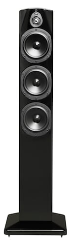

NHT Absolute Tower
The NHT Absolute Tower's trio of 5.25" woofers adds to the visual stimulation of the overall design.
