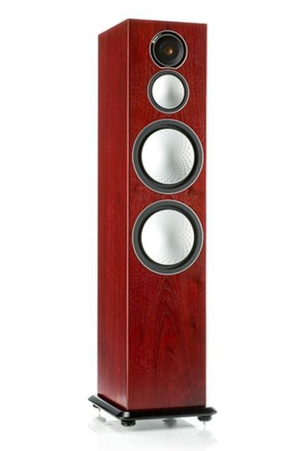

Silver 10: $1,250-$1,400 each
A rather imposing speaker at 42-3/16H x 11-7/16”W x 14-3/16”D (including plinth and feet), the range topping Silver 10 is a three way design featuring a 1” tweeter, 4” midrange, and dual 8” woofers in a vented cabinet. With a frequency response rated from 30Hz-35kHz, it seemingly should be capable of full range music reproduction; however, it should be noted that no tolerances are provided for the specification, reducing its usefulness. Also worth noting, the Silver 10 is a 4 ohm nominal speaker, suggesting you’ll want to pair it with a halfway respectable A/V receiver or outboard amplifier. Fortunately, the above average rated sensitivity of 90dB with 1W at 1m (this equates to 93dB with 2.83V at 1m because of the 4 ohm impedance), would imply that you shouldn’t require anything terribly exotic in terms of amplification.

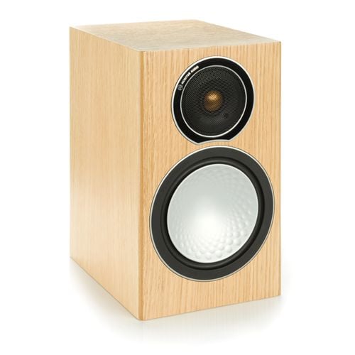

Silver 1: $875-$975 pair
The runt of the litter, the Silver 1 is also a two way bookshelf speaker featuring a 6” mid/woofer crossed to the golden C-CAM tweeter at a fairly high 3kHz. Due to the use of such a high crossover point, the Silver 1 could also have issues with beaming and audible cone breakup like its big brother. Of course, the smaller driver also comes with the requisite loss of extension, now rated at 45Hz; however, this is still quite good considering the speaker is a smidge over a foot tall. Unfortunately, the small size and deep extension also means another drop in sensitivity, this time down to 87dB with 1W at 1m.
The Monitor Audio Silver 1 in natural oak.
