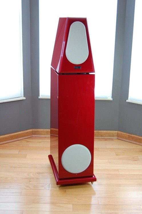

The Bamberg Series 3 TMW in Ruby Red.

Part of Bamberg’s philosophy is that nothing more complicated than a 3-way is necessary for full-range audio reproduction, and that monitors atop stereo bass cabinets is the optimal way to go.  Enter the Bamberg 3 TMW. Priced at $5,800 a pair, the Bamberg 3 is a three-way loudspeaker with built in amplification and DSP active crossovers. Numerous finish options are available, ensuring that potential customers will find something to fit their tastes.
The Particulars

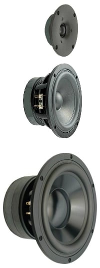

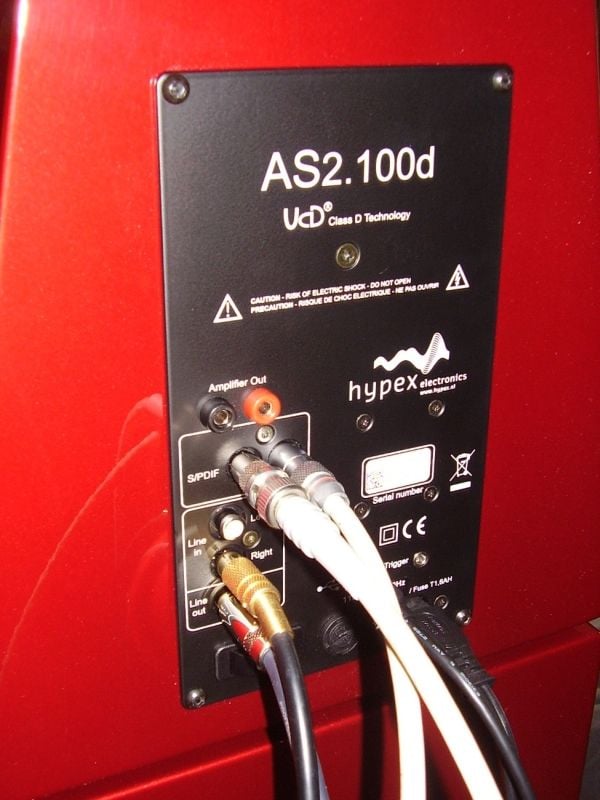

Starting from the top, the monitor is a standalone speaker in its own right.  The 22mm [7/8”] soft-dome tweeter and overbuilt 15cm [6”] midwoofer are mounted in a vented cabinet with low end output that extends down to 40Hz.  This monitor is self-powered by a two-channel DSP plate amplifier rated for 100W/channel located on the back panel along with the dual-flared port. On the monitor’s bottom are four hemispherical vibration-isolating rubber feet.  These soft feet provide high traction for the credenza or speaker stands, as well as isolate vibrations from the bass cabinet which could smear the acoustic image.
Monitor Amplifier
Closeup shot of the monitor section's built in amplifier.
Meanwhile, there’s the 32” tall bass cabinets, which support the monitors higher than is typical, putting the tweeters 1.15 meters [45”] above the floor. Bamberg states that this raises the sound stage to make it sound subjectively larger and more impressive. The cabinet contains a meaty 22cm [8.75”] aluminum cone woofer, as well as a 4” dual flared port which tunes the 2 cubic foot cabinet to 25Hz. As one might imagine, the bass cabinet is heavily built, with multiple internal braces as well as OC703 2” fiberglass lining for optimal damping. Power is provided by an internal 170 watt full-range amplifier.

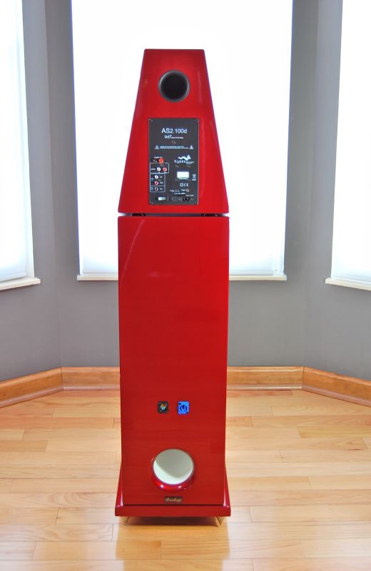

Bamberg 3 TMW Rear Shot
Rear shot of the Bamberg Series 3 TMW.
One interesting technical feature is the crossover has been meticulously engineered to eliminate the floor bounce dip that normally occurs around 250-300Hz. Bamberg notes this leads to a richer tonal balance, and without artificially deviating from the neutral voicing. In addition, the 6° rearward lean further enhances imaging such that the speaker truly disappears when optimally located in the room. Crossover slopes are all 24dB/octave Linkwitz-Riley, with an eye toward maintaining extreme phase coherency across a wide band. Treble dispersion has been crafted to remain level off-axis, and with less drop-off than is exhibited by the more traditional 7” woofer / 1” tweeter format speakers.
