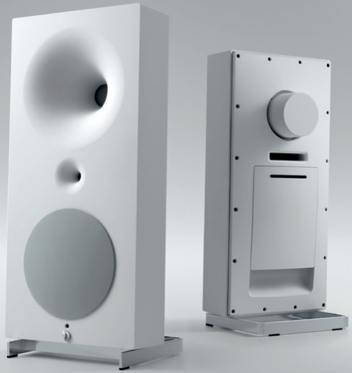

ag01_front_back     ag01_exploded
As you can see from the images, the Avantgarde Zero 1 speakers have a very unique look. The top of the enclosure features a 4.9" midrange mounted in a horn, while a horn-loaded 1"tweeter graces the center, and the bottom sports an 11.8" woofer. The 3-way speaker is rated down to 30Hz, and is controlled by an active crossover. Each of the drivers gets its own amp, with the tweeter and midrange each powered by a 50 watt Class A amp and the woofer powered by a 400 watt Class D amplifier.
The enclosure may be polyurethane but it is well braced, particularly around the woofer. There is a "master" speaker and a "slave" speaker (their terms, not ours). The master has all the inputs which include a USB, Optical, an AES/EBU input, as well as two Coaxial inputs. The standard version of the Zero 1 speakers has no analog input, though you can have one added, along with a 24-bit 88 kHz AD converter, for $900. The master speaker connects to the slave via a 2.4GHz wireless signal (don't put these too close to a microwave). The master speaker is delayed by 2 microseconds to perfectly time-align the speakers allowing for transmission and decoding at the slave speaker. The wireless signal transfers data at 44.1 kHz at 16 bits and is bit-perfect. The volume is transmitted over a dedicated wireless channel, applying it only when it has arrived at the slave. The Zero 1 speakers have three 24 Bit Burr & Brown DACs per speaker and a Finite Impulse Response Filter giving the Zero 1 perfect phase characteristics, with deviations of less than 5 degrees. By comparison, according to Avantgarde, the average loudspeaker has maximum deviations of 500 to 1,500 degrees.
