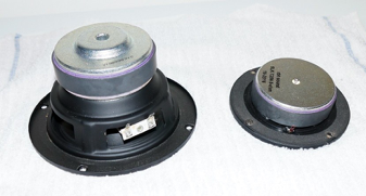

The tweeter uses a large-diameter ceramic magnet, which limits how close, physically, the tweeter can be mounted to the two midrange drivers. Had the tweeter used a small neodymium magnet (with finned heatsinking to make up for the loss of thermal-dissipating mass that the large ceramic magnet provides), then the combined vertical dimension of the M-T-M array could have been reduced to about 12 inches, increasing the CDF to 1130Hz and delivering a little wider and more uniform dispersion. Not a huge issue, but one wonders why RBH choose to use an old-styled ceramic magnet tweeter.
Editorial Note by Shane Rich: Regarding Tweeter Power Handling
We've found tweeter power handling is definitely superior with a larger ceramic magnet vs a small neodymium which is why we made this design choice in this case.
Rear view of midrange and tweeter, showing large ceramic magnets

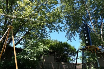

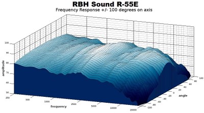

The RBH R-55E Tower speakers were measured in free air elevated to a height of approximately 4 feet with the microphone at a 90” height to be level with the tweeter. Measurements were gated at 5 ms. At this windowed gate, some accuracy is lost below 400 Hz and is totally lost below 200 Hz. The microphone was placed 2 meters away from the speaker at a height level just below the tweeter. The below graphs use 1/12 octave smoothing.

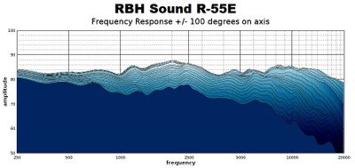

RBH R-55E Horizontal Response +/- 100 degrees: 3D view
RBH R-55E Horizontal Response +/- 100 degrees: 2D view
The above graphs depict the R-55E’s direct-axis and horizontal dispersion out to a 100-degree angle in five degree increments. Here we can see the source of the upper-midrange brightness that Steve noted. It takes the form of a low Q rise of a few dB centered at 2 kHz. I would expect a response like that to be audible but not severe, as Steve mentioned. The rest of the range is relatively flat. Since this rise is a resonance that occurs at every angle, it can easily be addressed with equalization. The R-55Es show themselves to have admirably wide dispersion with good response correlation from direct axis to off-axis angles. This means that its reflected sound should have similar tonality to the direct sound, so a room heavy in acoustic treatments isn’t needed to make these speakers sound better. It also means these speakers do not have a small ‘sweet spot’; they ought to sound good anywhere in a broad angle in front of them. This characteristic has always been a strong point of RBH speakers.

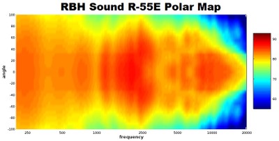

RBH R-55E Polar Map of its Horizontal Response
The above graphs show the same information that the preceding graphs do but depict it in a way that offers new insight regarding these speakers’ behavior. Instead of using individual raised lines to illustrate amplitude, these polar maps use color to portray amplitude and this allows the use of a purely angle/frequency axis perspective. The advantage of these graphs is they can let us see broader trends of the speaker’s dispersion behavior more easily. Outside of the extra midrange energy at 2 kHz, we see a very consistent level of energy as we move off axis. The only frequency that tapers off at a higher rate off axis is the very high treble band, but that is true of nearly all speakers. The response out to 10 kHz is still strong even at a 50-degree angle. There won’t really be any bad seats in the house with this kind of dispersion unless the listener is seated at an extreme angle with respect to the speaker. Those who want a full sound projected over a wide area would do well to consider this kind of dispersion pattern.

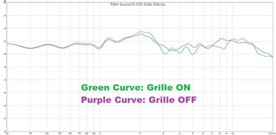

RBH R-55E Direct Response: grille on and grille off
The above graph depicts the effects on the direct axis response of the utilization of the grille. While I always take this type of measurement, I don’t normally include this graph in reviews, since the differences don’t tend to be very significant. However, the use of the grille here is a bit more impactful on the response than normal. It wouldn’t make a major audible change on the sound character of this speaker, but it certainly does not improve the response. As usual, for the best sound, leave the grille off.

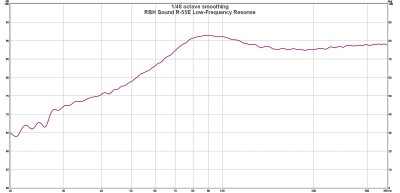

RBH R-55E groundplane bass response
The above graph shows the RBH R-55E’s low-frequency responses that I captured using groundplane measurements (where the speaker and microphone are on the ground in a wide open area). At a glance, one might guess that the 80 Hz to 90 Hz region is the tuning point of this speaker, but that is not the case. The port tuning frequency of the R-55E is just below 40 Hz, as we can see below in our impedance measurement. We can see this in the low frequency response when we look a bit closer and see a 12/dB octave slope below the bump centered at 90 Hz and then a steeper roll-off below 30 Hz. This was done to use boundary gain to shore up the low frequencies, since tower speakers are normally placed near walls or corners. If the R-55E has a flat response down to 40 Hz, typical tower speaker placement would balloon the bass for a ‘boomy’ effect. The roll-off that we see in the R-55E lends itself to more natural sounding bass, at least when placed near walls or especially corners. If these speakers were placed in an open area that had no proximity to nearby walls, they would likely sound a bit thin for ostensibly full-range speakers. The specified frequency response window of 35Hz to 30kHz +/-3dB that RBH states for the R-55E should be taken to mean in-room response. Anechoically, this is not the case, but, in practical, real-world use, it would have that kind of window.

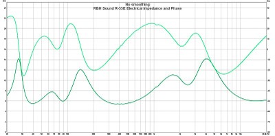

RBH R-55E Impedance and Phase Response
The above graphs show the electrical behavior of the RBH R-55E speakers. RBH specifies the R-55Es to be 6-ohm speakers, and this is a fairly conservative rating. Some manufacturers would call this kind of load 8 ohms, which might be pushing it, but it is certainly more benign than a 4-ohm load. The toughest part of this load occurs in the low frequencies where there are some steep phase angles at impedance minima, but those still occur above 5 ohms. Essentially any AVR or amplifier should be able to drive this speaker without worry. RBH specs the sensitivity of the R-55Es speakers at 88dB for 2.83v at 1m. Our measurements show 87dB (well, 86.963dB but we will call it 87), which is pretty good agreement. That is about what one would expect from a design like this- it’s not a low sensitivity nor is it especially high. Most mid-range AVRs will have enough power to drive these speakers to quite loud levels, but the R-55Es could safely handle a good deal more amplifier power than mid-range AVRs are capable of, if users wanted to add an outboard amplifier to really rock out.

RBH R-55E pageThe RBH Impression Series Elite R-55E acquitted itself quite well during its stay. (They could shorten that product name a bit, though, don’t you think?) I’ve had some outstanding similar-sized and similar–priced speakers in my home in the past few years for review and extended evaluation: the $2,200/pr. B&W CM8, the $2,500/pr. Atlantic Technology AT-1, the $2700/pr. NHT Classic Four and the $3000/pr. Paradigm Prestige 75F. All are fine speakers, and easily among the best in their size/price category. The RBH R-55E (let’s just call it that, ok? I) is a solid contender among this group of excellent loudspeakers. Its bass extension and impact are clearly superior to the B&W and Paradigm and at least the equal of the NHT. From a midrange coloration standpoint, I rank them as follows, from the bottom up: B&W, AT, RBH, Paradigm, NHT.
I want to emphasize that the slight forward upper-mid empasis of the R-55E was by no means a show-stopper or game-changer. I simply noticed it in comparison to the others, using identical equipment in the same room, playing the same discs, compared to the same reference speakers. Lesser speakers have larger warts that prevent them from serious consideration. I could easily have the RBH’s as my main speakers and be quite satisfied. They’re not perfect—I haven’t heard a perfect speaker yet—but their deficiencies are not obnoxious to the point of disqualification. Not even close.
They look great. The finish is world-class and unexpected for $2000/pair. I think their other compromises—non-flush-mounted terminal cup and ports, non-flared ports, pin-and-receptacle grille attachment and few-time-only use wood screw foot attachment—are very minor issues, well-chosen compromises. Especially if those compromises are what enabled RBH to use beefy aluminum-cone woofer and midrange drivers and be able to offer such a nicely-done finish.
Overall, the RBH Impression Series Elite R-55E is an excellent product—outstanding sound, great looks, well-chosen compromises and above all, a truly outstanding value. This is a lot of speaker for two grand. I don’t think you can go wrong.
