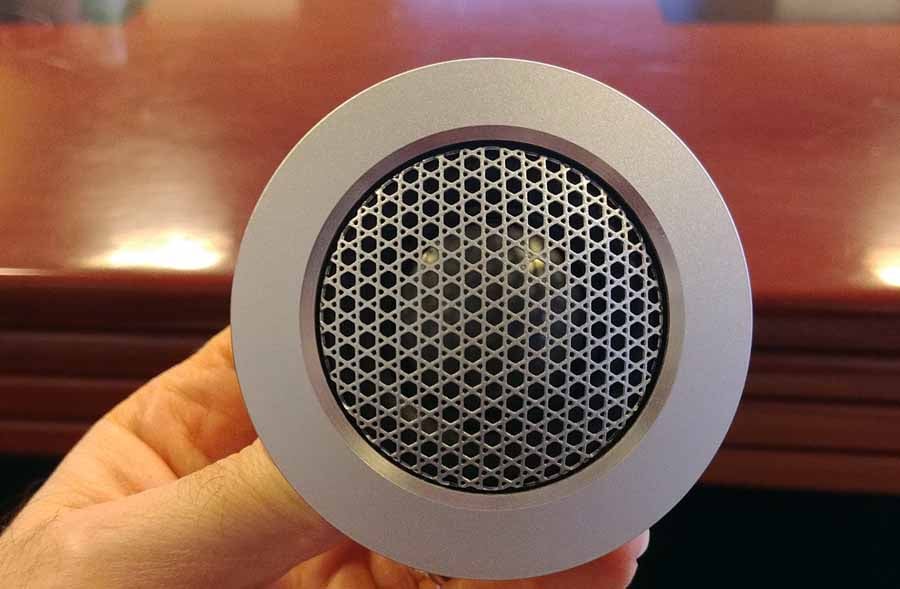

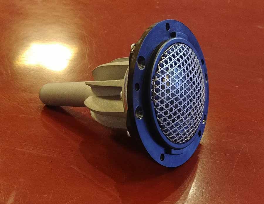

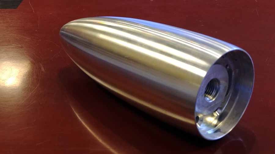

- The 705 S2 and 702 S2 B&W have adopted Solid Body Tweeter technology for their tweeter-on-top designs offering the same performance benefits found in comparable 800 series models.
- Instead of using a hollow zinc housing, the 705 S2 and 702 S2 use an inert shape milled from a solid mass of aluminum (weighing > 1kg!) to provide a stiffer and less resonant structure.
- This design enables B&W to use the mass of the tweeter body as a heatsink. It also means they can use the same decoupling mechanism, grille design and tweeter removal tool as the 800 Series Diamond.
- The first breakup mode of their new carbon tweeter is 47kHz, which is quite an improvement from 38kHz of the Aluminium Double Dome of the CM series and closer to their holy grail of 70kHz of the Diamond Dome in the 800 D3 series.

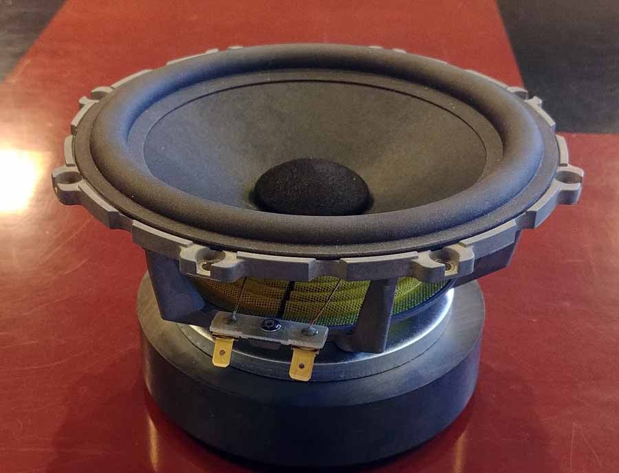

B&W Aluminum Basket with Damper (left pic) ; B&W Bass Driver with Aerofoil cone (right pic)
- The Continuum cone (borrowed from the 800 series) design is based on the concept of optimized and controlled flexibility with a highly controlled break-up mode beyond its usable bandwidth.
- B&W claims it helps it avoid the abrupt transition from pistonic to break-up mode behavior that drastically impairs the openness and neutrality of a conventional drive unit.
- Continuum is a triumph for experimental work, with more than 70 iterations and eight years of development prior to launch.

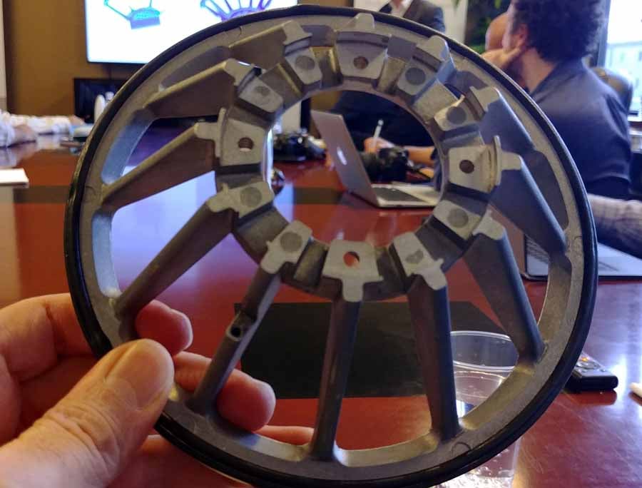

- These midrange drive units use a new FEA-optimized aluminum chassis that is stiffer than the zinc chassis of the outgoing CM Series.
- This optimized form is further enhanced with the addition of a tuned mass damper on the front face of the chassis. This dampens any remaining resonance in the structure, which is said to result in a cleaner, less colored midrange presentation.
- B&W developed a new midrange decoupling system that simplifies the design used in the 800 Series Diamond and replaces the drawbar design employed in the previous CM 10 S2. It is used in ALL floorstanding models in the 700 series.
- For the bass drivers, B&W developed a more affordable implementation of the Aerofoil cone used in the 800 Series by using paper rather than costly fiber skins.

B&W Carbon Dome Tweeter (Left pic) ; Solid Body Housing for 702 S2 & 705 S2 models (right pic)

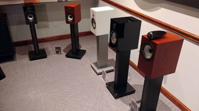

Bookshelf Models
The lineup contains three ported bookshelf speakers beginning with the 707 S2 ($1,200/pr) which is a compact 2-way bookshelf speaker featuring a 5" midbass driver and 1" dome tweeter, 8-ohm nominal impedance, a -3dB points of 50Hz and 28kHz and sensitivity of 84dB at 1 meter/2.83V and recommended amplifier power of 30 - 100 watts. It's pretty hefty at 13lbs for such a small cabinet enclosure 11" x 6.5" x 11" (HxWxD).
Next up is the 706 S2 ($1,800/pr) which steps you up to a 6.5" woofer for increased sensitivity of 88dB at 1 meter/2.83V but maintains a similar low frequency -3dB pt to its smaller sibling, which seemed a bit odd initially considering they did sound bassier to us in comparative listening tests. While the -3dB points appear to be very similar between the two models, the 706s had a greater sense of perceived bass because of their larger drive unit/cabinet combination and higher sensitivity making them more linear at bass frequencies. With a bigger woofer comes a bigger and heavier enclosure measuring 13" x 8" x 12" and weighing 17lbs.
The 705 S2 ($2,500/pr) is the top bookshelf speaker in the series, identical in driver compliment and output to the 706 model but it places the tweeter on top of the cabinet in its own isolated and decoupled chamber for a more refined and open soundstage.
A bookshelf speaker needs a great stand to provide a solid foundation and proper acoustical height of the speaker with respect to the listener. The FS-700 S2 ($250/ea) is such a stand. While it doesn't come cheap, it is built incredibly well and is very inert when sand-loaded and it looks great to boot. It's the ideal speaker stand for use with 707 S2, 706 S2 and 705 S2, models and is available in Black or Silver finishes. Incidentally, when the 705 S2 is mounted on these stands, the tweeters are at the same height as the 702 S2 floorstanding model, which was a deliberate and intelligent design consideration by B&W. Attention to detail counts for a lot.

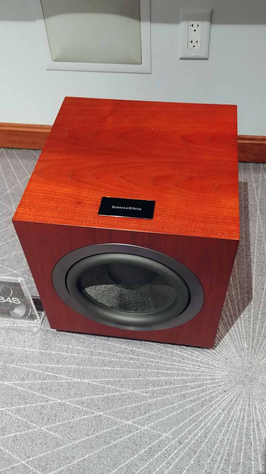

Subwoofer
To round out the system, B&W introduced their new DB4S ($1,600/ea) 10" sealed subwoofer based on the technology of its bigger brother dual driver designs (DB1D, DB2D, and DB3D models). The DB4S shares its drive unit technology, amplification, and preamp section with the dual-driver DB2D. It has a single 10in Carbon Aerofoil driver in a forward-firing configuration powered by a 1000 watt Hypex Class D amplifier and a digital preamp section with Dynamic EQ, Room EQ. It offers an App-based configuration system which is very handy for those wanting to fine tune the performance of their subs using their smartphone or tablet device.
