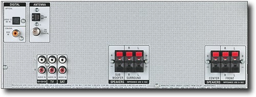

When I say basic, I mean basic...  Just check out the back and you will see only 2 digital inputs and 3 stereo analogue pairs.  Yes, there are AM/FM antenna inputs and speaker spring clip connectors, but that's it!  No video switching of any kind... just one big empty backside.  Fortunately, Sony just lowered the retail price so the lack of ports shouldn't be a concern for those simply looking to get surround sound without all the fancy features.
