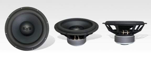

Enter the new PB-12NSD, SVS's most affordable ported subwoofer. This subwoofer features a custom designed aluminum cone 12" driver, 4" flared port and a 400 watt amplifier.
SVS uses a Finite Element Analysis (FEA) optimized motor with dual shorting rings and pole extenders which they claim brings all these improvements to the table compared to this models predecessor:
- More linear force/displacement curve
- Lower inductance and distortion
- Shorter "ring time"
- Improved sensitivity
- A wider and more linear frequency bandwidth
More details on their driver include:
- 2” diameter, high-power voice coil with high-temp GSV former
- Nomex linear roll long-throw spider
- Low-creep rubber long-throw surround
- Spider-integrated tinsel leads
- Aluminum cone and composite dust cap with SVS logo
- Powder-coated cast aluminum basket
- FEA-optimized motor structure
- Dual shorting rings and pole extenders to reduce gap induction and distortion
- Dual high-grade ferrite magnets
- Pole piece vent for greater cooling, low noise, and reduced air compression

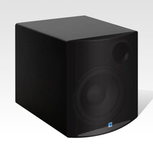

In addition to a very impressive robustly designed driver, the PB-12NSD is powered by a meaty Sledge 400 watt amplifier. This is a continuous power rating, not some fictitious peak power rating typically found on a BASH amplifier. The cabinet is well braced and sports a full 1" thick front baffle. Just tap on any SVS cabinet and you will heard a thud not a hollow box like some of their competition. There are real reasons why SVS subwoofers weigh a ton; sturdy well braced cabinets and big motor structured woofers.
SVS adds a touch of class to the PB-12NSD with a radius contoured perforated metal grille, flared port to reduce port noise and removable threaded synthetic rubber feat to keep the sub planted on the floor without damaging hard surfaces.
