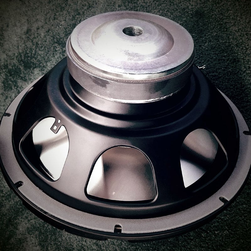

As their model numbers suggest, both the I-12 and I-12/e both feature 12” drivers. Unlike some of the competition, RBH Sound’s drivers are aluminum, not paper, and stem from RBH’s proprietary aluminum cone driver technology, which helps use the aluminum cone’s natural heat sink properties to keep heat generated away from critical components; namely the voice coil.  We should also note that aluminum drivers are normally found in subwoofers costing many times the price of the Impression Series.  In fact, according to RBH, using aluminum for the driver allows for higher performance and more accurate frequency response than the materials typically see at this price point.  This stamped basket aluminum cone driver shares a common heritage with other RBH products and it's quite a capable performer.

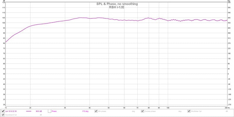

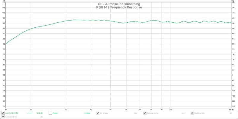

RBH sent us some preliminary measurements (viewable below) for the subs and the measurements are very impressive for subs at this price point.  Typically, you would need to spend many times the price of the Impression Series to get SPL level measurements like this in the 20Hz - 40Hz range.   One important item to note is that these preliminary measurements provided by RBH Sound are ground plane measurements at 2m and do NOT represent maximum output.  Using the subs’ vented alignment, you'd realize considerable gain below 40Hz if the sub were to be placed close to a rear wall.
RBH I-12/e preliminary measurements
Preliminary Measurements of the RBH I-12/e Subwoofer courtesy of RBH/RBH

RBH I-12 Sub Measurements
Preliminary Measurements of the RBH I-12 Subwoofer courtesy of RBH/RBH
