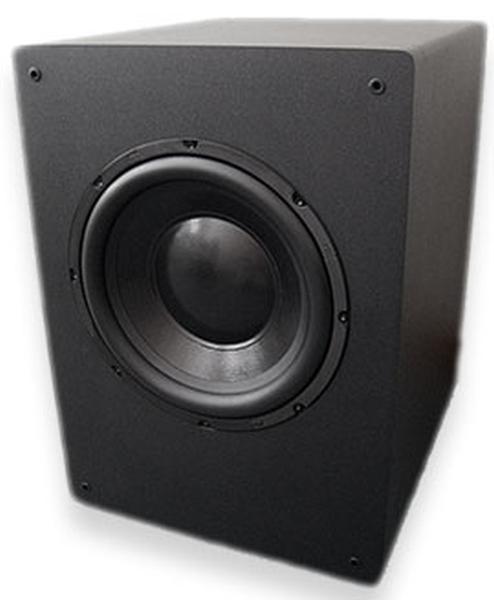

True to the value provided by the FV15HP, the entry level Rythmik packs an impressive list of parts relative to its modest price. The core of the LV12R is a 12” paper cone woofer built on a stamped steel frame, and motivation is provided by a 300W Class D Hypex amplifier. Those familiar with Rythmik’s lineup may note that the driver is a different model from that seen on their F12 sealed subwoofer, which utilizes an anodized aluminum cone and cast aluminum basket. As mentioned above, the LV12R utilizes a vented enclosure (available in matt black or simulated black oak), which extends the system’s response and helps to take some of the stress off the driver around the system’s tuning point.

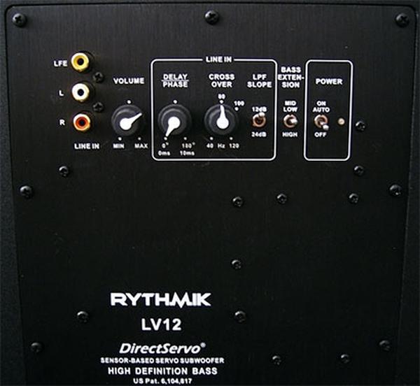

The LV12R's plate amplifier has a few useful features including phase controls and an adjustable low pass filter.
