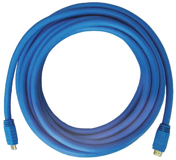

HDMI Cable - DVIGearWe calculated total cable lengths needed for this job to be roughly 10,000 feet just for the COAX and speaker cables. Since S&S supplied all of the CAT5e cabling for data and Ethernet, I let them figure out what was needed. I could only imagine the look on the face of Kurt Demke from Blue Jeans Cable when I called in my order, especially when I told him I needed the cable in two weeks. Talk about waiting until the last minute. About one week later, 4 huge rolls of cable showed up at the door stop of S&S Electric. Leave it to Blue Jeans Cable to not only meet a deadline, but to beat it by half the allotted time. This wasn't too surprising to me since this is a common experience I have had with Blue Jeans Cable and for our forum readers who also use and rave about the quality of their cables and customer service.
For HDMI cabling, I relied upon DVI Gear's SHR cables (pictured right) for my front projector system and Impact Acoustics for a secondary component run as well as interconnectivity between components. In my opinion, nobody has a better HDMI copper cable solution for long runs than DVI Gear. Impact Acoustics are also another great option for shorter runs, with their advantage being in flexibility since they are a bit thinner and more pliable than the DVI Gear SHR cables.

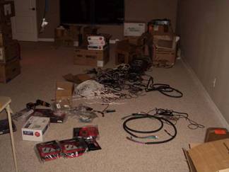

The Bonus Room (Main Theater & Control Center)
This is the central "plexus" for Audioholics where only the industry's finest gear resides. You won't find dinky cubed speakers in the room, or exotic battery powered cables (that is, unless we are ripping them apart to measure, analyze and do a little editorial on them.)

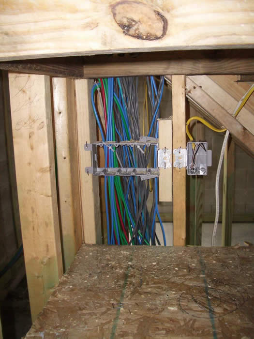

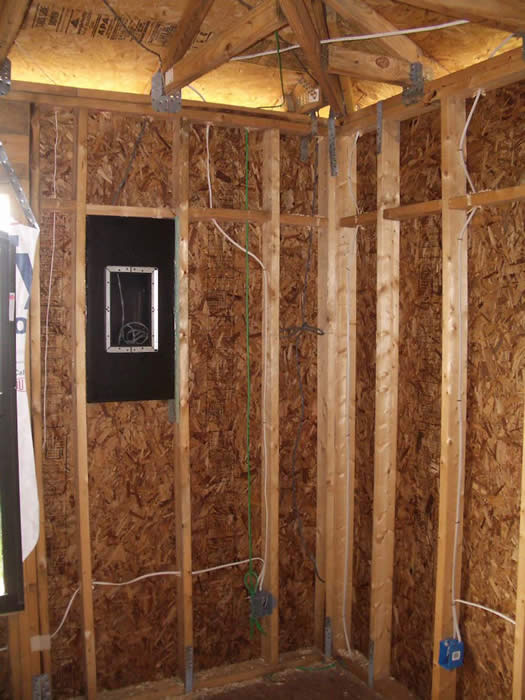

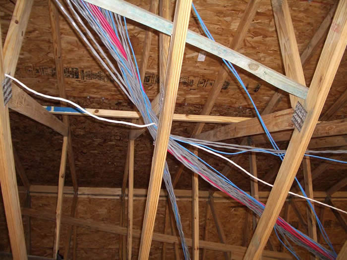

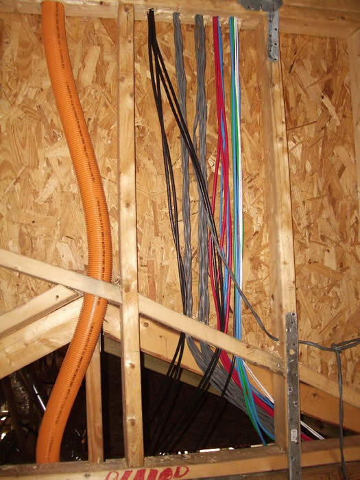

Here are some preconstruction pics that show how the cabling was routed.
wiring in conduit Upstairs wiring
Note in several instances, I had to sneak into the home after work hours to move around audio / video cables that were overlapping power runs. There are some critical guidelines that installers should follow when running low level cables such as audio, and video in a home. Despite the fact I handed S&S Electric a routing guideline for my cables, they still made some routing boo boos.
The middle picture shows the conduit I had run for projector cables while the pics to the far left and right show the runs of speaker and coax throughout the room.
In speaking with Ray Adkins, I learned it's a common problem with many installers since most of the people running the cables have little experience with A/V.

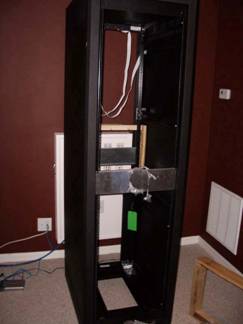

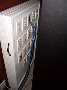

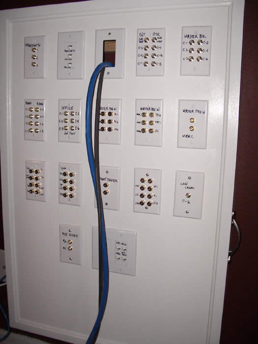

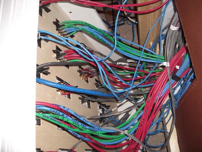

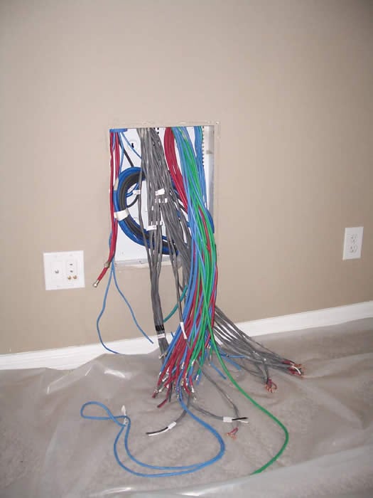

Main Control Panel System #1
cable panel wiring breakout panel box
The pic to the above left shows all of the cables breaking out into what would soon be the main control panel (right). It took up until the last two weeks before closing to get my builder and S&S Electric to sort out a workable solution for termination. In the end, they went with my suggestion of building a wooden box and strapping the Décora wall plates onto the surface, followed by terminating all of the cables (except HDMI) into SpeakerCraft female banana's for speakers and coax for audio and video.
servicing cable breakout
As you can see by the picture above, it is serviceable to all but the faint of heart.
Terminations, Install, Data & Power

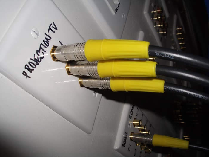

In practice, the main control panel SpeakerCraft terminations, coupled with compression WBT speaker terminations (left pic) and Canare Coax terminations (right pic) courtesy of Blue Jeans Cable worked flawlessly. My vision for hot swapping components and cables was quickly becoming a reality.
speaker connections line level connections

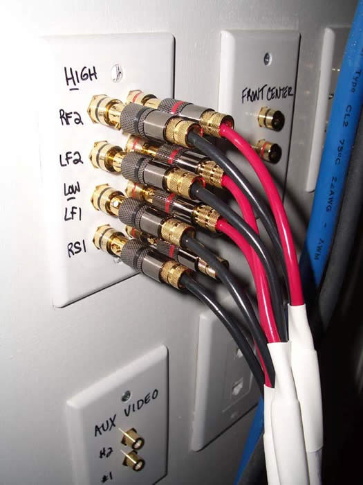

Editorial Note on Terminating Speaker Cables
When terminating the female Banana's onto the speaker wires, great care must be taken to ensure adjacent wires within the pair, or from other pairs groups, do NOT make physical contact with each other. When I popped off the back panel on the main control panel, I saw instances of strand contact between conductor pairs. Using a pair of needle nose pliers, I separated the conductors.
I then used a wrench to tighten down the terminations. The biggest source of discontinuity with cables is usually in the quality of the terminations. Making a tight compression fit is the best way to ensure uniformity in the connection while also minimizing resistance (the dominant metric of importance in speaker cables.)

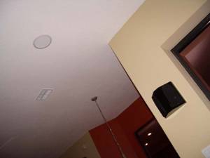

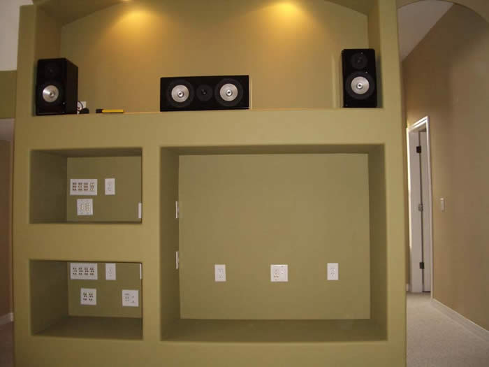

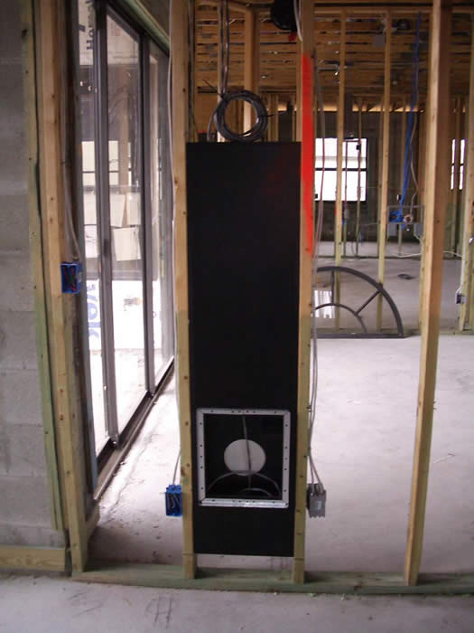

I also got S&S Electric to install some in-wall speaker cabinets (likely another first for them), as per my instructions. Thanks to the excellent consultation of Ray Adkins, we came up with an easy and effective method for them to follow.
in wall speaker installationProcedure for Installing In Wall Speaker Cabinets
  • Line the outer cabinet and 2x4 framing of the wall with wood glue.
  • Secure the speaker box between the wall framing with wood screws which are inserted from inside of the cabinet.
Note: If the 2x4 framing is greater than 14 inches on center, use furring strips for a more snug fit before installing screws.
  • Drill a small hole at the top of the speaker cabinet and insert speaker wire.
  • Use glue or wood caulk to seal the whole after the wire has been run.
S&S Electric did a great job on my speaker cabinet installs and followed my instructions to the letter.

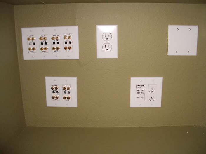

Family Room System
This is where the secondary 7.1 home theater system resides as well as where the majority of my guests will be entertained. It also serves the whole home for distributed audio, a particularly essential requirement when hosting parties. I had S&S home run all of the distributed speakers to this location with 10/4 and Cat5e. In all likelihood I will not have immediate use for the Cat5e run, but allow for future expansion for touch panel controls and automation.
wiring family room wiring family room2
Got enough wires? I hope so. With all of the 10/2 speaker runs for 7 main theater speakers, 12 pairs of distributed speakers, and Coax to connect all of the components including indoor and outdoor subwoofers, outdoor television and connectivity back to System #1, I believe I covered all of the bases.
family room plates family room plates 2
All terminations were done with SpeakerCraft using F-connector to female RCA's for all A/V Coax and Female banana's for all speaker terminations. Cat5e for all of the volume controls and control data were terminated into RJ45 connectors for now.

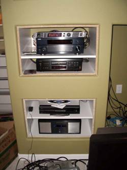

in-wall subwooferMaster Bedroom System
The idea here was high WAF (how else could a husband sell off surround sound in his wife's bedroom without it being completely invisible)? In-wall speakers and no equipment (other than flat panel display and cable box) is the answer. With that in mind, realizing I was using the Denon AVR-5805 for System #1, it seemed only logical that it was time to take advantage of its second zone surround feature for this application. I decisively chose to prewire this room for 5 speakers and 2 subwoofers, 6 COAX runs, 2 CAT 5e and Ethernet.
To take it one step further, I decided to install inwall subwoofers. This allowed me to keep the theme of no visible equipment in the room while also allowing me to run dual subs.
Again I gave S&S electric specific installation instructions on mounting the RBH SI-10 in-wall subwoofer cabinets. We decided on MC products for the speakers since the Signature grills are not flush mounted to the walls like the MC ones are. More on this in the dedicated equipment article.

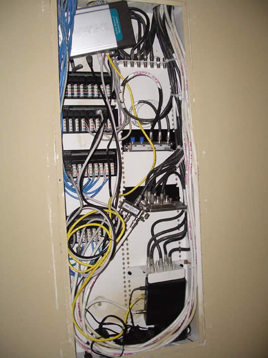

Data Distribution Panel
What use would the Audioholics Showcase home serve without having the ability to stream data and video throughout the house? We certainly wouldn't be able to get any work done and would likely spend most of the time just chilling listening to tunes and watching DVD's. Hmm on second thought….
We needed a centralized demarcation point for all phone, data, and cable. We selected the laundry room in which to install our data distribution panel. data distribution panel
As you can see in this pic, we have punch down blocks for all phone and Ethernet service as well as for cable and satellite TV. In the distribution panel also resides our broadband modem and one of the wireless routers/hubs. We have prewire for Satellite TV, over-the-air antenna and cable TV (our current choice) to all of the theater rooms, two offices, and guest rooms and back yard. Our Ethernet connectivity is quite extensive, serving 3 desktop computers, an Xbox, Yamaha MusicCAST 2000 and the Denon AVR-5805. Our wireless network supports two laptop computers and a wireless print server.

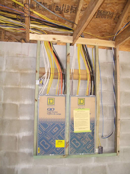

power distribution panelPower Distribution
You're probably wondering what kind of power we have to handle all of this. Fear not, as S&S Electric took good care of us. Rather than providing the standard 150amp service designated to this house design, they upgraded me to 300amp service via two distribution panels. Each dedicated line has 20amp service and independent grounds tied back to the panel. System #1 alone has 4 dedicated runs, followed by one each for Systems #2 and #3.
Peering at the above pic to the left, it is clearly obvious that routing power is S&S Electric's forte. This was a class A job of wire management, routing, and termination. Everything on the panel was clearly labeled just the way I like it to be.
APC S-15 UPSEvery dedicated line for home theater equipment is fully protected and conditioned by the award winning APC S15 or H15. When it comes to clean power, I don't mess around and elected what I felt to be some of the best solutions in the industry (see our FAQ article on APC). More on this topic will appear in the dedicated Showcase equipment article.

With over 10,000 feet of cabling run behind drywall for distributing audio, video and data, at some point this all has to get hooked up to equipment. As of last week I started taking on this challenge solo but could always use a helping hand (*subliminal message* - email [email protected] and offer assistance immediately).

Middle Atlantic Rack (for Primary Theater Room)
Middle Atlantic rack boxHere I am today contemplating how to hoist this nearly 7', 300lbs Middle Atlantic rack up a flight of steps by myself (yea our premier system is on the second floor, nobody ever accused me of common sense being my strong point). Just as I built up enough courage (read: insanity) to move it, the local UPS guy shows up with yet another delivery. He seemed to be a sturdy fellow so I tried out a tip I learned from my business partner and offered him a quick $20 to help me carry this beast upstairs.
We did it! But now can someone tell me how to assemble this thing? Look at all the boxes, yikes!
Ok think back to childhood when you had to match up the shapes to the empty peg boards. Does this look familiar? Good cause all of the cables on the floor (and about three more box fulls) in the left pic need to hook up to the main distribution box to the right. Are we having fun yet?
Cables on floor cable distribution panel
family roomIf not, try finishing off Family Room System that has about half the connections of this but in a much tighter space. Main System will be at least a three month project between waiting on room acoustics tuning, theater chairs, the main speakers, and getting it all hooked up and operational. I simply could not wait that long to listen to my favorite tunes, so I managed to get most of Family Room System operational. Once the cabinet guy finishes our shelving, we can mount the TV and put in all the finishing touches.
