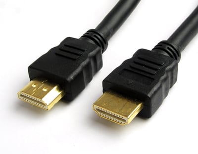

How could one cable create and solve so many problems at the same time?
Silicon Image, Inc. announced recently that they were working on a solution that would reduce the time it takes to switch from one HDMI source to another on your high definition display. This new technology, dubbed InstaPort, is promised to reduce the switching time to less than second. For those of us with older displays, this technology is actually part of the HDMI port and can't be added to older displays.
