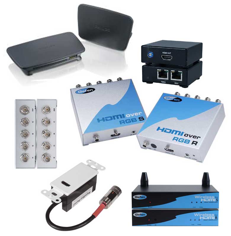

Cases in point: Everyone is coming up with ways to transmit, send or otherwise distribute HDMI... without actually using HDMI. Here are just some of the products we're seeing all over the place:

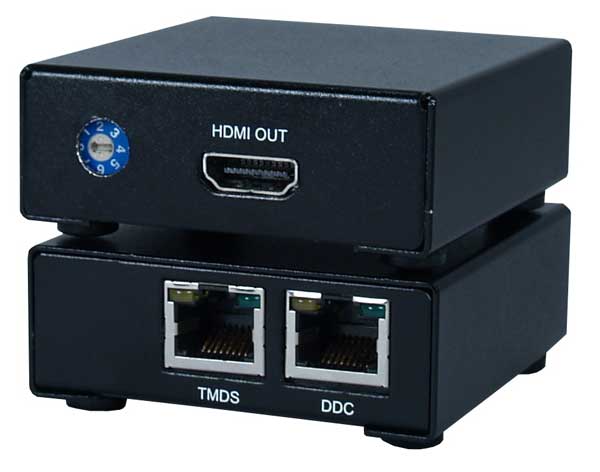

  • HDMI over Cat5Baluns (HDMI over Cat5)
    We've got companies like Atlona putting out active HDMI-to-Cat5e solutions ($329) which will run up to 130 feet of 1080p HDMI (at 1.65Gbps speeds). While that sounds expensive, the equivalent fiber solutions (another alternative to copper HDMI cables) will run you around $1000 or more. Other companies providing these types of Cat5e products include Gefen ($499), Honeywell, Intelix, Brando ($59!)
  • RapidRun (Active & Passive HDMI over Copper)
    This one stands on its own, but Impact Acoustics has an innovative method for running and pulling HDMI throughout a home. And with their active solutions you can plug in a 5V power supply at the source and get up to 100 feet of distance.
  • Wireless HDMIUWB and Wireless HDMI (3.1 - 4.6 GHz)
    At present, several companies are announcing Wireless HDMI transmission at varying lengths, but only a couple are actually shipping - most likely due to the complications introduced by HDMI 1.3 - which all but obsoleted many products which were in development. Wireless HDMI technology is chiefly for single "point-to-point" transmission rather than a solution for whole-home audio/video distribution at present. Gefen has a shipping unit ($699) that will do either 1080i/60 or 1080p/30 at 10 meters. Philips demoed a unit ($299) at the 2007 CES last year that seemed to work very well but has yet to actually hit the market. This one's a bit overkill, but Belkin's FlyWire system ($500+) adds video switching so that you can receive multiple sources and send them to an HDMI-enabled display (it even performs A-to-D conversion for analogue sources). Belkin is expecting to release it by the end of this year. Another player is AMIMON, however they are working with manufacturers to integrate their WHDI-based chipsets and modules into consumer electronics.

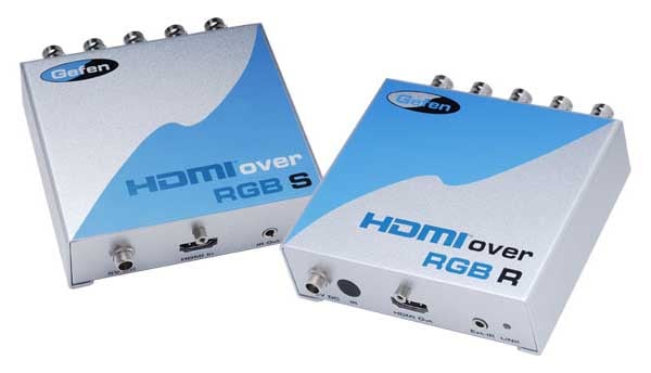

  • HDMI over Cat5eHDMI over Coax
    Yeah, baby, bring it on home. HDMI over coax is the "holy grail" of HDMI signal transmission. First of all, coax is cheap and it can go for long distances without failing or degrading - especially when coupled with an active transmitter and/or receiver. Gefen currently has a unit available for preorder that will transmit 3.4GHz HDMI 1.3 over 330 feet (100m) of coax. The unit takes either 5 coax cables (without outboard active amplification) or 4 coax cables with a 5VDC power supply. The device is retailing for $499 and should revolutionize the affordability of running HDMI over longer distances. Gefen indicated to us at CES this year that they are also working on a single-coax solution as well, though they haven't yet guaranteed the level of expected performance (it may not be able to handle Deep Color like their 4/5 cable solution). Still, we're hoping everyone is working on this solution. I;d love nothing more than to see AV manufacturers everywhere dump HDMI in favor of fully-compatible active BNC coax connections.
