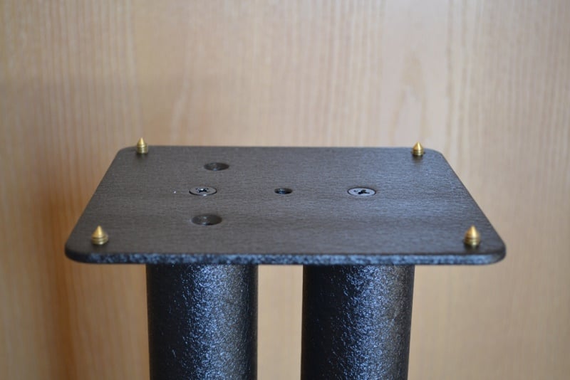

Top plates tend to vary in three ways. First, they may have rubber feet or speaker studs that your speakers set on. Rubber feet are most common and what the vast majority of people should use. The rubber provides a solid grip on the speakers and protects them from any damage. Speaker studs, on the other hand, can damage the bottom of your speakers and don’t grip as well; however, they do look cool and some people believe they will improve sound quality by reducing vibrations – that claim is questionable. Personally, we'd rather not risk scratching a cabinet finish for alleged better vibration isolation of metal spikes over rubber feet. If you're that concerned about reducing vibrations, either buy a stand that has solid posts or fill the hallow one with sand to make it more inert.
Sanus SF26 Top Plate with brass studs installed
Second, the top plate may have a hole through the middle that can be used to bolt the speaker to the stand. I’ve never seen a bookshelf speaker with a threaded insert at the bottom for such a purpose, but one could be added without too much difficulty if you’re an avid DIYer. Alternatively, a small wood screw into the bottom of a speaker wouldn’t cause any real damage as long as the hole is pre-drilled (I supposed here is where I should include a disclaimer that we don’t recommend drilling holes through your speakers... We don't recommend drilling holes in your speakers). Finally, the size of the top plate will dramatically affect the stability of the speaker on the stand. Before purchasing stands, check the size of the top plate and compare it to the size of your speakers to ensure there’s good coverage.

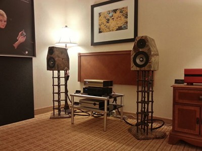

If money isn’t a concern, Status Acoustics makes $3k custom granite and steel stands to go with their $12k Voce Fina bookshelf speakers.

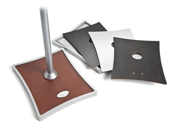

The OmiMount Gemini 2 stands feature interchangable base inserts
Stands usually come with two options for feet, rubber pads or spikes. Rubber pads should be use on solid floors, while spikes should be used on carpet. The spikes punch through the carpet and pad to secure speaker directly to the subfloor underneath. If you are particularly concerned about stability, try to find stands that work with 3rd party outriggers, such as those from Soundocity.
