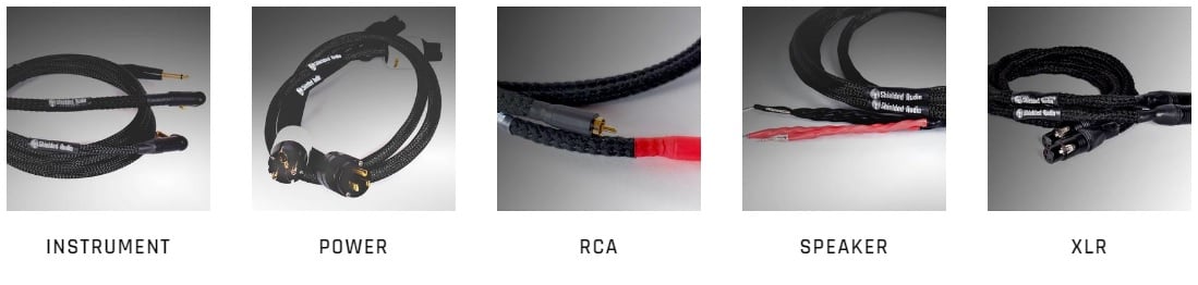

Shielded Audio covers cables ranging from instruments, power, RCA, XLR, and of course, speaker cables. They currently have two lines of speaker cables, their standard Velocity and upgraded Vector.

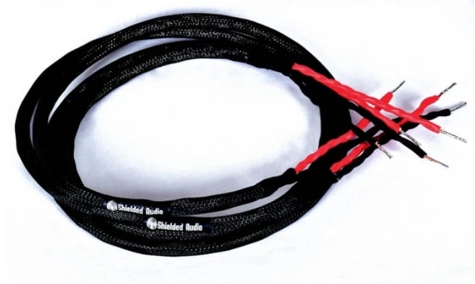

The Velocity line is composed of 12 AWG OFHC pure copper Speaker 2 cable and offers an affordable, shielded solution for systems up to 250 watts that is designed to be low resistance and low capacitance. The velocity speaker cable line ranges from $45 for a 3’ nude end to $210 for a 20’ nude end. For 3’ & 4’ speaker cables, add $20 for banana and spade connectors and for 5’–20’ speaker cables add $10 for banana and spade connectors.

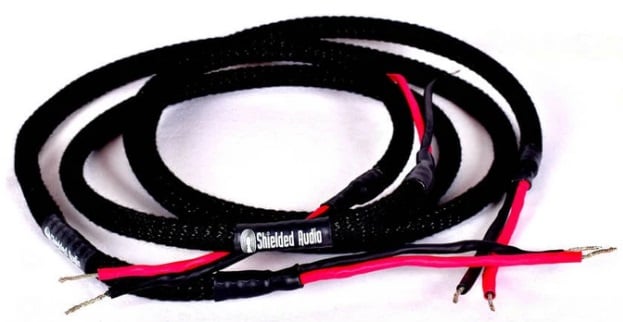

Shielded Audio designed their top of the line Vector cables with handcrafted 12 AWG solid core OFHC copper and braided copper shielding. The Vector line ranges from $185 for a 3’ nude end to $445 for a 20’ nude end. For the 3’ cable add $15 for banana and spade connectors and for 4’ to 20’ cables add $5 for banana and spade connectors. The necessity for shielding speaker cables is debatable since in most cases terminated speaker cables (connected to your speaker) typically do not exhibit RFI/EMI issues. However, there is NOTHING inherently wrong with offering shielded as an option for speaker cables.

The biggest difference in the two lines of speaker cables is that the Velocity cables are stranded while the Vector line is litz solid core (individually insulated).
The advantage of Litz is that each individual conductor is insulated to help reduce skin effect and thus maintain a more linear AC resistance profile well beyond the audio band (> 20kHz). This is something I will be measuring in the near future.
