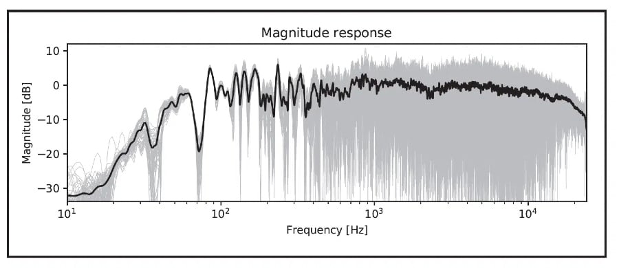

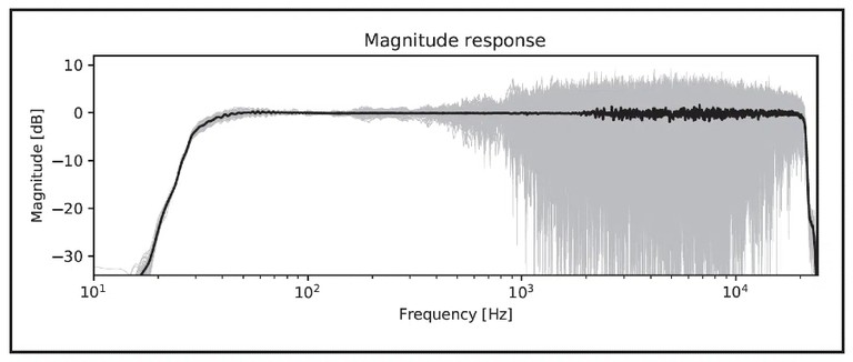

The measured responses of an uncorrected system, in 64 microphone positions (grey lines) and their average (black line).

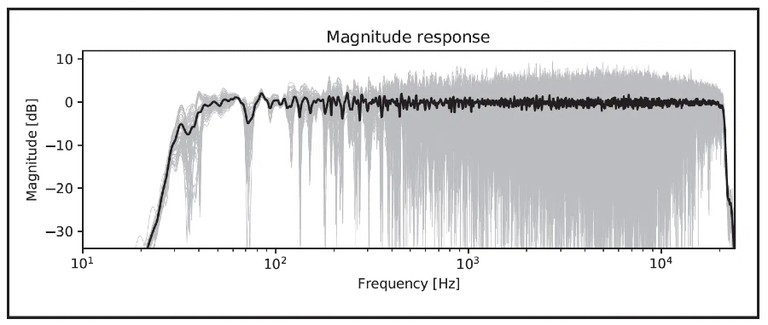

The measured response of a system using room correction based on single-channel technology. The average (black) is improved but spatial variations (grey) over different measurement positions remain.

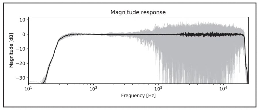

The measured response of a system using loudspeaker co-optimization for room correction, reflecting a flattening out, a reduction in spatial variations, and cancellation of room resonances.
