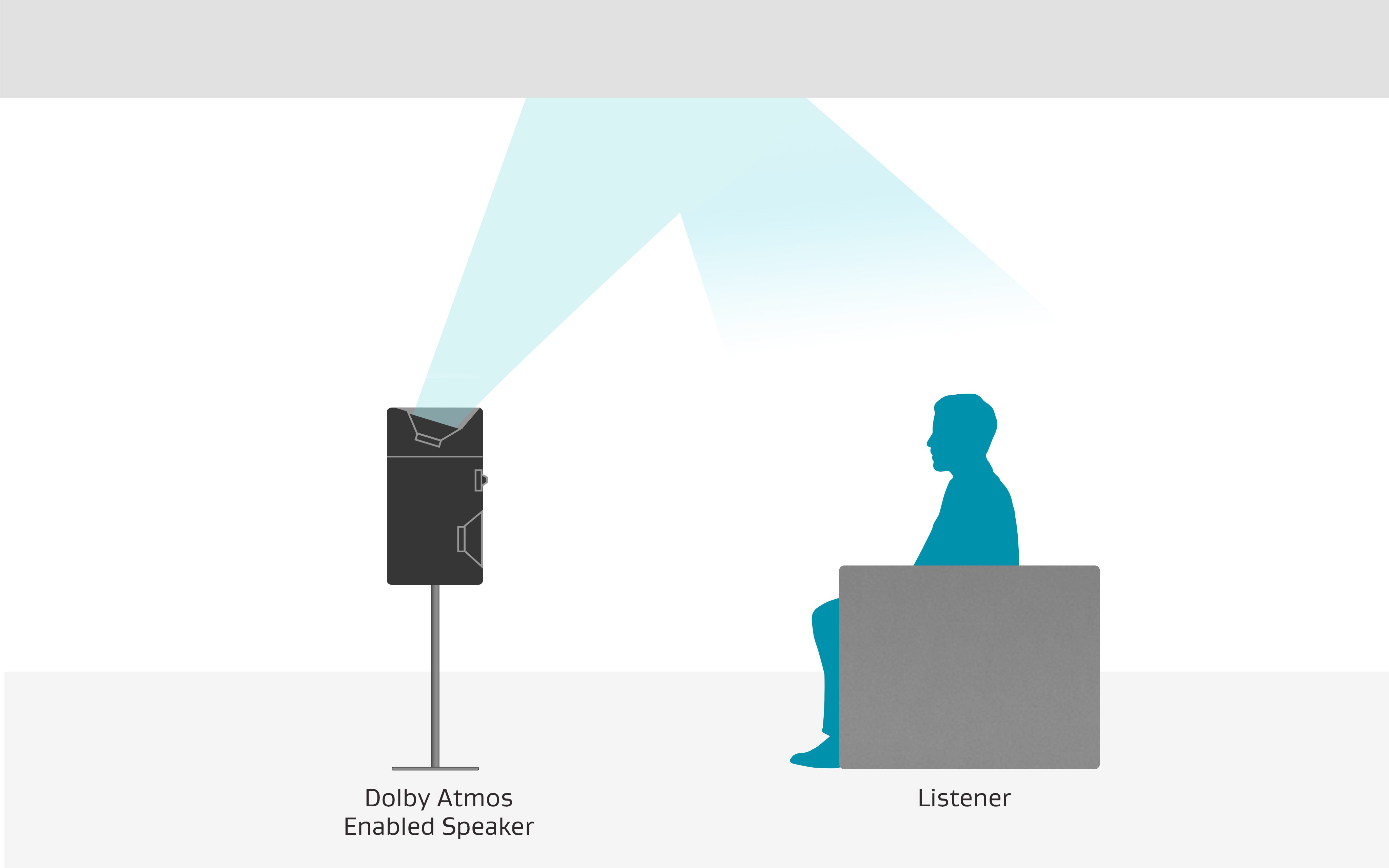

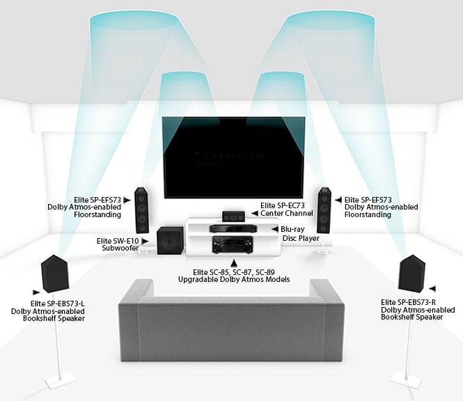

Dolby knows this quite well so they came up with their Atmos upfiring speaker (aka. Dolby-enabled speaker) which was designed to sit on top of your existing front and rear speakers firing up at the ceiling to bounce sound back down to the listening area.  On the surface this sounded a bit ridiculous since basic physics dictates sound does NOT project like ray optics shown in their diagrams.  Sure you could bounce the high frequencies off the ceiling, but its effectiveness depends on a lot of variables such as ceiling height, ceiling material, positioning of the speakers relative to the listener, etc.  It's far from an ideal solution to put it mildly.  That said, under the right circumstances this solution can give an elevated sound effect as intended but not without the penalty of muddying up the companion channels or being localizable if seated in close proximity to an upfiring speaker.  Rather than Dolby marketing this as a convenient solution to those that can't add the preferred discrete speaker, they and some of the Atmos-enabled speaker manufacturers were touting them as the "better solution" to discrete ceiling mounted speakers.  We heard all sorts of testimonies from "industry experts" as to why this speaker was preferred such as it offering better scatter or a more diffused and realistic sound.  Of course it was never mentioned that manufacturers licensing the Atmos-enabled speaker technology from Dolby have to pay a royalty fee whereas there is no such fee for using conventional ceiling mounted speakers.  But, I digress.

  • One year after the Atmos-enabled speaker was introduced, we can count on one hand how many manufacturers are producing this speaker (Atlantic Technology, Pioneer, KEF, Triad, Definitive Technology) and I guess Onkyo if you count the freebee speaker they provide with their Atmos receivers.
