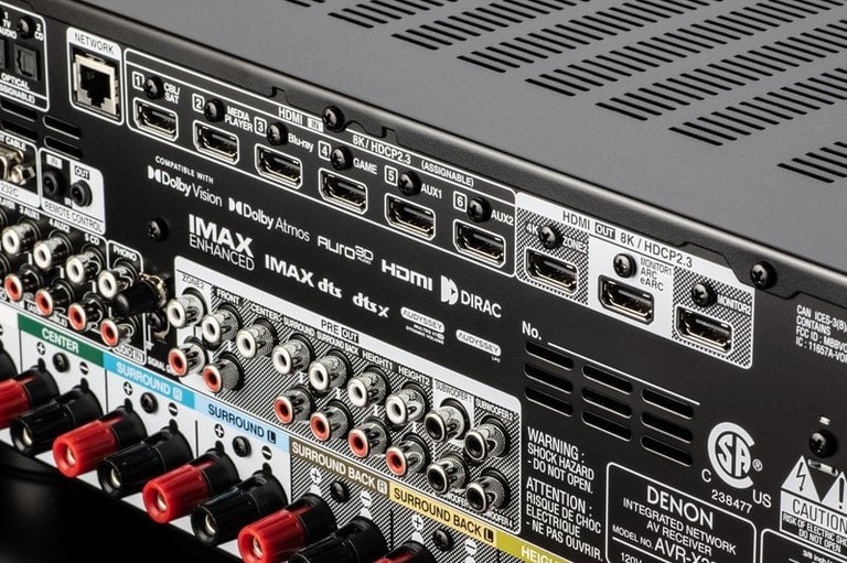

Used as strictly an AV receiver, the Denon AVR-X3800H has 9 channels of built in amplification. Denon rates the power at 180 watts/ch (6 ohms, 1kHz, 1%, 1CH driven). So much for Truth in Power. The real world power into 8 ohms, 2CH driven, is closer to 125-130 watts/ch which is still sufficient for most users needs. The fact that this unit has a preamp disconnect mode and the ability to route the amps to specific channels means you can add a high power 2CH amp to power your main speakers. In fact, If you want to use this receiver in full preamp mode, you can bypass ALL of the internal amps and connect external amplification making this a true 11.4 preamp/processor. In our prior bench tests of Denon and Marantz AV receivers, we found clean preamp sections capable of driving 4Vrms which is more than twice the voltage needed to drive most multi-channel amplifiers into clipping. In other words, these are all the good markings of a dedicated preamp/processor.
Denon AVR-X3800h Backpanel View - note the 4 subwoofer outputs

Denon has just upped its room correction game with FULL DIRAC support (upgrade option) in addition to simultaneously supporting Audyssey MultEQx. This is first time we've seen a line of new AV receivers support both room correction systems.

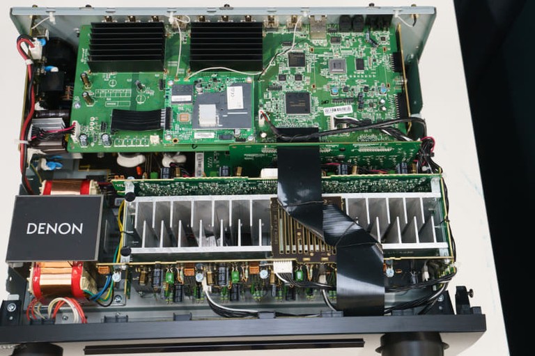

Denon AVR-X3800H Top Cover Removed
The Denon AVR-X3800H has a lot of tech crammed into it's case. You can see the large E-Core transformer in the lower left corner and the dual extruded aluminum heatsinks for the 9CH built in amplifier to the right of the power transformer. The dual heatsinks on the childcard at the back of the unit are likely to keep the HDMI 2.1 chipsets cool to ensure stable and long lived performance.
