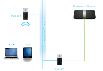

A better solution than a simple wireless range extender is to use an Ethernet over Powerline kit in conjunction with a range extender. Ethernet over powerline kits allow you to have the next best thing to an actual hard wired connection (If you’re not familiar with Ethernet over powerline kits, our wireless bridge article explains them as well). This solution offers a number of advantages over using a simple wireless extender. For starters, the second WAP doesn’t have to be within range of the existing wireless network. This allows you to extend the coverage area much farther than the wireless only extender because it cuts down on overlap. This system can also be faster and more reliable because it’s not piggy backing onto another wireless signal. Finally, this method is expandable to multiple powerline kits and WAPs, meaning you can create a huge wireless network. Like the first option outlined, these may use the same or different SSID than your existing network.
Linksys PLWK400 Diagram. Green = Ethernet. Blue = Existing electrical wiring
Sometimes these systems come as a complete kit (WiFi extender built into the Ethernet over powerline receiver), like the Linksys PLWK400 pictured above. In this scenario, the setup is nearly identical to that of a basic wireless range extender we have previously covered. There’s just one extra step. You need to connect the sending unit to the main router via an Ethernet cable and power on both the router and sending unit before setting up the wireless extender. For best results, plug both units directly into a wall outlet, instead of a surge protector. Note that the electrical wiring used by the sender and receiver needs to be connected to the same breaker box.

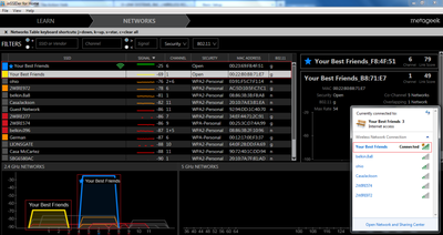

inSSIDer shows both networks, while Windows only sees one. Click to enlarge
At this point, everything should be working properly. If you need even more coverage, you can add additional WAPs around the home by repeating the process again. To test the setup, walk into an area of the home where the main router does not reach and test your internet connection. We also recommend using the program inSSIDer to view the signal strength of both networks and to ensure that your computer is connecting to the WAP, not the main router.

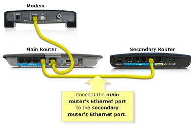

Ethernet connection diagram. Credit: Linksys
Disconnect your computer from the main network and connect it to one of the LAN jacks on the 2nd router (soon to be WAP). Power on and login to the 2nd router. Set the wireless SSID, encryption, and password so they are identical to the main network. Set the wireless channel so it is different than the main router. Next, assign the 2nd router an IP address outside the DHCP range of the main router, but within the subnet. If these were a simple WAP, you would be finished. But there is one last step.
DHCP Disabled
The last step is to turn off DHCP on the 2nd router, making it WAP with built-in switch. Disable DHCP and save the settings. Now you need to connect an Ethernet cable from an open LAN port on the back of the main router to an open LAN port on the back of the 2nd router. Make sure you are using a LAN port on the second router, not the WAN port you would normally use if it were the DHCP server for the network.
