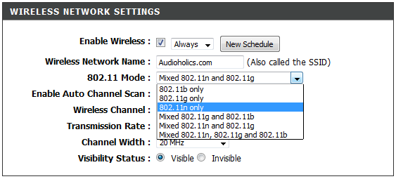

3. Disable old wireless protocols
Even though your fancy new router may be super-fast with 802.11n (or even 802.11ac), as soon as a device connects using an older protocol, say, 802.11g, the entire network slows down. The fix to this problem is to set the router to only broadcast newer wireless modes. For your reference, the speeds from slowest to fastest are: b, g, n, ac. Notice in the picture below that you can select which modes you want the router to work with.
wireless protocal g/n
Disable Old Wireless Modes
If all of the devices on your network support wireless n (802.11ac is faster, but most devices don’t support it yet), then select “802.11n only”. Unfortunately, this will kick any devices not compatible with wireless n off of the network. You can either:
A) stop using the older devices.
B) upgrade their wireless cards, if possible.
C) hardwire them to the router instead of connecting wirelessly.
D) select a mixed operation mode (like 802.11g + n), or E) purchase a dual band router.
Dual band routers are like having two routers built into one (close enough, anyway). They can broadcast two separate wireless networks simultaneously. This means that you could setup a wireless g network for you older devices, and a wireless n network for newer devices. This allows the older devices to connect to WiFi without slowing down newer devices. But don’t get too excited yet. Dual band routers operate by sending out the two wireless networks on different frequencies, one at 2.4Ghz, the other at 5Ghz. Many new wireless devices still do not work on a 5Ghz network, even if the device is 802.11n compatible. Additionally, 5Ghz wireless networks have poorer range than 2.4Ghz networks. You will want to do some research to find out which devices of yours actually support 5Ghz before investing in a dual band router. With that said, if you are planning on buying a new router anyway, go with a dual band router.

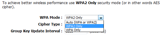

4. Use WPA2 security only
WEP encryption used to be the standard when it came to wireless security. However, now it’s not only a poor form of protection, but it can limit the speed of your network. The same goes for the more modern WPA standard. If possible, you should limit your router to only work with WPA2 encryption.
wpa2 security only
Wireless Encryption Settings

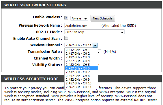

5. Change the wireless channel
You’re certainly not the only person on the block with wireless internet and routers only operate on a limited number of channels. Multiple routers operating on the same channel can cause all sorts of issues, including dropping a wireless signal all together.
First, go to an area you normally have wireless problems. If there aren’t any real problem areas, just move a few rooms away from the router.  Before changing anything, test the signal strength and speed, like you did when determining the best location for the router. This gives us a baseline and allows us to gauge the effects of any change we make.
wireless channel
Wireless Channel Setting
Most routers set the channel to “auto” by default. Find the channel setting in the router menu, and select the lowest option (CH 1 for 2.4gHz networks), then go back and check the signal strength and speed again. Repeat this process with a few different channels. I typically only test the lowest, middle, and highest channels. Once you have found the channel that gives you the best performance, select it and save the settings.

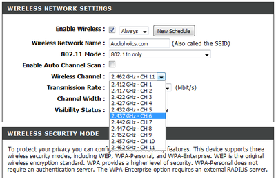

6. Change channel width
As wireless protocols have advanced, one of the ways they have increased speed is by operating using wider wireless channels. Wireless n routers need to use a 40Mhz channel width in order to achieve maximum speed. Most routers come with 20MHz as the default width, this is in an attempt to avoid interference. So, there is a potential for this change to negatively affect some users. If you start to notice issues, switch back to a 20Mhz operation. Also note that this isn’t really for increasing how fast you browse the internet, this change is more likely to be evident when streaming/transferring files between devices on your network.
Simply find the “Channel Width” setting in your router’s setting and change it to “Auto 20/40MHz”.
