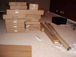

Middle Atlantic Rack (for Primary Theater Room)
Here
I am today contemplating how to hoist this nearly 7', 300lbs Middle
Atlantic rack up a flight of steps by myself (yea our premier system is
on the second floor, nobody ever accused me of common sense being my
strong point). Just as I built up enough courage (read: insanity) to move
it, the local UPS guy shows up with yet another delivery. He seemed to
be a sturdy fellow so I tried out a tip I learned from my business partner and offered him a quick $20 to help me
carry this beast upstairs.
We did it! But now can someone tell me how to assemble this thing? Look at all the boxes, yikes!
Ok
think back to childhood when you had to match up the shapes to the
empty peg boards. Does this look familiar? Good cause all of the
cables on the floor (and about three more box fulls) in the left pic
need to hook up to the main distribution box to the right. Are we
having fun yet?
