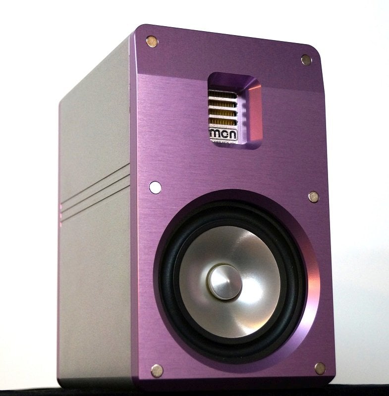

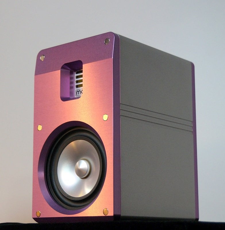

The SuperMon Mini speakers arrived in a heavy-duty cardboard box. The speakers were fitted in some pockets of a soft polyurethane foam bedding. Most speakers ship in stiffer polyethylene foam packing, but that is to hold the speakers in place since normal hollow wood enclosures can not endure being thrown around as much as these metal cabinets. The goal of Mon Acoustic’s packing is more geared toward protecting the speakers from scuffs and scratches rather than protecting the cabinet from jolts and shock since these aluminum enclosures are far more solid than normal speakers and that isn’t as much of a concern.
Once
unpacked, we are presented with some very upscale speakers that have a
glistening aluminum body. The speakers that I was sent have a lilac-colored
front baffle that gives them some flair, whereas an uncolored metal baffle
might be a bit too business-like for some people’s tastes. Side panels have an
undyed metallic luster, and there are some machined stripes on the sides.
Custom colors can be ordered for an additional cost. There are many different
colors available, and customers should get in contact with Mon Acoustics to
order their desired color. These speakers have a stylized industrial look that
would fit in nicely with modernist interior decor. They do not come with
grilles, but there would be little point in buying a speaker with such a
high-class metal exterior only to hide it behind some boring fabric. The front
baffle has a shallow beveling at the top for a slightly sleeker look. I would
imagine this shaping is aesthetically important since the wholly flat front
baffle might be a bit blunt looking. Longitudinal edges have a rounding to help
soften the appearance. An AMT tweeter is sunk into a deep waveguide that has a
steep inward beveling, and the silvery woofer is sunk into the front baffle
with a 90-degree beveling. The quality of the milling is excellent throughout.
A Mon badge is printed in the lower part of the AMT plate. Screw heads are
tastefully hidden by some magnets that make it look like the speaker was bolted
together with flat head rivets that are flush with the front baffle. That is a
beautiful attention to detail which is befitting the cost of these speakers.

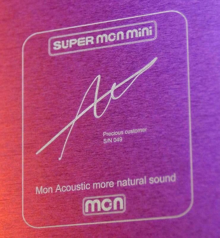

Model labeling and serial number are laser-etched on the rear. The SuperMon
Minis look like they would serve well as a business executive’s desktop system.
The aesthetics can not be faulted; these speakers look terrific.

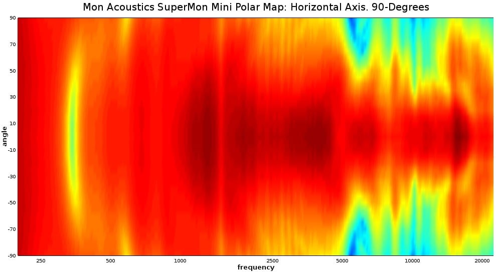

The above polar map graphs use color to portray amplitude, and this allows the use of a purely angle/frequency axis perspective. The advantage of these graphs is they can let us see broader trends in the speaker’s behavior more easily. For more information about the meaning of these graphs, we again refer the reader to Understanding Loudspeaker Review Measurements Part II.
In the above graph of the horizontal dispersion, the most stand-out aspect is how much the tweeter’s frequency band is restricted compared to the woofer. This is about what I expected when looking at the speaker’s design: wide dispersion from the woofer and narrow dispersion from the tweeter. The narrow waveguide on the tweeter is really constricting the tweeter’s dispersion, so users will want to be within a 30-degree horizontal angle of the tweeter. Listening within that angle isn’t likely to be a problem in a desktop situation.
Positional Tip: An easy way to know if you are too far off-axis is if you cannot see all of the lettering in the word ‘MON’ printed on the tweeter plate, you are not going to be hit with much of the tweeter’s output.

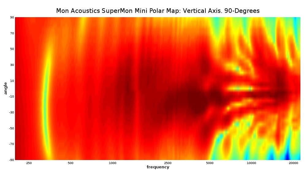

The above graph is a polar map of the Mini’s vertical dispersion. The tweeter is the axial reference point, and positive degrees are angles above the tweeter with negative degrees being angles below the tweeter. The tweeter’s band above 5kHz produces an unusual result. The narrow waveguide is causing some complex diffraction and reflection patterns. The angles at which there aren’t any nulls occurring are ten degrees above and below the tweeter, so that is where users should ideally aim the speaker to hit the ears on the vertical axis. However, even if those exact angles cannot be managed, this type of interference pattern, called comb-filtering, isn’t tremendously audible. In my own listening, changes in height did produce a change in the sound, but unless the height differences were dramatic, such as standing up versus sitting down, the effect on the sound was not huge. One of the reasons that this disordered dispersion pattern is not easily audible is that these effects are restricted to treble frequencies where human hearing isn’t the most sensitive. The entire midrange band is very consistent on both the vertical and horizontal axis. Moreover, the type of acoustic reflections this pattern can produce can average out at the point of the listener’s ears, so the dips created by this response can be shored up by reflections from near vertical surfaces, i.e., the desktop. Nonetheless, there is room to optimize the sound by adjusting the vertical angle. If the treble seems a bit soft, simply angle the speaker up or down by a few degrees.

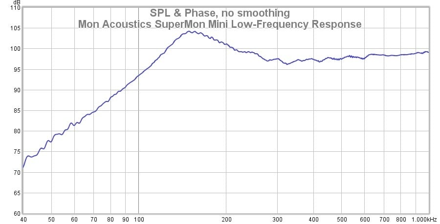

The above graph shows the SuperMon Mini’s low-frequency response that I captured using groundplane measurements (where the speaker and microphone are on the ground in a wide-open area). The most prominent feature is a bump at the port-tuning frequency of about 150Hz. This is probably what I heard as some thickness of the strings during my listening to the Kronos Quartet album. A lot of small speakers go for this type of voicing in order to make it sound bigger than it actually is, but it does color the sound, and I would prefer a more neutral response in that range. Curiously, the slope below that point rolls off at 12dB/octave slope, which is not normal for a ported enclosure. Usually ported loudspeakers roll off at a much steeper 24dB/octave slope below port tuning. I could only guess this is some kind of byproduct of the isobaric design since both woofers surround a sealed compartment. This is, however, not an unwelcome attribute, since it will do more to promote room gain which will shore up the low end thereby giving the user deeper bass extension than a typical ported roll-off. Nonetheless, I wouldn’t expect much deep bass from this speaker, and the addition of a subwoofer did significantly improve the sound in my own listening. I would encourage a higher crossover frequency over the standard 80Hz as well for those who do choose to use a subwoofer with these speakers. Few speakers of this size will deliver much deep bass at all. The ones that do have a very limited dynamic range and can reach their limits very quickly. That is the trade-off that has to be made in a small loudspeaker; you can have dynamic range or low extension but not both.

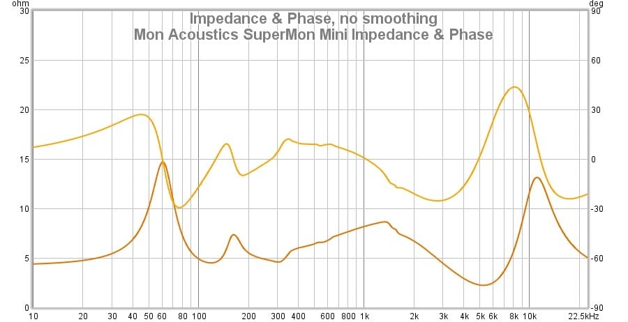

The above graph shows the electrical behavior of the SuperMon Mini. Mon Acoustics specs this as a 4-ohm speaker, and that is correct. The impedance and phase take on an unusual shape relative to other speakers, and I would attribute that to the isobaric design. The impedance minima dips down to just under 3 ohms and occurs around the crossover frequency between 5kHz and 6kHz. It is accompanied by a steep phase angle, and that can be a tough load for amplifiers. It is only alleviated by the fact that this low impedance and steep phase range starts at 4kHz which is just above the all-important midrange that is so heavily used by so many recordings. The other good news is that in a desktop environment, it’s not likely to get cranked super loud, so most amplifiers that are paired with this speaker aren’t going to be driven to the bleeding edge. All the same, I would not try to drive these speakers with a cheap, low-powered chip amp, not that anyone spending $2k on a speaker set is going to power them with a $75 amplifier.
I measured the sensitivity of the Minis to be 86.1dB for 1 meter at 2.83v. While that is a tad under Mon Acoustic’s listed sensitivity spec, this is actually a bit more sensitive than I would have guessed given the design. For a small speaker, 86.1dB is quite good. These speakers won’t need a powerful amp to get loud, especially for their intended application.
