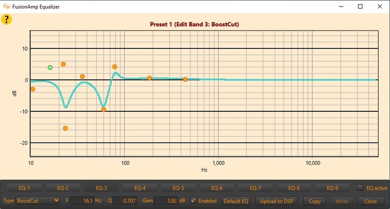

- Equalizer / Room correction: Manual EQ, 9-band parametric

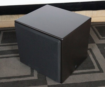

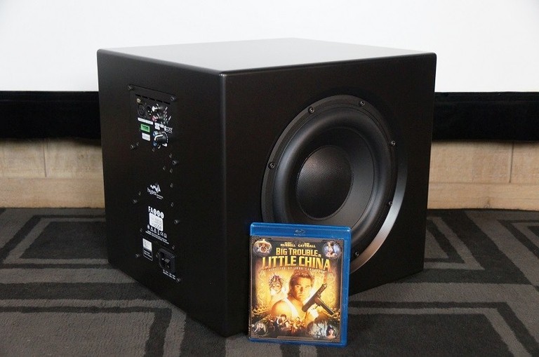

Packing and Appearance
The 10D arrived in a heavy-duty cardboard box with some dense polyurethane foam packing. That should be adequate to protect it for routine shipping practices, but I think it could benefit from double boxing and another layer of foam in case shipping transit gets rough. Once unpacked, the 10D is revealed to be an understated yet attractive subwoofer. All the edges are rounded, and it has a fine satin black finish. Apart from the side-mounted drivers, the only detailed feature is the Sigberg emblem on the lower front of the unit. Its minimalism gives it an air of seriousness, but the rounded edges soften that a bit. That minimalism could have been emphasized a bit more if the drivers had trim rings around the frame, and if the cones had used inverted dustcaps, but those who want minimalist as possible will probably just use the grilles which hide the drivers altogether. They use magnetic grille guides so the side panels are that much cleaner looking. The feet are spherical and aren’t really visible when the sub is resting on them. There isn’t a whole lot more to say about the appearance of something with such a simple industrial design. It is classy-looking without being flashy or ostentatious.

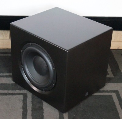

The
basic design of the Sigberg Audio 10D Subwoofer is a sealed sub with two
dual-opposed mounted drivers and is powered by a 500-watt RMS Class-D
amplifier. There is, of course, much more to it than that, so let’s dig into

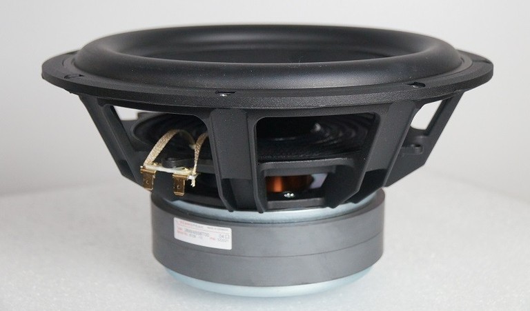

some of the details, and let’s start with the driver. Sigberg uses a Scan-Speak
driver from the Discovery line, which is a known quantity among speaker
designers for its wide bandwidth and linearity. It’s a driver befitting of a
high-end subwoofer. It has 1” of linear travel, peak-to-peak, and over 2” of
total peak-to-peak excursion, which is quite a bit for a 10” woofer. Two 10”
woofers have about the same surface area as a 14” cone, so this subwoofer could
be considered the equal of a sealed 14”, everything else being equal. However,
everything else is not equal, since few 14” drivers would have anything like
the combined motor properties of these two 10’s. One nice thing about splitting
the displacement of a subwoofer among multiple drivers is that sensitivity can
be retained and inductance can be lowered since there isn’t a whole lot of coil
stuffed into a single motor. That means the moving assembly weighs less,
thereby increasing sensitivity, and not as much moving copper in the gap will
produce less inductance, thereby flattening the response as well as reducing
even-order distortion.
The cone itself is made from aluminum and has a large glass fiber dustcap. Aluminum is a bit heavier than some alternative cone materials that could have been used, but it does have the added benefit of serving as a good heatsink. It attaches to the basket via a thin and light NBR half-roll surround that should provide a lot of travel before any serious tension sets in. The basket itself is a heavy-duty cast-aluminum piece that definitely will not flex in the slightest against anything the moving assembly could do. The motor uses a stack of two magnets for a combined thickness of 1 ⅜” with a 5 ¾” diameter, although those figures aren’t all that meaningful without knowing the magnetic flux they produce in the gap. I would guess they would provide a great deal of force, since this driver doesn’t appear to be using a huge coil to drive the moving assembly and would therefore be relying more on the magnets to provide force. Again, this is another good strategy to reduce inductance. The motor uses a 2” diameter voice coil around a titanium former. The heat conductivity of titanium isn’t very good, but it is light and is only weakly magnetic so it won’t interfere with the magnetic field of the motor very much. Venting of the motor is done in the basket under the spider. The backplate is slightly bumped out to allow for greater excursion without hard bottoming of the former.

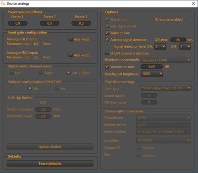

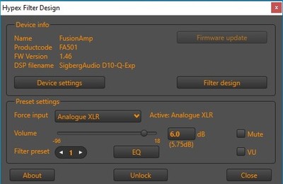

power the drivers, Sigberg has chosen Hypex’s FA501 amplifier, again using the
acclaimed nCore modules much like Sigberg’s other offerings. This
state-of-the-art Class-D amp provides 500W RMS of power with extremely low
distortion and noise with linearity metrics that are much better than
subwoofers could probably ever benefit from. The drivers are wired in a
parallel circuit with the amp, and that might seem like a heavy load with two
4-ohm drivers, but the amp has been verified to be stable with the 10D’s
electrical load. The drivers are given as much power as they can handle, and
the limiters set by Sigberg ensure that they won’t beat themselves to death
from over-excursion or melt from thermal overdriving as well.
The amp has a balanced XLR input and throughput, as well as left and right RCA inputs. There are also high-level inputs for those who want to connect it to a system via speaker wire. The amp also has a USB input with which its DSP functions can be accessed from a Windows PC, and Sigberg provides the USB Mini-B cable with which to connect the sub to the PC. There are three preset configurations that can be accessed from the amp controls: Preset 1 removes the low-pass filter so the sub can be used with external bass management. Preset 2 sets the sub up to be used with the Sigberg Audio SBS.1 speakers by lowpass filtering the subwoofer at 100Hz. Preset 3 lowpass filters the sub at 40Hz and is intended to simply shore up the lowest octave in systems that have no bass management. Included in the software is a 9-band parametric EQ, so the inevitable deformation that in-room acoustics does to the response can compensated for to a pretty fine degree. Of course, it is always good practice to address peaks with equalization and dips with placement, and, if it can be accommodated, a multi-sub system. Other aspects of the sub that can be adjusted are individual input gain, input level for wake-up, time to enter standby after no signal detection, LED brightness, among others.
The
MDF enclosure is a fairly beefy one with the drivers being mounted on panels
that are approximately 1 ¼” thick. Running parallel to the drivers are two
full-length braces with large holes. There is a soft, rubbery foam lining the
side walls for damping. The feet, as previously mentioned, are rubber
half-spheres that give the sub a reasonable level of clearance. They aren’t
hard rubber so they won’t scratch any hard flooring, and they are probably
well-damped enough to absorb what little cabinet vibration might occur. With a
dual-opposed driver orientation, the moving force that each driver imparts on
the enclosure is canceled out by the opposite driver, and this prevents the
drivers from transferring any rocking motion on the cabinet. That, combined
with the heavy internal bracing, means that the 10D cabinet should be solid as
a rock at every drive level. This level of build quality should be expected at
this price point, and Sigberg delivers it. It can be felt in the 60 lbs.
weight, a considerable amount of heft for such a small sub.

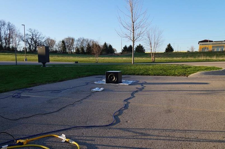

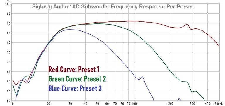

Testing on the Sigberg Audio 10D was conducted with the microphone facing the woofer at a 1-meter distance and then scaled back to 2-meters in our graphs by subtracting 6dB in output. The temperature was recorded at 49F degrees with 70% humidity. The subwoofer’s gain was set to maximum and the low pass filters were left off.
The above graph shows the measured frequency responses for the Sigberg Audio 10D subwoofer per its individual presets. Preset 1 is what most people will use, and this gets us a strong, flat response from 25Hz all the way to 400Hz. We can see here just how wideband these drivers are. The 10D has a very neutral response. We can see that the 10D uses high-pass filters to protect the low-end since the low-frequency roll-off does not have the standard 12dB/octave slope that a basic sealed subwoofer would have. Preset 2 has an upper-end gradual off that intends for it to blend in with the Sigberg Audio SBS.1 speakers. As was mentioned before, Preset 3 is intended to simply shore up the deep end of loudspeakers in systems that do not have any kind of bass management at all like older style integrated amps. Many loudspeakers roll off the low-end response at around 40Hz to 50Hz, so preset 3 can get such a system some deeper bass without adding too much extra bass on top of the main speakers. I don’t expect that many people will use this sub in such a manner though.

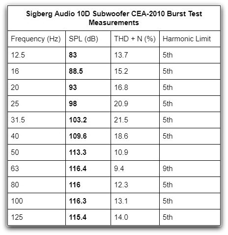

The above CEA-2010 measurements are
short-term bursts that show the subwoofer’s clean peak SPL before heavy
distortion sets in. Our measurements have been referenced to 2-meter RMS, which
is 9dB down from the standard requirement for the measurements to be shown at
1-meter peak. However most publicly available CEA-2010 measurements are shown
at 2-meter RMS, so we followed that convention. This is a strong measurement
set for such a small sub. It’s the kind of measurements I would expect from a
high-powered sealed 12”. The mid-bass output matches some of the 15” subs that
we have reviewed in the past and blows away all of the 12”s. It’s no wonder
that the 10D proved to be so powerful on music tracks. This thing is a little
beast! These burst-test numbers net it the Audioholics’ Bassaholics ‘Medium’
Room Size Rating which almost but not quite gets the ‘Large’ room rating,
although if you are listening to acoustic music, this sub, with 116dB in the
mid-bass range, could probably handle a large room by itself.

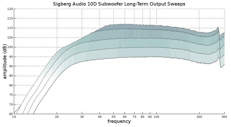

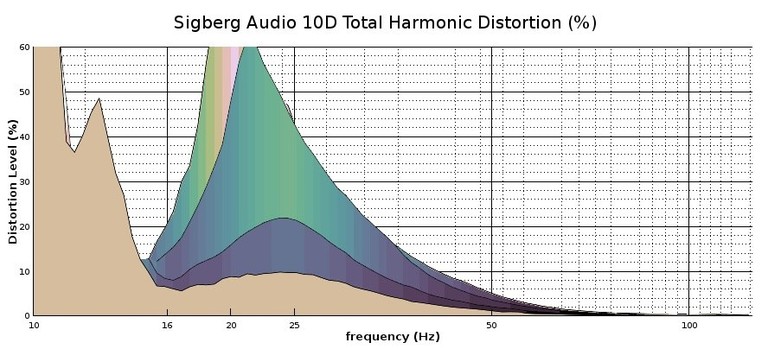

Testing for long-term output compression was done by first conducting a 20-second sweep tone where 50Hz hit 90 dB with the subwoofer 2-meters from the microphone. We then conduct further 20-second sweeps by raising the gain by 5dB until no more output could be wrung out of the subwoofer. These tests show us the long-term continuous headroom that the subwoofer is capable of. At the highest drive levels, the 10D does encounter some compression from about 25Hz to 40Hz, but it is relatively mild compared to most subs. This sub holds its beautifully flat response at all but the highest drive levels. At mid-bass, it can hold a continuous 110dB which, again, one would expect from a high-powered 12” or a typical 15”. Again, this is not the output one would expect from such a small sub.

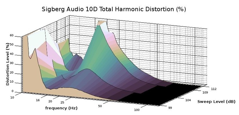

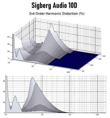

The above graphs show the corresponding total harmonic distortion to the long-term output graphs. Essentially, they depict how linear the subwoofer remains for the corresponding drive level seen in the long-term sweeps. The quantity being measured is how much of the subwoofer’s output is distortion and is shown here as a percentage. One quick note; the spike of distortion that rises up as frequencies dip below 15Hz is primarily from background noise. This sub doesn’t produce much output at such low frequencies, and so background noise becomes a significant component of the recorded measurement.
One immediately apparent feature is the effect of the limiter; distortion goes up at a nearly logarithmic rate as frequencies go down, which is customary for a sealed subwoofer. But go down a bit further, and distortion rapidly falls down again, and that is from the limiter restricting cone motion. Without it, the voice coil may well beat itself to death. At the last few dB of headroom, distortion can get fairly high in deep bass, but below that point, the 10D keeps its composure very well. In mid-bass, the 10D doesn’t want to produce any distortion at all in this test, even at maximum drive levels. At the lowest sweep shown in this graph, the 95dB sweep, distortion never rises above 10% until below 15Hz. That means at nominal drive levels, the 10D is an extremely clean and linear subwoofer. The bottom line from these graphs is that it's just not terribly happy when pushed hard in deep bass but then very few sealed subs are.
Astute readers might note the discrepancy between the vanishingly low distortion in midbass in these long-term sweeps but higher distortion products in the burst tests. The reason for this seems to be that the amp has a protection circuit that clamps down on a continuous, extremely large signal, but doesn’t react similarly for a burst signal since that power can be sustained for a short period. While the sub can be driven pretty hard, it does have limiters that protect the drivers from self-destructing. I pushed the sub as hard as it could be pushed with an input signal, and it did not bottom out or give any other sign that the drivers were in danger.

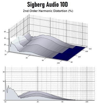

The above graphs depict measurements of the constituent harmonics from the long-term output sweeps and are what the total harmonic distortion measurements are composed of for the 2nd and 3rd harmonics. These individual harmonics can give us a clue as to what might be the cause of some quirk or non-linearity. We are only showing the 2nd and 3rd here because they more or less reflect the higher even-order and odd-order behaviors, although higher-order harmonics tend to be much further down as a percentage of distortion compared to the second and third.
An interesting feature to note with these graphs is that the even-order distortion rises with a pretty steady rate relative to drive level, but the odd-order harmonics stay extremely low until the highest drive level at which it skyrockets in deep bass. I would guess from that kind of distortion profile that the source of even-order harmonic distortion is primarily from induction which tends to scale evenly with output level. Induction can cause an asymmetry in the back-and-forth motion of the driver. What minuscule distortion that occurs in mid-bass comes from the even-order harmonics. An advantage here is that even-order harmonic distortion is more difficult to perceive than odd-order, and so in the music frequency band, what little distortion exists is a less intrusive sort. Once the driver nears its limits, we can see from the 3rd harmonic graph that both directions of travel get evenly impacted by a restriction in its excursion.

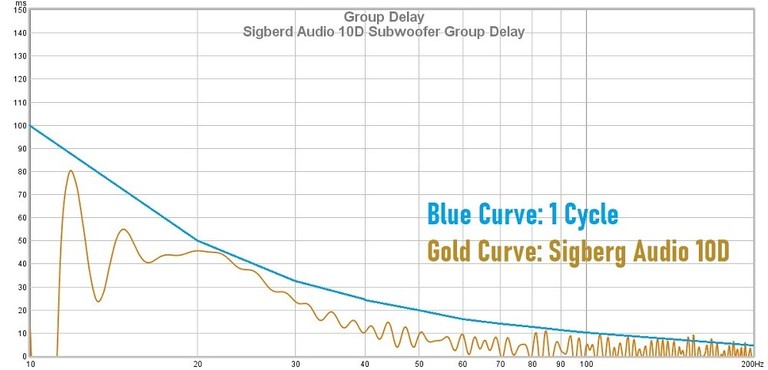

Group delay is the measurement of how much time it takes for individual frequency bands of an input signal to be produced by the speaker. It can indicate that some frequency components are developing slower than others or are taking longer to decay. It is generally thought that 1.5 sound cycles are needed for group delay to be audible at bass frequencies, although there is an argument that group delay should remain under 20ms to be completely unnoticeable, but that is likely meant for mid and upper bass frequencies.
Normally I include a 1.5 cycle curve on this graph, but since the 10D does not meaningfully exceed even 1 cycle, I didn’t even bother. The 10D posts some overall very good results here, staying below 10ms above 50Hz. Group delay does start to rise a bit below 35Hz or so, and that is due to the high-pass filter that Sigberg has employed to protect the sub. It has a remarkably mild time-domain effect considering how steep its effect on the frequency response is. Overall, this is a very good showing, and this sub will have a sharp sound without any audible decay times.
