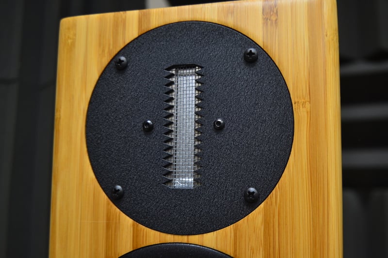

- Tweeter Custom made RAAL true ribbon tweeter featuring a 10mm wide pure aluminum ribbon with a total moving mass less than 1/100th of a gram.

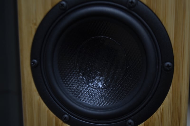

- Woofer 4.5” long-throw dual compliant CURVTM woofer, non-resonant cast magnesium frame, SEAS SpiderRingR technology, vented pole-piece and vented spider. Custom made by SEAS of Norway.

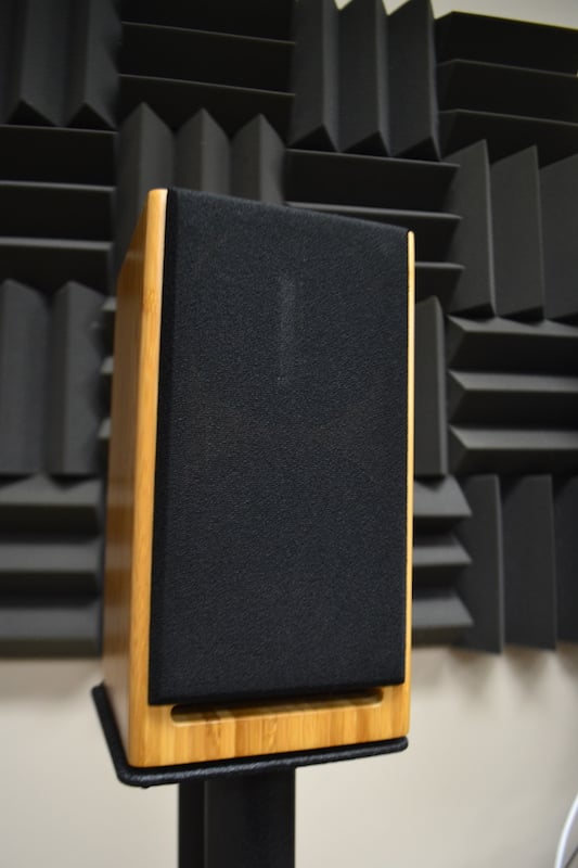

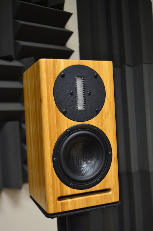

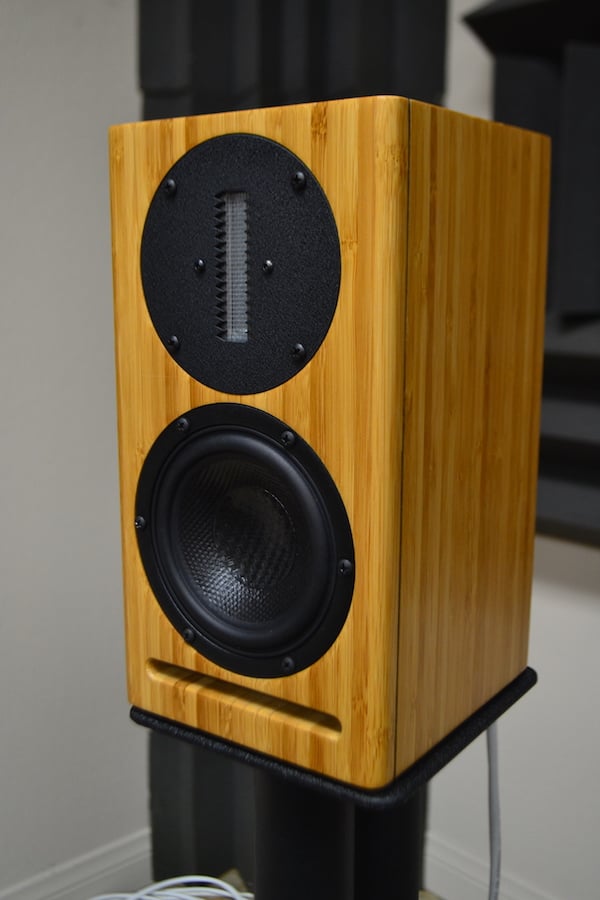

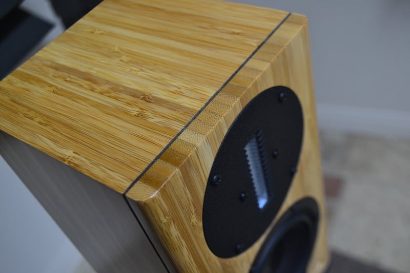

Ascend Acoustics is a budget friendly high quality speaker manufacturer located in San Clemente, CA. They have been in business for nearly 20 years. As it says on their website, they are interested in “Reaching the Peak of Audio Purity.” I was given a tour by president & chief designer of Ascend Acoustics, Dave Fabrikant and after my experience in their demo room their diligence allows their slogan to ring true. The most recent product to emerge from the shop is the Sierra Luna mini-monitor. This unique product is basically a miniature version of the Sierra-2 loudspeaker. It contains the same custom RAAL 10mm ribbon tweeter, the same V-LAM bamboo cabinet material and finishes, but this time with a small front firing slot port below the 4.5” long throw dual compliant CURV woofer custom made by SEAS of Norway.
The demo models were in the “Natural” finish and very smooth to the touch. There were no gaps in the finish whatsoever. The frequency response is 60Hz-27kHz +/- 3dB, with an anechoic sensitivity of 83.5dB at 2.83v @ 1m (typical in-room sensitivity of 85dB), 8ohm nominal impedance, and 150w maximum continuous power handling. The Lunas are 10.5”H x 5.75”W x 6”D (sans magnetic grill), weigh-in at 9lbs ea. and have a recessed pair of gold plated 5-way binding posts. The black fabric grill is also unique because the mounting system uses 8 completely hidden neodymium magnets to securely hold the grille in place.
They are designed as an extremely versatile high-performance no compromise mini-monitor, ideal for use as desktop monitors, on-wall or stand mounted front and/or rear speakers, or simply as left/right main speakers. Ascend does recommend the use of a subwoofer to fill in the bottom 2 octaves. Each loudspeaker contains a rear integrated keyhole bracket (for true flush mounting to a wall) and a ¼-20 threaded insert for attaching to swivel wall brackets. These speakers also come with Ascend’s 7-year parts and labor warranty and 30-day satisfaction guarantee.

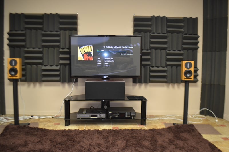

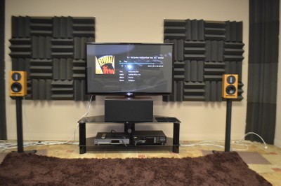

The demo room at Ascend was arranged similar to a family room one would have at home. The loudspeakers were set up on stands along the opposite wall of the leather sofa to the left and right of the large format flat screen TV. This orientation was longer than wide. Along the walls and corners of the room were acoustic dampening materials, which can be removed, as Dave explained, depending on the customer preference. To the left of the seating area was the electronic components. The audio content came from an OPPO Blu-Ray player. This was connected to a Rotel RSP-1068 surround processor in 2-channel operation, which was also run through an ADA PTM-6150 power amp to the speakers. Also to the left of the seating was a Rythmik F12se subwoofer with the spectacular piano black finish. The sub was not used until the end of the session and only on a few tracks.
