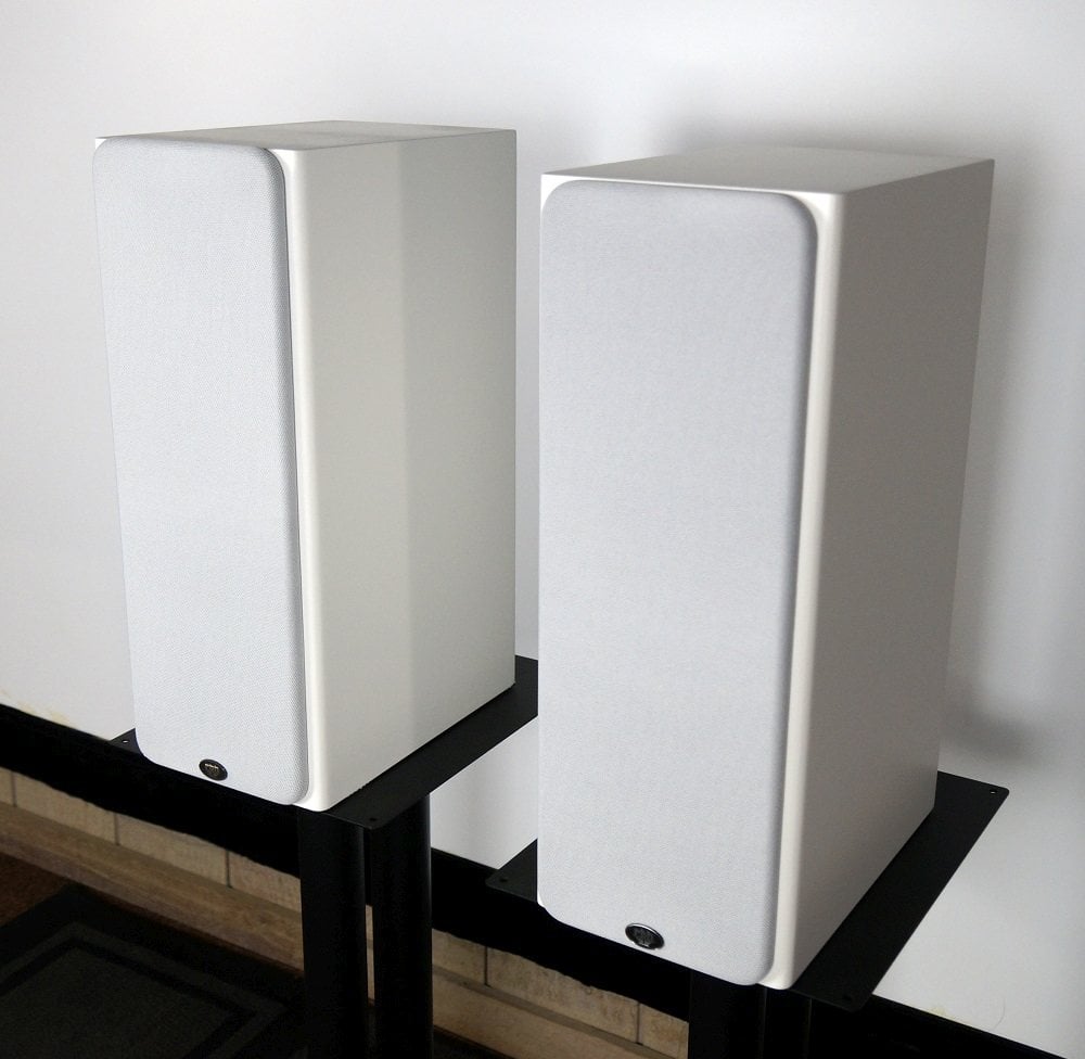

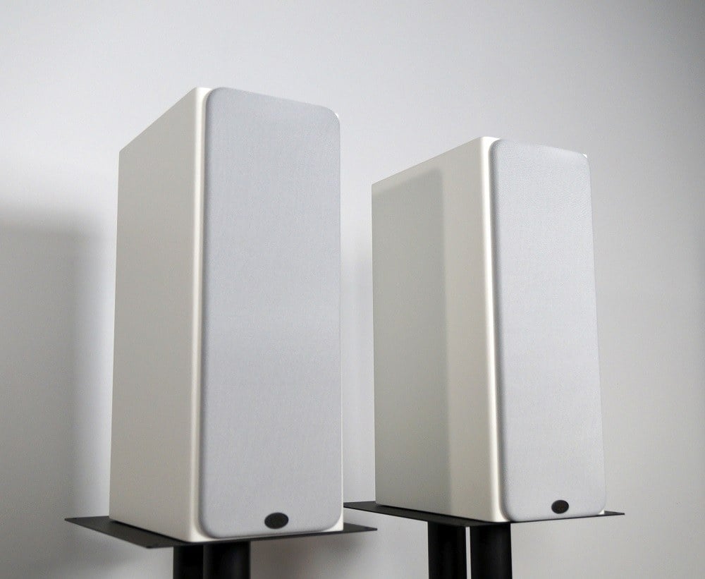

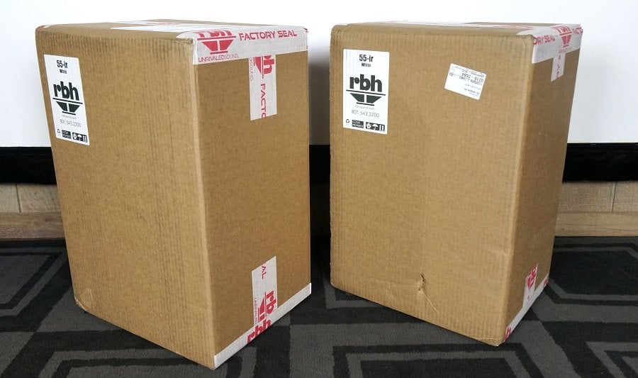

Since buyers are likely to receive the RBH Sound 55-ir speakers via parcel delivery, packing will matter with these speakers. The 55-ir arrived at my doorstep in some medium-sized boxes. They were double-boxed in a somewhat unconventional way. Instead of one box immediately covering the other, there was a layer of packing between the two boxes, with styrofoam edge protection and polyethylene end cap pieces. The speaker was covered by a cotton sleeve to protect it from scuffs and moisture. It’s hugged pretty tightly by the inner box, so users will want to use caution if opening the box with a knife to make sure not to cut the speaker itself. Overall, the packing was good and should do well in protecting the speakers from the usual harsh shipping practices.
55ir grilles8   55ir pair21

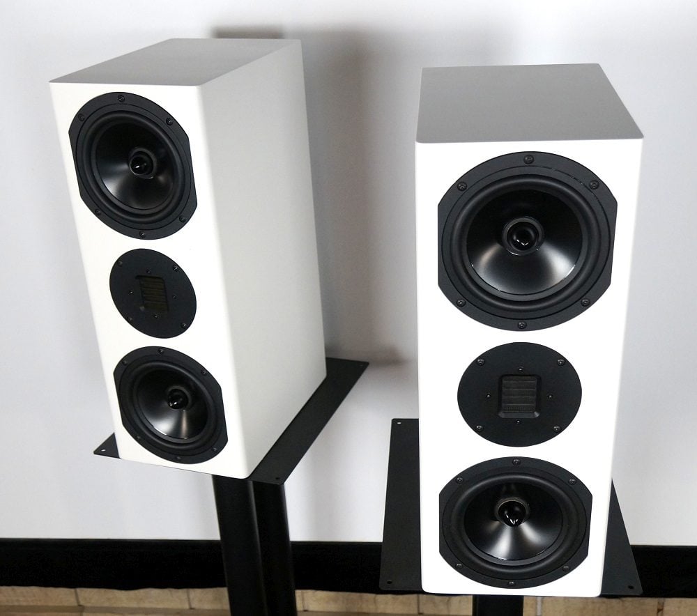

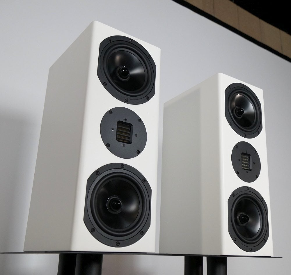

Once unboxed, the 55-ir speakers are revealed to be a simple and tasteful design that will fit in with a wide variety of interior decors. They can be had in a satin black or satin white finish, and I received the satin white. They are tall and slender standmount speakers, but not large ones. The edges and corners have all been rounded to soften its appearance. The black drivers do stand out in the white front baffle, but they can be concealed by a white fabric grille. With the grille attached, the speakers have a fairly minimal look, but when the grilles are removed, they stand out more as loudspeakers. The finish is real paint instead of some kind of vinyl wrap. It is not quite as high-end of a satin finish as RBH’s higher-cost offerings, but it is not bad at all, especially for the pricing. Overall, I think the 55-ir LCR speakers look quite nice. They might not be as stylish as speakers with curved or slanted cabinets or more flamboyant driver appearances, but they are inoffensive and shouldn’t cause a problem with other household dwellers if placed in a living room or other shared living space.

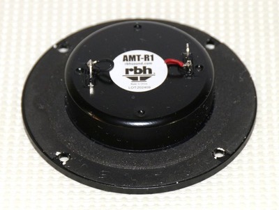

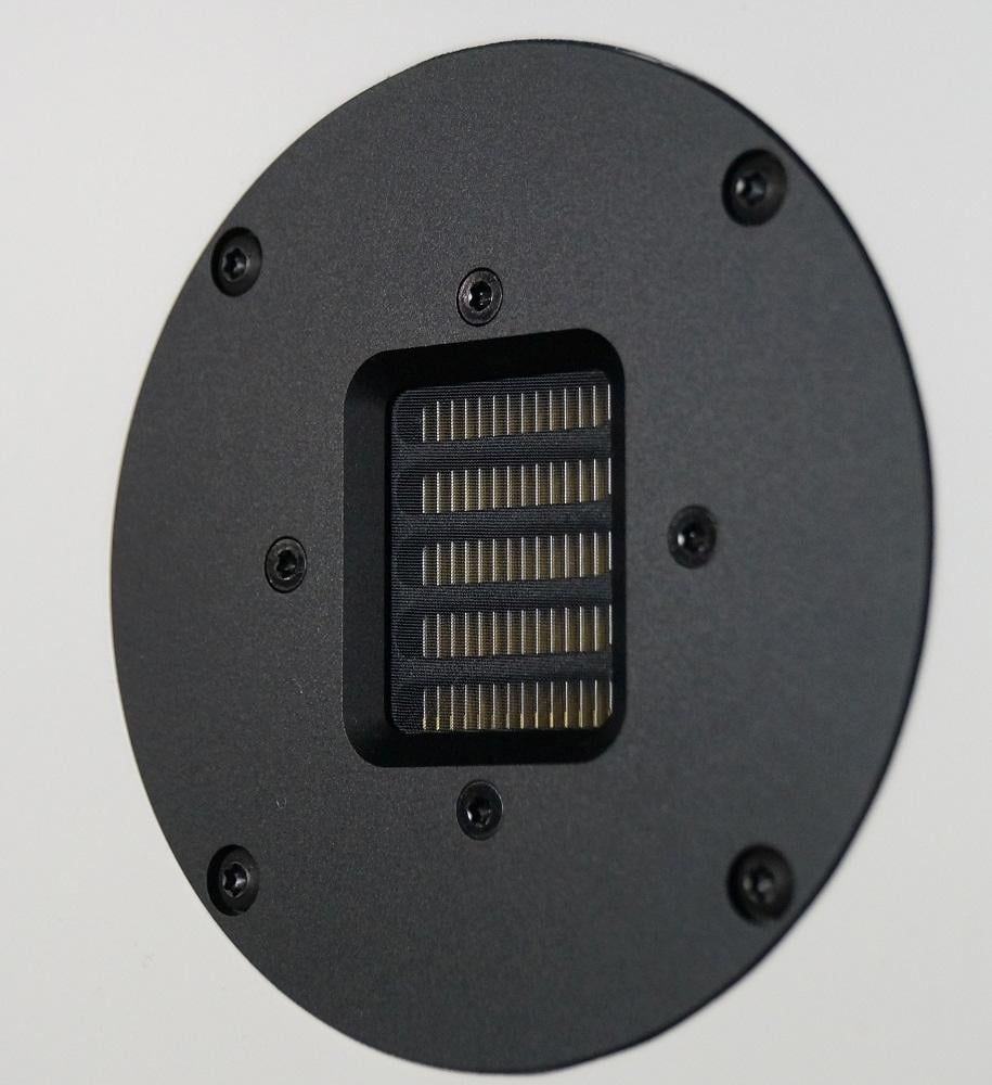

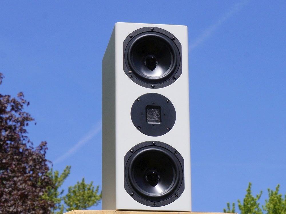

Summing up the 55-ir design in a quick sentence, I would call it a standmount, MTM, vented loudspeaker, but such a terse description misses all the details, and in high-fidelity loudspeakers, it’s the design details that can make or break a speaker. Let’s start our discussion of the details at the top of the frequency range, the tweeter. The 55-ir uses a 1.38” x 1” AMT tweeter. AMTs, an acronym for “Air Motion Transformer,” have become a lot more popular in the last decade. They can have a very wide dynamic range, as well as a response that extends high into ultrasonic ranges. Some manufacturers often mislabel them as “ribbon” tweeters in an effort to make them seem higher-end than they really are. The truth is, actual ribbon tweeters are an entirely different animal and not nearly as durable as AMTs.

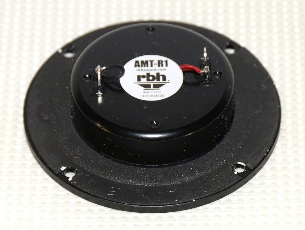

55ir tweeter2  55ir tweeter motor

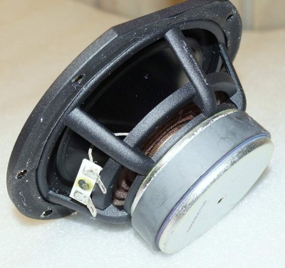

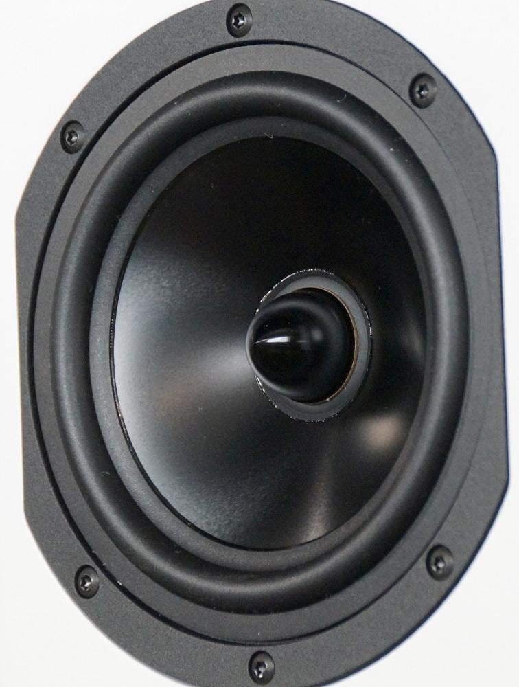

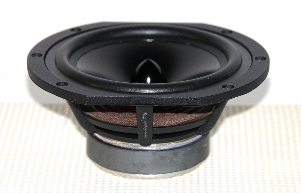

The tweeter gets handed off to the midrange drivers at 3kHz with a 4th-order slope. The midrange drivers use 5.25” aluminum cones that are anodized black. There is a fixed phase plug that is attached to the pole piece. Some loudspeaker drivers in this class look like they have a phase plug, but the “plug” is attached to the moving assembly and is cosmetic only. The 55-ir woofers also have cast aluminum baskets instead of stamped steel frames. Cast aluminum is usually a better option over stamped steel since it’s often more rigid and paramagnetic. The motor uses a 3” x ⅝” magnet, and venting is done underneath the spider.

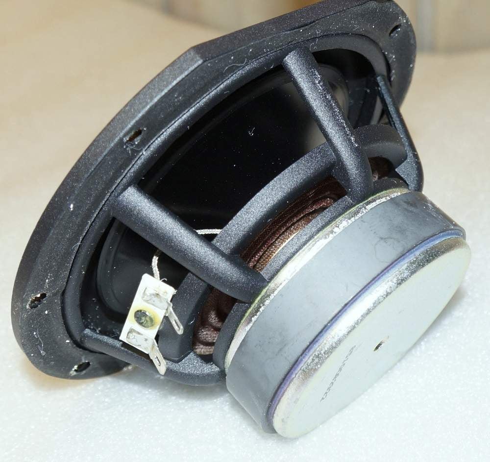

55ir woofer cone   55ir woofer motor2

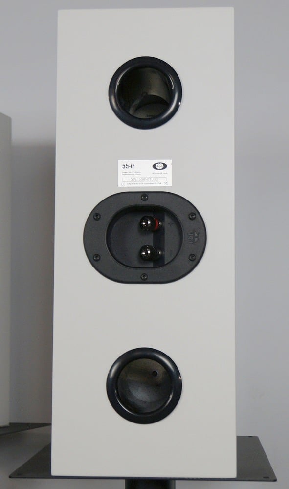

55ir rearThe deepest frequencies are generated by the ports, which are a pair of 4” long and 2” diameter tubes that are flared on the exterior side. The enclosure is made from HDF, high-density fiberboard, which is tougher than the standard MDF used in most loudspeaker construction. The panels are ½” thick and there are two window braces that separate each woofer from the tweeter. The cabinet has a generous amount of polyfill-type stuffing to damp internal pressure waves. The terminal cup holds a pair of sturdy five-way binding posts. The grille uses magnetic adhesion in order to make for a cleaner appearance. The grille frame might create some diffraction effects, as with so many grilles, so the speaker might sound best with the grilles off, although my guess is that the differences would be slight, if they could be heard at all.
As we saw in the 85-i speakers from the Impression series, an interesting feature of the crossover circuit in the 55-ir speakers is the use of a self-resetting poly-switch. This protects the tweeter by raising resistance above certain electrical current levels that would place the driver’s voice coil in danger. With a 3kHz crossover at a 24dB/octave slope, the tweeter should be pretty well protected anyway, but that additional layer of protection is nice to have, especially since the AMT tweeter is likely to be an expensive component.
Zooming out a bit, a good AMT tweeter with a 3kHz crossover and two decent 5.25” midrange/midbass drivers should be capable of producing a lot of SPL, especially if the speaker isn’t trying to tackle deep bass. With the addition of a subwoofer, these speakers should be able to hit hard despite their modest size. But let’s see how that plays out in some real-world listening…

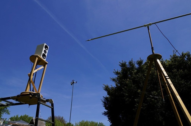

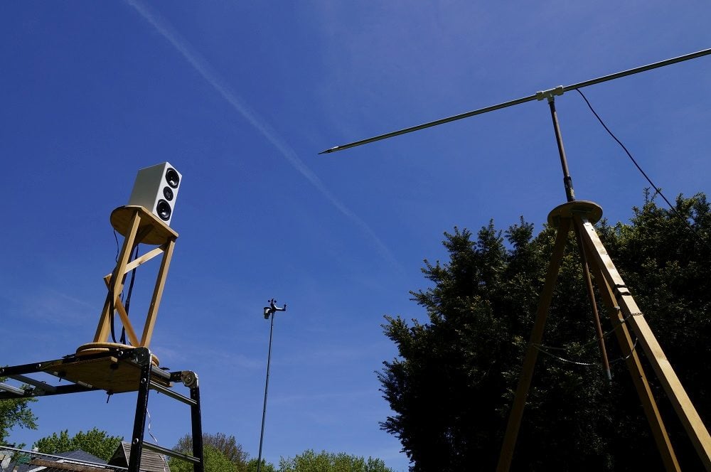

55ir outdoor testing
The RBH Sound 55-ir speakers were measured in free air at a height of 7.5 feet at a 1-meter distance from the microphone, and the measurements were gated at an 11-millisecond delay. In this time window, some resolution is lost below 250 Hz, and accuracy is completely lost below 110 Hz. Measurements have been smoothed at a 1/12 octave resolution.

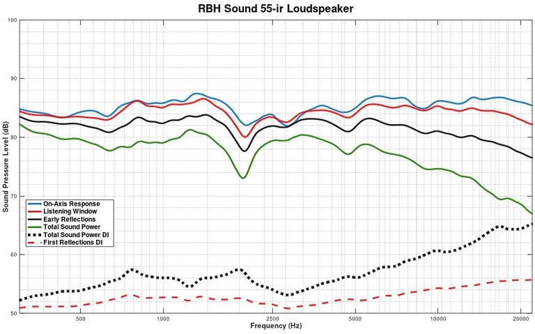

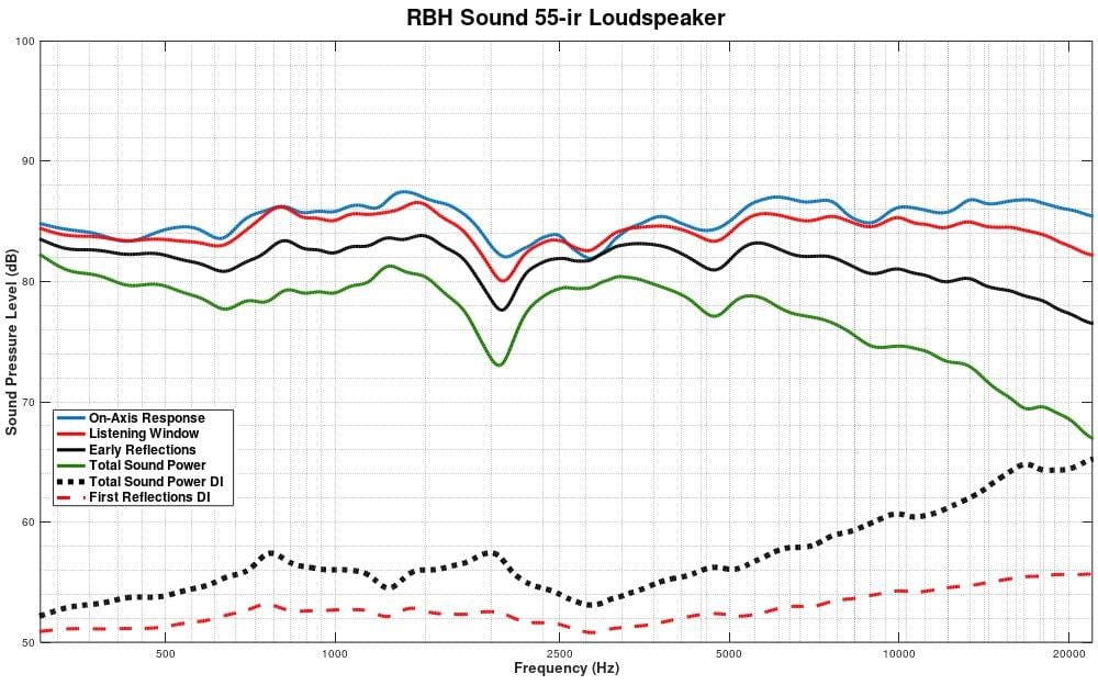

55ir spin o rama
The above graph shows the direct-axis frequency response and other curves that describe the speaker’s amplitude response in a number of ways. For more information about the meaning of these curves, please refer to our article Understanding Loudspeaker Measurements Part 1
The above shown graph isn’t the most neutral response we have seen, nor is it the most colored. There is a sag centered at 2kHz that is accentuated by a small peak right before it. I didn’t notice this peculiarity in my listening, although I would have guessed it would be audible from looking at it on a graph. This caused me to go back to do an A/B comparison with my custom-made 1802G reference speakers that have a ruler-flat response in order to hear how exactly such an irregularity registered in audible experience. The difference was evident but not as blatant as I would have guessed. In general, some vocals seemed a bit recessed on the 55-ir speakers relative to the 1802G speakers. It occurred to me that this kind of dip is similar to what was termed the “BBC dip,” which many older speakers (and even some modern speakers) have. The BBC dip deliberately recesses the range from 1.5kHz to 3kHz to avoid a “shouty” sound signature. While I think that kind of a curve might have been beneficial for older speakers and recordings that had technical limitations causing shoutiness in that range, I don’t think it’s needed anymore. In my comparison against the neutral 1802G reference speakers, I did prefer the reference speaker’s sound, and found the vocals to be a bit more open; however, I didn’t find the 55-ir’s voicing to be offensive in the slightest, and I still quite enjoyed them.

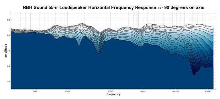

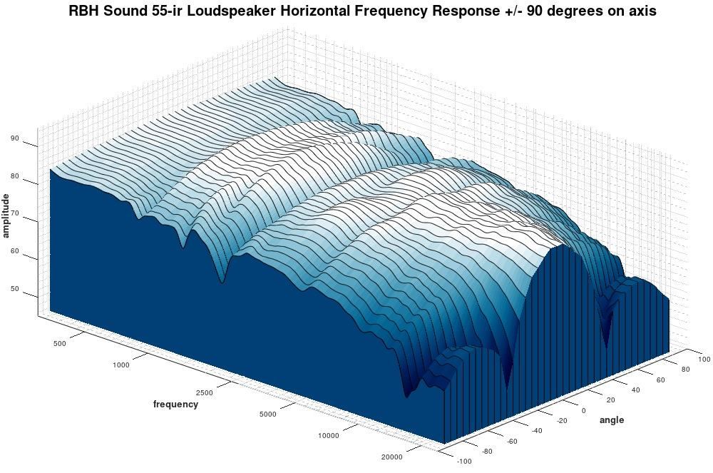

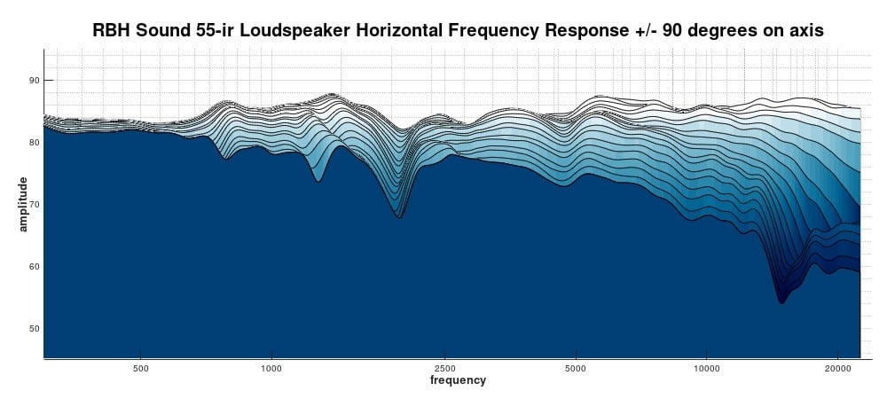

The above graphs depict the 55-ir’s direct-axis and horizontal dispersion out to a 90-degree angle in five-degree increments. Information on how to interpret these graphs can be read in this article: Understanding Loudspeaker Review Measurements Part II.
One of the things that we can glean from the above graphs is that the AMT tweeter is fairly well-controlled but not quite perfect. While there is a slight bump up in energy above 5kHz, the dispersion is nicely smooth and uniform. It doesn’t beam very hard until above 14kHz, and there are few dome tweeters that could do that, at least without the assistance of a waveguide. Regarding the recession around 2kHz, I think the sharp dip is due to a slight phase conflict in the crossover circuit. It’s a fairly high-Q null, so I don’t think it makes a very audible difference on its own. I do think what more greatly characterizes the sound of this speaker is the slight depression in the response from 2kHz to 5kHz. Basically, the upper midrange is slightly scooped out, but this happens more on-axis than off-axis. Relative to a neutral response, this makes the vocals a bit more recessed and a tad less open, although the difference isn’t massive.

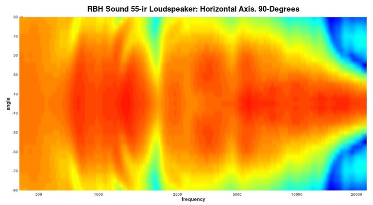

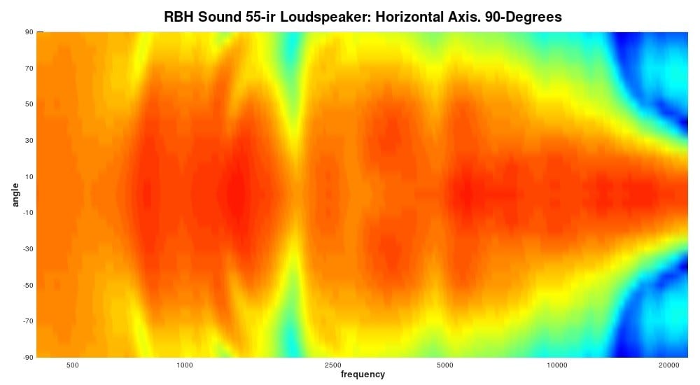

55ir polar map horizontal
The above polar map shows the same information as the preceding graphs but depicts it in a way that can offer new insight regarding these speakers’ behavior. Instead of using individual raised lines to illustrate amplitude, polar maps use color to portray amplitude, and this allows the use of a purely angle/frequency axis perspective. The advantage of these graphs is that they can let us see broader trends of the speaker’s dispersion behavior more easily. More information about interpreting this graph can be read in this article: Understanding Loudspeaker Measurements Part II.
In the polar map of the 55-ir, we get a good look at how the tweeter’s response narrows as frequencies rise, but it does so at a very gradual rate. We also get a better look at how the crossover circuit isn’t quite blending the tweeter with the woofer perfectly, but that is manifested more off-axis than on-axis. The shame of it is that I think this woofer can have a better match with this tweeter, but it’s possible that the MTM layout of the design is making that more difficult, or that a perfect match might require a much more complicated crossover circuit that the designers didn’t think was worth the extra expense. I can’t blame them if the latter reason was the case because the speaker does sound good as is.

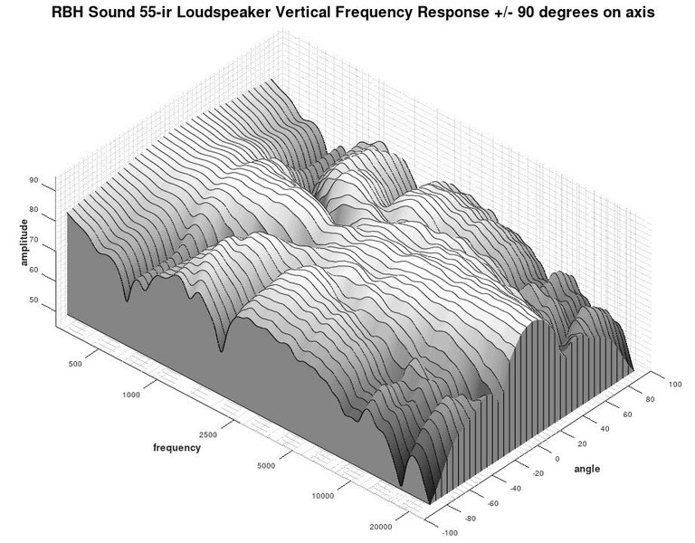

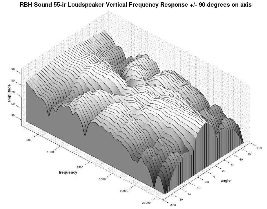

55ir 3D waterfall Vertical response
The above graph shows the 55-ir’s response behavior along its vertical axis, where zero degrees is directly in front of the tweeter, negative degree values are below the tweeter, and positive degree values are above the tweeter. As an MTM design, the 55-ir runs into lots of comb-filtering and phase conflicts at off-axis angles. The good news is that off-axis angles are not as important on the vertical axis as it is on the horizontal axis. That being said, this graph does tell us that it is important to keep the listener’s ear height roughly level with the tweeter. Listeners have about a +/- 10 degree angle off-axis before phase conflicts start taking bites out of the response. This is all very typical of MTM speakers. I would have guessed that the 55-ir speakers would have been even more restrictive with a 3kHz crossover frequency, but it isn’t as restrictive as it might have been.

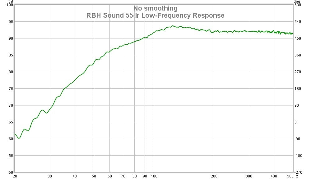

55ir low freq
The above graph shows the 55-ir’s low-frequency response captured using ground plane measurements (where the speaker and microphone are on the ground at a 2-meter distance in a wide-open area). The 55-ir has a flat response that starts to descend at about 100Hz. The ports are a bit over-damped relative to the woofers, so port output is not quite on the level of the woofers. Port-generated output holds strong until 60Hz, at which point it begins to roll off very quickly, as would be expected of a ported system. While these speakers can do some lower bass OK on their own, they are intended to be used with subwoofers, and I would use an 80Hz crossover frequency or higher for best results.

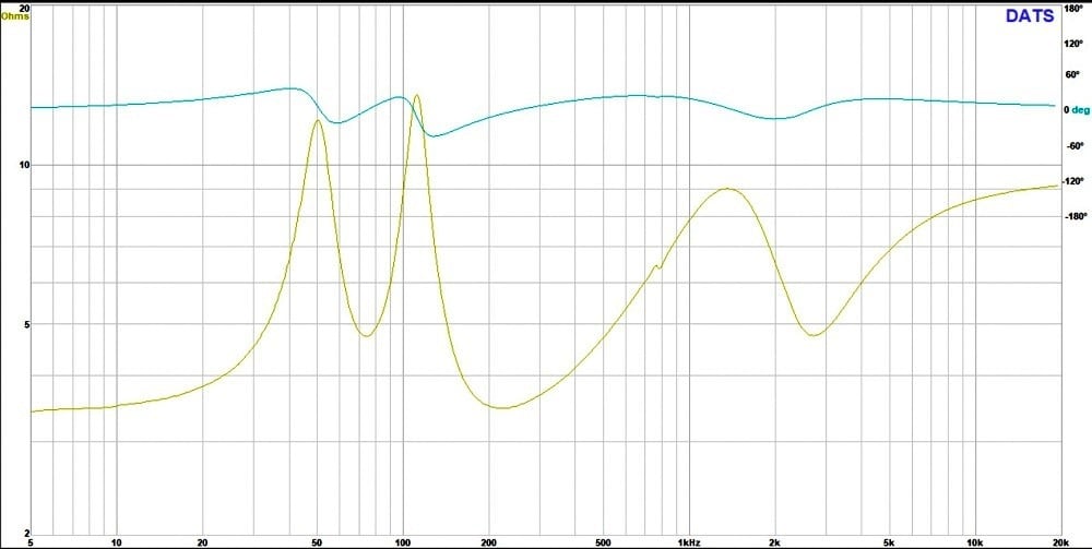

The above graph shows the electrical behavior of the 55-ir speakers. RBH Sound specifies them to be 6-ohm speakers, but I would characterize them as 4-ohm speakers. The minima occurs at just above 200Hz where the impedance bottoms out at 3.5 ohms. It’s not a hugely stressful load on amplifiers, but I wouldn’t plan on blasting these speakers on a budget AVR. The woofers are clearly wired in series which halves their impedance. This elevates the system sensitivity, but it will draw a lot more current from amplifiers, which will create more heat. Cheap amps won’t be able to handle a lot of heat generation. Something else to note here is the dip in the lower frequency saddle, indicating that the port tuning looks to be around 75Hz. The saddle peaks are also fairly even in height, indicating that the resonant frequency of the woofers is a close match with that of the enclosure.
I measured the 55-ir’s sensitivity to be 89.5dB for 2.83v at 1 meter. This is very close to RBH Sound’s sensitivity spec of 90dB. This is higher than average for a standmount speaker; indeed, I had to raise the amplifier gain by 7dB for the 1802G speakers to level-match them to the 55-irs in my comparison. However, this sensitivity is not surprising for the design of the 55-ir. This helps to ameliorate the low impedance, since users will not have to crank the volume for the 55-ir speakers to get loud. With a max recommended power spec of 175 watts, they can handle a fair amount of power and are capable of a very wide dynamic range for a standmount speaker.
