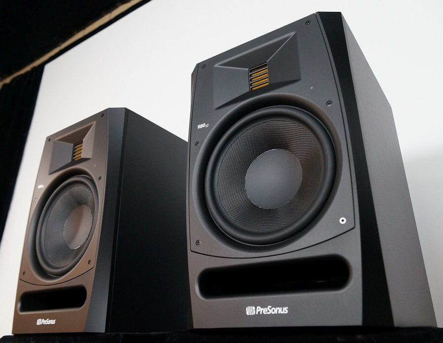

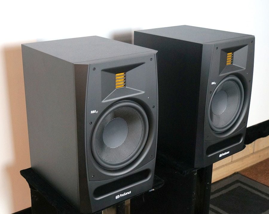

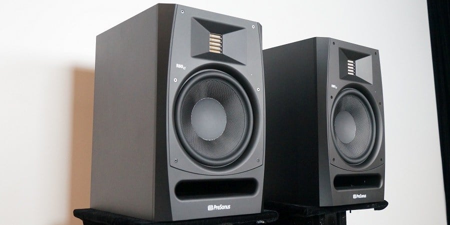

Appearance
 As a
studio monitor, the R80 V2 is not primarily concerned with aesthetics. However,
it does make some efforts to not look totally utilitarian. There is a curved
chamfer running down the front vertical edges. Ostensibly that is to lessen
baffle diffraction, but I am guessing that aesthetic styling was the real
reason, and that is fine since there is no rule that says that monitors have to
look boring. The front baffle is a two-piece plastic molded assembly with the
top piece hiding screws and mounting components for the drivers. There is a
small function light on the front that shows the on/off state of the speaker.

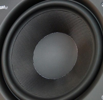

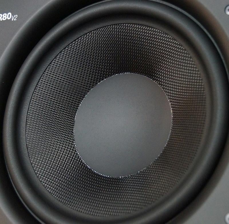

The woofer cone looks like it means business with its tough-looking woven
texture and inverted matte dust cap. The cabinet finish is a textured vinyl
that we see on many lower-cost speakers. It is not a beautiful finish, of
course, but it is not bad, and it is not easy to scratch nor will it show
fingerprints. The R80 V2 isn’t as busy-looking as some other studio monitors,
but I think it would be on the edge for a lot of people whether it’s clean
enough in appearance to have a place in a family room. Were PreSonus to remove
the decal badging on the front of the speaker, that would help to make an even
cleaner and more appealing look.

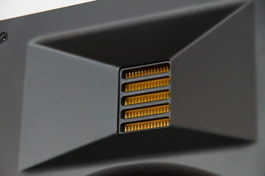

As mentioned before, the R80 V2s use AMT tweeters, and that stands for “Air Motion Transformer.” As opposed to a conventional dome tweeter that pistonically oscillates a little dome, AMT tweeters contract and expand the folds of a pleated membrane to produce sound. To explain using an example, imagine the folded surface of a half-closed curtain- then line the interior folds of the curtain with conductive rods on adjacent sides of the folds, and set two powerful magnets on the sides of the curtain. Run some alternating current through the conducting rods and their newfound electromagnetic field will rapidly collapse and expand the folds of the curtain, and, in doing so, squeeze air in and out of the folds, thereby creating pressure waves that we experience as sound.
A major advantage of AMT tweeters is that since the folds of the diaphragm are much deeper than they are wide, the air is ejected out at a much faster speed than the vibration of the diaphragm itself- as much as five times faster. That can move air very quickly, and that can equal high SPLs in upper frequencies. In fact, the R80 is spec’d at 107dB for peak SPL at 1m, whereas the Eris E8 XT with its 1” dome tweeter is spec’d at 105dB. Since the amp power and woofer are largely the same between the speakers, the increased headroom is likely due to the AMT tweeter.
Another advantage is the very low mass of the diaphragm, which makes it very easy to move and change direction since it does not have the momentum of the weight of a typical dome tweeter. Indeed, the diaphragm material for PreSonus’s AMT is Kapton with a 0.01mm thickness. These elements give AMT tweeters an extended response well into ultrasonic frequency ranges. Also, since AMT tweeters can have a relatively large surface coupled with the air, they can have a very wide dynamic range.
PreSonus mounts the AMT in a waveguide that is geared for a wide horizontal dispersion but a narrow vertical dispersion. This strategy is common to many monitors in this class, and their reasoning for it is that reflections from vertical surfaces cause problematic acoustic issues that degrade the sound. I do have two problems with this design strategy. First, there is not much actual research to show that vertical reflections in normal situations do hurt the sound quality in significantly audible ways. Second, many monitors, the R80 V2 included, only take measures to constrain the tweeter’s dispersion but not the woofer’s dispersion. The problem with that is now the vertical acoustic reflections are spectrally uneven; you will get acoustic reflections from the woofer but not the tweeter. If vertical reflections do degrade the sound, having an uneven balance of those reflections may be the worst-case scenario. Luckily for us, there isn’t much to suggest that it does hurt the sound in typical situations.

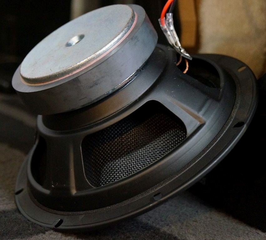

The 8” woofer uses a woven composite cone that has a beefy-looking surround. It uses a ¾” thick, 4” diameter magnet on the motor that is vented through the pole piece. The woofer is driven by a 75-watt amplifier, and the tweeter is driven by a 65-watt amplifier for a combined total of 140 watts of amplification using a class A/B amplifier. Most of the competing monitors have moved on to class-D amplifiers, but PreSonus has stayed with class-A/B for its lower noise floor that those amps tend to have in this class. Unfortunately, the R80 V2 still emits a hiss, although it’s no worse than what is normal in this segment. If the class-A/B amplifier reduced the noise floor, it only went from worse-than-average to merely average. The PreSonus Eris E8 XTs fared better in this regard with a lower noise floor.

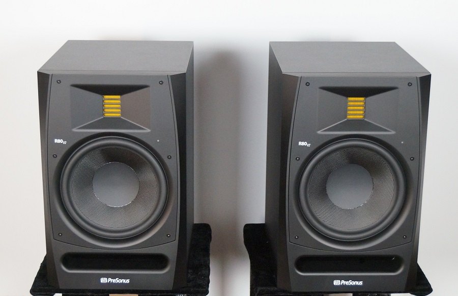

One smart design decision here was to move the AMT tweeter as close to the woofer as possible. This should enable the individual sound coming from the tweeter and woofer to integrate at a closer distance, and that is a good idea for a monitor that may be placed at a relatively close distance from the listener. It should also help to reduce crossover nulls in the off-axis response at angles close to the on-axis angle. That could help to make it less picky to get a full, smooth sound without needing to have the listener’s ears precisely level with the tweeter height.
The three inputs on the R80 V2 are typical for this segment: a balanced XLR, a balanced ¼” TRS, and an unbalanced RCA. There are a host of controls that can alter the frequency response to compensate for different acoustic conditions. A boundary gain level switch can cut the low frequencies by 2 or 4 dB which can come in handy where the R80 V2 has to be placed near surface boundaries that can disproportionately boost bass. There is a high-pass filter that can come in useful if the R80 V2 is paired with a subwoofer in a system with no bass management. It can set the filter frequency at 100Hz, 80Hz, or let the speaker run full range. That high-pass is a really good idea since most ‘prosumer’ audio systems don’t have an easy way to blend a sub in with the speakers; this allows the speaker to cross over to the sub in a much more controlled manner, especially since most subs have adjustable low-pass filters. The R80 V2 also has a knob that can boost or cut the midrange frequencies or treble by up to 6 dB; the purpose of this is to emulate cheap speakers that have problems in that range. I think the midrange boost/cut knob is unnecessary since it can only emulate one problem area that a bad speaker can have. In any case, there is very little reason to leave it at any setting except for zero. Along with these response shaping controls, there is a gain knob, of course.
There is a front-mounted slot port beneath the woofer with some mild flaring at both ends. The enclosure uses a plastic molded front baffle mounted on a ½” thick MDF enclosure. There is a line of bracing around the midsection of the enclosure, and the side paneling is lined with polyfill. While the construction of the cabinet is OK, there is room for improvement here in reinforcement and damping, although I don’t know if that would have any noticeable improvement in sound quality. Bolder users could probably do some simple modifications to improve the enclosure, although that would void the warranty, of course.
The PreSonus R80 V2 monitors seem like competently designed speakers with some intelligent design decisions. Let’s now see how that pans out in giving them a listen…

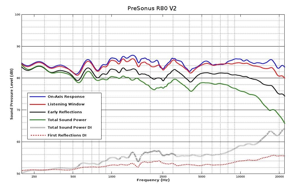

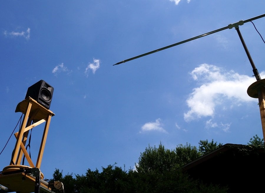

The PreSonus R80 V2 was measured in free-air at a height of 7.5 feet at a 1-meter distance from the microphone, and the measurements were gated at an 11-millisecond delay. In this time window, some resolution is lost below 250 Hz and accuracy is completely lost below 110 Hz. Measurements have been smoothed at a 1/24 octave resolution.

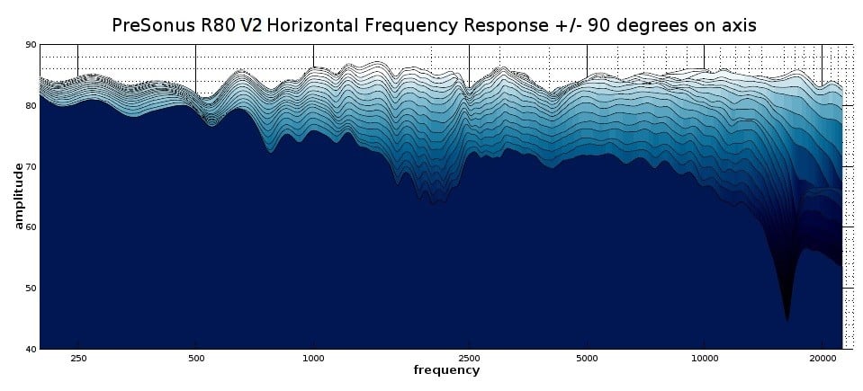

The above graph shows the direct-axis frequency response and other curves that describe the R80 V2’s amplitude response in a number of ways. For more information about the meaning of these curves, please refer to our article Understanding Loudspeaker Measurements Part 1. The measured response above is a bit ragged. However, it generally holds to a baseline response, and the listening window does fall within an industry standard of +/-3dB over its operating range. A lot of little peaks and dips don’t result in audible effects, so small undulations in the response can be ignored. The most significant feature in this graph that results in coloration of the sound is the recession centered at 500 Hz followed by the elevation in the response centered around 2kHz. That does give the speaker a bit more of a forward character. To be sure, this is not a huge deviation that makes the speaker sound badly unnatural, but compared to a speaker with a more neutral response, like the PreSonus Eris E8 XT, it has a more brash quality. It accentuates a region where much of the harmonics of human voices and musical instruments dwell, so it does have a more detailed sound, but it does so at the expense of accuracy. The smoothness of the directivity indexes indicates that this speaker could be equalized with predictability. Overall, we have a response that is good enough to enjoy music and movies, although I was hoping for something a bit less frayed from a studio monitor.

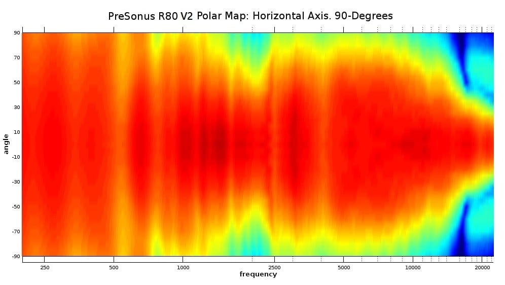

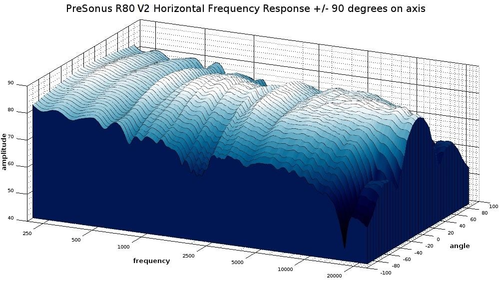

The above graphs depict the speaker’s lateral responses out to 90 degrees in five-degree increments. More information about how to interpret these graphs can be read in this article: Understanding Loudspeaker Review Measurements Part II. One interesting feature that can be seen is that while the on-axis response is a bit craggy, its shape generally holds at off-axis angles, hence the smooth directivity indexes in our ‘Spin-O-Rama graph of the R80 V2. That means that the in-room acoustic reflections of this speaker will not deviate from the direct response, so any changes made to the speaker’s tonality be the same everywhere. That is particularly helpful to equalization systems like Audyssey and YPAO. The exception occurs at around 2kHz where the off-axis response dips a bit compared to the on-axis response. This is occurring because the woofer is starting to tighten its dispersion in this range, but the tweeter hasn’t yet kicked in full yet. The response widens at the handover to the tweeter. I had a feeling that the specified 2.6kHz crossover frequency was going to end up with an imperfect directivity match between the tweeter and an 8” woofer, and while we do see that here, it is not severe.
The above polar map graphs show the same information that the preceding graphs do but depict it in a way that can offer new insight regarding these speakers’ behavior. Instead of using individual raised lines to illustrate amplitude, these polar maps use color to portray amplitude, and this allows the use of a purely angle/frequency axis perspective. The advantage of these graphs is they can let us see broader trends of the speaker’s behavior more easily. For more information about the meaning of these graphs, we again refer the reader to Understanding Loudspeaker Review Measurements Part II.
Aside from the waist-banding at around 2kHz, the R80 V2 holds a good dispersion pattern. We can see that the 2kHz directivity mismatch doesn’t really set in until around the 40-degree angle, so if it manifests itself at all, it will be as an acoustic reflection since few listeners will be seated outside that angle. We do see the tweeter start to tighten its dispersion at around 10kHz, but it is still broader in that region than the vast majority of dome tweeters would be. The response above 10kHz isn’t terribly consequential since there isn’t much content that high, and many listeners’ hearing degrades above that point as well. Overall, while the performance portrait shown here isn’t perfect, it is not bad, and I didn’t detect any midrange deficits from the 2kHz waist banding at all in my listening.

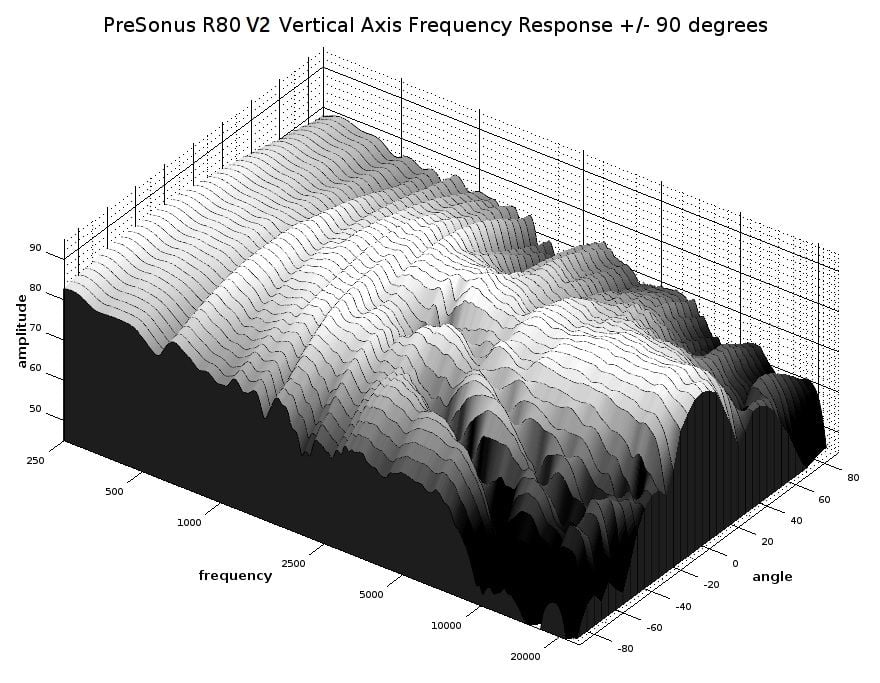

The above graph shows the R80 V2’s response behavior along its vertical axis where zero degrees is directly in front of the tweeter, negative degree values are below the tweeter, and positive degree values are above the tweeter. One important feature that we can see here is that the crossover null emerges very quickly at angles below the tweeter. Any speaker where drivers are separated by a distance greater than half a wavelength at the crossover frequency (meaning almost any speaker that isn’t using coaxial drivers or a single full-range driver) will suffer a null at some angles where the difference in distance causes a phase mismatch between the drivers in a shared frequency range at the crossover. Typically, it starts to set in outside of a 15-degree angle above and below the on-axis angle, but in the R80 V2s, it is becoming acute at 10 degrees below the tweeter. That means that this speaker should be listened to at or somewhat above the tweeter height, but not below the tweeter. The vertical response does stay strong out to 25 degrees above the tweeter, so that does give the user a good margin in which to aim the R80 V2 for the best sound. This is a trait we also saw in our review of PreSonus’s Eris E8 XT speaker.

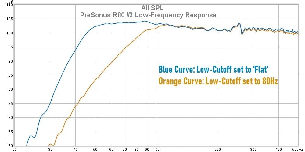

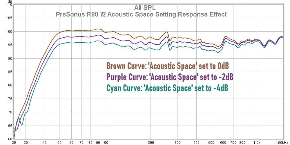

The above graph show the R80 V2’s low-frequency responses that I captured using groundplane measurements (where the speaker and microphone are on the ground in a wide-open area). With the high-pass filter set to ‘flat,’ we do see a slight rise in bass below 90Hz. That could give the sound a bit more weight than a totally flat response, although it might lead to a bit too much bass in a small room. Should that be the case, users can set the R80 V2’s ‘Acoustic Space’ switch to -4dB which should alleviate some excess bass. One nice feature is the ability to high-pass the response at 80Hz and 100Hz, and that allows for subwoofer integration without the need for an external processor. In its ‘flat’ setting, the R80 V2 holds a steady response down into the upper 40Hz range which is good for a non-tower speaker. The roll-off below 45Hz is very steep which indicates that it is being electronically high-pass filtered. That means the R80 V2 won’t see much room gain below 40Hz, but 40Hz is enough bass extension to reproduce almost all acoustic music (with the exception of some pipe organs), and most other kinds of music. That does explain why the R80 V2s weren’t quite catching the lowest notes of some electronic bass music, but even most electronic bass music doesn’t dig below 40Hz.

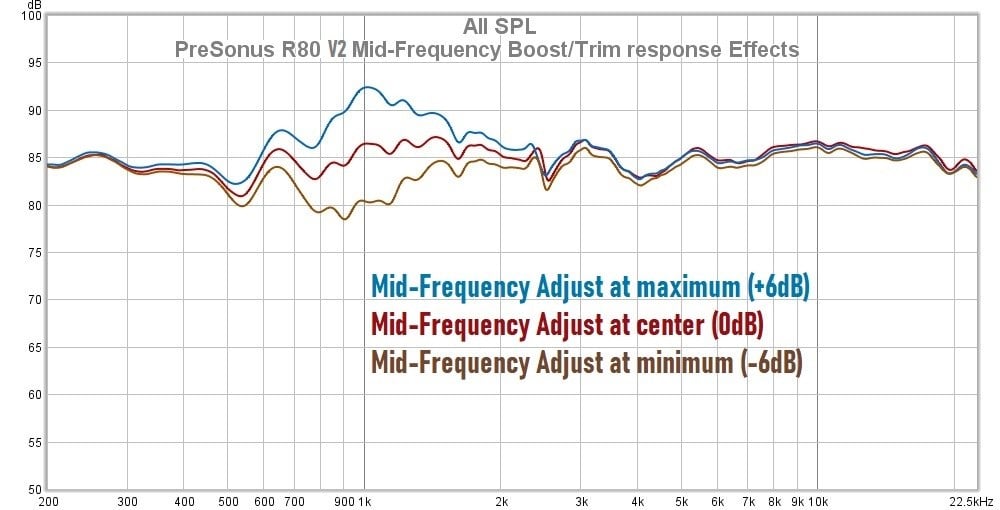

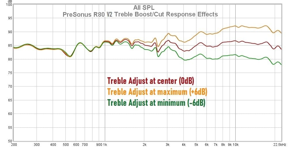

The above graphs exhibit a few of the changes that can be made to the response using some of the controls on the amp plate. For the most anechoically neutral response, I would set the ‘Acoustic Space’ switch to -2dB, the ‘Mid Frequency’ adjust knob to 0dB, and the ‘High Frequency’ trim knob to 0dB. Of course, for a warmer sound, the user can knock down the ‘High Frequency’ adjust knob, or they can boost it for a hotter and more aggressive sound. The ‘Mid Frequency’ adjust knob appears on other PreSonus speakers and has always been a bit weird to me. PreSonus’s rationale for it is to emulate cheap speakers, but cheap speakers can go awry in many more ways than too much or too little frequency bandwidth around 1kHz, so I don’t think that one is very useful. The ‘High Frequency’ trim knob and ‘Acoustic Space’ switch, on the other hand, would be useful for those who want to tune these speakers for their taste. However, those buying these speakers for the most accurate playback should leave all the knobs at 0dB. The bass response is so heavily affected by the room, so that is more up to the user to determine what sounds natural, but I think most circumstances would call for an ‘Acoustic Space’ setting of -2dB or -4dB if the ‘Low Cutoff’ switch is set to ‘Flat’ since the ‘Flat’ setting gives elevation to lower bass.

In my view, the tonality of the R80 V2 with respect to monitoring is its only significant flaw. There are other measured imperfections with the performance, but they are largely academic with regard to audible consequences so are not something that would have any real-world effects. This brings us to its strengths, of which there are many. To start with, while they might not be the most accurate monitor out there, I did enjoy their sound and never disliked what they brought to movies and music. They bring forward a crisp sound character, but it was never obnoxiously hot or fatiguing. The sound was detailed without being shouty or overly sibilant. I think that most users would be pretty happy with the way they sound. They had good bass extension to below 50Hz, so the addition of a subwoofer is not an absolute must depending on the application.
Speaking of subwoofers, one feature I really like is the high-pass filter switch which cuts off bass below 80Hz or 100Hz so that the inclusion of a subwoofer into a simple setup can be very easy. With the popularity of subs even in simple bedroom studios, all monitors in this class should have this feature, but only some do, and they aren’t often implemented as well as the R80 V2s. Likewise, the tonal adjustments available on the R80 V2s make it easy to tailor the sound to the user’s taste. While user taste shouldn’t be a factor in actual monitoring applications, it does help the speakers to have more flexibility in recreational listening. On the subject of recreational listening, the tonal character of the R80 V2s have an advantage for those who struggle to understand dialogue; the response elevates the upper harmonics of human vocal ranges which can enhance speech sound. In other words, these speakers make it easier to understand what people are saying.
The R80 V2s have a good dynamic range which is not surprising with an 8” woofer with an AMT tweeter and 140 watts of amplification, so anyone looking for speakers that can take on typical living room listening distances of a few meters without compressing or distorting heavily, these can do that. They would make a great alternative to a soundbar for a larger domestic space, especially for someone who struggles with speech intelligibility with typical soundbars. In addition to their dynamic range, the R80 V2’s imaging ability was very good, and they had no trouble keeping resolving complex soundstages in recordings.
To sum all of this up, as a speaker for recreational listening, I think the R80 V2s are a good choice. However, as a monitor, they are somewhat flawed, although not fatally so. For monitoring purposes, I think that their similar but less expensive PreSonus sibling, the Eris E8 XT, is a better choice since it is a more tonally balanced loudspeaker, although they are a tad larger. This isn’t a knock on the R80 V2s as much as praise for the Eris E8 XTs; in fact, I liked the Eris E8 XTs so much that they are the only product that I have purchased after reviewing to this date. Some people may prefer the increased high-frequency articulation of the R80 V2s for content creation, but they should understand the drawback that carries its spectral balance. I do think the R80 V2s could be used to create good mixes, although they aren’t what I would use to make a high-fidelity mix such as highly realistic recordings of acoustic instruments unless the user understood how it would be affecting the sound in a more neutral scenario. While they are marketed as a studio monitor, I do think they should also be considered for movies, music, and gaming purposes, and those who decide to get a pair will likely be delighted with the results.
