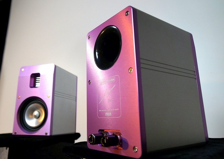

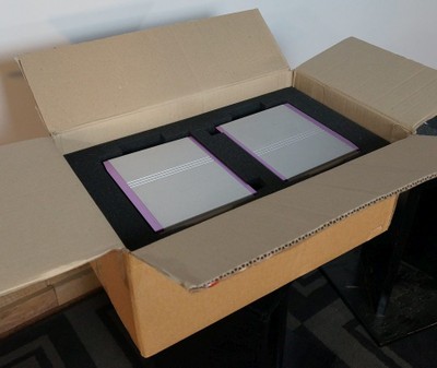

The SuperMon Mini speakers arrived in a heavy-duty cardboard box. The speakers were fitted in some pockets of a soft polyurethane foam bedding. Most speakers ship in stiffer polyethylene foam packing, but that is to hold the speakers in place since normal hollow wood enclosures can not endure being thrown around as much as these metal cabinets. The goal of Mon Acoustic’s packing is more geared toward protecting the speakers from scuffs and scratches rather than protecting the cabinet from jolts and shock since these aluminum enclosures are far more solid than normal speakers and that isn’t as much of a concern.
Mini box  Mini pair6

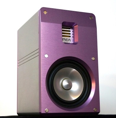

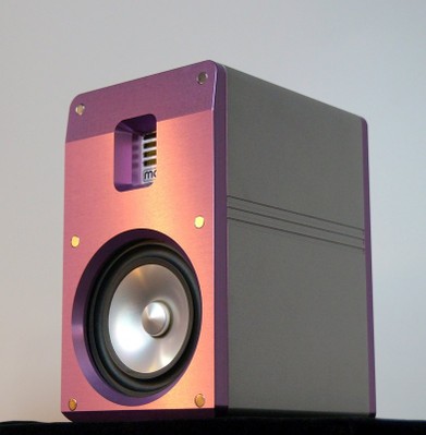

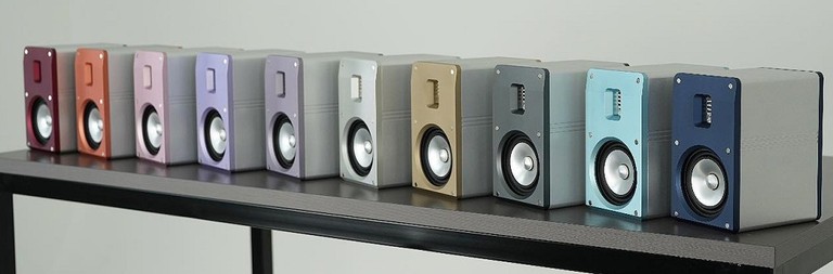

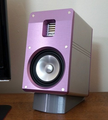

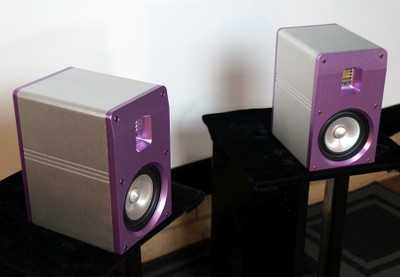

Mini single5Once unpacked, we are presented with some very upscale speakers that have a glistening aluminum body. The speakers that I was sent have a lilac-colored front baffle that gives them some flair, whereas an uncolored metal baffle might be a bit too business-like for some people’s tastes. Side panels have an undyed metallic luster, and there are some machined stripes on the sides. Custom colors can be ordered for an additional cost. There are many different colors available, and customers should get in contact with Mon Acoustics to order their desired color. These speakers have a stylized industrial look that would fit in nicely with modernist interior decor. They do not come with grilles, but there would be little point in buying a speaker with such a high-class metal exterior only to hide it behind some boring fabric. The front baffle has a shallow beveling at the top for a slightly sleeker look. I would imagine this shaping is aesthetically important since the wholly flat front baffle might be a bit blunt looking. Longitudinal edges have a rounding to help soften the appearance. An AMT tweeter is sunk into a deep waveguide that has a steep inward beveling, and the silvery woofer is sunk into the front baffle with a 90-degree beveling. The quality of the milling is excellent throughout. A Mon badge is printed in the lower part of the AMT plate. Screw heads are tastefully hidden by some magnets that make it look like the speaker was bolted together with flat head rivets that are flush with the front baffle. That is a beautiful attention to detail which is befitting the cost of these speakers. Model labeling and serial number are laser-etched on the rear. The SuperMon Minis look like they would serve well as a business executive’s desktop system. The aesthetics can not be faulted; these speakers look terrific.
Mini colors

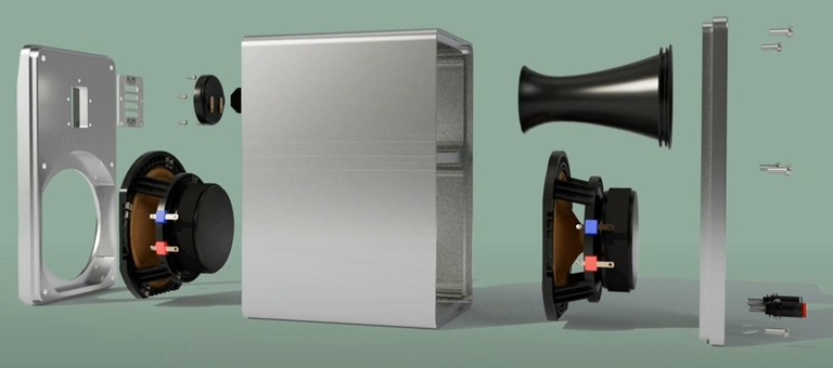

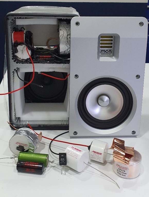

The SuperMon Mini is an unusual loudspeaker not just in enclosure composition but in the overall design. The base description is that it is a 2.5-way small bookshelf speaker with a number of unusual design choices. The obvious departure from the speaker design norm is the use of aluminum as cabinet construction material, so we will start our design analysis there before getting into the other unseen divergences from typical design practices. Aluminum is a great material to use as a loudspeaker enclosure when weight is not a consideration. It is very dense and so will make for an inert and resonance-free enclosure, and it is highly corrosion and heat resistant, especially the grade 6061 alloy used by Mon Acoustics. Furthermore, aluminum is also a great material for heat transfer, so the aluminum enclosure can also serve as a heatsink to disperse thermal buildup from the driver motors, and that should help dynamic range a bit by reducing thermal compression. The front baffle is 0.7” thick, the rear plate is 0.6” thick, and the side panels are 0.3” thick. There is also windowpane bracing around the midsection which is a part of the aluminum extruded main structure instead of being an additional welded piece. There is a spot-welded frame to hold the inner woofer which would add to the rigidity of the cabinet.
Mini exploded
The internal construction wouldn’t be bad if these speakers of this size were made from some composite wood, but using aluminum with that thickness makes them positively boulder-like. On top of that, there is a fair amount of open-cell foam used as acoustic that lines the enclosure walls as well as the port. Anyone worried about panel resonances at all can breathe easily with the SuperMon Mini since this enclosure will be totally inert and vibration free.

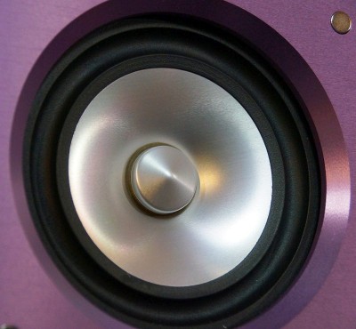

Mini wooferSome readers will see that 2.5-way design description and wonder where the other woofer is, since 2.5-way designs use multiple woofers, but only one woofer is visible on the Mini. This is where the term ‘isobaric’ comes in. Isobaric derives from Greek and means the quality of having equal pressure. For an isobaric loudspeaker design, the equal pressure refers to an air mass suspended in a chamber that is sandwiched by two active drivers which are moving in phase. So the Mini’s other driver is hidden and is mounted behind the exposed woofer at a halfway-deep point in the enclosure, and the two drivers enclose a sealed pocket of air between them. The reason to use this design is to get deeper bass from a small cabinet. The effect of having a pocket of air with unchanging pressure between two drivers is that the system retains a lower resonant frequency in a smaller cabinet by doubling the moving mass yet halving the compliance. It is like using one driver with a heavier moving assembly but a larger and softer suspension; it will have a low resonant frequency although at the cost of efficiency. The efficiency cost is minimized with an isobaric system since it halves the impedance and sensitivity.
Mon Acoustic’s take on an isobaric system is a bit different since the rear woofer has a low-pass filter and is only generating bass frequencies. That technically means that the air pocket between the woofers is not strictly static, because the excursion from the outer woofer is not matched by the inner woofer. But the volume of air needed to be moved to produce bass is much greater than higher frequencies, so the air pocket is largely being pushed around in a uniform manner due to the low frequencies for the most part, and the principle still holds.
 Mini Pair10
Using an isobaric system makes a lot of sense when metal is used as a cabinet material. Mass and weight add up very fast as the enclosure grows larger. Indeed, even though the Mini’s are quite small, they still weigh 11.5 lbs. each which is what I might expect of a well-built bookshelf speaker of twice their size. What is more, the outer woofer on the Mini is being tasked with playing up to treble frequencies, so a heavy driver wouldn’t have been an option since it could not serve as a wideband driver. The weight needed for a single driver to hit a lower resonant frequency in a small enclosure would have prohibited the ability to produce the midrange or treble frequencies that the engineer wanted.
The internal driver of the SuperMon Mini loads a port, and the port uses an elliptically shaped tube instead of a straight cylinder. Research by JBL and Bose has shown that similar-shaped ports will produce less turbulence than simple cylinders with some flaring on the ends. The port used by Mon Acoustics is a step up from the usual cylinder. The port is roughly 3” deep with a 1 ¾” diameter, and with dimensions like that, it is bound to have a somewhat high tuning frequency.
Mini single3The crossover between the woofer and the tweeter is quite high at 6.8kHz. That means the tweeter is relegated to producing high treble only, and the vast majority of sound from the Mini will be coming from the woofer. With such a wide frequency band, a special wide-range driver is needed, because even though the woofer diameter is small at 4”, most 4” drivers would run into break-up modes by 6.8kHz. Break-up modes are the behavior that the cone starts to exhibit when it is moving so fast that it can no longer hold its shape. Larger cones will bend and flex at very high-frequency movement, and the frequency at which these break-up modes set in decreases as the size of the cone increases. The woofers used are 4” wide-range MarkAudio drivers. MarkAudio specializes in wide-range drivers that can maintain good performance out to high frequencies, so Mon Acoustics picked a good driver brand for this task.
One reason for giving the woofer such a wide-frequency range is that there will be no problems associated with a crossover circuit anywhere near the most important frequency bands. Most harmonic spectra from common musical instruments as well as human speech and singing are very low in amplitude by 7kHz. That means that the vast majority of the sound from these sources will be reproduced by the Mini’s woofer and not the tweeter. The advantage of this design decision is that there will be no phase rotation right in the middle of this important frequency range. Most 2-way or 2.5-way speakers have their crossover frequency somewhere between 2kHz to 3kHz, which is right in the middle of the spectrum of many human voices as well as acoustic instruments. The problem with that is, even if the crossover circuit is perfectly executed so that the frequency response exhibits no sign of the crossover point, there will still be phase rotation around the high and low pass filters used to create the crossover. While it was previously thought that phase distortion was not a major audible problem unless it was extreme, there has been some research in the last few years that suggests these types of phase artifacts can degrade speech intelligibility. In other words, the SuperMon Mini should have excellent speech intelligibility due to the absence of a crossover circuit in a common speech frequency spectrum.
 Mini internal
The crossover itself uses some very heavy-duty components such as Mundorf large film capacitors, air-core inductors, and massive resistors. The robustness of these components is very likely overkill, but it’s better to have it and not need it than to need it and not have it. These are all very low-tolerance components, and given their size and build, the capacitors should hold a stable capacitance value for a very long time to come instead of drifting in value like a ceramic capacitor. These large film capacitors are much less affected by heavy use, so they won’t get hot and change their value from thermal effects.
While the Mini is a small speaker, it is using some pretty beefy five-way binding posts. When I asked Mon Acoustics how much power the Mini’s could handle, they advised 30 watts from tube amps, 100-200 watts from class AB, and 150+ watts from class D. Over 100 watts seems like a lot for such a small speaker, but the isobaric woofer system plus an AMT tweeter should be able to take a lot more power than a typical small speaker.

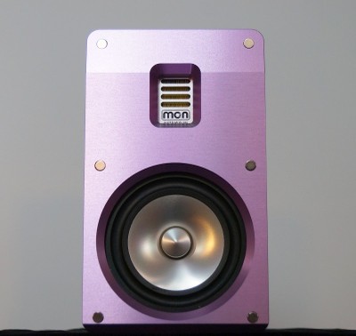

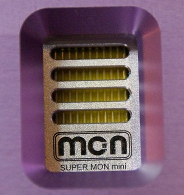

Mini tweeterThe Mini’s tweeter is a small AMT tweeter. It is crossed over at such a high frequency that it almost functions more as a supertweeter than a normal tweeter. The tweeter is sunk into a steep waveguide that has been milled into the front baffle. This waveguide looks like it is serving a contrary function to the 4” woofer. The woofer is bound to have wide dispersion out to a high frequency, whereas the waveguide on the tweeter looks like it would significantly restrict dispersion. That could set the drivers up for a directivity mismatch, but we will get a look at its nature in the measurements section of this review. Another potential problem with the waveguide is it could create a hefty amount of diffraction. In narrow waveguides like this, diffraction is caused when sound from the transducer diaphragm experiences a lot of reflection off the inner sides of the waveguide. These reflections can interfere with the direct sound of the tweeter diaphragm and cause comb-filtering patterns in the response or other types of phase distortions. This could be exacerbated by the use of a small AMT tweeter that would naturally have a very wide dispersion, so it is throwing a lot of acoustic energy off to the sides. On the surface, a waveguide of this shape would seem to be suboptimal for this loudspeaker design, but it’s possible that it was necessitated by manufacturing practices where a wide, shallow waveguide would have been much more difficult to execute in milling aluminum. And with such a high crossover frequency to the tweeter, I wouldn’t expect the suboptimal waveguide shape to turn into a major audible problem since it isn’t touching midrange frequencies at all.
Zooming out, we have a small speaker with an excessive build quality that is trying to get some bass out of a small enclosure through an isobaric driver arrangement while relying on a wide-band driver to carry most of the sound to avoid any crossover circuit issues. Mon Acoustics have pulled some clever engineering moves to pull this all together, but let’s see what it all sounds like in practice…

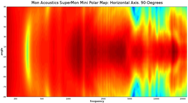

Mini Polar Map
The above polar map graphs use color to portray amplitude, and this allows the use of a purely angle/frequency axis perspective. The advantage of these graphs is they can let us see broader trends in the speaker’s behavior more easily. For more information about the meaning of these graphs, we again refer the reader to Understanding Loudspeaker Review Measurements Part II.
In the above graph of the horizontal dispersion, the most stand-out aspect is how much the tweeter’s frequency band is restricted compared to the woofer. This is about what I expected when looking at the speaker’s design: wide dispersion from the woofer and narrow dispersion from the tweeter. The narrow waveguide on the tweeter is really constricting the tweeter’s dispersion, so users will want to be within a 30-degree horizontal angle of the tweeter. Listening within that angle isn’t likely to be a problem in a desktop situation.
Positional Tip: An easy way to know if you are too far off-axis is if you cannot see all of the lettering in the word ‘MON’ printed on the tweeter plate, you are not going to be hit with much of the tweeter’s output.

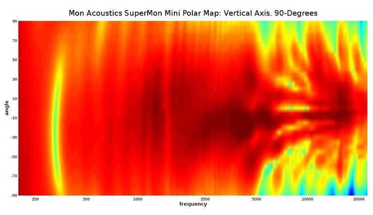

Mini Vertical Polar Map
The above graph is a polar map of the Mini’s vertical dispersion. The tweeter is the axial reference point, and positive degrees are angles above the tweeter with negative degrees being angles below the tweeter. The tweeter’s band above 5kHz produces an unusual result. The narrow waveguide is causing some complex diffraction and reflection patterns. The angles at which there aren’t any nulls occurring are ten degrees above and below the tweeter, so that is where users should ideally aim the speaker to hit the ears on the vertical axis. However, even if those exact angles cannot be managed, this type of interference pattern, called comb-filtering, isn’t tremendously audible. In my own listening, changes in height did produce a change in the sound, but unless the height differences were dramatic, such as standing up versus sitting down, the effect on the sound was not huge. One of the reasons that this disordered dispersion pattern is not easily audible is that these effects are restricted to treble frequencies where human hearing isn’t the most sensitive. The entire midrange band is very consistent on both the vertical and horizontal axis. Moreover, the type of acoustic reflections this pattern can produce can average out at the point of the listener’s ears, so the dips created by this response can be shored up by reflections from near vertical surfaces, i.e., the desktop. Nonetheless, there is room to optimize the sound by adjusting the vertical angle. If the treble seems a bit soft, simply angle the speaker up or down by a few degrees.

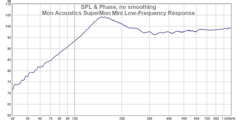

Mini Low Frequency Response
The above graph shows the SuperMon Mini’s low-frequency response that I captured using groundplane measurements (where the speaker and microphone are on the ground in a wide-open area). The most prominent feature is a bump at the port-tuning frequency of about 150Hz. This is probably what I heard as some thickness of the strings during my listening to the Kronos Quartet album. A lot of small speakers go for this type of voicing in order to make it sound bigger than it actually is, but it does color the sound, and I would prefer a more neutral response in that range. Curiously, the slope below that point rolls off at 12dB/octave slope, which is not normal for a ported enclosure. Usually ported loudspeakers roll off at a much steeper 24dB/octave slope below port tuning. I could only guess this is some kind of byproduct of the isobaric design since both woofers surround a sealed compartment. This is, however, not an unwelcome attribute, since it will do more to promote room gain which will shore up the low end thereby giving the user deeper bass extension than a typical ported roll-off.  Nonetheless, I wouldn’t expect much deep bass from this speaker, and the addition of a subwoofer did significantly improve the sound in my own listening. I would encourage a higher crossover frequency over the standard 80Hz as well for those who do choose to use a subwoofer with these speakers. Few speakers of this size will deliver much deep bass at all. The ones that do have a very limited dynamic range and can reach their limits very quickly. That is the trade-off that has to be made in a small loudspeaker; you can have dynamic range or low extension but not both.

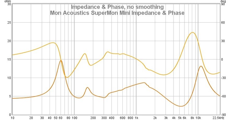

Mini Impedance
The above graph shows the electrical behavior of the SuperMon Mini. Mon Acoustics specs this as a 4-ohm speaker, and that is correct. The impedance and phase take on an unusual shape relative to other speakers, and I would attribute that to the isobaric design. The impedance minima dips down to just under 3 ohms and occurs around the crossover frequency between 5kHz and 6kHz. It is accompanied by a steep phase angle, and that can be a tough load for amplifiers. It is only alleviated by the fact that this low impedance and steep phase range starts at 4kHz which is just above the all-important midrange that is so heavily used by so many recordings. The other good news is that in a desktop environment, it’s not likely to get cranked super loud, so most amplifiers that are paired with this speaker aren’t going to be driven to the bleeding edge. All the same, I would not try to drive these speakers with a cheap, low-powered chip amp, not that anyone spending $2k on a speaker set is going to power them with a $75 amplifier.
I measured the sensitivity of the Minis to be 86.1dB for 1 meter at 2.83v. While that is a tad under Mon Acoustic’s listed sensitivity spec, this is actually a bit more sensitive than I would have guessed given the design. For a small speaker, 86.1dB is quite good. These speakers won’t need a powerful amp to get loud, especially for their intended application.

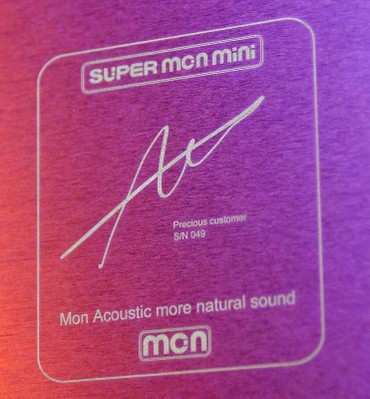

 Mini single.2JPG  Mini Label
