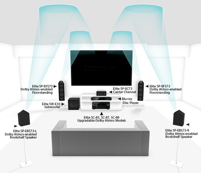

Dolby Atmos Diagram - Courtesy of Pioneer
As you can see in the diagram above of the Pioneer Atmos Elevation speakers, the sound is supposed to fire up at the ceiling and bounce back down towards the listening area. The Pioneer approach integrates the Atmos driver into the cabinet and is sold as one unit. The driver is actually flush mounted into a 20 degree angled baffle instead of recessed, which ameliorates our aforementioned concerns about diffraction.

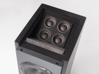

Triad Bronze LR-H Dolby Atmos Elevation Speaker (MSRP: $1000/ea)
The four 2" Atmos drivers of the new Triad LR-H Atmos Elevation speaker are designed to combine acoustically for tight dispersion and good power handling. They're made by Scan-Speak, whom make some of the best drivers in the world. The tight pattern on the ceiling is said to yield a better effect, without the untidy effects of a wide-dispersion array.

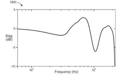

Dolby Atmos Equalization for Atmos Elevation Speakers (source AVS Forum)
The Dolby patent calls for a filter response with a rise at 7 kHz of 5 dB followed by a drop of 7 dB at 12 kHz. While the patent claims this can be done in the speaker via a crossover network or in the digital domain via DSP processing or a combination of both, the reality is it’s typically done digitally via DSP processing in the AV receiver. It’s quite difficult and expensive to achieve such a tight response like this in the analog domain. Moreover, it's NEVER a good idea to apply boost via a passive filter network. This should be done in the digital domain. Period.
Update 9/12/14: Recent feedback from our talks with Dolby at CEDIA suggests there is some element of the HRTF employed in Atmos Elevation speakers in the analog crossover. However, we don't suspect it matches the amplitude of the above graph especially since most of the Atmos Elevation speaker specs we've read indicate a frequency response of 150Hz to 18kHz +-3dB which can't be met with a swing of 12dB (+5dB at 7kHz and -7dB at 12kHz) from the HRTF graph. We will know more as we get samples in our labs for testing.
Update 10/29/14: After close examination of the Definitive Technology A60 Dolby Atmos speaker in conjunction with figure 14A from the Dolby patent, we have discovered that a Dolby Atmos speaker does in fact incorporate a complex 8-element crossover in attempt to create a +2dB bump at 7kHz followed by a -4dB notch at 12kHz. This crossover is a one design fits all solution with values set by Dolby so a driver with a very specific DCR must be selected in order to achieve the frequency response transfer function they are targeting in figure 14B of their patent.
Also on the topic of the HRTF filter, we're curious to see the base frequency response of some of the entry level elevation speakers that have popped up. Some models like the Onkyo SKH-410 feature a single ~3" paper cone driver, which leave a few things to be desired, most notably restricted dynamic range. However, one big concern we have relates to cone breakup. Suffice it to say, at some point a 3" paper cone will no longer function in a purely pistonic manner: the cone itself will resonate, typically leading to a marked peak in response. Judging by various drivers that we've looked at in the past, that point tends to be smack dab in the middle of where Dolby's HRTF filter is working its magic. As such, we're very interested to put these speakers to the test.
