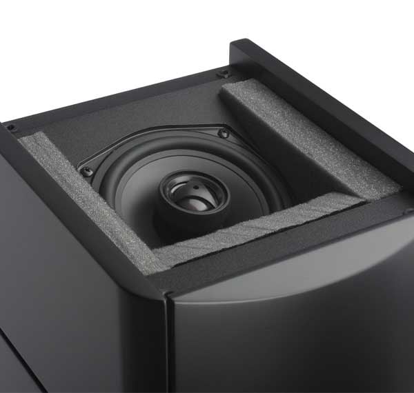

Enter the Atlantic Technology 44-DA. Priced at $499/pair, the 44-DA is to the aforementioned Onkyo what a two-way bookshelf speaker is to a Bose cube. Instead of using a single full range driver, Atlantic Technology developed a concentric unit featuring a 5.25” damped polypropylene cone mid/woofer and a 1” silk dome tweeter. The crossover is at 3.5kHz, and is a 1st order Butterworth design. One initial concern with this arrangement is whether cone breakup is adequately damped, though a polypropylene cone isn’t likely to be as offensive in this respect as a metal cone. Rounding out the package, the 44-DA employs a sealed enclosure, and measures a compact 5-1/2”H x 8-3/8”W x 9-1/2”D, perfect for fitting on top of the Atlantic Technology 4400LR speakers.
44da Driver shot
Shot of the 44-DA's concentric driver array. Note the foam around the edges used to reduce diffraction effects.

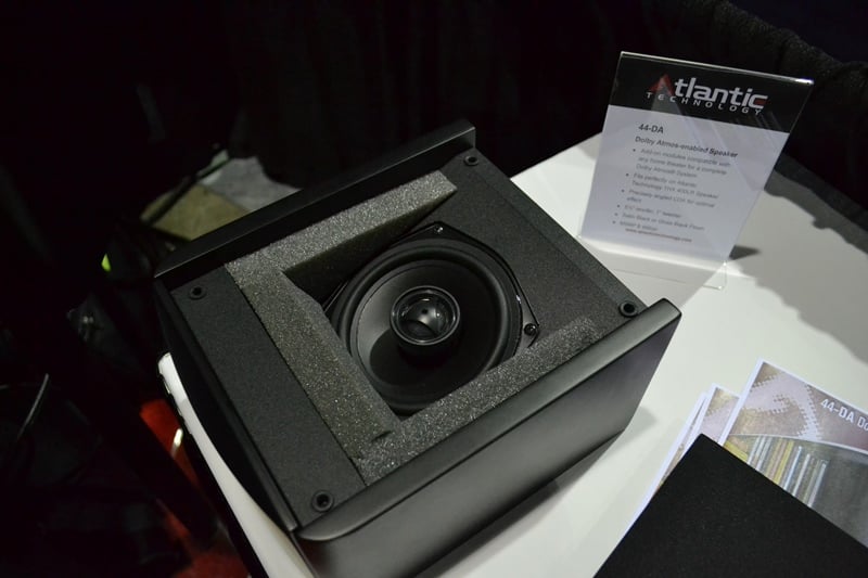

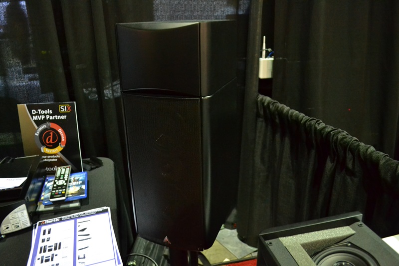

We caught up with Atlantic Technology at CEDIA 2014 and got a hands on look a the 44-DA. The tweeter was movable on the pre-production model they had on display, but it will be fixed on the production model. We thought that it looked good sitting atop the 4400 LR bookshelf speaker. Unfortunately, they didn't have the 44-DA hooked up, so we couldn't get a live demo. However, we suspect that it will perform similarly to other Atmos speakers we've heard.
44-DA grill off         44-DA on 4400 LR
The 44-DA in-person at CEDIA 2014
