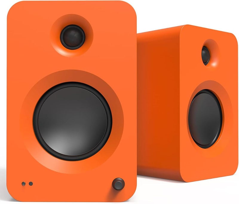

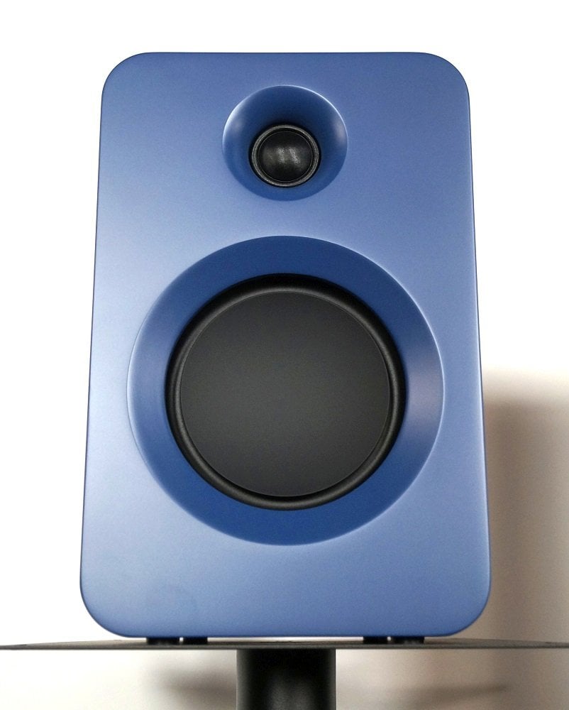

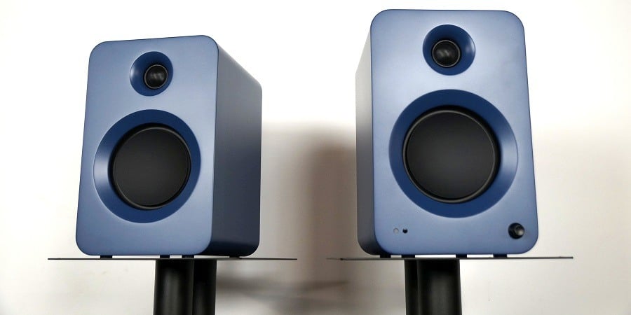

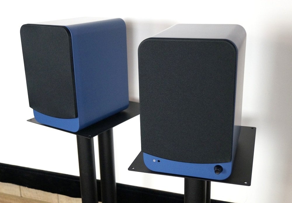

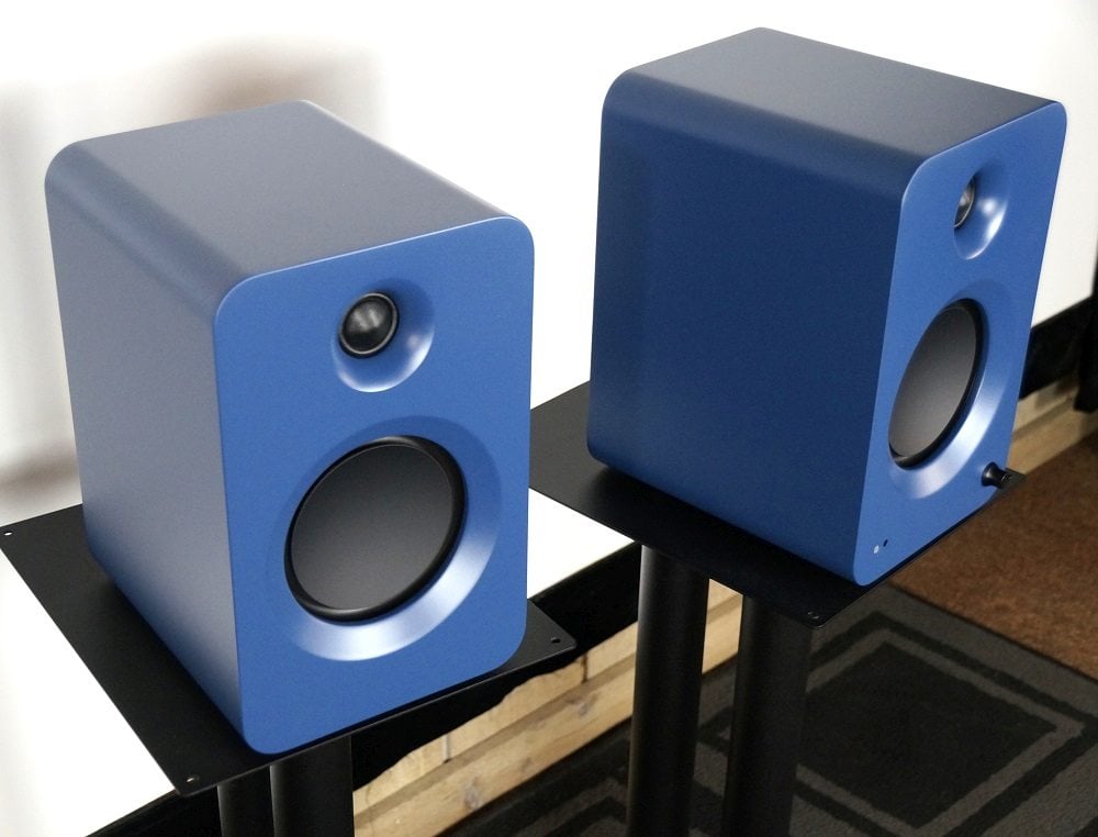

Kanto Ren OrangeThe Kanto Ren speakers come in a good selection of colors. Most speakers only have two or three finishes available, but the Rens have five. They can be had in matte white, black, blue, orange, and grey. I received the blue. Kanto calls it a matte finish, but it has enough of a sheen that if they called it a satin finish, I would not argue. The finish is very nicely applied. Stylistically speaking, the Rens are fairly simple — a good idea so they can fit in a wider variety of decors. The lengthwise edges are rounded to lend a somewhat streamlined look. The drivers are sunken into the cabinet which gives the tweeter a built-in waveguide. The driver diaphragms are simple, uniform surfaces that are ringed by a small surround. The drivers can be hidden by a black fabric grille which simplifies the appearance of the speaker even more. The grille does leave the status LEDs and control knob on the master speaker exposed. The front LED brightness can be changed, and there are five different brightness levels. There is not much else to say about the appearance of the Ren speakers. They look nice with a minimalism that shouldn’t have any aesthetic collision with nearly any room they would go in, so long as the color is a good pick.

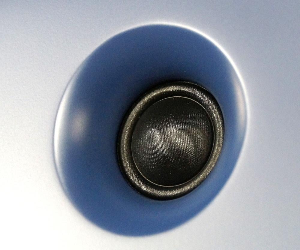

The Ren speakers are tasked with delivering high-fidelity sound from a modest-sized package while accommodating a variety of sources; so how does it go about accomplishing that task? The Rens use a very common 2-way design type: a 1” dome tweeter mated with a 5.25” woofer, and it shouldn’t be too hard to pull a good speaker out of such a popular design archetype. Let’s start our discussion of its design at the top with the tweeter. The Rens use a 1” silk dome tweeter mounted in a small waveguide. Silk dome tweeters are some of the best-understood and most reliably good performers around. The waveguide should help to control the tweeter’s directivity to narrow dispersion at the bottom of its bandwidth and possibly broaden it at the top of the bandwidth. The woofer is a 5.25” aluminum cone with an inverted surround. Given the beveling of the waveguide around the cone, Kanto must have had to use an inverted surround so that the driver would fit. It shouldn’t compromise performance at all. A rear-mounted, flared port produces the lowest octave.

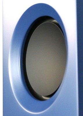

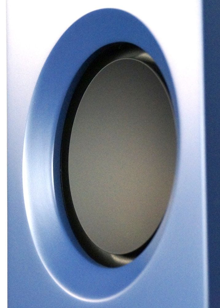

Ren tweeter   Ren woofer

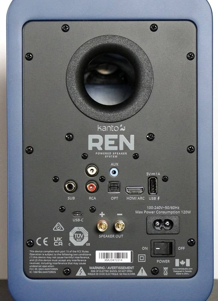

Ren amp panel2The drivers are powered by a system total 100-watt RMS amplifier. That should be plenty of wattage for speakers like these. The amp is a class D design, which should make these speakers very energy-efficient. Only one speaker of the pair has the amp built-in; it powers both speakers and uses a simple 10’ speaker cable to power the passive speaker. While one speaker unit powers both speakers, there isn’t a dedicated right or left unit since the channels can be swapped by the remote control (just hold down the “next track” button for five seconds until you see the speaker’s front LED blink twice). The crossover circuits are passive, but since DSP is used, there should be equalization by Kanto to fit a target response, so the crossover circuit isn’t likely to be much more than simple bandwidth filters.
One of the major advantages of the Ren speakers is their HDMI ARC connectivity. That makes it extremely easy to integrate into the signal chain of a television: just plug an HDMI cable from the TV into the Ren speaker. You may need to configure the television’s audio options to set it to two-channel sound. Other types of connectivity that the Ren can accommodate are Bluetooth, USB Audio, analog RCA, analog 3.5mm, and optical TOSLINK. This is a wide variety of connectivity that will allow the Rens to be easily integrated into nearly any type of sound system. Furthermore, it has a subwoofer output, so adding a sub for deep bass is a cinch as well. When the subwoofer output is connected, the Ren speakers will sense it and then automatically high-pass filter out frequencies below 80Hz, so it has some level of built-in bass management. The Ren speakers even have a USB charger built into the back panel intended to charge things like smart home devices or network streamers, but I suppose you could use it to charge your smartphone as well.

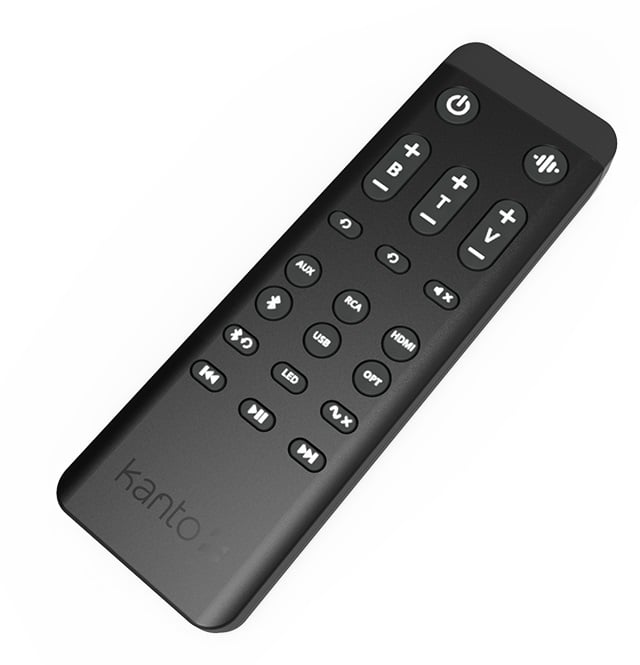

ren remoteThe Ren comes with a remote control unit that has some functions not available on the speaker itself. The remote can interact with Bluetooth playback by playing, pausing, reversing, and forwarding tracks. It can also adjust the LED status light brightness to five different brightness levels. The remote can engage an automatic power-up and automatic power-down mode. If no signal has been detected for 15 minutes, it will enter a standby mode but will be able to power up if a signal is detected again. The remote has a mute function and also a “mute subwoofer only” function. The remote also has tone controls in the form of treble and bass buttons that can lower or raise treble or bass.

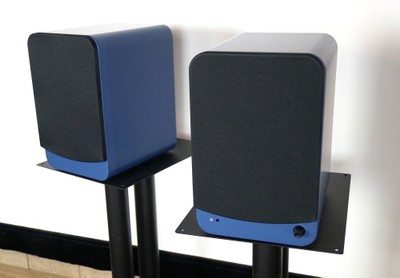

The enclosures are made from ½” MDF panels with the front baffle having a greater thickness. The rear-mounted port is approximately 5” long with a 1 ⅞” diameter, and is only flared in the outer end. The speakers do not come with feet, but Kanto provides some adhesive pads that users can stick to the bottom to prevent the finish from getting scuffed by being placed on hard surfaces. The grille uses magnetic adhesion for a cleaner front baffle appearance, but the grille frame probably will cause some diffraction effects, so for the best sound, leave the grille off (though the difference isn’t likely to be great).

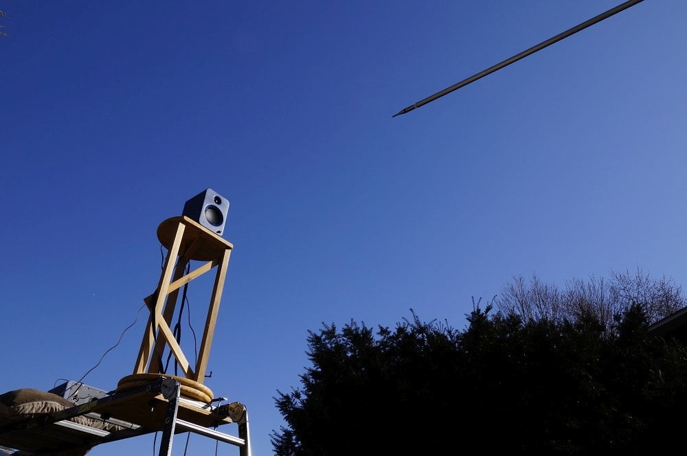

Ren outdoor testing

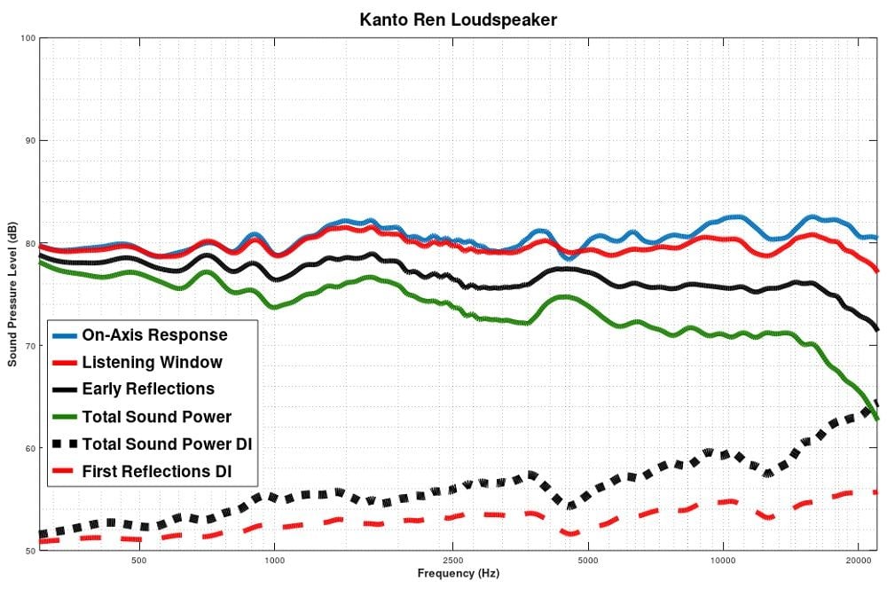

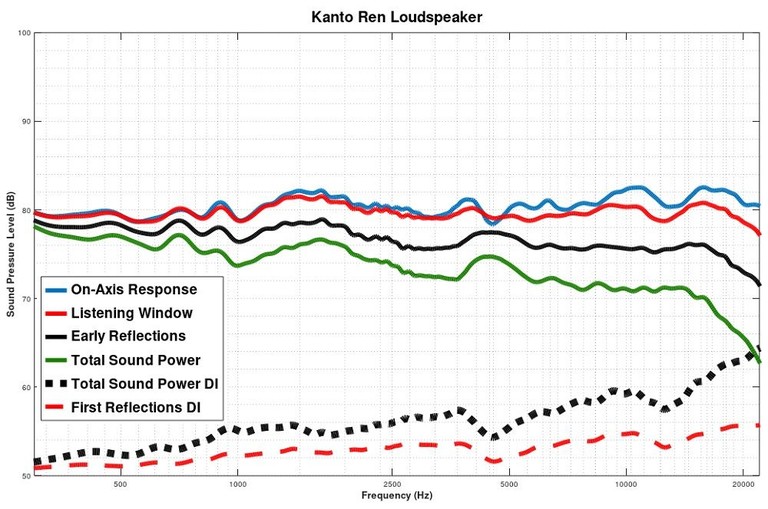

The Kanto Ren speakers were measured in free air at a height of 7.5 feet at a 1-meter distance from the microphone, and the measurements were gated at an 11-millisecond delay. In this time window, some resolution is lost below 250 Hz, and accuracy is completely lost below 110 Hz. Measurements have been smoothed at a 1/24 octave resolution.
Ren Spin o rama
The above graph shows the direct-axis frequency response and other curves that describe the speaker’s amplitude response in a number of ways. For more information about the meaning of these curves, please refer to our article Understanding Loudspeaker Measurements Part 1. The response that we see from the Ren speakers is nicely well-controlled. There is a little bit of waviness going from 1kHz to 2kHz, but other than that, it’s very good. The on-axis response has some waviness in upper treble, but the most important curve here, the Listening Window, is quite neutral, especially in the tweeter’s bandwidth. The Listening Window holds to a pretty tight range, about +/-1.5dB out to 20kHz. Based on what we saw from Kanto’s Ora speakers, I was expecting the Rens to be good as well, and that is what we see here. The directivity indexes do have a few ripples in the tweeter’s bandwidth, so this isn’t a perfect set of measurements, but they are pretty darn good. The Rens prove themselves to be fairly accurate and linear loudspeakers.

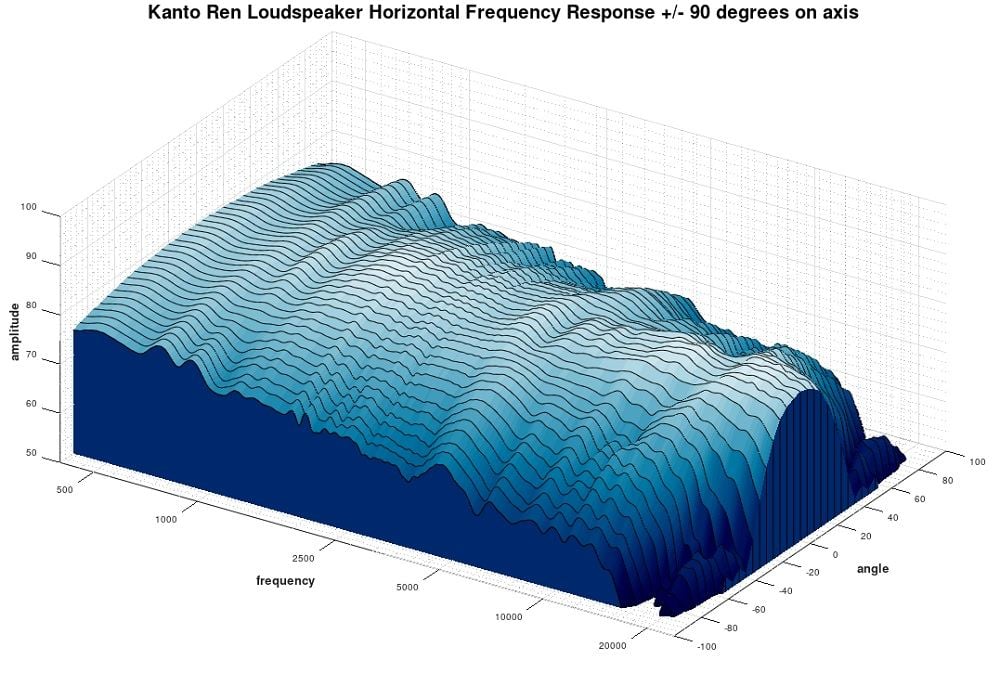

Ri71 3D Waterfall Response
 Ri71 2D Waterfall Response

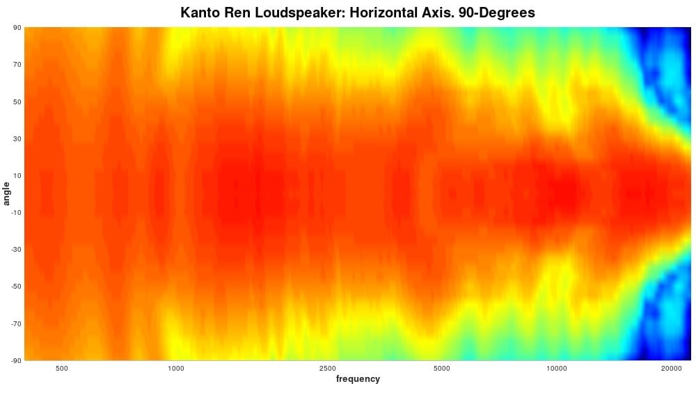

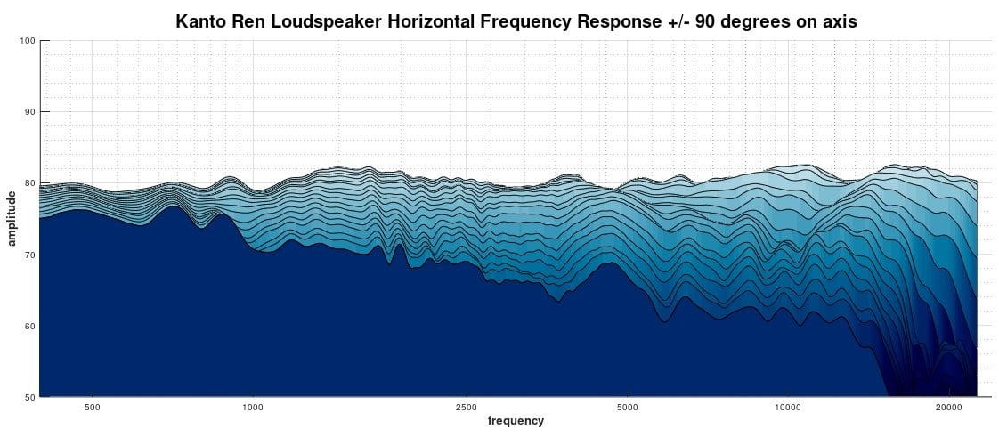

The above graphs depict the speaker’s direct-axis and horizontal dispersion out to a 90-degree angle in five-degree increments. Information on how to interpret these graphs can be read in this article: Understanding Loudspeaker Review Measurements Part II.
As we can see from the above graphs, the on-axis responses are very neutral. Correspondence to off-axis responses does take a small hit in some areas, namely around 5kHz and above 12kHz. These are what caused dips in the directivity indexes. I wouldn’t expect them to have a serious impact on the sound of these speakers since they occur pretty far off-axis, and stuff above 12kHz is pretty rare and not easy for many listeners to even hear. These flaws are small and very minor. What these graphs tell us is that the Ren speakers have an accurate and well-balanced sound, much like what I heard while listening to them.

The above polar map shows the same information as the preceding graphs but depicts it in a way that can offer new insight regarding these speakers’ behavior. Instead of using individual raised lines to illustrate amplitude, polar maps use color to portray amplitude, and this allows the use of a purely angle/frequency axis perspective. The advantage of these graphs is that they can let us see broader trends of the speaker’s dispersion behavior more easily. More information about interpreting this graph can be read in this article: Understanding Loudspeaker Measurements Part II.
In this graph, we get a sense of how wide the dispersion of the Ren speakers is. Typically, 2-way speakers using a 5.25” woofer with a 1” dome tweeter have a very wide dispersion, especially at the low end, but then tighten up as we approach upper treble. The Ren speakers don’t quite follow that trend since the tweeter is mounted in a small waveguide. The waveguide tightens its dispersion at the lower end of its bandwidth but broadens it at the upper end. Since the Ren’s waveguide isn’t a particularly deep one, it isn’t hugely controlling of the dome’s dispersion, but its effects are very evident. The tweeter still starts to beam, but that only becomes significant above 13kHz or so, frequencies that are too high to really impact the sound character of the speaker. The Ren speakers are fairly wide-dispersion speakers on the whole, and maintain some real acoustic energy out past a 50-degree angle from a front-firing position. That means that it should offer good coverage to anyone within a reasonable angle in front of the speakers.

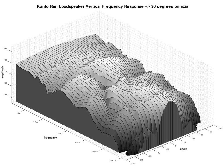

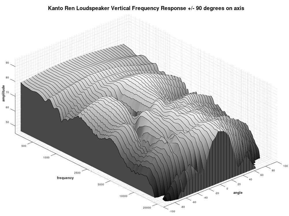

Ren 3D Vertical Waterfall Response

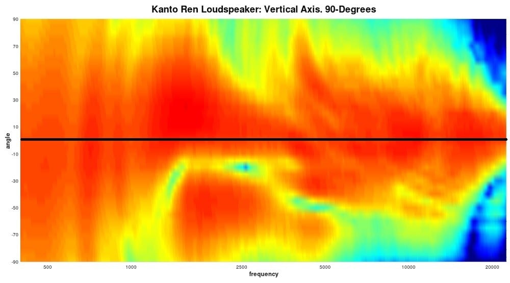

The above graph shows the Ren’s response behavior along its vertical axis where zero degrees is directly in front of the tweeter, negative degree values are below the tweeter, and positive degree values are above the tweeter. Any speaker where drivers are separated by distance, such as here, where the tweeter is mounted a short distance away from the woofer, will inevitably suffer phase conflicts on the axis where the separation occurs. Those phase conflicts typically manifest as nulls at off-axis angles. In this respect, what is unusual about the Ren speakers is just how asymmetrically these nulls occur relative to the on-axis angle. There is a very formidable null just below the on-axis angle, yet a good angle of solid response above the on-axis angle. What that means is that there will be a big gap in the sound if you are listening at an angle below the tweeter but not above the tweeter. To get a better sense of this, let’s look at a polar map of the vertical dispersion…
Ren Vertical Polar Map w line
The black line marks the zero-degree angle, meaning that is the response that happens where the tweeter is aimed. Above that line is about 30 degrees of nice solid red, meaning that that sound will be consistent and full within that angle. Below that, however, we get a gap between about 1.5kHz to past 3kHz, just under 10 degrees. That is a pretty important frequency band, so users definitely do not want to be listening at that angle. What this all boils down to is that users should listen to the Ren speakers at or above the tweeter axis, not below.

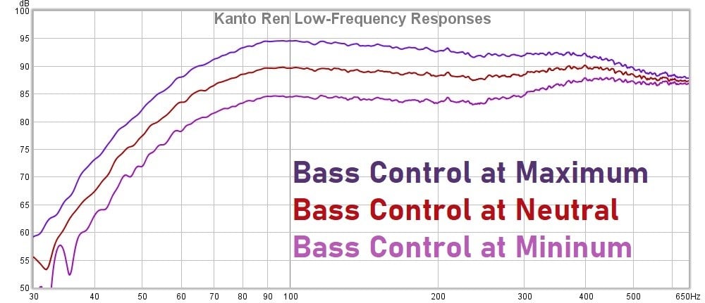

Ren Low Frequency Responses w label
The above graph shows the Ren’s low-frequency response captured using ground plane measurements (where the speaker and microphone are on the ground at a 2-meter distance in a wide-open area). The Ren has a bass tone control button on its remote control, and I have shown responses where the tone control is set to maximum, neutral, and minimum. The bass tone control can add or subtract about 5dB below about 300Hz. The Ren has a mostly flat low-frequency response that begins its roll-off at 90Hz. With room gain, I expect most users would get a solid response to just above 50Hz. Much like the rest of its frequency response, the bass response is admirably flat and well-controlled.

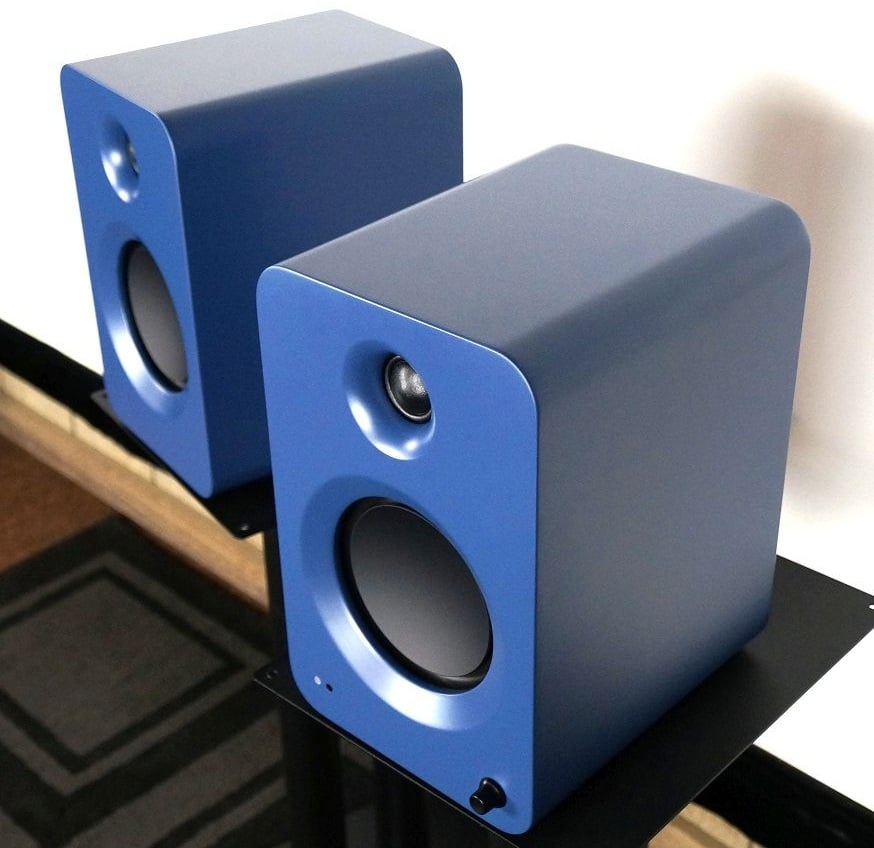

Something else that I wish were a bit beefier is the cabinet. The cabinet construction is OK and in line with products of its class, but I think that Kanto could shore it up a bit. Kanto could add some bracing or make the panels thicker. That would be a simple matter and would go a long way towards making the Rens feel more premium and substantial.

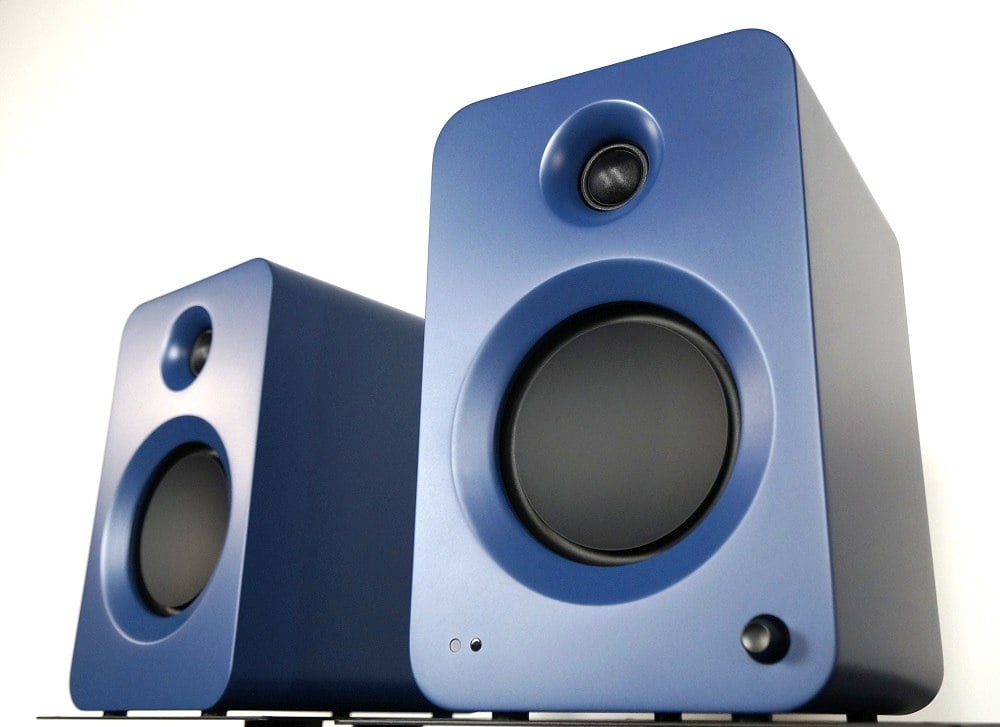

Ren singleWith those two minor gripes out of the way, let’s now talk about the Ren’s strengths, the chief of which is the sound it can produce. The Ren’s sound is well-balanced and has no undue emphasis or deemphasis over any frequency band. Its projected sound is well controlled over a wide angle, so users don’t need these speakers to be precisely positioned to have a great sound. Just sit somewhere in front of them with your ears roughly level with the tweeter, and they will sound great. They image well and can create a vivid, well-realized soundstage. Bass extension is good for a smaller standmount speaker, and the ability to easily add a subwoofer lets users determine bass extension should they choose to do so. Dynamic range is likewise impressive for a loudspeaker of its size, especially with a subwoofer in play.
