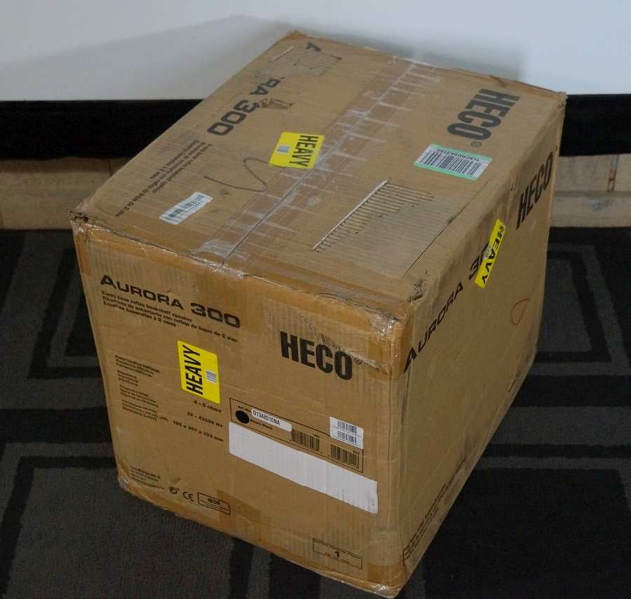

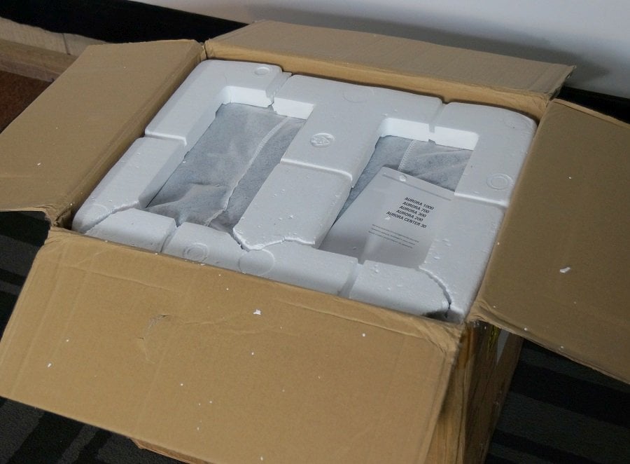

The Aurora 300 pair arrived in a single, heavy-duty cardboard box. They were packed in styrofoam, and the foam did not quite survive the voyage to my home. What was supposed to be two pieces sandwiching the speakers turned into many pieces after what must have been a rough trip. Thankfully, enough key pieces survived so that the speakers weren’t tumbling around in a mess of Styrofoam particles, and the speakers only suffered minor cosmetic damage. Within the Styrofoam packing, the speakers are wrapped in a cotton sleeve to protect against moisture and scuffs. HECO should look into upping the packing protection by using polyethylene foam blocks instead of Styrofoam. Styrofoam is much less expensive, but if these speakers are indeed good ones, then they deserve better packing than what has been provided here.

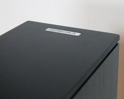

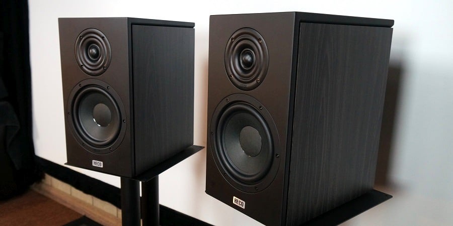

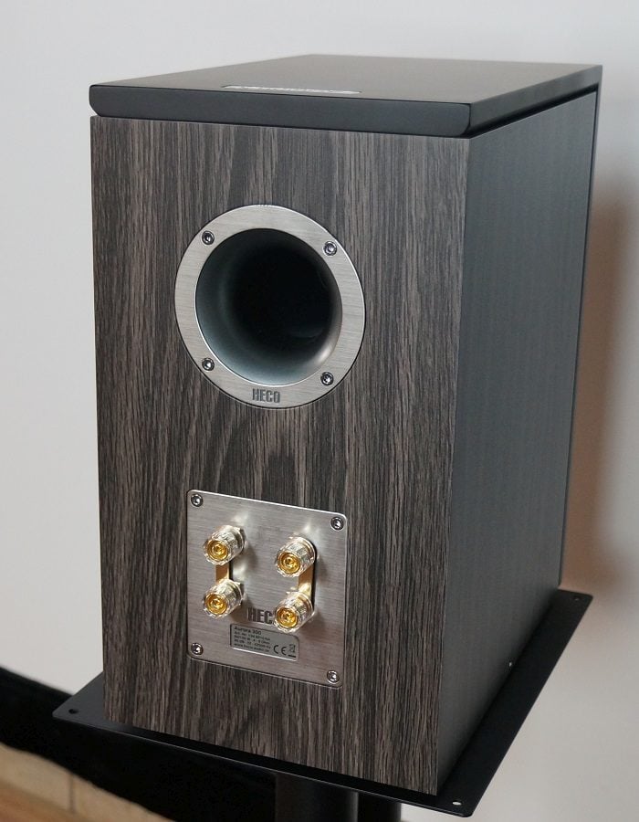

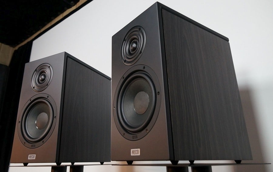

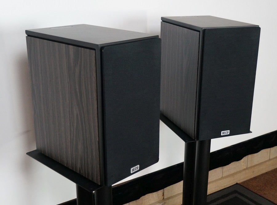

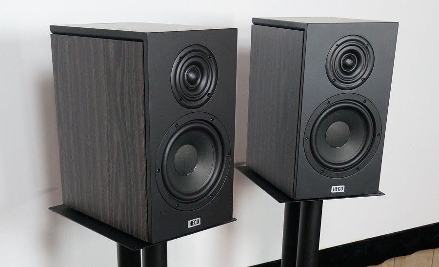

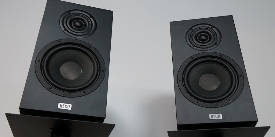

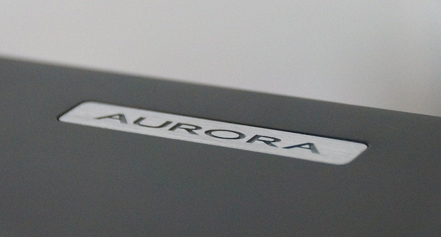

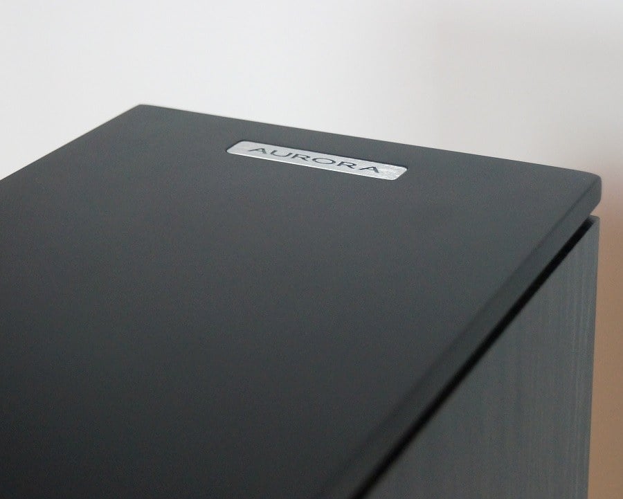

Once unpacked, we are met with two handsome bookshelf speakers that came in HECO’s ebony finish. The front baffle and top are a continuous piece of satin black, and the sides, bottom, and rear use a vinyl imitation ebony wood veneer. The ebony imitation looks a lot more like a real wood veneer than the ivory white that the 1000s had which I previously reviewed. With grilles on, the 300’s drivers are hidden, and the 300s look like smooth black boxes with a wood panel siding. Without grilles, the drivers are exposed and give the speakers are more detailed appearance. The woofer looks very typical, and the dome tweeter looks slightly unusual owing to the radial ribbing on the tweeter faceplate. A metallic HECO badge rests on the lower edge of the front baffle, and an Aurora badge sits in the back of the top panel. To the extent that it matters, the rear of the speaker uses a faux brushed metal finish on the terminal cup as well as the port. It looks fine at a distance but isn’t terribly convincing upon close inspection. Overall, the Aurora 300s look like typical bookshelf speakers, perhaps a bit understated in the ebony finish, and not at all bad for the class.

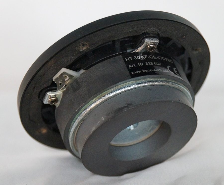

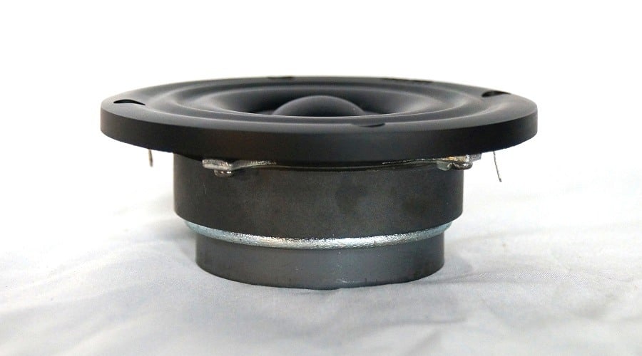

The Aurora 300 uses a 1.1” fabric dome tweeter surrounded by a corrugated flange in a system that HECO calls the “Fluktus” tweeter. The faceplate of the tweeter has computer-modeled waves shaped into it that are supposed to assist with the dispersion, so they act as a waveguide somehow. It’s a strange waveguide, and I think the real purpose of the ripples in the faceplate is to modulate baffle diffraction in some manner. The results we saw in the 1000 were very good, and I expect the same to be true here. The tweeter uses a 2 ¾” diameter ferrite motor with a ⅝” thickness with a bucking magnet attached. In the ‘old days,’ bucking magnets were used to contain stray magnetic fields from interfering with CRT televisions. They can also have the added benefit of slightly raising driver sensitivity which is why I would imagine HECO is using them here.

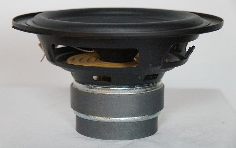

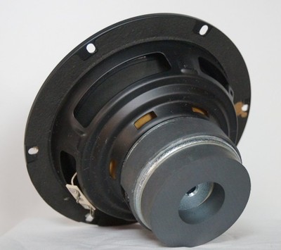

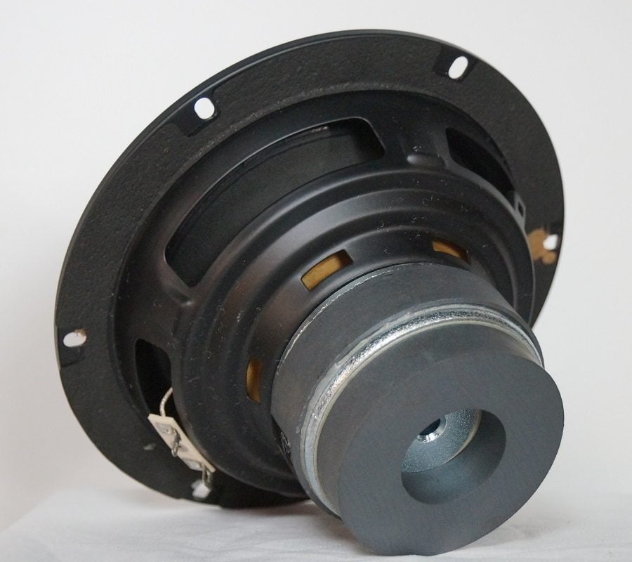

Moving on to the woofer/midrange, we have a 6.7” treated paper cone attached to a stamped steel frame with a relatively large half-roll surround and Nomex spider. The motor uses a 3” diameter x ¾” thick magnet and is vented under the spider. It also has a 3” diameter by 9/16” thick bucking magnet attached, presumably to raise sensitivity. Cooling is done through the pole piece as well as under the spider.

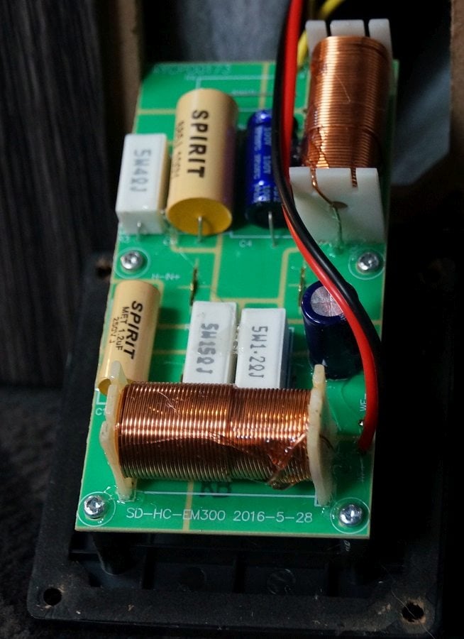

The 9-element crossover looks sufficient for the job, but it’s not the fanciest circuit I have ever seen. The stated crossover frequency is 3.3kHz, and while that seems pretty high for a two-way bookshelf speaker with a 6.7” woofer, it worked well for the Aurora 1000s, so I am guessing it will work well here too. For some absurd reason, the 300s have dual binding post pairs so they can be bi-amplified or bi-wired. There is rarely a good reason to bi-wire any speaker, and the bi-amplification of a two-way bookshelf speaker that is only spec’d at 75-watt RMS power handling is also ridiculous. I am guessing they only added dual binding post pairs to tick off some marketing checklist to make the speakers seem higher-end. To be sure, dual binding post pairs don’t necessarily hurt anything, but misuse by users who don’t fully understand their functionality only makes them a source of trouble, not improvement. I would encourage users to just use the speaker normally and leave the jumpers installed.

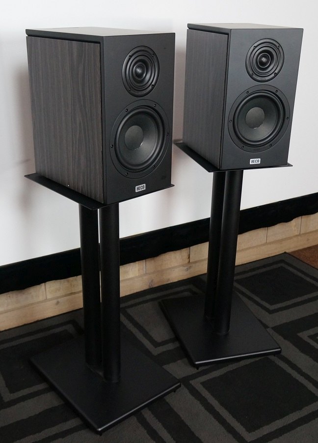

In my 24’ by 13’ (approximately) listening room, I set up the speakers with a few feet of stand-off distances between the back wall and sidewall and equal distance between speakers and listening position. I angled the speakers with a mild toe-in toward the listening position. The listening distance from the speakers was about 9 feet. Processing was handled by a Marantz 7705, and amplification was handled by the Monoprice Monolith 5x200. The speaker stands were some Monoprice Monolith 24-inch Steel Stands. Subwoofers were not used unless otherwise noted.

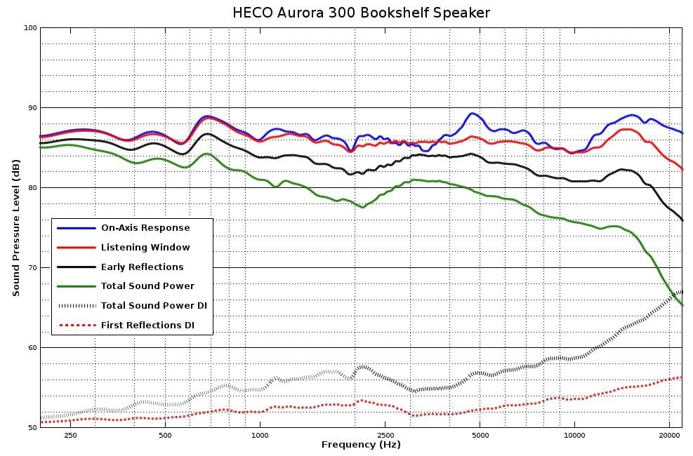

The Aurora 300 speakers were measured in free air at a height of 7.5 feet at a 1-meter distance from the microphone, and the measurements were gated at an 11-millisecond delay. In this time window, some resolution is lost below 250 Hz and accuracy is completely lost below 110 Hz. Measurements have been smoothed at a 1/24 octave resolution.
The above graph shows the direct-axis frequency response and other curves that describe the 300’s amplitude response in a number of ways. For more information about the meaning of these curves, please refer to our article Understanding Loudspeaker Measurements Part 1. While the on-axis response is a bit rocky here, the listening window is fairly smooth, and the good news is that the listening window is much more important than the on-axis response. The listening window encompasses much of the forward acoustic response across probable listening positions, whereas the on-axis response only describes a single angle. The early reflections curve is also fairly smooth, but we start to see effects of crossover cancellation, although much of that is probably stemming from the vertical responses which aren’t that critical and thus less impacting on the sound. The power response and directivity indexes do show a slight directivity mismatch between the tweeter and woofer, and the tweeter does have a broader radiation pattern at its bottom end than the woofer has at its top end. I would imagine that the Aurora 200s with a smaller 5” woofer would probably have a better directivity match with the tweeter, but I think that the audible consequence of any of this would be small.

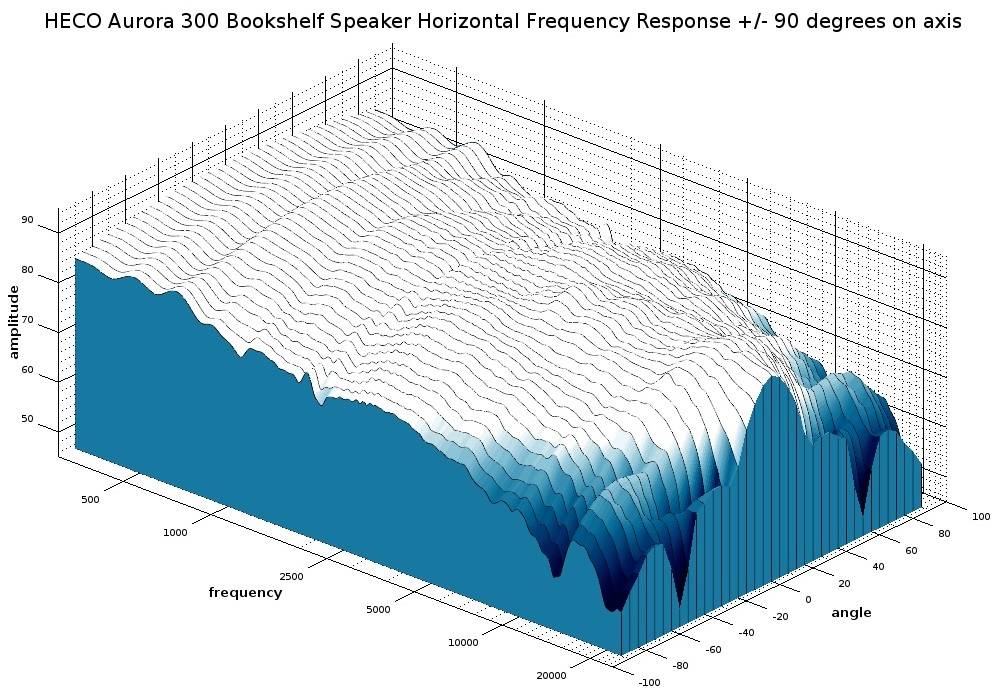

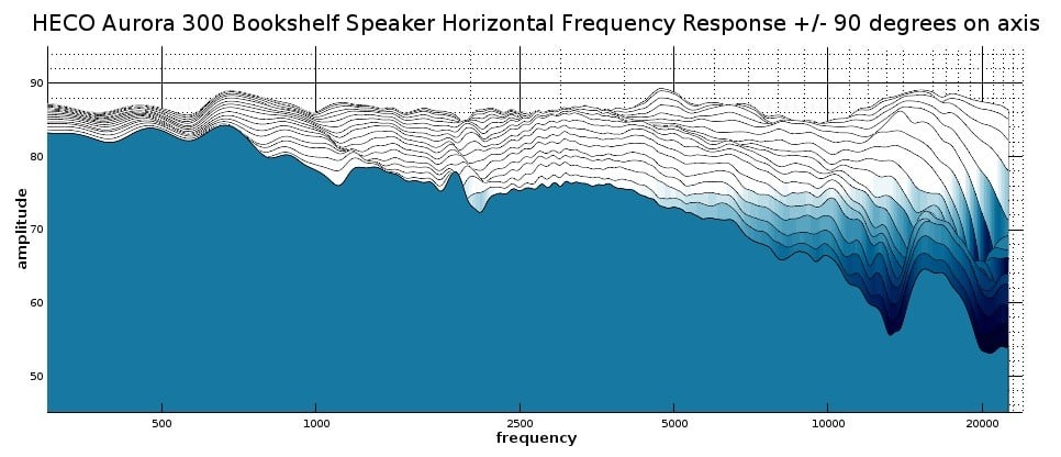

The above graphs depict the speaker’s lateral responses out to 90 degrees in five-degree increments. More information about how to interpret these graphs can be read in this article: Understanding Loudspeaker Review Measurements Part II. In these graphs, we get a better look at how the on-axis response and nearby angles compare to the off-axis responses. The bump in the on-axis response centered at 5kHz might make the 300s a tad sibilant to listen to when aiming the speaker directly toward the listener, but without a toe-in, these speakers exhibit a very smooth response. There is a small rise in treble above 12kHz or so, but that is too high in frequency to matter in any realistic listening situation. There is not much content up there, and many listeners’ hearing isn’t very sensitive to such high frequencies anyway. The directivity mismatch that we see from the above ‘spin-o-rama’ family of curves isn’t apparent in these measurements of the horizontal radiation, which is more reason to think it's not going to have a serious impact on the sound.
The above polar map graphs show the same information that the preceding graphs do, but they depict it in a way that can offer new insight regarding these speakers’ behavior. Instead of using individual raised lines to illustrate amplitude, these polar maps use color to portray amplitude, and this allows the use of a purely angle/frequency axis perspective. The advantage of these graphs is that they can let us see broader trends in the speaker’s behavior more easily. For more information about the meaning of these graphs, we again refer the reader to Understanding Loudspeaker Review Measurements Part II.
In this graph, we do see some very slight waistbanding at just under 2.5kHz, but it is pretty mild. We do see that the tweeter does constrict its dispersion as frequencies rise above 5kHz, and that is typical of dome tweeters without waveguides. This narrowing of upper-frequency radiation of this dome tweeter is not as severe as many that we have seen in the past that have this type of design. The good news is that we see a lot of solid light red color which means that the response is stable and consistent across so much area. That will result in the speaker having a similar tonality over a broad listening area. This is particularly good news for those looking at these as surround speakers since they offer coverage over a wide area with an even, uniform sound.

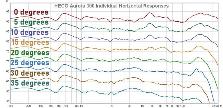

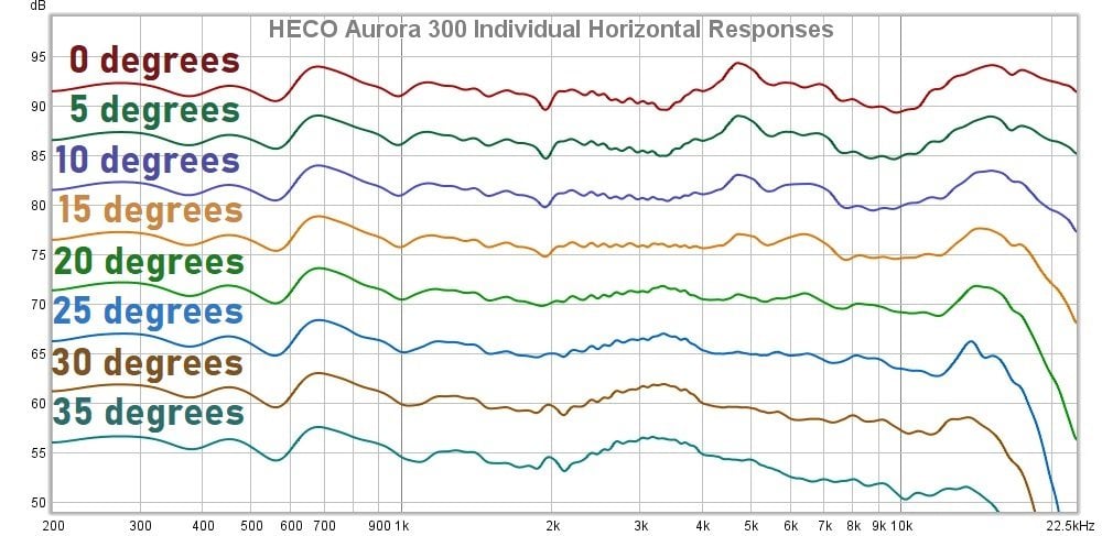

The above graph takes a closer look at the individual amplitude responses on the horizontal axis from zero degrees out to 35 degrees which covers pretty much all of the area that anyone would reasonably listen to on these speakers. Here, we get a better look at the optimal angles where the response is the smoothest. From zero degrees going out, we get a peak at 5kHz that softens and is completely gone by 20 degrees. If you position the speakers to face outward in parallel directions, then those listening at a center point between the speakers would be around the 20-degree angle. That means these speakers work best with no toe-in. That is smart engineering (or just good luck) since most people do not angle the speakers to face the listener directly as audiophiles so often do. At responses at and around 20 degrees, we get a very wide band of flatness stretching from lower midrange to upper treble. There is a bump centered at 700Hz that occurs at all angles, and that might lend a slight nasally quality to some voices, but I don’t think it is high enough or wide-band enough to have a serious detriment on the sound. I didn’t notice anything amiss in my listening.
The bottom line here is that, for the best sound, just position the Heco 300 speakers to face forward WITHOUT angling them inward at all.

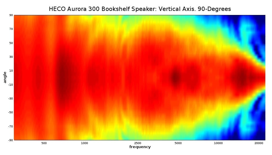

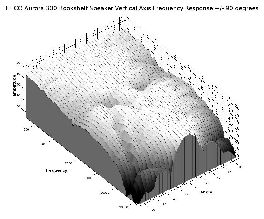

The above graph shows the 300’s response behavior along its vertical axis where zero degrees is directly in front of the tweeter, negative degree values are below the tweeter, and positive degree values are above the tweeter. We can see that we don’t get an extremely wide angle before crossover cancellation occurs on the vertical axis, about +/- 10 degrees. That means that, as with so many other speakers, these speakers should be placed around ear-level height and try not to listen too high or low with respect to the tweeter angle. That is very typical of this type of design. The 300’s might have gained a broader vertical angle before crossover cancellation dips kick in if the tweeter was mounted closer to the woofer, but the large tweeter plate and its odd ‘Fluktus’ design make closer mounting impossible.

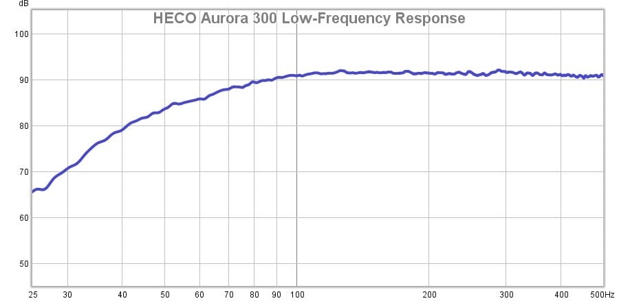

The above graphs show the 300’s low-frequency responses that I captured using groundplane measurements (where the speaker and microphone are on the ground in a wide-open area). This is a remarkably smooth low-frequency response with a gradually tapered low end indicating that the port isn’t quite producing as much output in the low end as the woofer is in mid-bass frequencies. That is a very common strategy since a dead flat response down to port tuning doesn’t account for room gain and often causes a boomy in-room response. In my home theater room, I ended up with strong bass down to 50Hz, but in a smaller space, this type of response could potentially yield usable bass down to lower frequencies. I appreciated the fact that HECO decided not to boost the port-generated frequencies as can sometimes be done on lower-cost bookshelf speakers. That can cause muddy and indistinct bass depending on the nature of the bass boost.

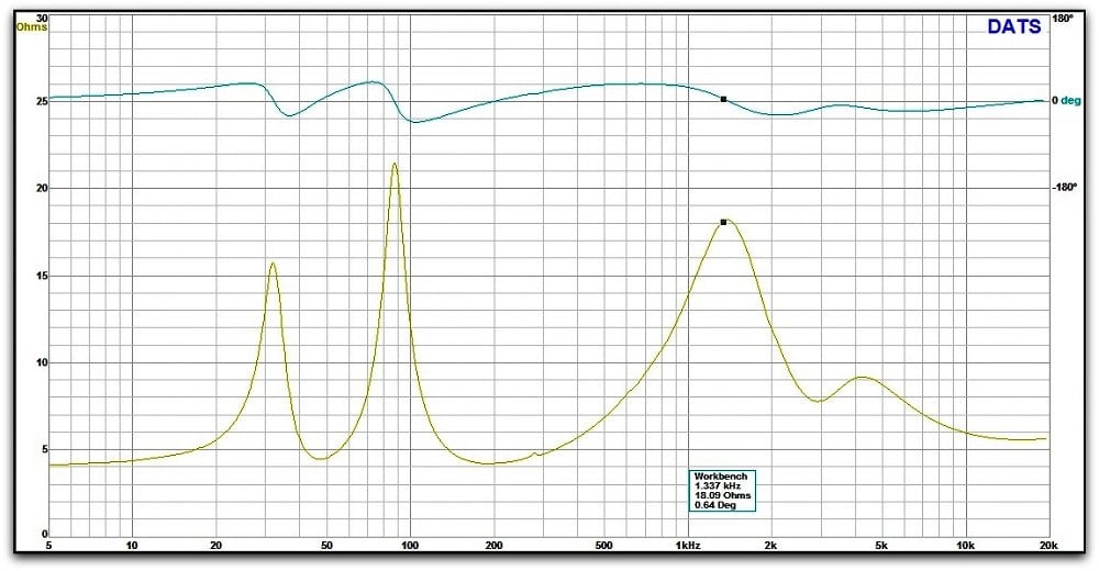

The above graph shows the electrical behavior of the Aurora 300 speakers. This has to be considered a 4-ohm speaker thanks to the mid-bass region’s minima at 4-ohms, but this is a very mild 4-ohm load. Any AVR should be able to run these speakers without problem. We can see from the dip between the saddle peaks in bass that the port tuning is just under 50Hz. We can also see from the second saddle peak being so much taller than the first that the enclosure resonance is higher than that of the bass driver. There is a slight blip just under 300Hz that might be a panel resonance since the 300 doesn’t have any cross-bracing within the cabinet.
I measured sensitivity to be 88.2dB for 2.83v at 1 meter which is a bit below HECO’s sensitivity specification of 90dB for 2.83v watt at 1 meter. But even by my measurements, the 300s are above average in sensitivity for a medium-sized bookshelf speaker. They don’t need a ton of power to get loud, and indeed they could not handle a ton of power anyway with a 75-watt RMS power-handling spec.
