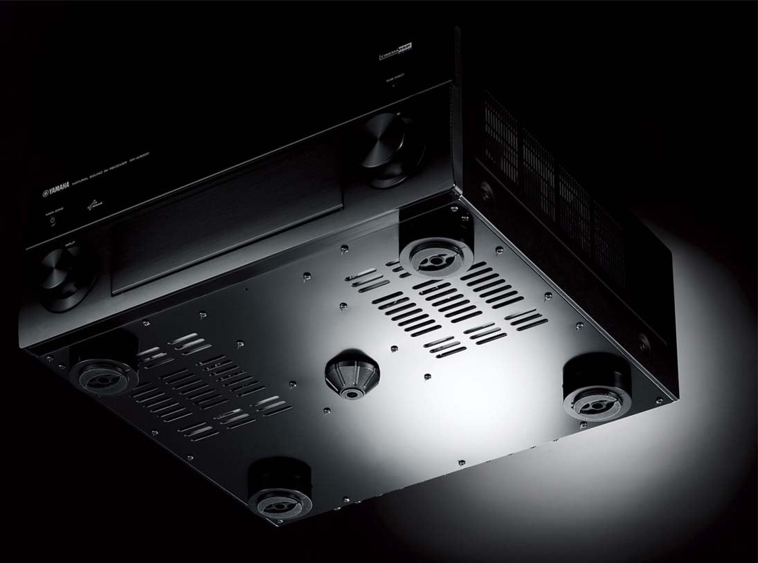

5th Foot w/ Anti-Resonance Technology
Low Jitter PLL Circuitry (Ultra Low)
H-shape Cross Member Frame

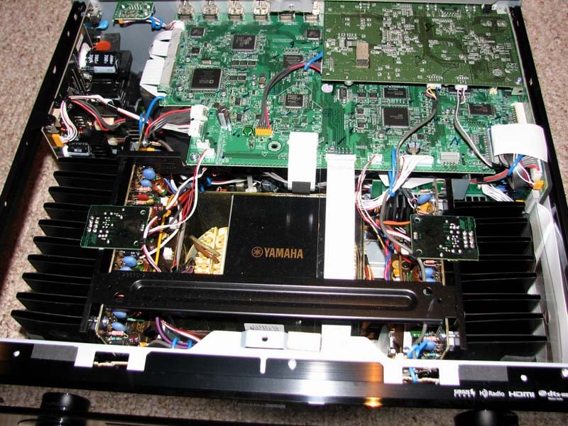

Yamaha truly lives up to their mantra of better build quality with their Aventage lineup of receivers.  Pulling the top cover off the RX-A3000 revealed no wasted space and meticulous attention to detail for reducing mechanical vibrations in the product such as felt taped heatsinks, padding for every contact point to the top cover, and their alleged 5th foot mounted directly under the centralized E-Core power transformer. At first this appeared to be a marketing gimmick, but there is method to their madness as it's not a lofty design goal to eliminate mechanical vibrations in a product, especially a transformer that likes to hum.  Unlike the RX-Z7's single heatsink for its power devices, the RX-A3000 splits this duty off to smaller dual heatsinks mounted on each side of the power transformer in what Yamaha calls dual symmetric power amplifier layout.  At first glance, these heatsinks appear small but more careful observation reveals extra thick metal plating at the base of the heatsink mounted to a very thick bottom cover to help dissipate heat and increase chassis rigidity.  Yamaha also employed brand new thermal control regulated power transistors in this baby to better manage heat.  It was clear to us that Yamaha proved their masterful craftsmanship with the execution of this compact, well engineered A/V receiver.

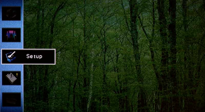

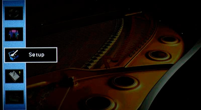

Yamaha RX-A3000 Aventage Menu System & Setup
One of the things we really like about the RX-A3000 is its new and improved GUI with snappy, animated menus that can also superimpose itself over video. Earlier menu systems were gussied up text-based interfaces - this is more like an app. Screenshots are great, video is even better, so check out our Yamaha RX-A3000 Video Preview for a sneak peak at the menus in action. Starting at the top, even the background of the menu system, the splash screen, can be configured:
Within the system menu we found that the RX-A3000 unlocks an almost limitless amount of options for the amplifiers, inputs, HDMI and DSP. We're talking a massive amount of configurability, and the visual representation of what you are doing makes it easy to understand the settings. The Setup menu system, which slides up and down, and left to right depending upon the submenu you are in, generally allows you to edit settings on the fly while watching video in the background and is broken up into 8 main sections:

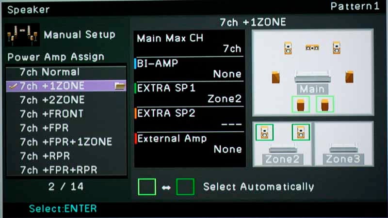

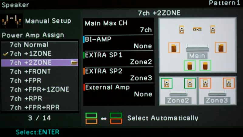

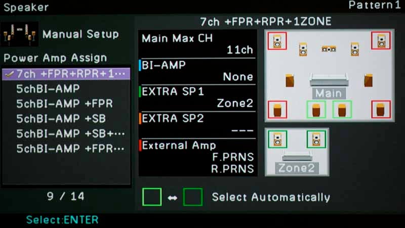

This is where you engage the Auto setup using the included multi-point microphone, and also where you configure the speakers with the manual setup function. We have beat YPAO to death in the past, so we're not going to waste valuable real estate rehashing that system here. What we are going to talk about is the new design of the manual Speaker Setup menu, which operates under a new "Select Your Speaker Configuration" methodology. In the past, Yamaha had you select how the amplifiers were going to be used, and select the way the Surround Back and Presence channels were to be allocated, often without any provision for utilizing both a second or third Zone and the Presence Channels. In short, Yamaha was severely limited in the past. With the RX-A3000, the on-screen GUI interface literally shows you what your options are, and you can pick and choose how you want to run your speakers and how you are planning to amplify them in the various situations. The amplifier assignments are automatically selected when you scroll through the configuration options - and you have only to observe the notation and graphical representation to understand what is possible. In this way, the complexity of selecting amplifier routing is removed and all possible permutations are granted simultaneously. This is the first time we've seen this in an AV receiver.
Take this scenario, for example, which is my favorite: I am operating a 7.1 system + a second Zone. In this configuration I am not bi-amping the mains, but I am using an external 2-channel amplifier to power my Zone 2 speakers. This is designated as EXTRA SP1: Zone 2. It also gives me the flexibility to select how I am using my last 2 channels of amplification - as Surround Back speakers, or in Zone 2. The beauty is, with 11 pars of binding posts, I don't have to do any fancy rewiring; everything is all set. Here is how it looks:
Now, suppose I wanted, instead to opt for pulling both the Surround as well as the Surround Back amplifiers in order to power two additional zones? No problem, Yamaha's RX-A3000 can allocate amplifiers as needed to do that as well. Here's how that particular configuration looks:
But I want to use my Presence channel speakers, you say. You know what, that's a great idea. Yamaha  allows you to configure those for use with an external amplifier (they have dedicated preamp outputs) and now you can opt to allocate the internal amplifier between Surround Back channels and the optional Zone 2 you configured. This is how that scenario would look on the setup menu:
We complained (OK, whined) about that for years, and finally Yamaha seems to have taken the hint and allocated enough processing power and preamp outputs to handle even the most difficult configurations. It seems that if you can add external amplifiers, you can truly harness the power of this 11.2-channel receiver.  Not since their flagship RX-Z11 selling for more than 2 ½ the price, was this possible.
OK, so that's just the speaker allocation and power amp assignments. You still have the ability to configure the speaker levels (0.5dB steps), distances (0.2 ft/.05m increments), and Extra Bass (where the receiver can send fullrange information to the front speakers and bass from the front speakers to the subwoofer). You can also, and this is a BIG deal for a receiver at this price point, connect two subwoofers with independent level and trim control and set the subwoofers for either mono, stereo (left + right), or front/rear. We typically recommend Mono, but some audiophiles may want to experiment with the stereo setting.  We don’t recommend the front/back setting since it only sends LFE info to the rear sub.
For more information, read:  Home Theater Multiple Subwoofer Set-Up Guide

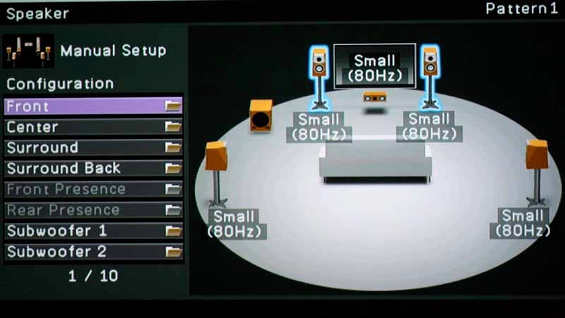

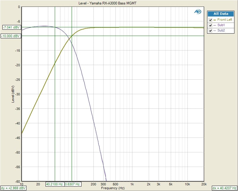

As was the case with the RX-Z7, the RX-A3000 provides for variable crossover settings per speaker group (ie. Mains, Center, Surrounds but doesn't give you a choice for the subwoofer crossover which I found through my testing to be dependent on the main channel crossover setting.  Thus I highly recommend you keep each speaker group's crossover setting within 20Hz to ensure a more optimal integration with the subwoofer during all playback modes (ie. discrete 5.1 sources and 2 CH music in PLIIx Music Mode).
Yamaha still allows you to set the center and surround channels to "large" even if you select "small" for the main channels.  I would have preferred Yamaha to automatically set all speakers to "small" if the mains were set "small".  Pay extra attention when manually configuring speaker size groups or use one of their presets that sets all speakers to "small" if you aren't running fullrange speakers on the main channels or want all of your speakers bass managed.
The crossovers worked as expected for a THX Ultra2 certified receiver (except the RX-A3000 is not THX certified) as indicated by the 12dB/oct High Pass Filter (HPF) slopes on speakers set small and 24dB/oct Low Pass Filter (LPF) slopes on the subwoofer output which we measured with our Audio Precision APx585. The only oddity was that the subwoofer channel was down about 1.5dB at 10Hz which to us indicated a rather conservative HPF employment on this channel since this slight attention didn't show up on any of the seven main channels.

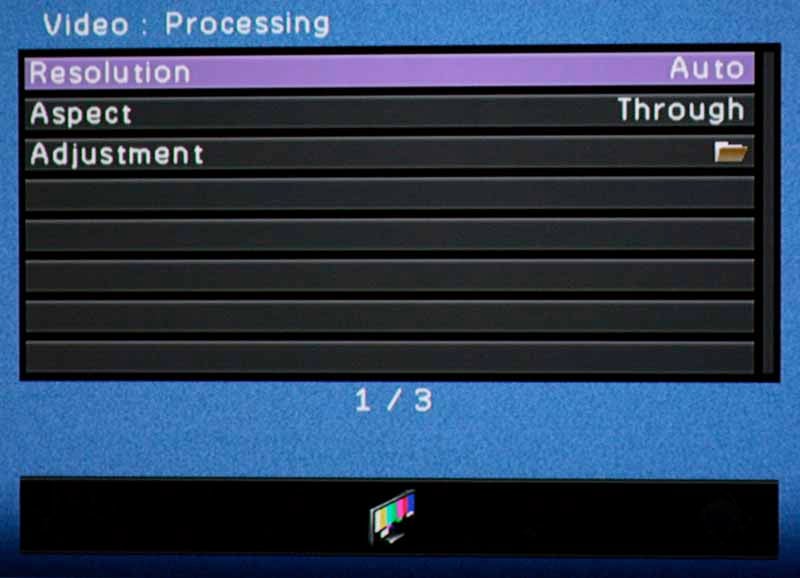

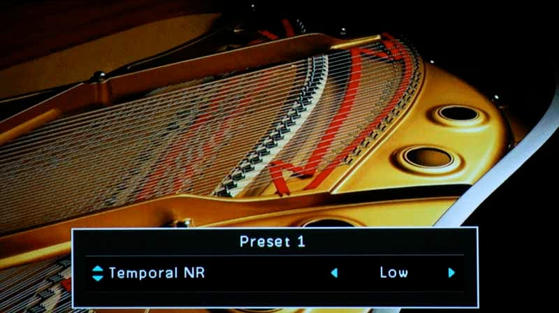

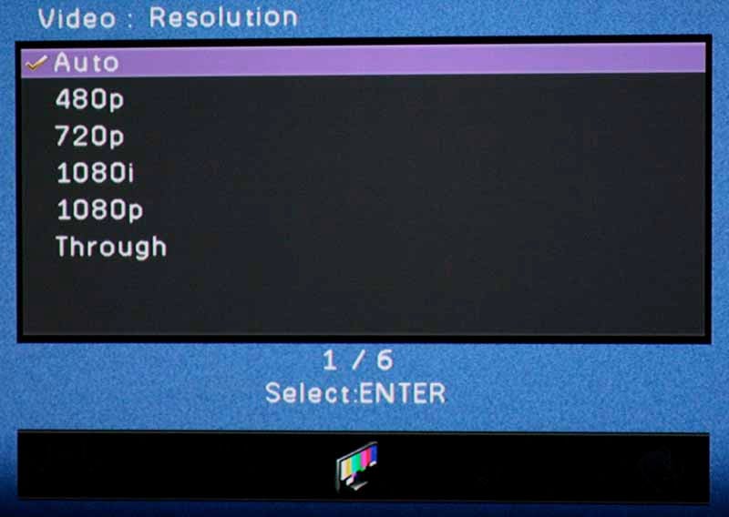

Video
The Video setup menu has some very unique and helpful settings. In particular, we felt it was wise of Yamaha to allow users to disable analogue-to-analogue conversion. In that way you can force your expensive display to do the work and maintain the purity of your video signal (it's also an excellent way to troubleshoot analogue video compatibility problems). You can also disable the video processing features for the HDMI video - also helping you to determine exactly who is doing the video processing: the receiver, the player, or your display. If you enable it, you can set the output resolution to 480p, 720p, 1080i, 1080p or Through (same resolution as what is being input).
Please read: Video Processing in Blu-ray Players, Receivers and Displays
Aside from processing and conversion, this menu provides for scaling options of converted video, and picture controls such as Contrast, Brightness, and Resolution Enhancement. Unless you have a deficient source component, we recommend largely leaving these options alone with one exception. We found that the various Noise Reduction circuits were handy in reducing mosquito noise and the analogue noise found on older program material. In either case, it's a truly advanced feature with six configurable Presets which allow adjustment over:
  • Contrast enhancement
  • Resolution Enhancement
  • Detail Enhancement
  • Edge Enhancement
  • Noise Reduction
  • Mosquito Noise Reduction (NR)
  • Block Noise Reduction (NR)
  • Temporal Noise Reduction (NR)
  • Brightness
  • Contrast
  • Saturation
That's an extensive list, driven by the new HQV Vida video processing chipset. Since you can customize and store up to six different presets, it's incredibly powerful and offers a great way to tweak the system when your display or source doesn't allow for easy application-specific customization.

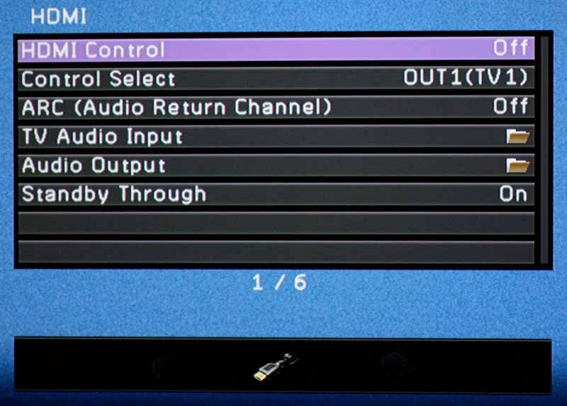

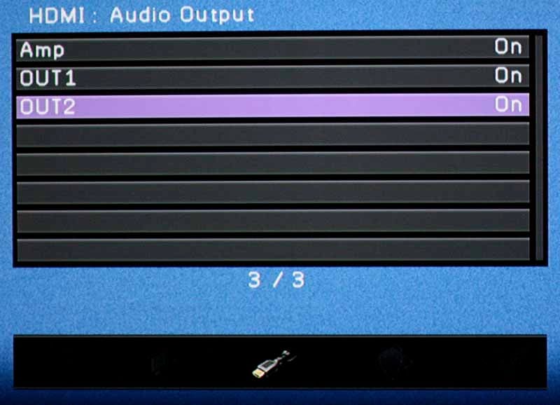

HDMI
As with most receivers with dual HDMI outputs, the Yamaha RX-A3000 lets you set which output will handle CEC functions (and enable or disable the function entirely). Unfortunately, since HDMI has provided such poor implementation standards for CEC functions under the guise of "freedom for manufacturers to choose", the results are almost always unpredictable, even when you stick to products made by the same manufacturer. This menu is also where you would enable Audio Return Channel (ARC) functionality (and the Control Select function determines which HDMI output receives the audio signals from the TV). You can also select which input receives this audio.
The other thing we really liked was that you could set what is output via the two HDMI output jacks - namely, whether audio and video, or just video are output. What's semi-unique about the RX-A3000 is that you can have the receiver simultaneously read audio from an HDMI input and also send that audio out through one or both HDMI outputs on the back. This means that you can do a sort of multi-cast of program material. Why is this important? At times, during our annual Super Bowl party for example, we've wanted to take audio from a source and also pass it along to another room where it can feed a television. Typically you must choose one or the other - either you are pulling audio and passing video on to a television, or you are passing all audio through the receiver without using it. With the RX-A3000, you can have your cake and eat it too. Lastly, HDMI Standby is activated here and you can select the HDMI input even when the unit is in Standby mode!

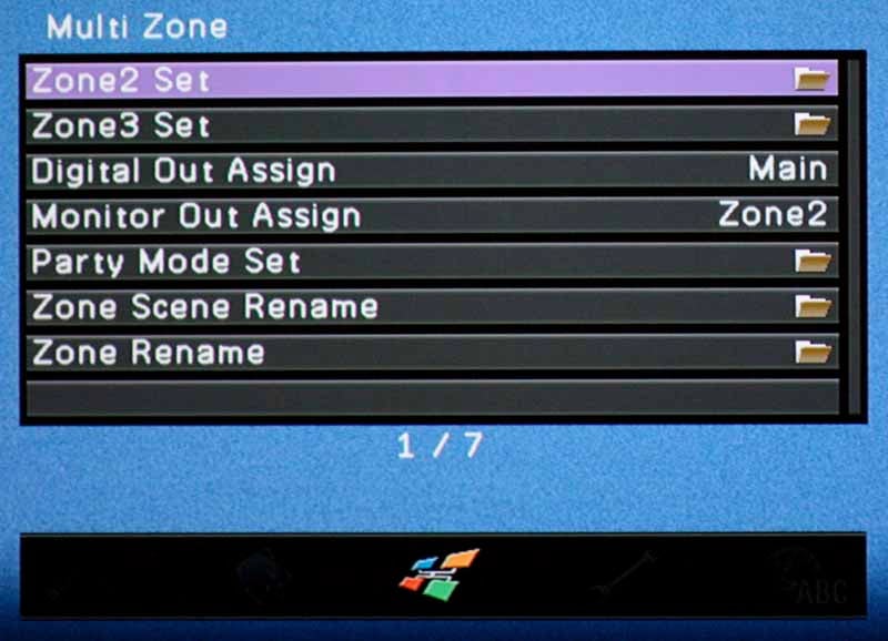

If you use this receiver for multiple zones - and you should because it's good at it - you'll spend some time here setting it up. Once you configure the speakers in the Speaker menu, what's left is to tell the receiver whether you want Fixed or Variable volume in Zones 2 and 3 and what the Max Volume needs to be set at (a life-saver if I ever saw one). Having this level of Zone audio control is extremely handy for when, as in our case, you are using a Zone for outdoor speakers and want to limit the output levels to reduce the potential for distortion or overdriving your speakers. You can even set Initial Volume and select the digital output to be assigned to Zone 4 or the main zone. A Party Mode can be configured to allow you to enable all or just some of the zones to respond with identical audio from the main zone source. In this way you can literally light up your house with whole home audio that's in sync or, if you have a separate area that requires a different sound, like an office or a children's room, you can split off that Zone from the rest of the Party Mode audio. Aside from this, you can rename Zones and even rename Zone Scenes as well as configure the monitor output between Zones 2-4 (or keep it to the Main Zone).  Like the RX-Z7, the RX-A3000 Party Mode allows digital signals (HDMI & S/PDIF)  (multichannel ones downmix to 2ch) to go to zone 2, 3 & 4 without the need for additional digital or analog source connections to those zones provided that the main zone is turned on and multi source is defeated.  If you don't engage Party Mode, you must make analog source connections to the other zones so they can receive audio too.

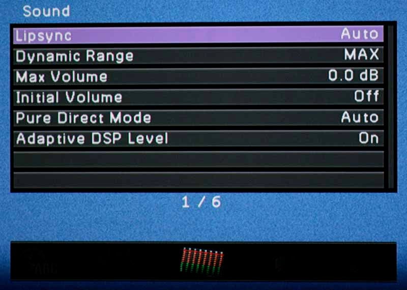

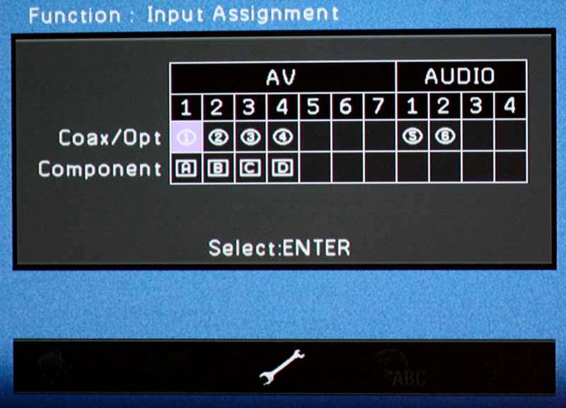

If there is a utility menu, this is it. Auto Power Down (really Standby mode) can be enabled for 4, 8, or 12 hours of inactivity (or disabled completely). And, instead of a dedicated digital audio/video input menu, Yamaha dumped it here - presumably figuring that once you set this up you'll leave it alone. Note that you can configure everything independently, however the naming conventions - being just numbered inputs - really make this a more difficult process for many users. While some may be able to remember they plugged the TV into the "SAT" input, you're going to need a cheat sheet when setting up the RX-A3000 unless you have a photographic memory that likes lots of arbitrary numbers. You also can't re-assign HDMI or analogue inputs - it's AV1, AV2, AV3... just put them where they need to be and forgeddabouddit.
Returning back to where we started, the Function menu is what lets you set the front panel dimmer level, scrolling mode, trigger functions and the wallpaper for the menu. While Yamaha gives you 4 options for the wallpaper, none of them is custom - and odd thing since they have both USB access and networking functions as a means to grab a compatible file.

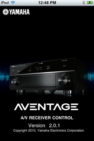

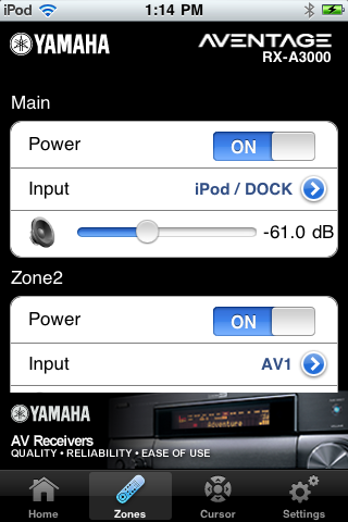

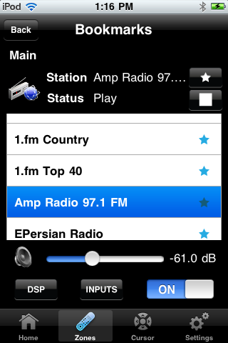

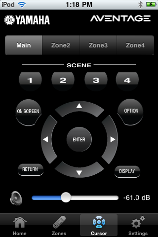

Aventage iPhone/iPad App
iPad-app-splash.pngSpeaking of apps, Yamaha also released an Aventage iPhone/iPad app which allows user control over features like Zone volume and source selection. It even grants control over the tuner and Internet radio sections of the receiver. We have to be honest, the App was a bit of a dog in our testing, with slow feedback and a quirky interface, but it's a great start - and for free it's hard to complain.  Particularly with respect to using multiple Zones, it's almost a life-saver. Near the end of our review Yamaha added some new functionality to the App - namely a cursor or menu control system whereby you can use your iPad or iPhone to control the GUI menu system of the RX-A3000. (It should be noted we tested ver 1.0.1 at the time of this review, and there is now a newer version 2.0.1 app which Yamaha claims to have improved interface options and speed.) We are starting to see more and more of this and, as such, it's going to be surprising if we don't eventually see the end of remote controls entirely - at least as we know them to be today. Let's face it - as receivers become more complex, our complaints about remote controls go up. You just can't sufficiently add enough functionality on the face of a remote with such limited real-estate. Add an LCD touch screen, however, and you now have the ability to configure modes and much more ergonomic control functions. The future is coming, and Yamaha brings it partially here with its App.

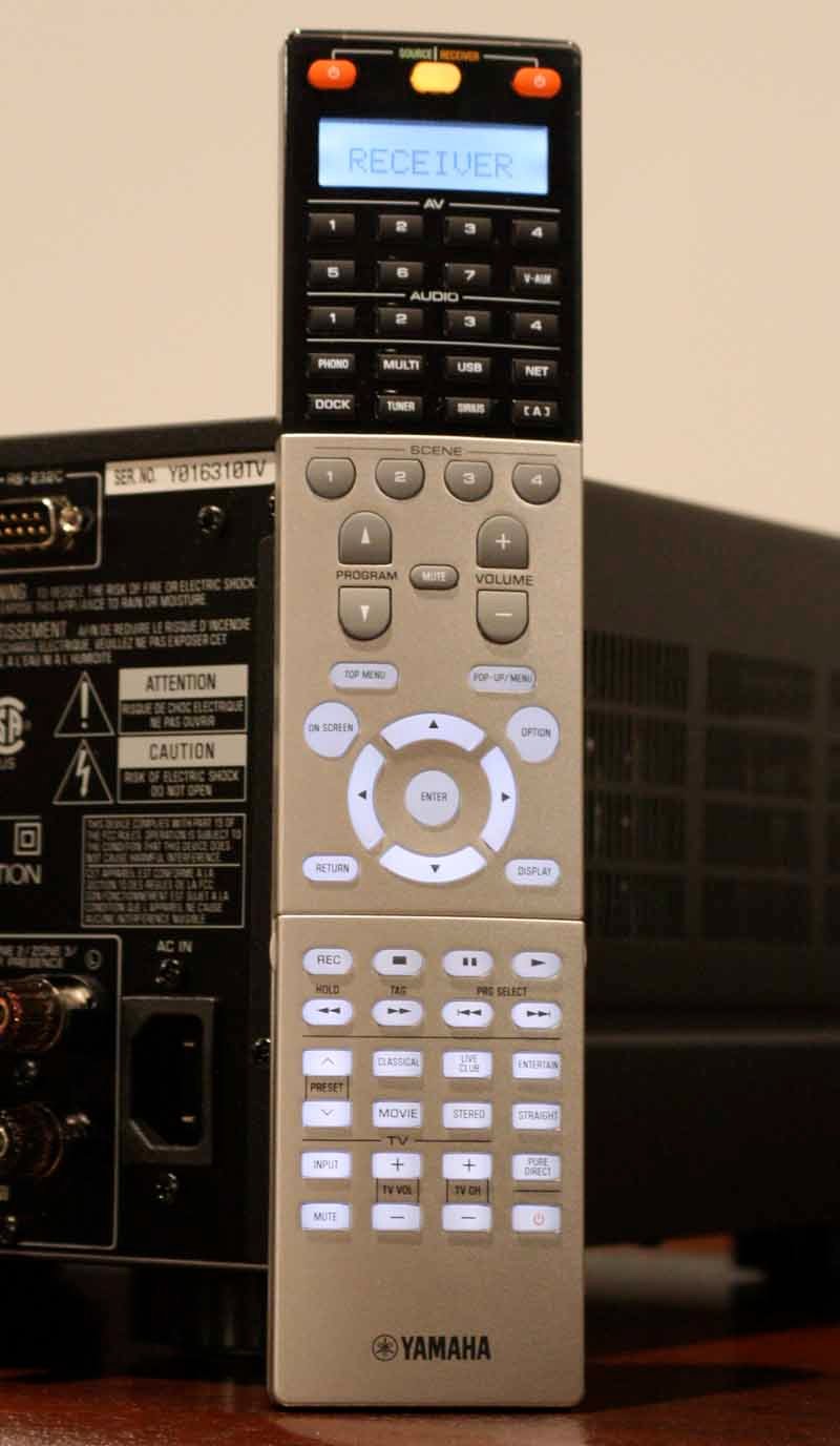

Remote Control
RX-A3000-remote.jpgOK, on to the remote control... Look, we hate the Yamaha RX-A3000 remote. It's a standard Yamaha remote and the company seems to have a knack for making things over-complicated and just difficult. Remember the RAV 172 remote? These guys make an art form out of unusual interfaces. The new RX-A3000 remote doesn't have an unusual interface, it just features a ton of buttons on the front face and a flip up panel at bottom to allow even more functionality - like a number pad for tuner control. Aesthetically, it looks, at first blush, like an inversion of the x67-series remotes, but with more buttons. But the real problem is that the Source buttons all have useless labels... like AV1, AV2, and AV3... Um, that's descriptive. Like the unusable nomenclature on the rear of the unit, Yamaha shoots users into oblivion with their label-free alphanumeric designations that will be sure to drive anyone (except maybe the person who sets up this receiver) batty in less than 60 seconds... Scratch that, it drove us batty - and we're the ones who set it up! With a new GUI interface, perhaps Yamaha is subconsciously drawing users to use that (and their iPhone/iPad app).  Advanced users will want to take advantage of Yamaha's Receiver Manager software integration capability which we've covered in prior reviews.  This will come in handy to relabel inputs into more meaningful names.
Yamaha needs to buy some stock in Logitech or Universal Remote, because with flagship remotes like this they are practically driving everyone to use a competing device to retain their sanity. I could go into the way they broke down the remote, but you have eyes and we included a picture - add $200 to this receiver and get yourself something you can actually give your significant other to use. If you're single, you can make due with this and it does allow for learning of other device codes - it just won't support the four color buttons that are required for advanced use of Blu-ray players and (particularly) any Samsung device.

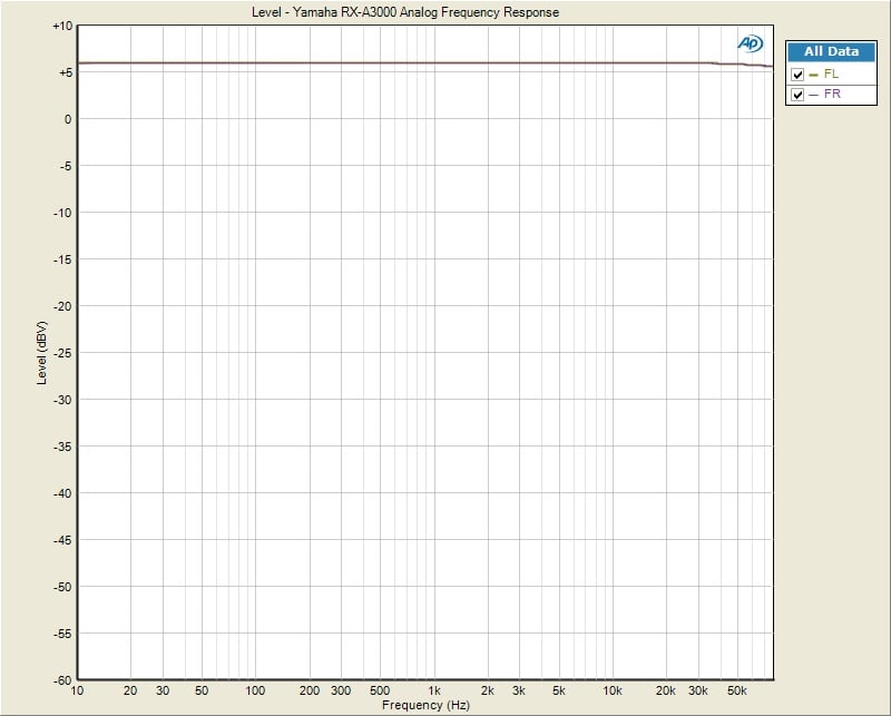

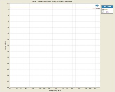

Yamaha RX-A3000 Analog Frequency Response
Frequency Response was ruler flat from 10Hz to 80kHz (the limit of the APx585 test equipment) with +-.025dB variation.  The preamp gain (Av) = 13.6dB similar to what I measured on the RX-Z7.

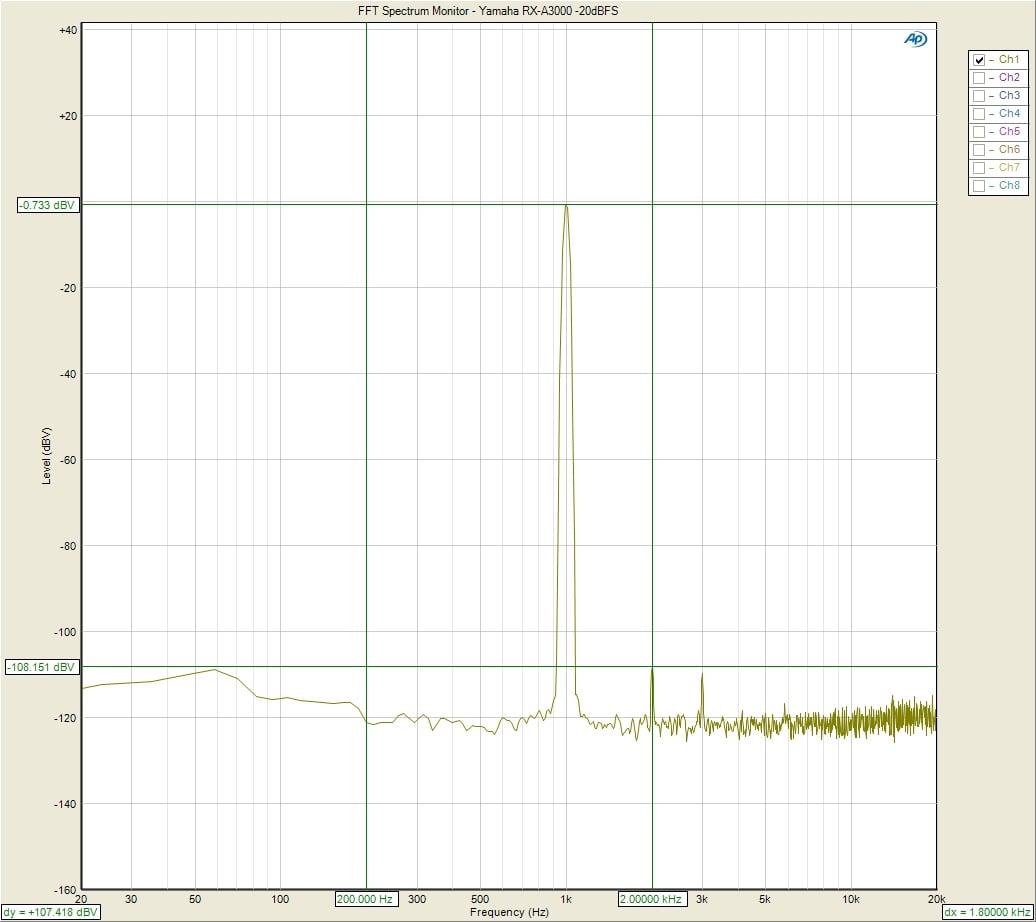

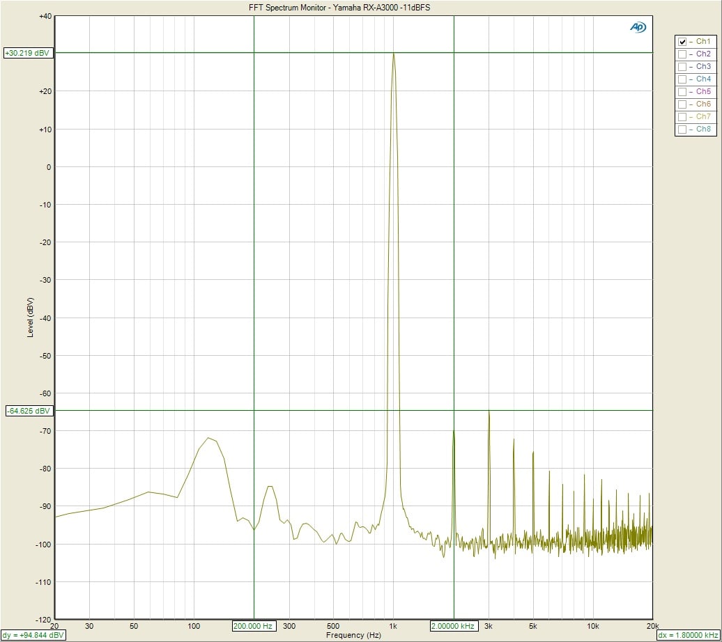

Yamaha RX-A3000 FFT Distortion (HDMI In, -20dBFS, 1Vrms out)
Driving the RX-A3000’s HDMI input with a -20dBFS signal, I adjusted the volume control until I measured 1Vrms via the preamp outputs., The RX-A3000 displayed an excellently clean FFT distortion profile with the magnitude of the 2nd harmonic of (-.733 +108.15)dBv = 107.4dBv or 100*alog^-1(-107.4/20) = .0004% THD + N.   As you can see in the output, residual noise products are virtually nonexistent.

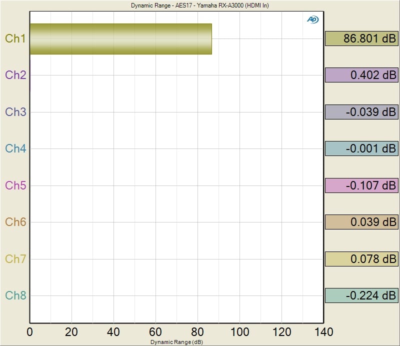

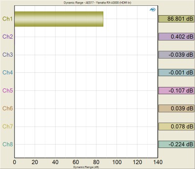

Yamaha RX-A3000 SNR (pre-amp driven via HDMI)
Using the HDMI input driven at -20dBFS with 1Vrms out of the preamp analog outputs, I measured 86dB (unweighted).  This is a pretty clean measurement.  I repeated this test via the analog inputs and noticed an elevated result likely due to clock noise or just digital artifacts well above the audio band corrupting the measurement.  Engaging “Pure Direct” made about a 3dB improvement to this measurement coming close to the SNR performance I measured when driving the RX-A3000 via an HDMI input source.

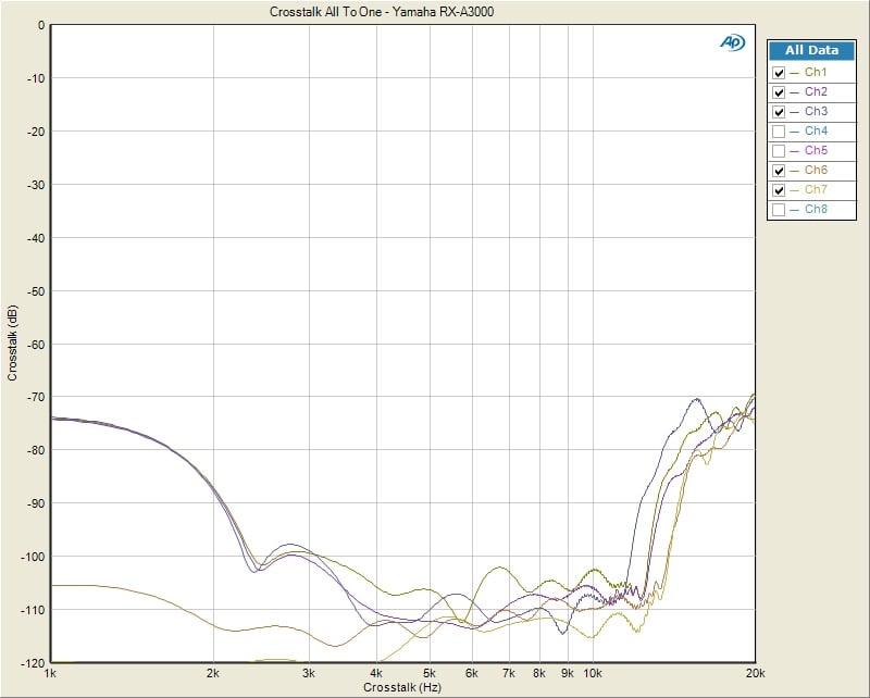

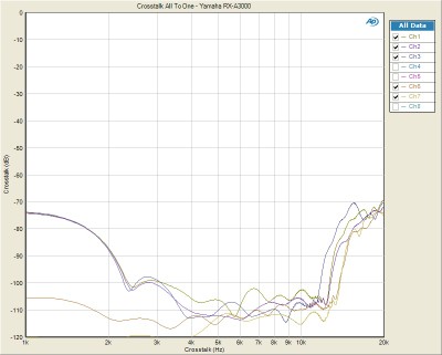

Yamaha RX-A3000 All-to-One Crosstalk (HDMI In, Preamp Out 1Vrms)
The RX-A3000 exhibited commendable channel to channel crosstalk performance. With all channels acting as the noise source or disturber driven via the HDMI input, I measured each idle channel one at a time to determine the worst case channel to channel crosstalk.  At 1kHz the RX-A3000 yielded -70dB @ 1kHz dropping lower with frequency (odd but true) and still maintaining -70dB at 20kHz for its noisiest channel.  I consider anything less than -40dB @ 10kHz acceptable so the RX-A3000 met that minimum requirement with 30dB to spare!  With only one channel driven at a time, channel to channel crosstalk performance was about 10dB better across the board putting it on par with what I measured on the RX-Z7 two-channel crosstalk tests.

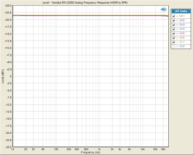

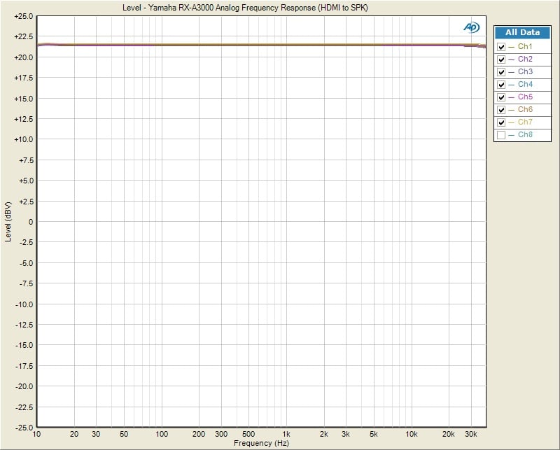

Yamaha RX-A3000 Frequency Response (HDMI In, Speaker Level Outputs)
With the RX-A3000 driven by a -20dBFS input signal via HDMI, I measured all channels driven at 8 ohms via the speaker outputs at 10 watts power level.  Frequency response was again ruler flat from 20H to 80Khz (the bandwidth limit of my AP test gear) +-0.04dB variance which was incredibly linear.
Yamaha RX-A3000 FFT Distortion Analysis at Full Rated Power
The distortion spectra of the RX-A3000 amplifier overall is very good.  However as the RX-A3000 approached max rated power (140wpc) odd order harmonics started to dominate (30.2 +64.6)dBv = 94.8dBv or 100*alog^-1(-94.8/20) = ..002% THD + N.  This is still a good measurement and comparably cleaner to what I measured on the Emotiva UPA-7 7CH power amplifier for a reference.

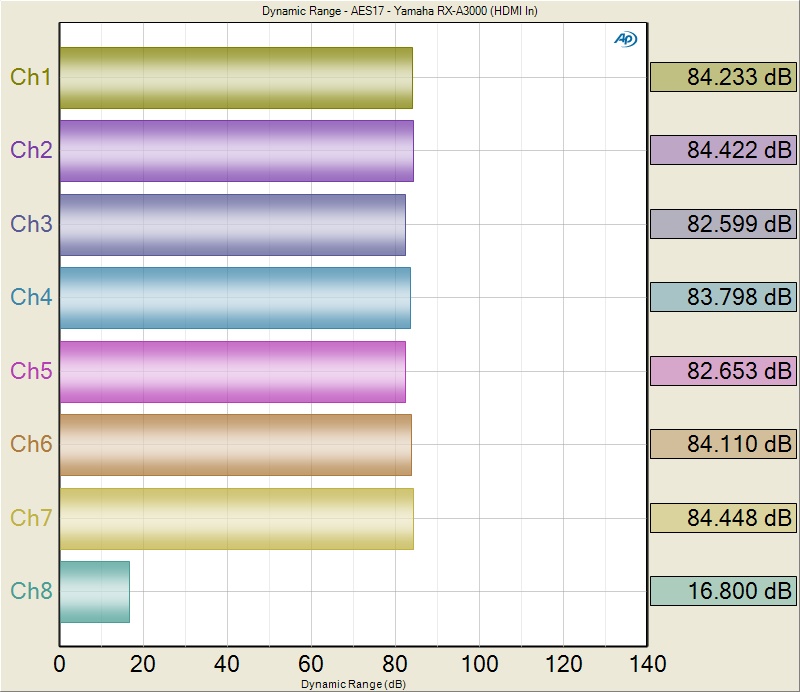

Yamaha RX-A3000 SNR (HDMI In, Speaker Level Outputs)
Driving the RX-A3000 with a -20dBFS input signal via HDMI, I measured 84dB SNR at 1 watt with all channels driven.  The RX-A3000 noise floor from preamp all the way through its power amp section is commendably low.  I measure amplifier SNR at 1 watt to put everyone on equal footing and to also better gauge its low level performance where the amplifier spends most of its time operating at.  I consider 80dB @ 1 watt (un-weighted) to be a good measurement which the RX-A3000 comfortably exceeded.

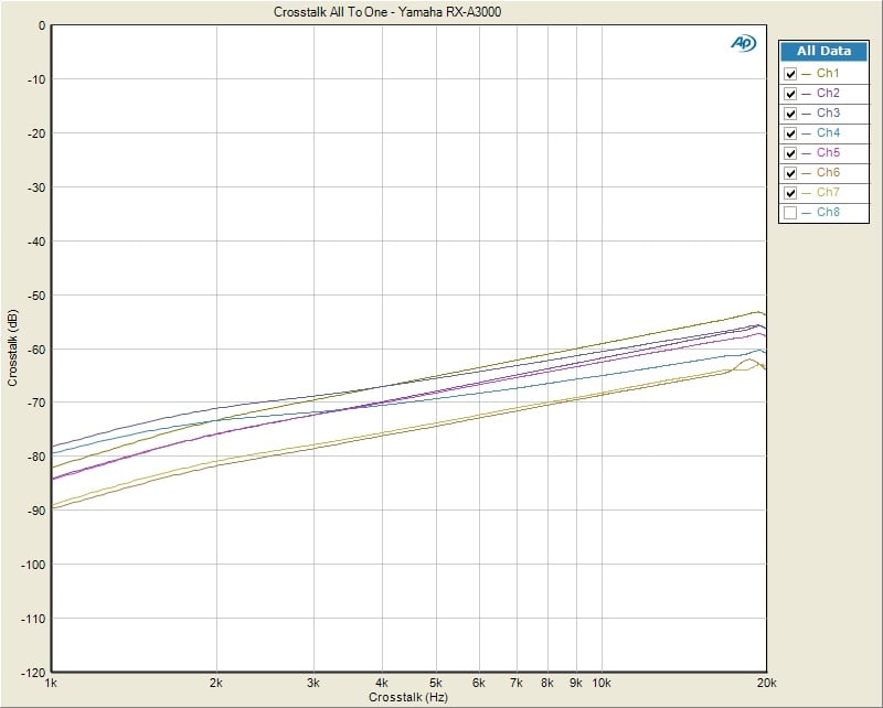

RX-A3000 All-to-One Crosstalk (HDMI In, Speaker Level Outputs 20watts)
I measured all-to-one crosstalk from the preamp input of the RX-A3000 all the way to the speaker outputs with each channel driven at 20 watts (except the channel under test).  Channel to channel crosstalk was excellent (80dB @ 1kHz, 55dB @10kHz).  Again this is a worst case crosstalk measurement.  Simply measuring channel to channel crosstalk with only one channel acting as a disturber at a time would produce numbers 10dB or lower across the board.  This is how most publications measure crosstalk but we tend to be harder on the products and test them in the worst case scenarios like these.

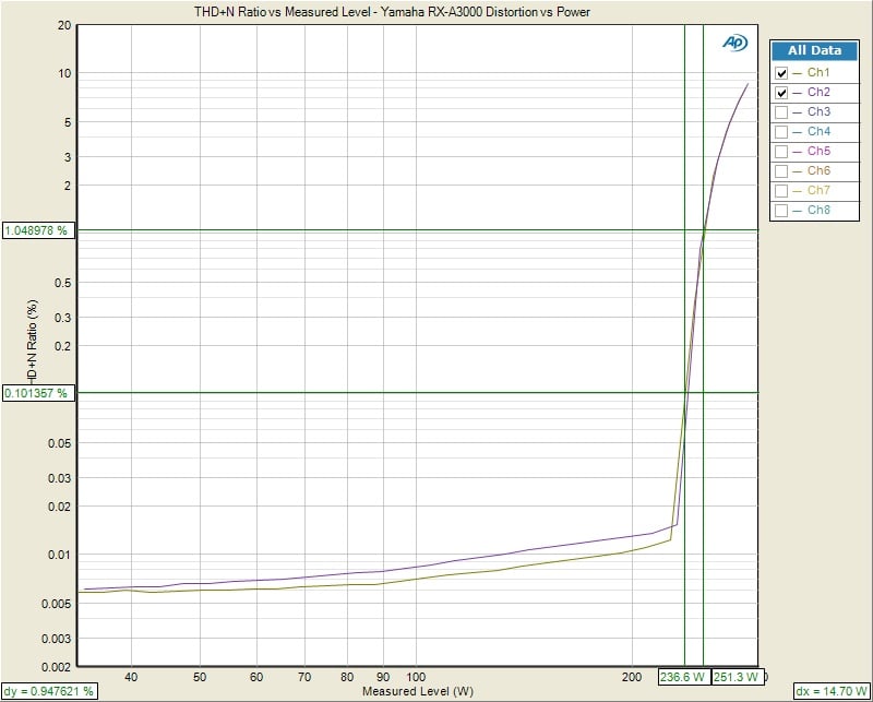

  • 1kHz Power Sweep vs Distortion (1kHz PSweep) - popularized by the print magazines, this is an instantaneous power vs distortion test at 1kHz. The problem with this test is it often masks slew related and or frequency response problems some amplifiers exhibit at the frequency extremes, and thus inflates the measured power results. It does provide an instant gratification # for consumers to argue over on the forums so we are now incorporating this test to please the masses.
  • Dynamic PWR - 1kHz CEA-2006 Burst Method testing - this is a dynamic power measurement adopted from the car industry similar to IHF method only a bit more difficult for an amplifier and more representative of real musical content.

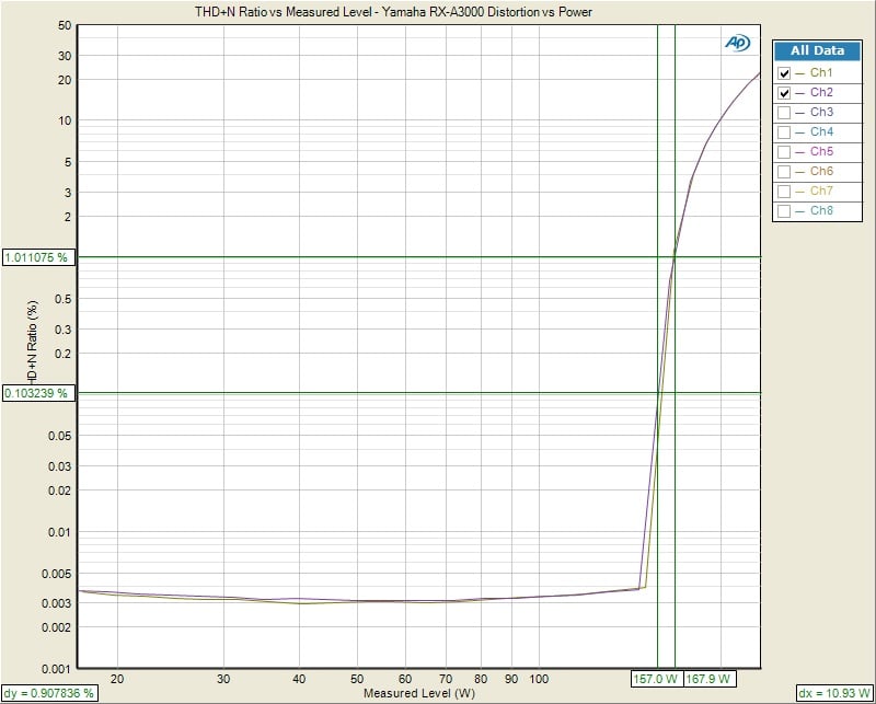

Yamaha RX-A3000 1kHz Power Test
Left Pic: ACD, 8 ohms;  Right Pic: 2 Channels driven, 4 ohms

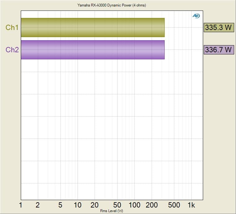

Yamaha RX-A3000 Dynamic Power Test (1kHz) 2CH Driven, 4 ohms

2 1kHz Psweep 168 wpc 8-ohms 1%
2 1kHz Psweep 251 wpc 4-ohms 1%
7 1kHz Psweep 65 wpc 8-ohms 1%
1 Dynamic PWR 217wpc 8-ohms 1%
1 Dynamic PWR 386wpc 4-ohms 1%
2 Dynamic PWR 205wpc 8-ohms 1%
2 Dynamic PWR 330wpc 4-ohms 1%
7 Dynamic PWR 153 wpc 8-ohms 1%
       Yamaha RX-A3000 Power Measurement Table
The Yamaha RX-A3000 handedly exceeded its 140wpc power rating continuously with two channels driven and stomped out an impressive 236wpc both channels driven into 4 ohms; and that’s a full power bandwidth measurement (20Hz to 20kHz at 0.1% THD + N).  It proved to be every bit as powerful as their more expensive RX-Z7 mode.  You can see the protection circuit kick on during our ACD tests, purposely limiting power to 65wpc.  In short time, there is no doubt in my mind forum lurkers seeing this will pop up on our site or AVS Forum bashing Yamaha, not realizing the design purpose of power limiting a multi channel amplifier in a compact chassis, or the reality that real world program material will never trip this limiter circuitry.  Thus we conducted dynamic burst power measurements simulating real world program content.  Interestingly enough the RX-A3000 delivered similar dynamic power output ACD into 8 ohm loads and slightly more power two channels driven into 4 ohm loads than the Emotiva UPA-7 dedicated multi-channel power amplifier that is designed to deliver rated power continuously into all channels as can be seen in the comparison table below.

RX-A3000-bottom.jpgBooyah! Yamaha has hit it out of the park with this one.  The RX-A3000 proved itself to be a worthy and most importantly less costly successor to the venerable RX-Z7 (though we do miss Yamaha's signature orange frontpanel display).  Say all you want about our ranting about the remote - apart from that, the Yamaha RX-A3000 is a real winner that shows its true colors a an audiophile product that has legs. It's an incredibly flexible and powerful system that works well, measures well and looks... well, it looks like every other black box - but that's not how we shop for these things. On the list of surprises was the adept iPhone/iPad app. It's not perfect, but it's a nice touch and it's free. We also liked the video processing performance and the way you can configure this receiver to utilize all 11.2 channels as needed. This is a keeper and we hope that it's just the beginning for a company that seems to really get this market.

Remote ControlStarStar
