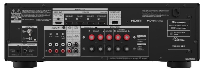

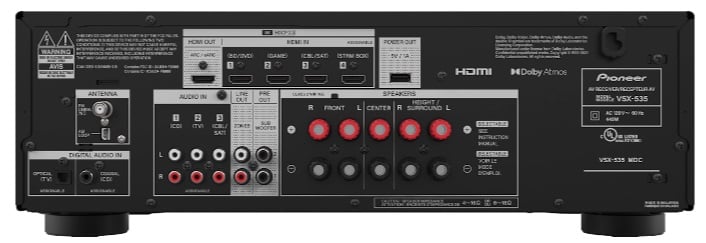

VSX-535
CHANNELS: 5.2 (5 amplified)
POWER OUTPUT: 80w (20-20kHz, 0.08% THD, 2ch @ 8 ohms - FTC)
AMPLIFIER CLASS: Class AB
HDMI I/O: 4 In / 1 Out (eARC)
HDMI CAPABILITIES: 8K/4K Ultra HD, Dolby Vision, HDR10+, HDCP2.3, HDMI2.1a VRR, QFT, Dynamic HDR, ALLM, DSC, SBTM
AUDIO INPUTS: 4 HDMI, 3 RCA, 1 Opt, 1 Coax
AUDIO OUTPUTS: Zone B Stereo RCA Lineout, 2 Preout subwoofer
ROOM CORRECTION: MCACC Auto Room Tuning
SURROUND MODES: Dolby Atmos, Dolby Atmos Height Virtualizer, Dolby Surround

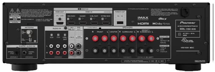

VSX-835
CHANNELS: 7.2 (7 amplified)
AUDIO OUTPUTS: 2 Preout Subwoofer, Zone B Stereo RCA Pre/Lineout, Power Zone B
SURROUND MODES: IMAX Enhanced, Dolby Atmos, Dolby Atmos Height Virtualizer, Dolby
Surround: DTS:X, DTS Virtual:X, Neural:X

Pioneer Amplifier Power Sacrifices
But, what is the catch at this price? What is missing or lacking from these new budget AVRs from Pioneer? Features aside, you give up some beef in the power supply and amp sections. Both Pioneer receivers are rated at 80 watts/ch (2CH) driven per FTC but it's a sure bet the power goes down significantly with all channels driven. Current drive is another area that budget receivers suffer. Since neither unit has preamp outputs, you can't simply supplement for more power down the road if you choose low-impedance power demanding speakers. We would recommend using speakers with a nominal impedance of 6 ohms or higher IF your planning on powering your system with either of these AVRs.

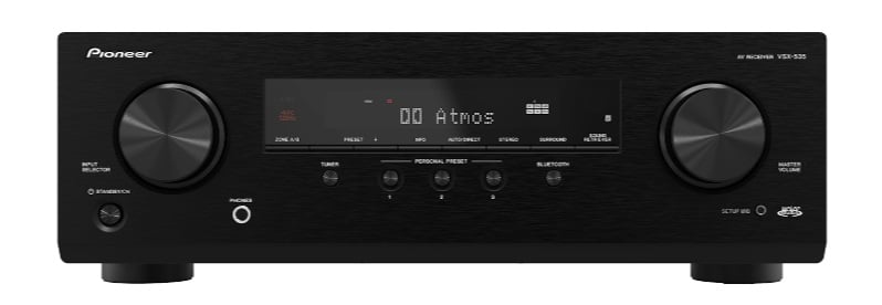

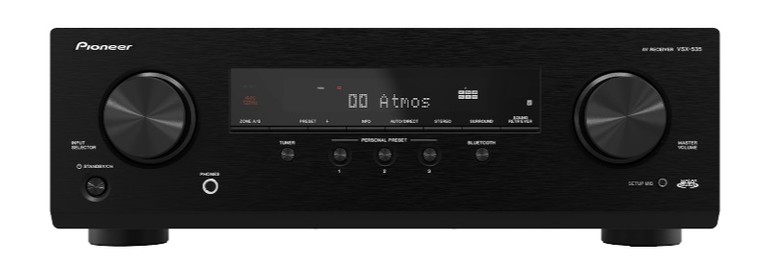

VSX-535 5.2 AV Receiver
For $379, the VSX-535 supports Dolby Atmos capabilities and Dolby Surround, HDMI 2.1, and Bluetooth streaming. Pioneer says that the VSX-535 can be setup as a 5.2 or a 3.2.2 configuration. A 3.2.2 setup is not the best use of your money, but like rooms that don’t support in-ceiling speakers you might have no choice but to go with bouncy-house up-firing speakers. In this case, if your room doesn't support rear speakers this is another option and an incredible value to get people started in an immersive sound home theater.
Both receivers comes with Pioneer’s MCACC auto room tuning software. Auto Room Tuning MCACC (Multi-Channel ACoustic Calibration system auto room tuning uses a custom microphone to automatically compensate for differences in speaker size, level, and distance, and equalizes response, so you get the even sound you’re supposed to. It’s no DIRAC or Audyssey, but I’ve used it and it does a decent job of calibrating your room based on the sound in the room. At the very minimum, it gives you a starting point for channel level and trim settings for those that aren't handy with an SPL meter and tape measure.

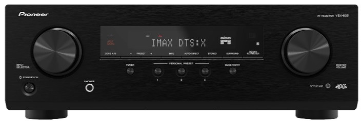

VSX-835 7.2 AV Receiver
The VS835 upgrades to 7 channels of amplification and can be set up as a 7.2 or 5.2.2 system. The VSX-835 also comes with and IMAX Enhanced mode for MAX digitally remastered content—just as the filmmakers intended. Pioneer’s IMAX Enhanced Mode is optimized to adhere to strict performance standards around color, brightness, contrast, and audio fidelity.
The VSX-835 supports DTS:X and uses DTS Virtual X to automatically adapt audio to existing channels and speaker setups, so no specific speaker layout is required. We’ve played around with the Virtual X technology ourselves. It doesn’t substitute for a true 5.2.2 or 7.2.2 system, but it does do an amazing job of adding layers of sound throughout the room without speakers.
2 Sub Outputs - NOT Independent
Let's be clear about the dual sub preouts on both of these units. Both theVSX-535 or 835 dual sub outputs are in parallel so you can't adjust delay or level for each of them independently. Understandable for this price class of AVR so if you need independent delay/level control for your dual subs, you're gonna have to add a mDSP or choose subwoofers that have level/delay features built in for you.
