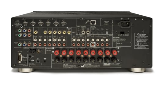

VSX-1120-K_REAR
First let's start of with the similarities. The VSX-1120-K sports all the features of the VSX-1020-K including 7x100 watts of amplification, iPhone Certification with on-screen album art and iPhone app control, six 3D ready HDMI 1.4 ports including one on the front plate, Bluetooth readiness, assignable amps for Dolby ProLogic IIz height channels or Zone 2, graphical GUI, Ethernet jack for Internet radio, Sound Retriever AIR, 1080p video upconversion, and advanced MCACC auto setup and calibration. That sounds like a lot - and it is. But remember, these are all features that are shared with the VSX-1020-K.
The first, and most minor, of upgrades is in the assignable Zone 2/height channel binding posts. Up until the VSX-1120-K these have been either absent (lower models) or use spring-type clips. As Audioholics, we are opposed to spring-type binding posts in general but especially at this price point. Pioneer anticipated this and upgraded them to the more traditional five-way binding posts.
The next addition to the feature set of the VSX-1120-K is a RS-232 port. While this might not matter to many home enthusiasts, it makes a big difference for custom installers. This gives the custom installer much more flexibility in integrating the VSX-1120-K into a control system. The RS-232 port is used for direct control of higher-end home automation systems. Also included with the VSX-1120-K is direct PC control. As long as you have your receiver connected to a router via the Ethernet port, you can access and control it with any PC or Mac on the network. For some features (such as setting up Internet radio presets and renaming inputs), PC control is invaluable.
