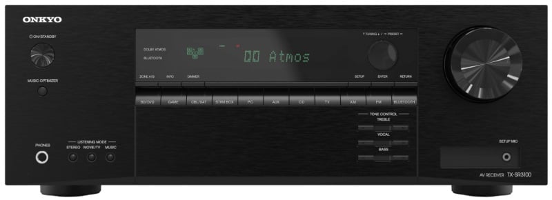

TX-SR3100 front

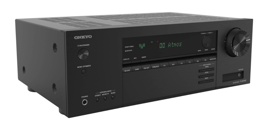

Now, Onkyo has released the all-new TX-SR3100 5.2 channel AVR for $400. The receiver is advertised at 80 W/ch (into 8 ohms (20-20,000 Hz) at 0.08% THD, with 2 channels driven) which IS the correct nomenclature for power ratings. It also comes with the codec for both DTS:X and Dolby Atmos for a 3.1.2 system.   It’s a bit misleading to call it an Atmos receiver when it can’t support at least a 5.1.2 speaker layout though. In most instances, we would recommend a standard 5.1 speaker configuration for this AV receiver and NOT bypass the surrounds for height channels.But if you don't have the ability to run rear surrounds and want a more  immersive setup with Atmos or DTS:X decoding than this would be a way to do it on a budget.

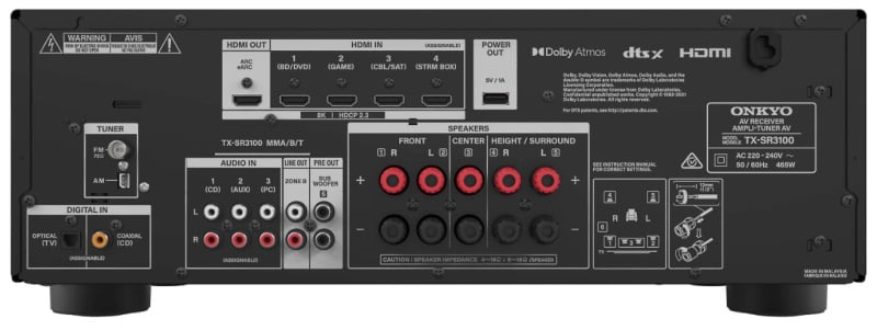

TX-SR3100 rear
Onkyo TX-SR-3100 dual sub outs are parallel and do NOT have independent delay or level control
