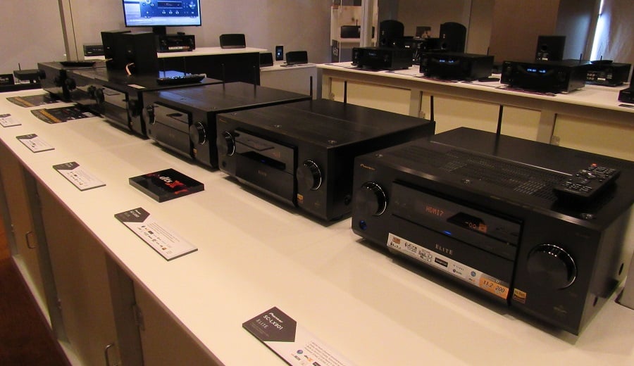

Pioneer's new receivers at CEDIA
Pioneer's new network Atmos/DTS:X AV receivers on display at CEDIA

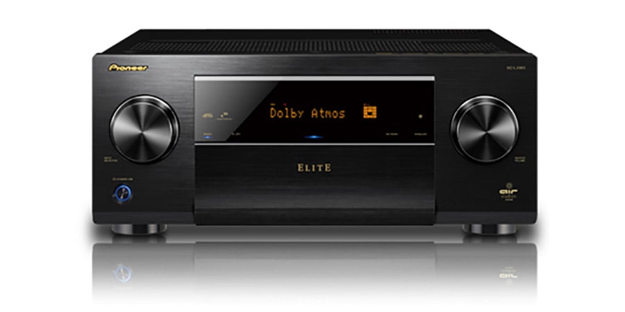

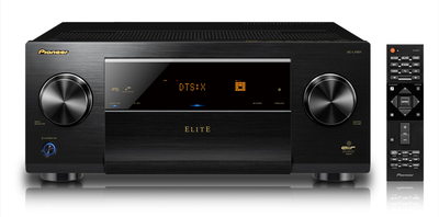

Pioneer SC-LX801 Network AV receiver front view.
Pioneer’s stated specs for each model are only with two channels driven—not all channels—and there are some other aspects of their power ratings that we'll explain.  Unfortunately, manufacturers don't give us specs with all channels driven and it doesn’t give us an true idea of how these units will really perform when stressed. So, on paper, the 9.1 channel SC-LX701 is rated to deliver 135 wpc into 8 ohms at 0.08% THD with two channels driven.  The 9.1 channel SC-LX801 delivers 140 wpc into 8 ohms at 0.08% THD with two channels driven.  The flagship 11.1 channel SC-LX901 sports the same specs as the LX801 (140 wpc at 0.08% THD with two channels driven) but has 11 on-board amplification channels instead of nine.

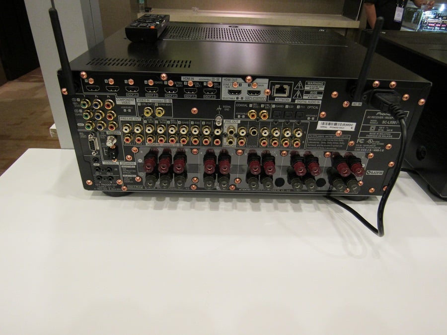

Pioneer SC-LX701 Network AV receiver at CEDIA
Rear of the Pioneer SC-LX701 Network AV receiver at CEDIA

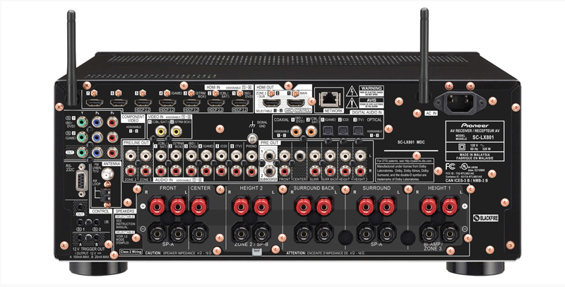

Pioneer SC-LX801 Network AV receiver rear view

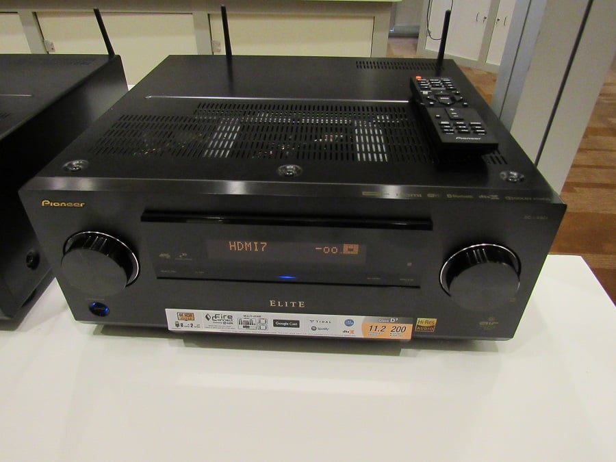

Pioneer SC-LX901 Network AV receiver at CEDIA

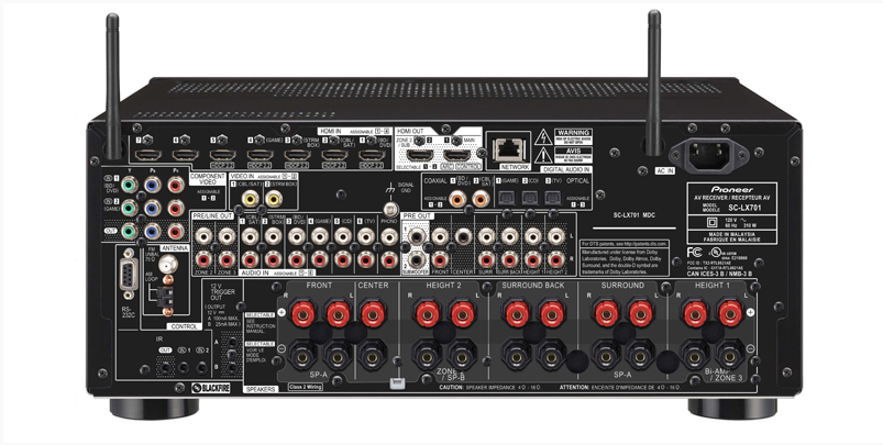

Pioneer SC-LX701 Network AV receiver rear view
