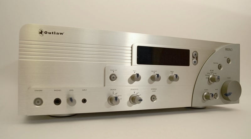

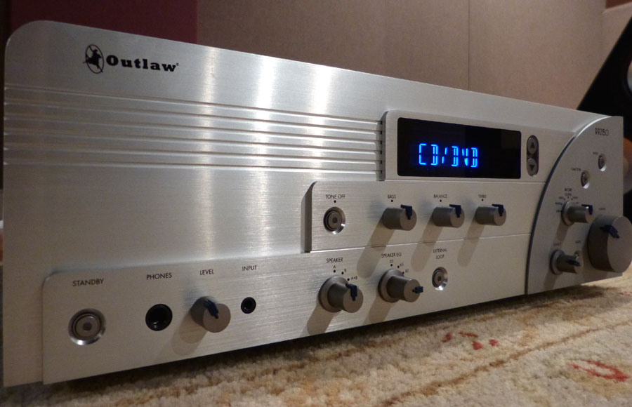

Front Panel: Knobs, Buttons, and Lights
Although many audiophiles would like to think they can surmise everything there is to know about a product by glancing at the rear panel, the gorgeous front panel on the RR2150 demands a good look. Inspired by the art deco radios of the past, the front panel is brushed aluminum with custom tooled knobs. Little blue LED lights rest in the center of some of the buttons, adding utility as they indicate the state of a button, and a modern styling.
Outlaw Audio RR2150 Front Panel

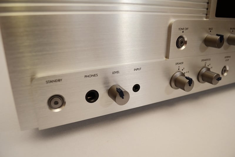

On the front panel, you will find a ¼ headphone jack with independent volume control. You can’t always use the big speakers, and with the proliferation of high-end headphones recently, this is a nice feature to have.
There’s also the previously mentioned 3.5mm input and speaker selector with the standard four options: A, B, A+B, Off. The speaker outputs are wired in parallel which is the preferred way of connecting multiple speaker pairs. Though this means the load impedance the amp sees is cut in half (assuming speakers with identical impedances are connected). This will cause the double the current draw in these cases so use caution when running two pairs of speakers simultaneously.
When using the headphone jack, the main speakers are still enabled unless you turn them off using the speaker selector control. There are also tone controls for bass and treble. Both offer ± 6.5dB of adjustment, with the treble adjustment at 10kHz and bass at 50Hz. I used the controls a small amount during my listening tests. Although they were unnecessary with my MartinLogan Theos, I liked the bass boost on my MartinLogan LX16 bookshelf speakers and enjoyed a few dB of attenuation in the treble on the Polk Audio LSiM703. There’s a Tone Off button to defeat the tone controls, and in between the bass and treble knobs is a balance knob. An extra bonus is that tone and balance controls work for the headphones as well.
If the ±6.5dB at 50Hz isn’t enough extra boom-boom for you, Outlaw also incorporated a Speaker EQ knob that adds a 6dB boost at 55, 65, or 80Hz. The purpose of this adjustment is to add bass around the point that a small bookshelf speaker starts to roll off. We’d caution users to be careful to not overdrive their speakers when using the Speaker EQ function. Additionally, sometimes the lack of bass at a certain frequency has little to do with a speaker, and is actually because of room modes and standing waves.
On the right hand side of the receiver you will find a few more controls. Function, Enter, and Up/Down Arrows are used to adjust the built-in AM/FM tuner. A control labeled “Record” selects what source you want output from the Tape Out RCA jacks on the rear panel. Below that is a knob for adjusting source. When flipping through the sources quickly, it’s easy to turn past the desired input because the “click” between inputs doesn’t quite lineup with the actual input change. Finally, a mute button sits right next to the motorized volume control. Yeah, the volume knob is motorized, it’s freakin’ cool.

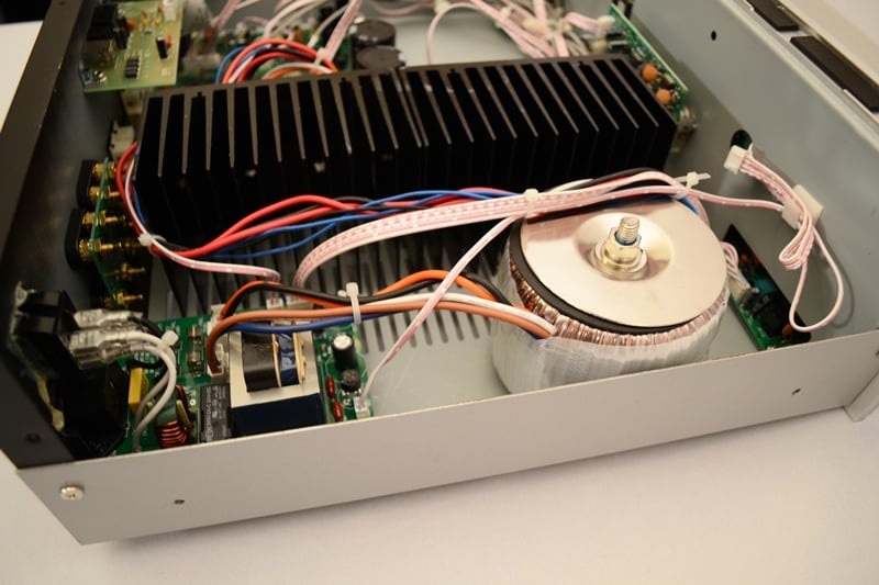

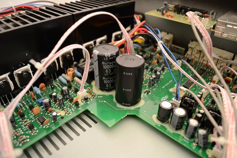

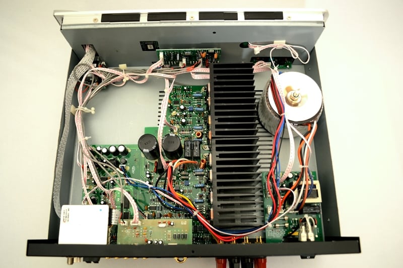

One of the main reasons consumers invest in nice gear is because they expect it to be built to a higher standard than entry level gear. Consumers with such expectations will be pleased with the RR2150.
Outlaw Audio RR2150 Top Removed
Even before removing the top panel, the overall feel of the unit is high-end thanks to the milled aluminum face plate and glowing blue LEDs. Even the top cover is sturdier than your general run of the mill AV receiver.
The binding posts are solid, but they look more like the binding posts on a 1970’s H/k receiver than what’s found on modern high-end receivers or amps. In fact, our oversized Monster M2.2s speaker cables wouldn’t fit with the spade lugs we normally use. Luckily, the tips on the M2.2s are swappable, so we traded out the spade lugs for banana plugs.
Power Capacitors Power Supply
Inside are two thick heatsinks with 4 output transistors per channel to allow the amp to source more current at lower impedance. A pair 10,000uf, 63v power capacitors are a healthy size for this receiver. 63V rating provides plenty of voltage margin to achieve high enough rail voltage to sustain the 100wpc rating. If you look closely, you will see that the caps are 105 deg C rated. This is great for durability and better than the standard 85 deg C parts most mass marketing companies use.

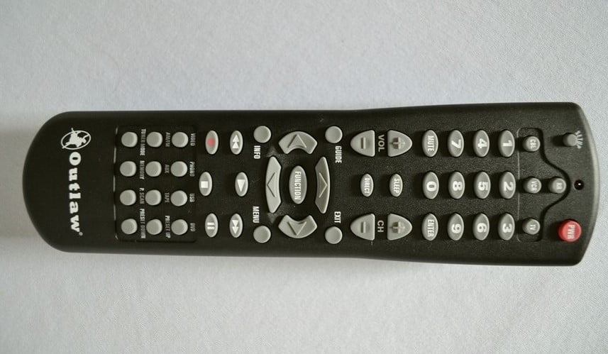

Outlaw Audio RR2150 Remote
We are used to poor quality remotes, even from large manufacturers who custom design their own remotes and should know better. Most of the time we write up a paragraph or two about how much they suck, and then move on. We figure that the majority of consumers will invest in a nice universal remote, or simply use their Cable/Sat remote to control everything. Following this logic, we often recommend that manufacturers focus on making a remote that controls a single device well, rather than a slew of devices poorly. Yet again, we must give that same advice to Outlaw. But in the case of the RR2150, the remote is even more important than with a full-fledged AV receiver because we expect that most consumers will actually use the remote that comes with it. Few people would invest in a universal remote for a stereo setup.
The remote has the basic controls you would imagine, power, volume and source. It also has full tuner control, including tuning mode and preset adjustment. And all of these controls worked reliably. But, it’s missing control for all of the niche features associated with the RR2150, or stereo receivers in general. We would have liked to see a “Speaker A/B” function. This makes comparing two sets of speakers much easier by preventing one from having to walk up to the front panel to make the adjustment. The same goes for the speaker EQ, external loop, tone and balance options. However, in Outlaw's defense, they had good reason for not putting all of the a fore mentioned controls onto the remote. It simply comes down to budget. Buying a generic remote and giving it the IR codes for the RR2150 is significantly less expensive than custom designing a remote. Incorporating some of the extra functionality on the remote would also mean modifying the RR2150 itself, even making additional front panel knobs motorized (not cheap). These additional production costs would likely drive up the retail price of the unit, a topic we discussed in our article about the product design process for AV electronics. To be even more forgiving, the remote does control the essentials (volume, power, input) and can operate other sources devices. Still, the remote does not fit with the build quality or feel of the rest of the unit, and we’ve seen other companies manage to produce nice remotes for high performance/low cost products.

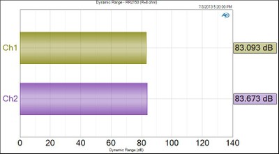

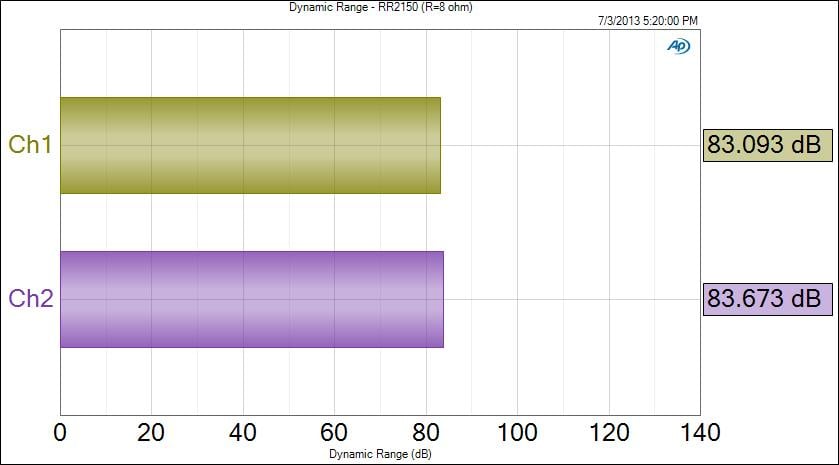

Signal to Noise Ratio
Outlaw RR2150 SNR @ 1 watt (A-weighted)
The RR2150 exhibited a low noise floor. At 1 watt I measured 83dB (A-weighted) and 76dB with no filter engaged. The relatively small difference between A-wt and un-weighed measurements indicates that out of band residual noise residuals are low. At rated power, I measured 103dB (A-wt).

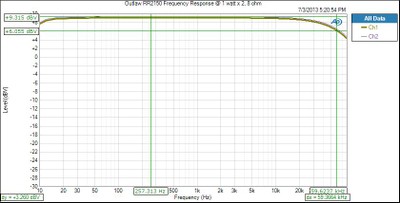

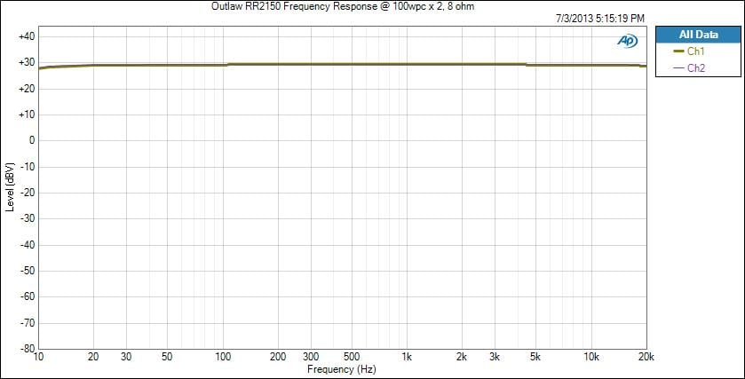

Frequency Response

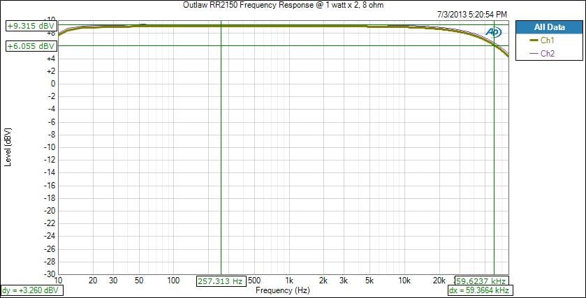

Outlaw RR2150 Frequency Response @ 1 watt

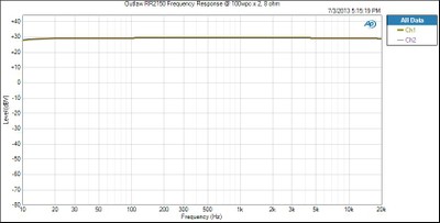

The RR2150 exhibited ruler flat frequency response at all power levels within the audio band. I measured a -3dB point of 60kHz from the speaker outputs.

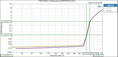

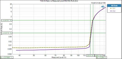

Using our Audio Precision APx585 8-channel HDMI analyzer, I conducted a full barrage of multi-channel amplifier tests on the RR2150. We tested power using three methods all of which were taken at < 0.1% THD + N:

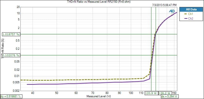

- Continuous Full Power Bandwidth (CFP-BW) from 20Hz to 20Khz into 8 and 4-ohm loads (up to two-channels)

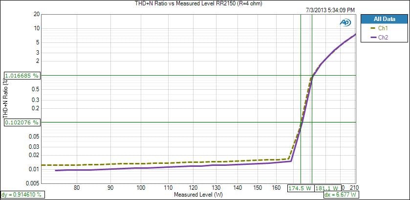

 - 1kHz Power Sweep vs Distortion (1kHz PSweep) - popularized by the print magazines, this is an instantaneous power vs distortion test at 1kHz. The problem with this test is it often masks slew related and or frequency response problems some amplifiers exhibit at the frequency extremes, and thus inflates the measured power results. It does provide an instant gratification # for consumers to argue over on the forums so we are now incorporating this test to please the masses.

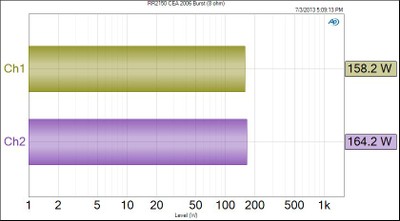

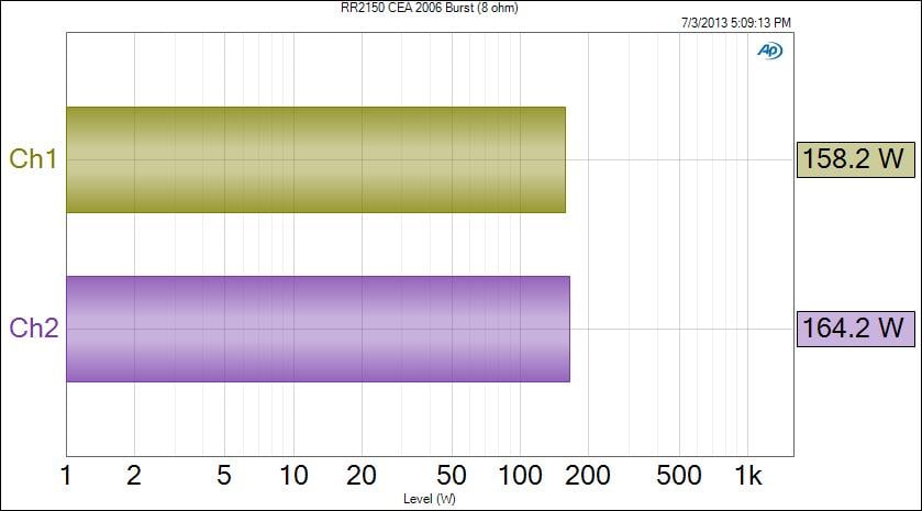

 - Dynamic PWR - 1kHz CEA-2006 Burst Method testing. This is a dynamic power measurement adopted from the car industry similar to IHF method only a bit more difficult for an amplifier and more representative of real musical content.
Keep in mind most review publications don't do continuous power measurements and they usually publish power measurements into clipping at 1% THD + N. Our measurements are very conservative as we use a dedicated 20A line with no Variac to regulate line voltage. We constantly monitor the line to ensure it never drops more than 2Vrms from nominal which in our case was 120Vrms.
For more info on amplifier measurements, see: The All Channels Driven (ACD) Test
Outlaw RR2150 Frequency Response @ Full Rated Power (100wpc x 2, 8 ohms)
Outlaw RR2150 1kHz Power Test
Top Pic: 2CH driven, 8 ohms; Bottom Pic: 2CH driven, 4 ohms
Outlaw RR2150 Dynamic Power Test (1kHz) 2CH Driven, 8 ohms
| # of CH | Test Type | Power | Load | THD + N |
| 2 | CFP-BW | 110 watts | 8 ohms | 0.1% |
| 2 | CFP-BW | 165 watts | 4 ohms | 0.1% |
| 1 | 1kHz Psweep | 143 watts | 8 ohms | 0.1% |
| 1 | 1kHz Psweep | 148 watts | 8 ohms | 1% |
| 2 | 1kHz Psweep | 120 watts | 8 ohms | 0.1% |
| 2 | 1kHz Psweep | 126 watts | 8 ohms | 1% |
| 2 | 1kHz Psweep | 175 watts | 4 ohms | 0.1% |
| 2 | 1kHz Psweep | 180 watts | 4 ohms | 1% |
| 1 | Dynamic PWR | 168 watts | 8 ohms | 1% |
| 2 | Dynamic PWR | 155 watts | 8 ohms | 1% |
| 1 | Dynamic PWR | 298 watts | 4 ohms | 1% |
| 2 | Dynamic PWR | 270 watts | 4 ohms | 1% |
Outlaw RR2150 Power Measurement Table
Outlaw rates the RR2150 as follows:
- 100 watts x 2 continuous @ 8-ohm from 20Hz to 20kHz < 0.03% THD + N
 - 160 watts x 2 continuous @ 4-ohm from 20Hz to 20kHz < 0.03% THD +N
Most amplifier companies never give such detailed continuous full bandwidth power ratings like this, let alone receiver companies. This type of honesty is refreshing.
The RR2150 not only met the specified manufacturer power figures, it beat them. For continuous power, I measured 110wpc x 2, 8 ohms and 165 wpc x 2, 4 ohms at below 0.1% THD+N. Using the typical 1kHz Psweep tests, you can see the RR2150 produced above its continuous ratings for 8 ohm and 4 ohm loads, both channels driven. Dynamic power was an impressive 168 watts into 8 ohms and almost 300 watts into 4 ohms with one channel driven. I did measure one channel to be slightly more powerful than the other by a few watts, so my figures always reflect the lower power ratings.
That being said, the RR2150 exhibited 2.3dB of dynamic headroom based on the comparison of the continuous power ratings to what I measured dynamically. It’s clear that the power supply in this amp section, coupled with high current output devices provides plenty of real world power to drive a wide variety of speakers, even those rated down to 4 ohms. Not once in any of my power torture tests was I able to cause the power protection circuits to kick in. This is one ballsy amp section for a receiver!

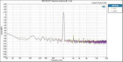

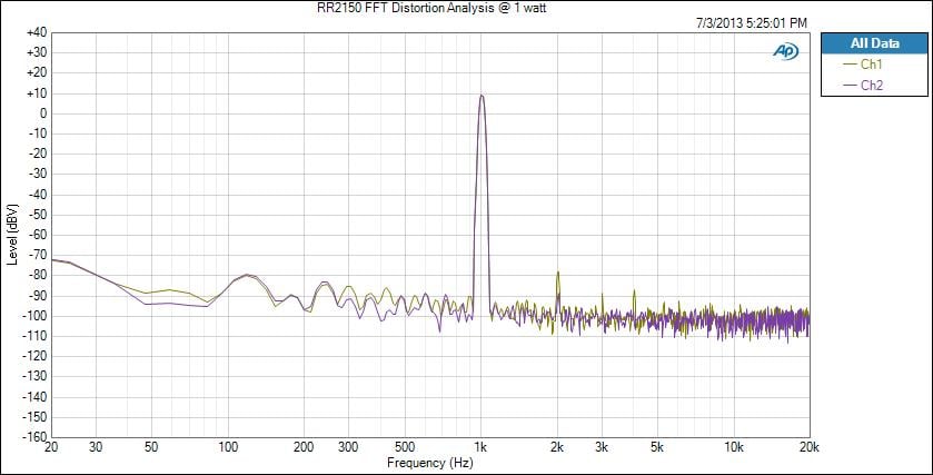

Distortion Analysis
FFT Distortion
Outlaw RR2150 FFT Distortion Analysis @ 1 watt
I ran FFT distortion plots at 1 watt and full rated power to determine how clean this amplifier really is. At 1 watt, the spectral distortion pretty clean with the 2nd order harmonic down 90dB from the fundamental. At rated power, things got a bit less sterile as expected with the 3rd order products dominating but still -85dB below the fundamental.

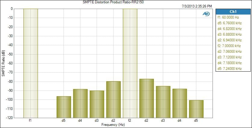

We just started including SMPTE IMD distortion tests to see how amplifiers react to non-harmonically related signals. The test signal consists of a 60Hz and 7kHz test signal summed together at a 4:1 amplitude ratio.
Outlaw RR2150 SMPTE IMD Distortion Test
This test was conducted at 25 watts with both channels driven. The RR2150 exhibited good results in this test. No residuals were present for 60Hz (which is important for power supply noise rejection) and the harmonics at 7kHz were -80dB or lower than the fundamental.

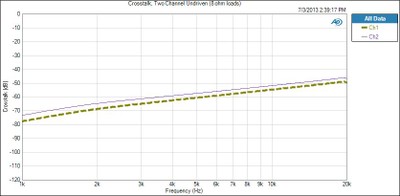

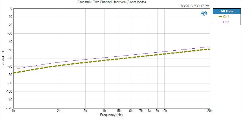

Crosstalk
Low channel to channel crosstalk ensures good stereo separation. I consider anything less than -40dB @ 10kHz acceptable and anything less than -80dB to be superb. The Outlaw RR2150 exhibited good, though not stellar crosstalk performance with about -50dB at 10kHz of isolation between the channels.
Outlaw RR2150 Crosstalk Measurement at Rated Power
